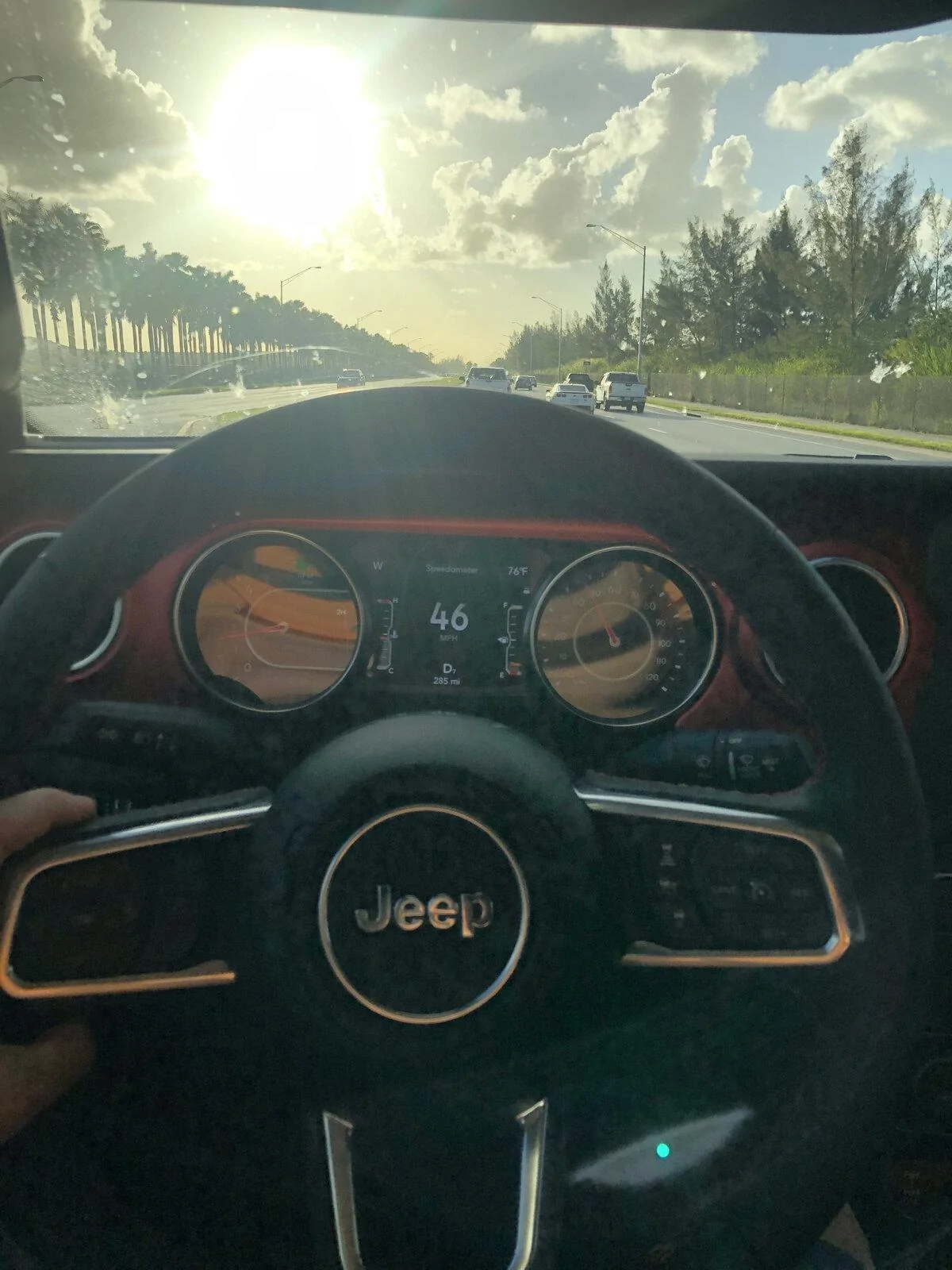

Hello Just picked up a new Rubicon Diesel and I notice that the steering wheel is off center and there is quite a bit of dead play. As a result it takes a bit of concentration and preventive inputs to keep the jeep going straight even on flat roads.
How bad is it compared to to other Jeeps and pre the recall on the steering box?

that looks awful. Mine doesn't drive anything like that. 2021 rubi with latest steering box.
that being said, mine came from the dealer with the tires at 45psi and wandered a little. took it down to 35 and drives straight.

Mine had the tires at 47 psi... Dropped to 38 and it drive really nice now (considering its a rubicon on MS tires).
Steering wheel is still off center, i talked to my selling dealer in FL (i now live in CO) and they said to take it to my local dealer (has 700 miles now), worst case if they charge me for the alignment the selling dealer will reimburse me.

Just adjust the steering wheel yourself lol. Takes two minutes.
As for the play in steering, check the steering box like what is posted on the forum. If it is the old one bring it in for the TSB. If it is the new one, get it replaced with the updated one anyways.

Check your steering boxes fellas.
Old box = silver aluminum
new box = black steel
if you have the aluminum box read the TSB in this thread and call your dealer. Not many dealers have had any issue performing the TSB. but to be safe say word for word the issues stated in the tsb, and reference the tsb, when you schedule your service.
https://www.jeepgladiatorforum.com/...b-08-074-20-for-improved-steering-feel.33705/
Many of us have had dead spots corrected with the tsb fix.
hope this helps!

I'd be very surprised that a brand new 21' vehicle would ship with the aluminum box, but definitely doublecheck this. The TSB certainly improved my dead spot.
I have seen two people who took delivery in the last two months have the aluminum box.
yea theyā€™re still out there. Weā€™ll probably stop seeing them in 2022 models but i have this inate distrust of some fca internal procedures... id bet they ā€œfixā€ them and try to reuse emā€™ haha
