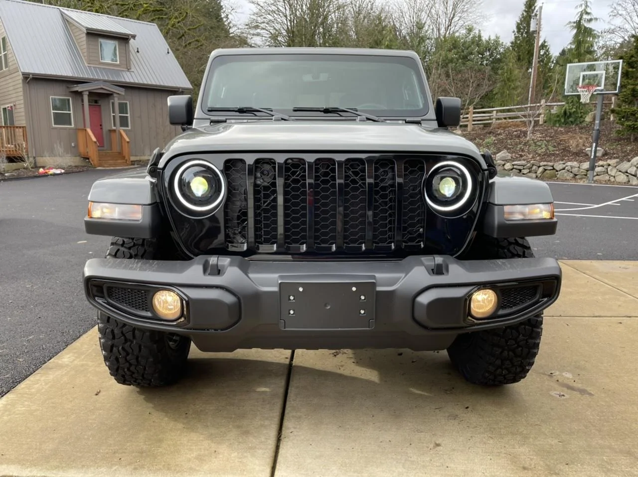

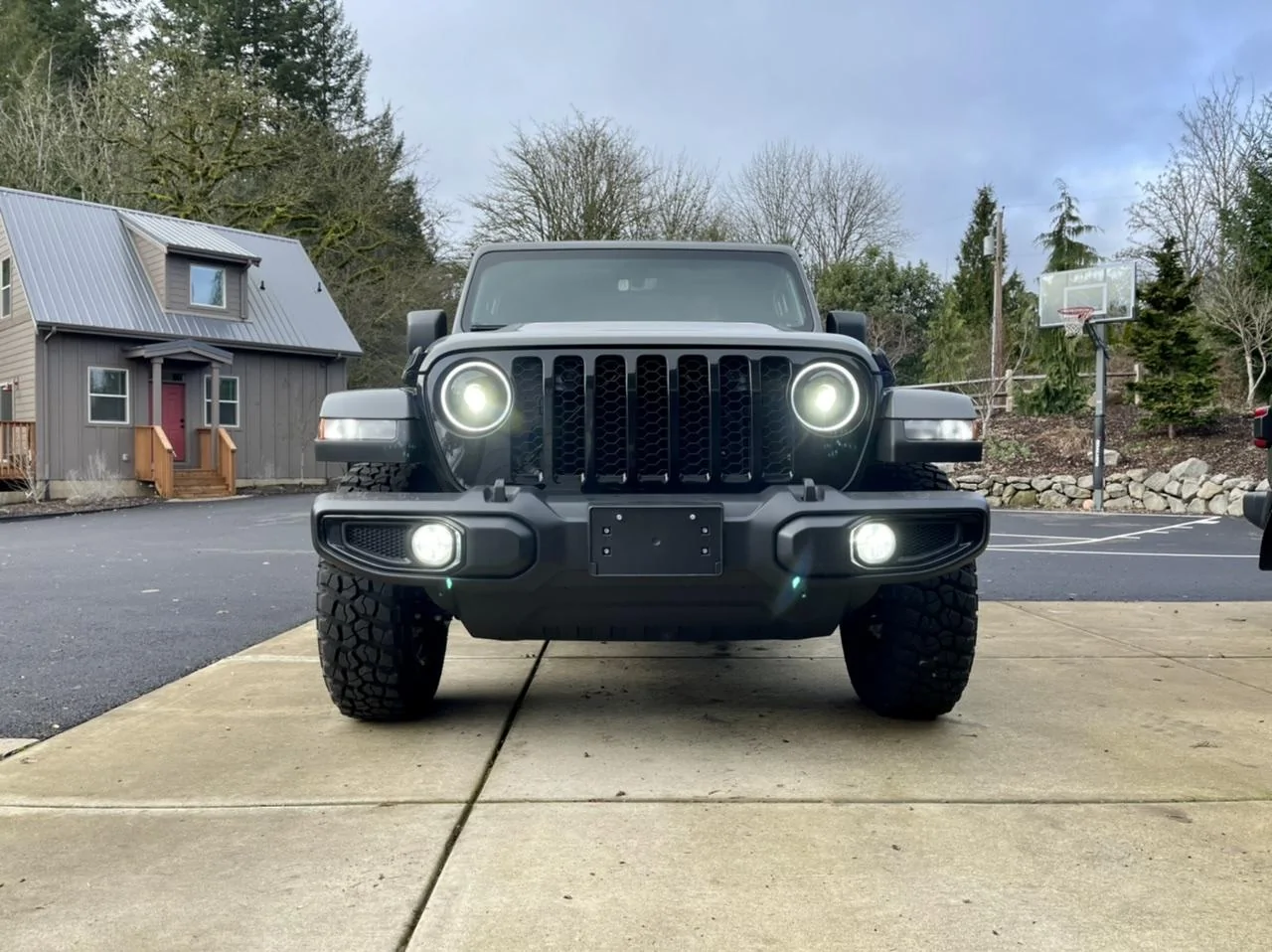

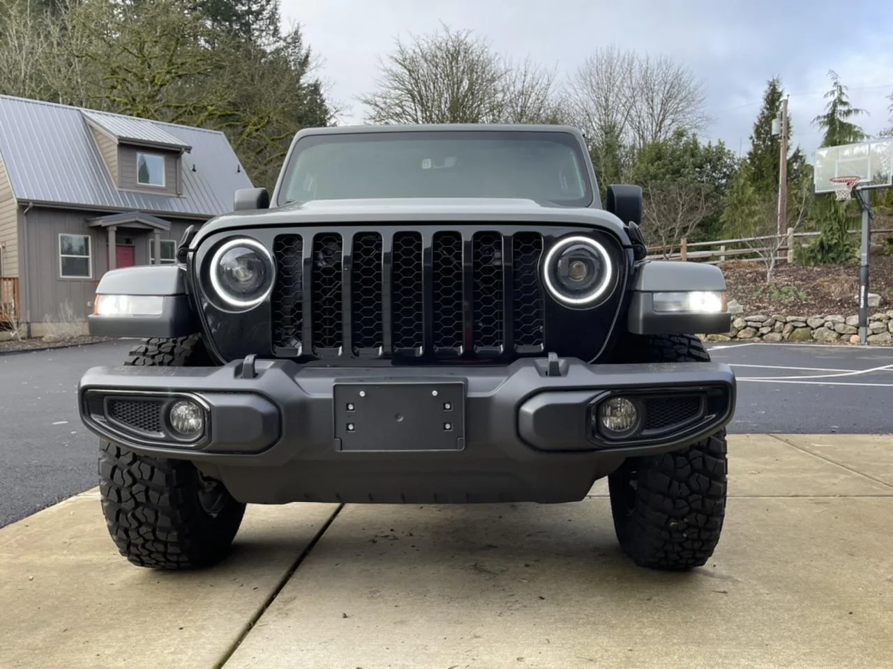

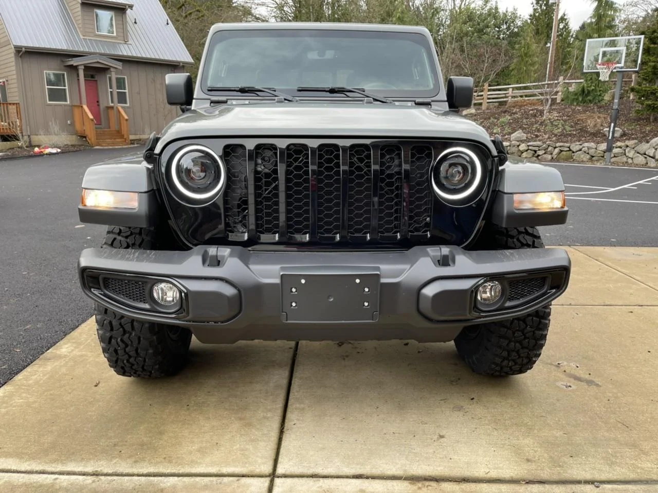

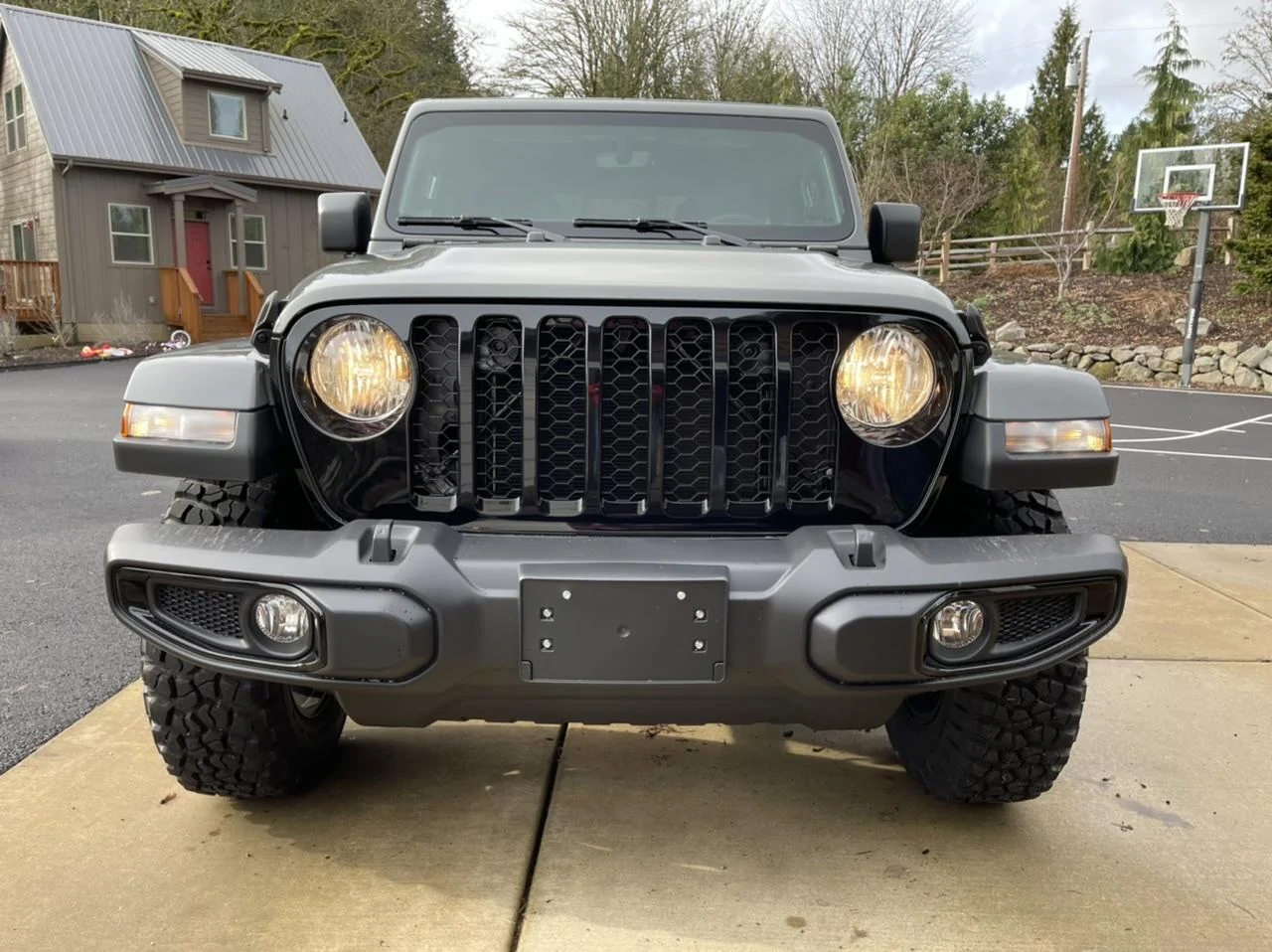

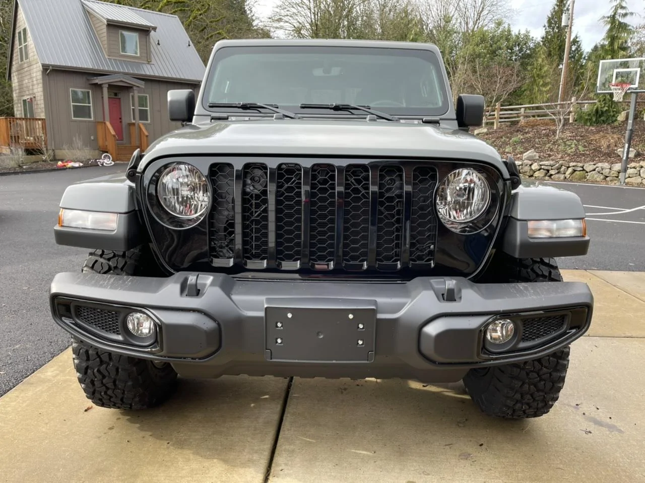

I just finished up the install of my new Oracle Oculus 9” LED Headlights. Went very smooth- just need to figure out the fogs, drls and turn signals. I’m EXTREMELY happy with the results. The look killer. I just need to see how much brighter the road is at night- I’m sure it will be quite a bit brighter 😂
Before:
Jeep Gladiator New Oracle Oculus 9” Headlight installation - need led bulb #s for DRL, Turn and Fog DDD1512E-2EDD-4894-AADE-7347BD39BD6E
Jeep Gladiator New Oracle Oculus 9” Headlight installation - need led bulb #s for DRL, Turn and Fog C94D1B83-4E52-4325-9CA3-4D3A36B574AC
After:
Jeep Gladiator New Oracle Oculus 9” Headlight installation - need led bulb #s for DRL, Turn and Fog E4AD3388-0DB1-4409-9A4E-4A2DF67FF679
Jeep Gladiator New Oracle Oculus 9” Headlight installation - need led bulb #s for DRL, Turn and Fog 997F4BDB-0DC5-42D1-8A69-FEAE24AF2569

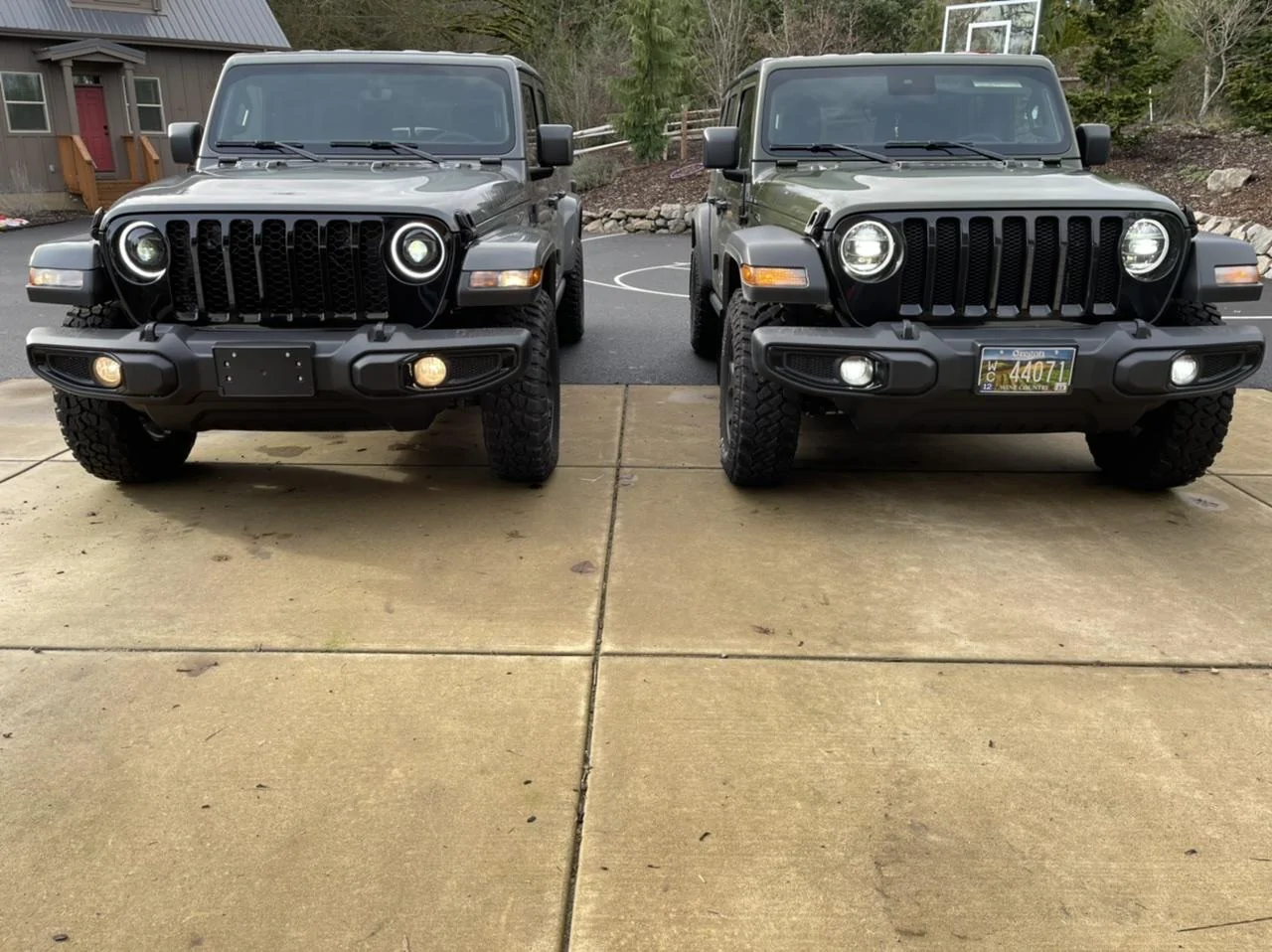

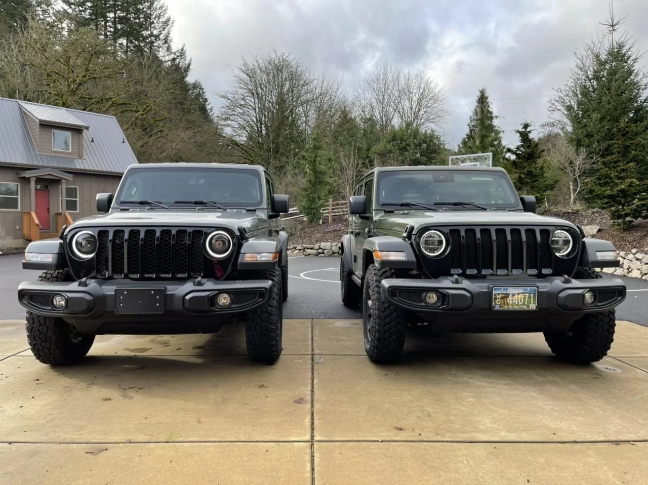

Next to my Wife’s JL with Factory LED’s:
Jeep Gladiator New Oracle Oculus 9” Headlight installation - need led bulb #s for DRL, Turn and Fog E610E3DF-E29F-459F-AD9C-AC8C62FE8D29
Jeep Gladiator New Oracle Oculus 9” Headlight installation - need led bulb #s for DRL, Turn and Fog 0D3F41BF-9251-47F7-9EC8-FCE01D0B28D2

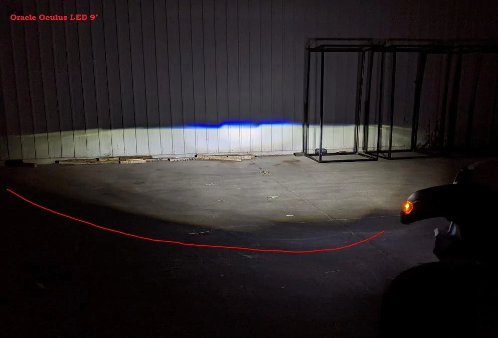

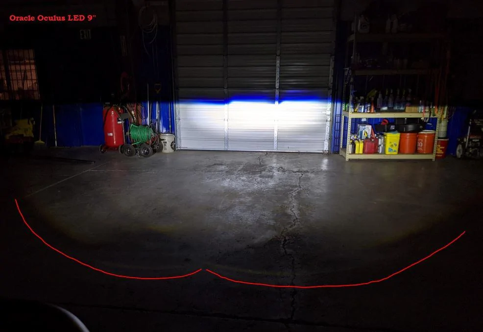

are those the headlights or just the fogs...seems kinda dim for led headlights to me
Just the headlights... far from dim though. These pics are from my cell phone and I don't know how to properly set exposure for this type of situation.
