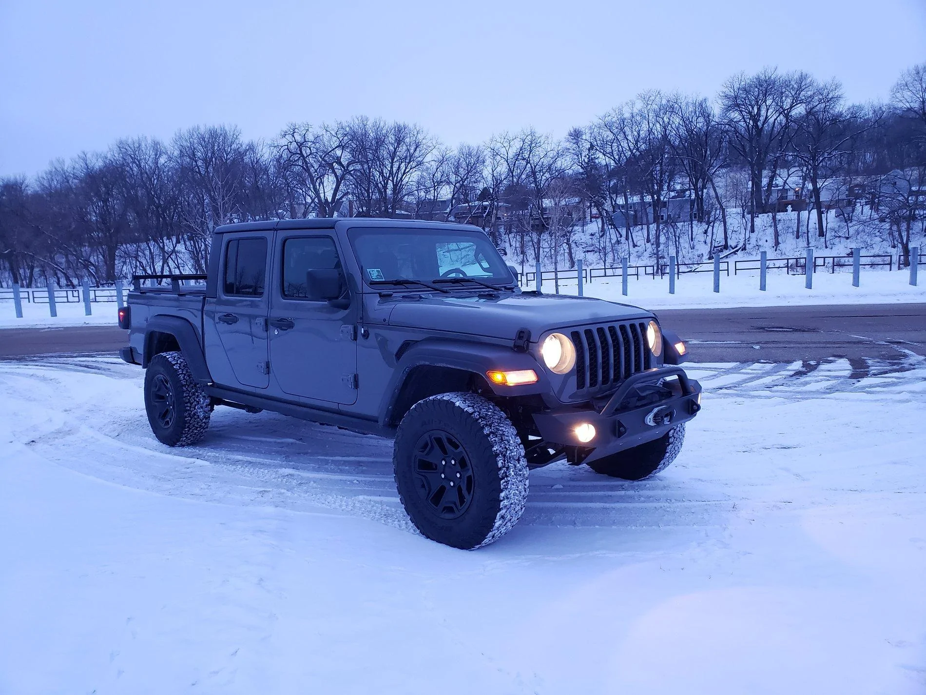

Here's 285/70/17 on a Sport S with Rubicon springs & shocks + 1" teraflex spacer. I put the spacer on because my bumper/winch combo weighted the front down .5"
I really like the way my truck sits now but would've gone with 285/75/17 if I hadn't gotten such a good deal on the tires I put on.
Not the best photo but you get the idea

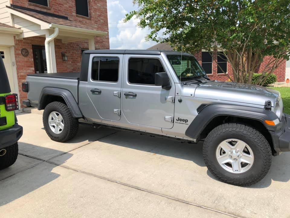

Stock Sport S (max tow) with 285 75 R17 on stock wheels.

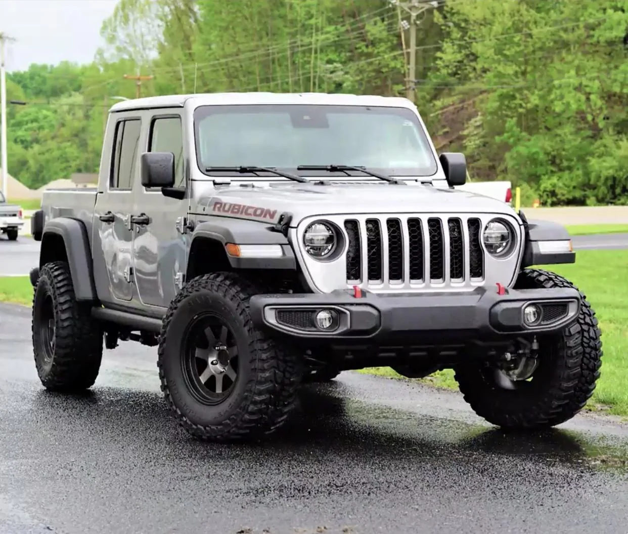

295/70/17 = 34x12 on a stocker top
With 1.5” leveling kit bottom
