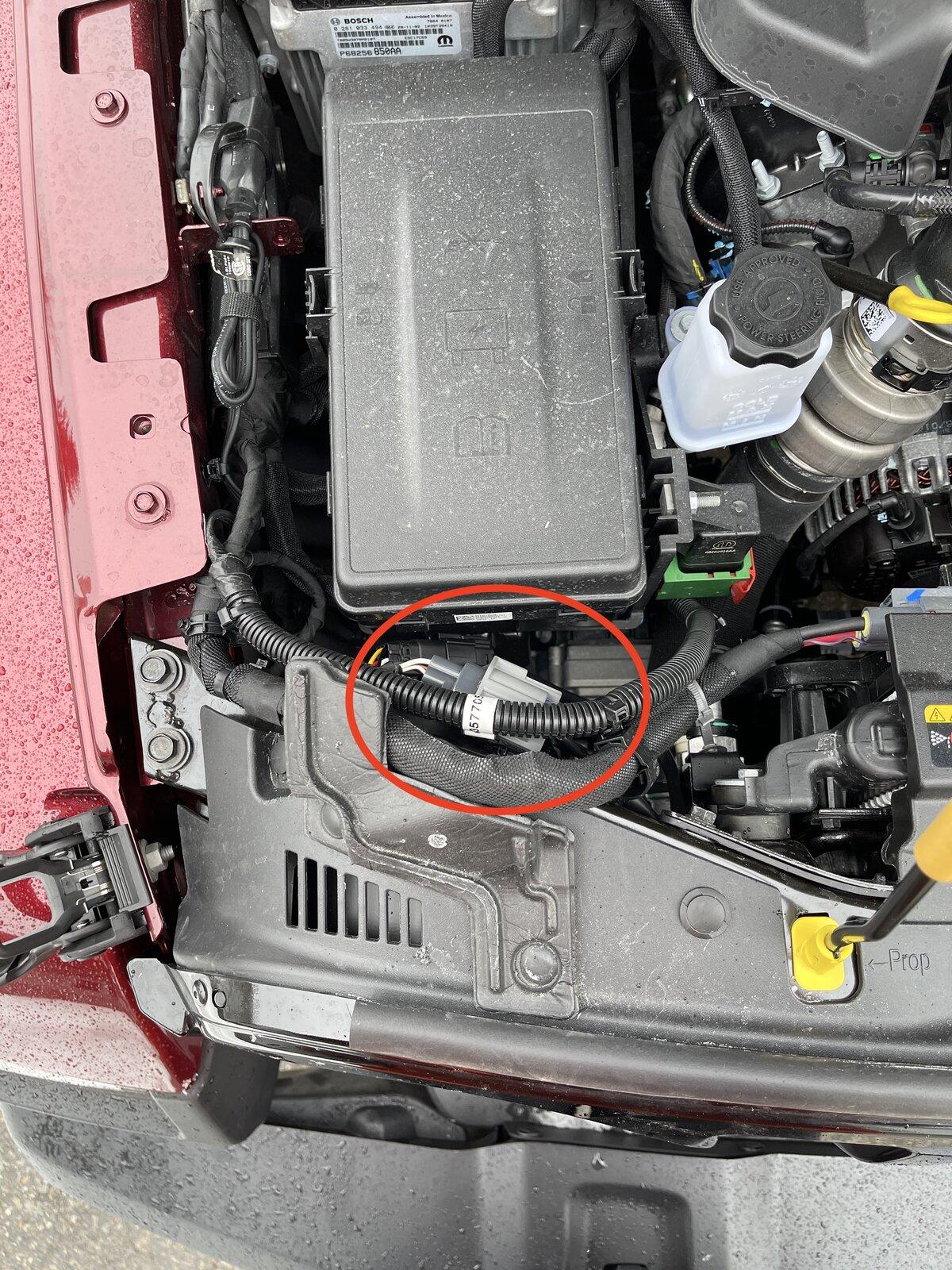

I had all 4 wires going to the driver side headlight, only had 3 on the passenger side. BUT I was able to replace a 16" harness that had the 3 wires to one with 4 (since 4 wires were coming in, 3 wires going to the headlight).
Jeep Gladiator New to the Forum! MOPAR LED Lighting Conversion Question IMG_0091.JPG
The connector circled goes to the headlight. the portion on the left side had the 4 wires, portion on the right was 16" that only had three wires and plugged into the headlight on the other side. Had a guy on eBay create a replacement harness for a factory look and it was plug and play.

I think you mean 4 wires.
🤦‍♂️ You are correct....I have slept since then😂 I was thinking pin #5 in the plug. Looks very nice! I am glad that I didn’t have to worry about anything like that though. Like the color also🥰
