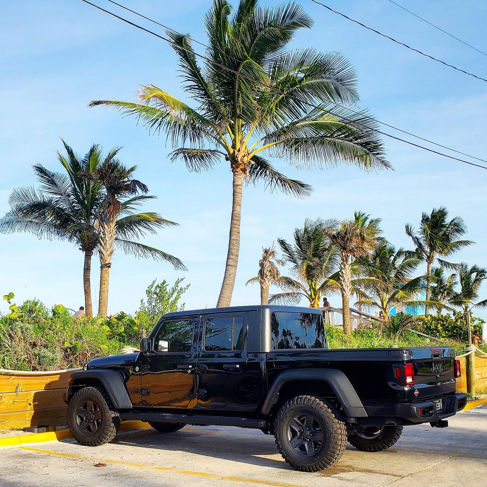

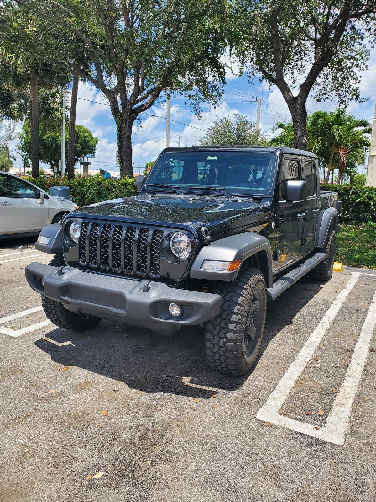

Do what i did i think it looks 100 times better. I used same wheels and got mud terrain 285 70 17s. Still drives grest and looks good enough... i would love to have done 35s and a 3.5 in lift but mine is leased and not sure if will end uñ keeping, just couldnt stand the look of the original wheel tire set up... oh also i plastidipped them myself
