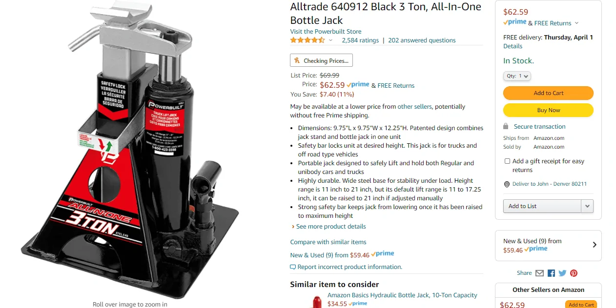

AEV jack base + OEM jack = bare minimum
OR
I personally own this one. Lots of adjustability as well as safety of a jack stand.
Exactly....I have no idea on earth why anyone would spend $75 for that hunk of AEV plastic....to put it under a jack worth maybe $10. The stock jack is a very light duty jack intended only for use on perfectly flat terrain...to change a flat or two during the life of the vehicle. There are endless threads and videos on yotube of people having that thing turn into a taco when they either used it on slightly uneven terrain, or with a heavy built out rig, or after using it multiple times. You'd be much better off with a unit like the above or even a quality standard bottle jack and some scrap wood to make a stable base.

I bought the AEV block and am disappointed in the jack supporting ability. I wish I had kept the box so I could return it. It will stay in the truck as an overpriced wheel chock.
I was looking at the Alltrade jacks today before I saw this thread. I will be ordering some thing like that soon. Easier to store than a large capacity floor jack and lighter.
