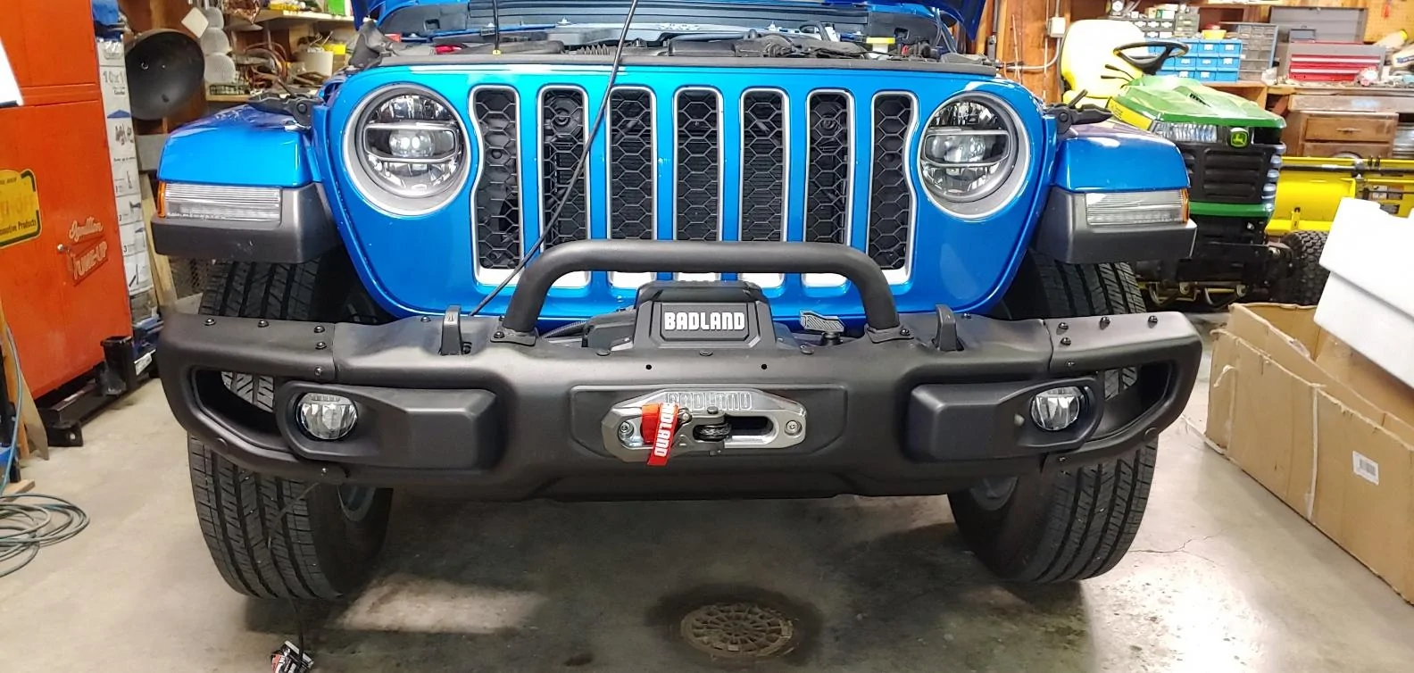

If you already have a winch ready modular front bumper, all you need is mounting plate. But not all rubi's come up with. Mine didnt and I had to replace mine with an aftermarket bumper to accommodate my x20 12k winch. Fun project regardless, good luck!
180
29,526
35,135
Jeep Gladiator Newbie to winches 20201017_135829_HDR
Cutoff switch that comes with that winch - all the wiring you need and then some. You can even relocate the electronics off the top of the winch if you want to lower the profile even more.
