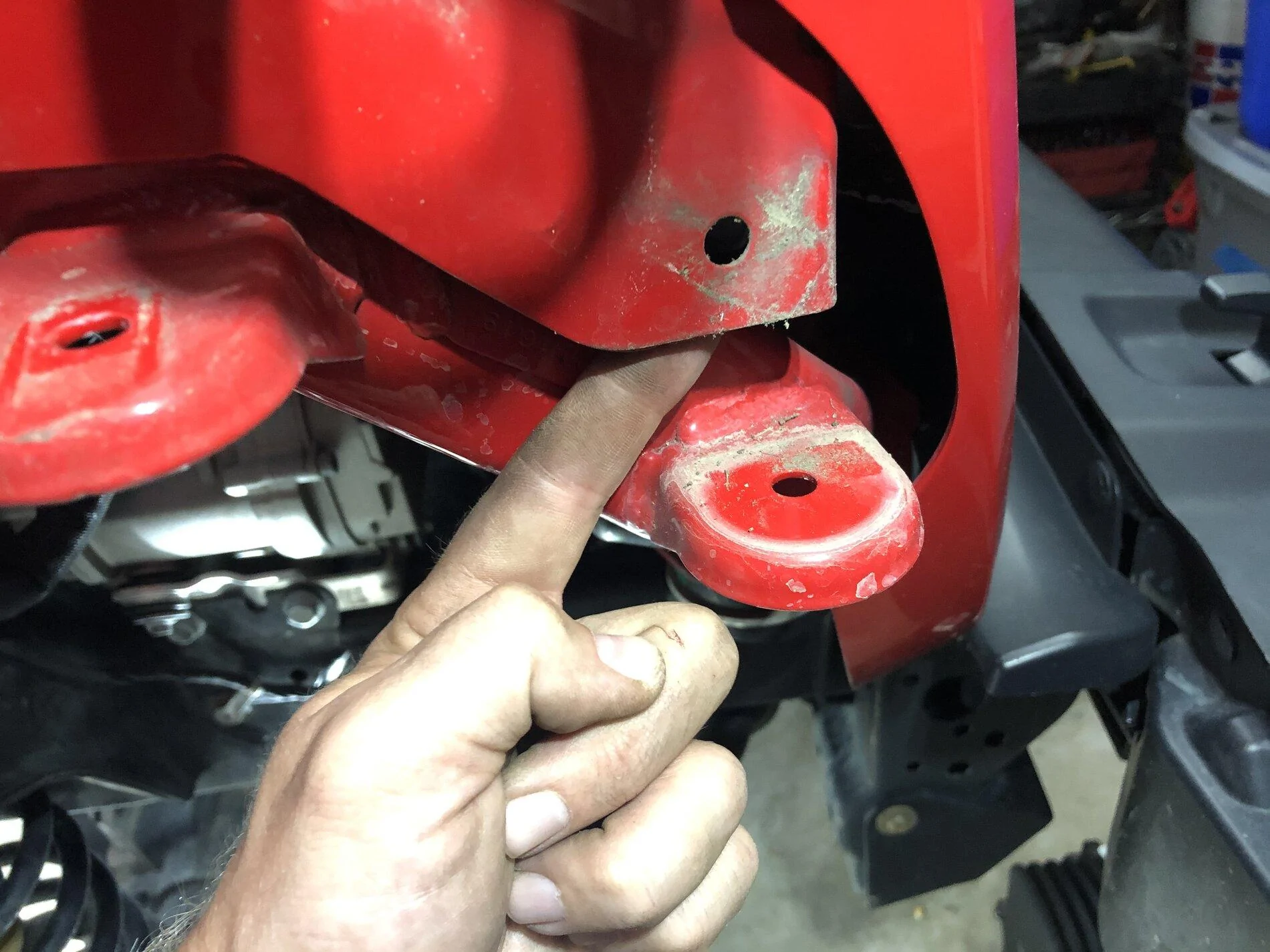

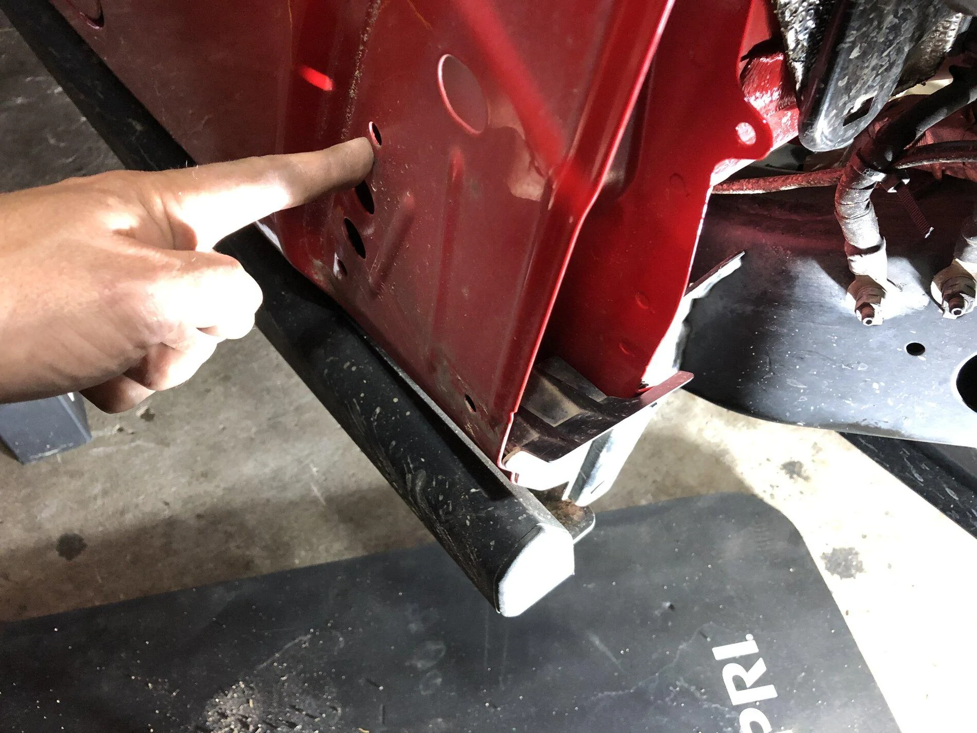

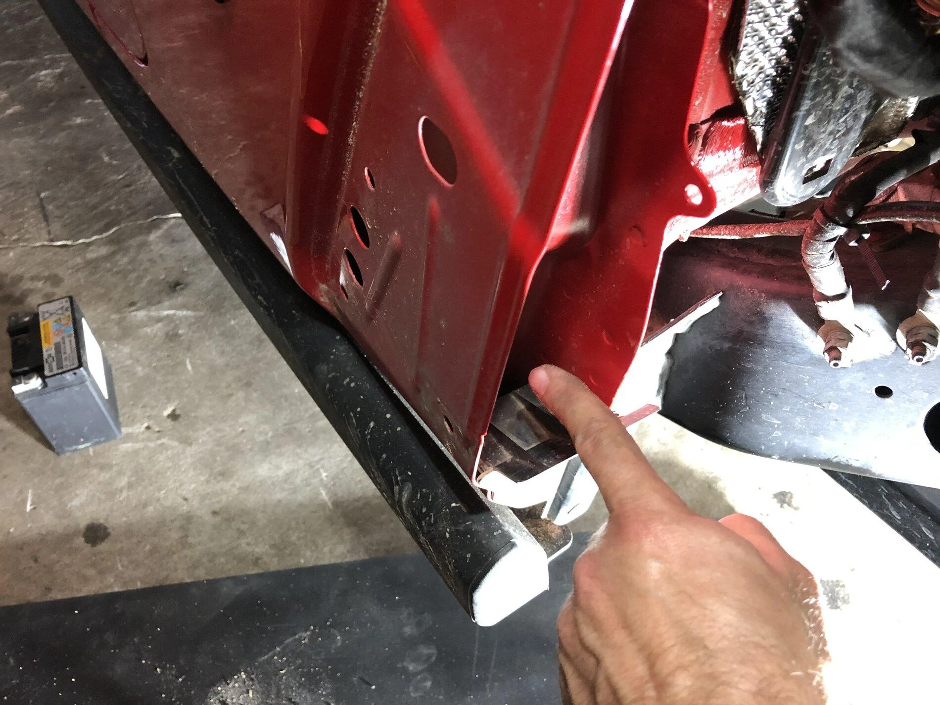

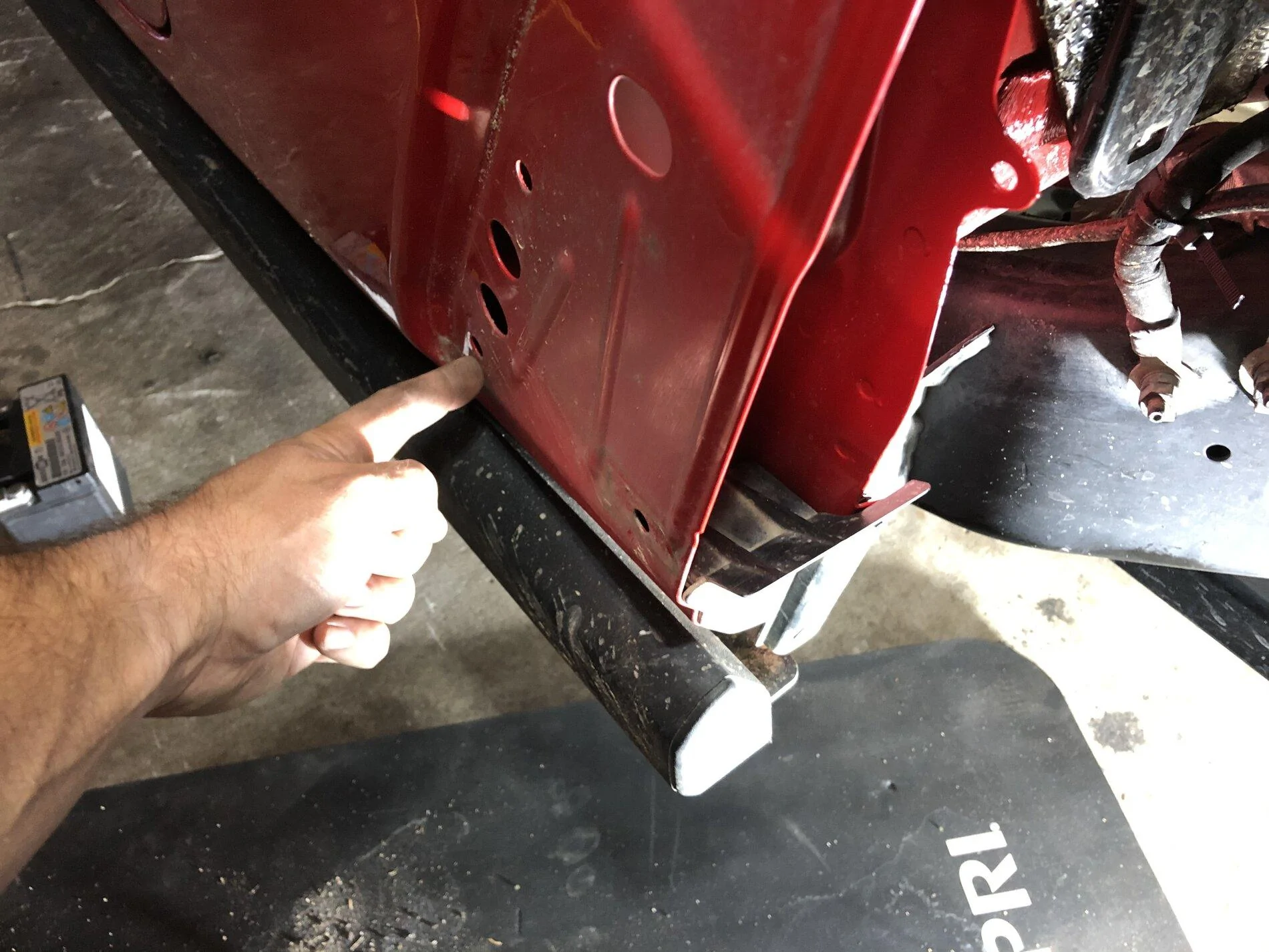

I just had to replace my aux battery for the ess system, so i watched the videos and read the threads. Some are saying that breaking fender clips is inevitable, and that you start by yanking at the back bottom edge of the fender.

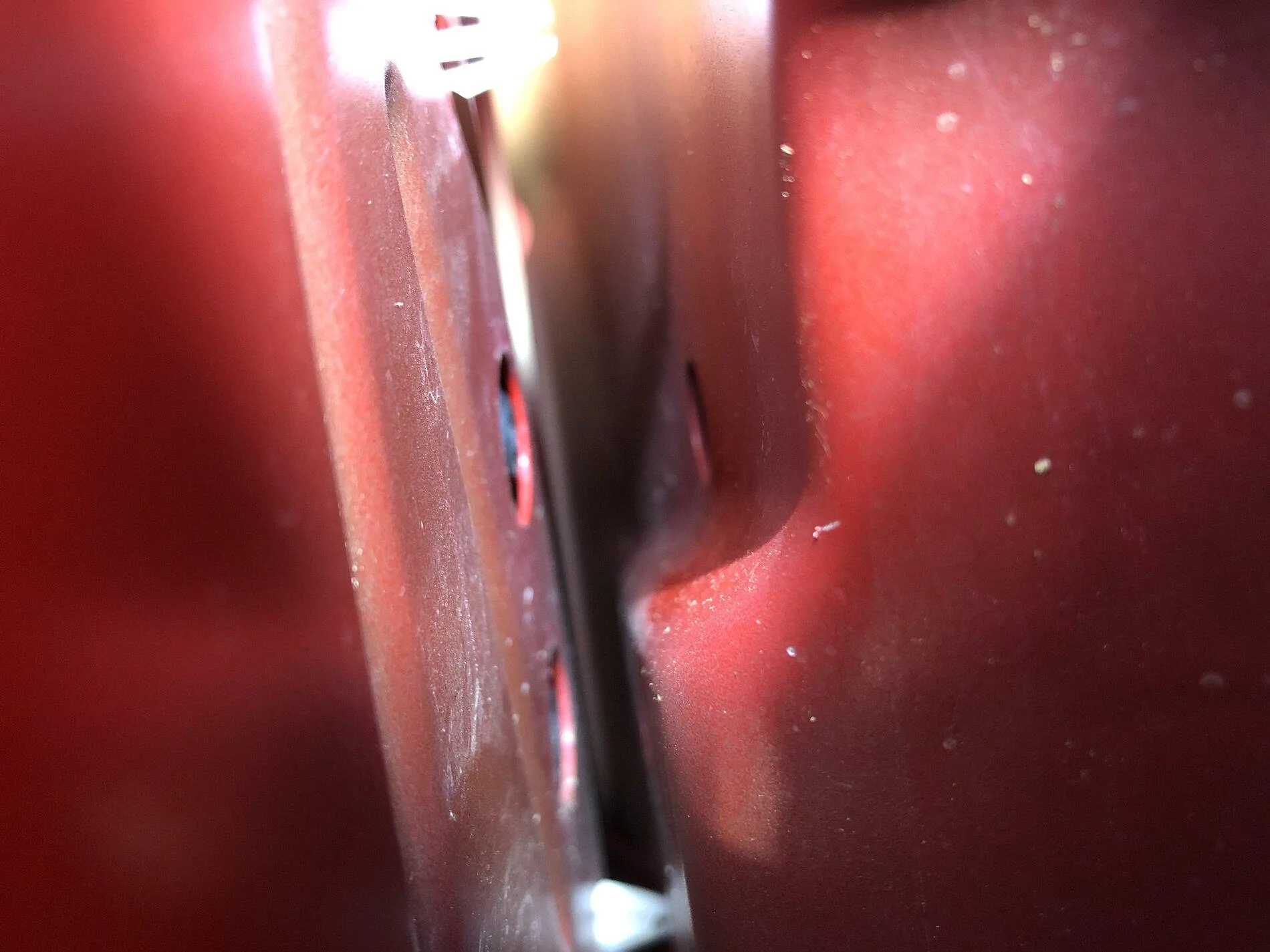

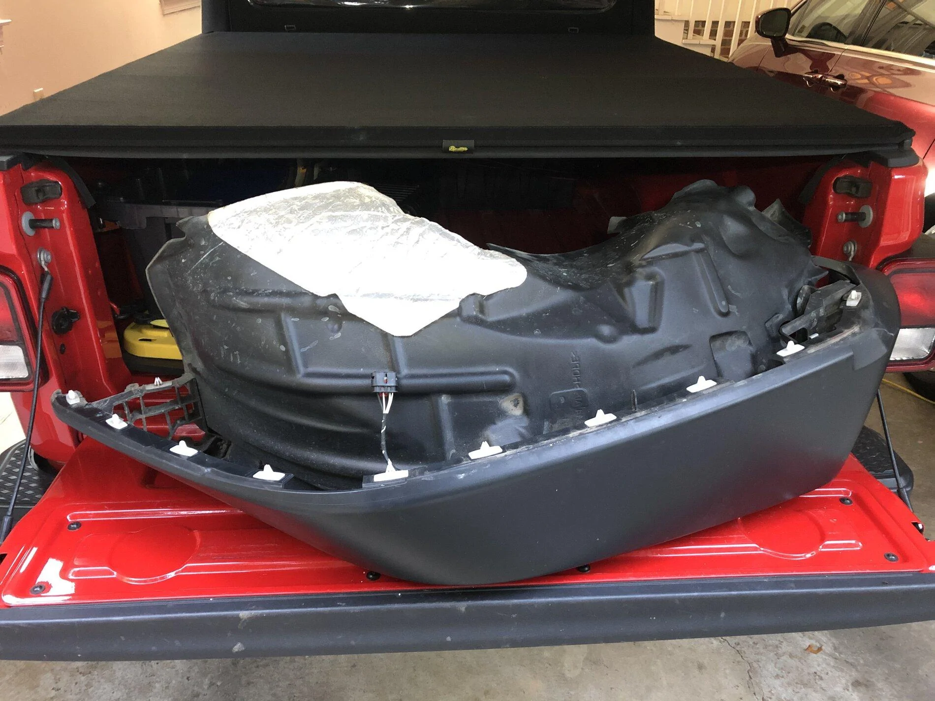

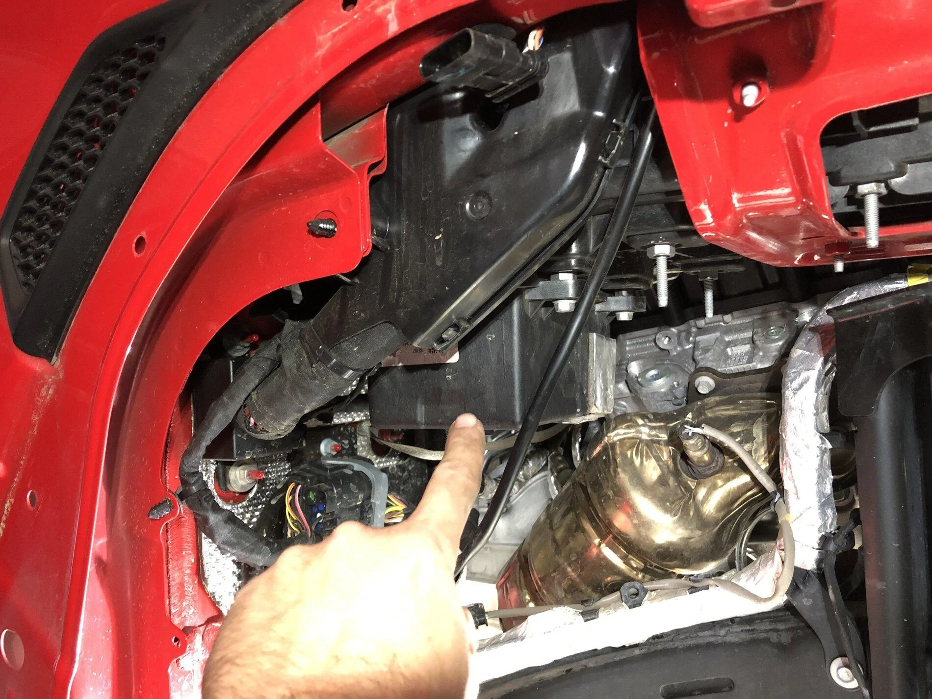

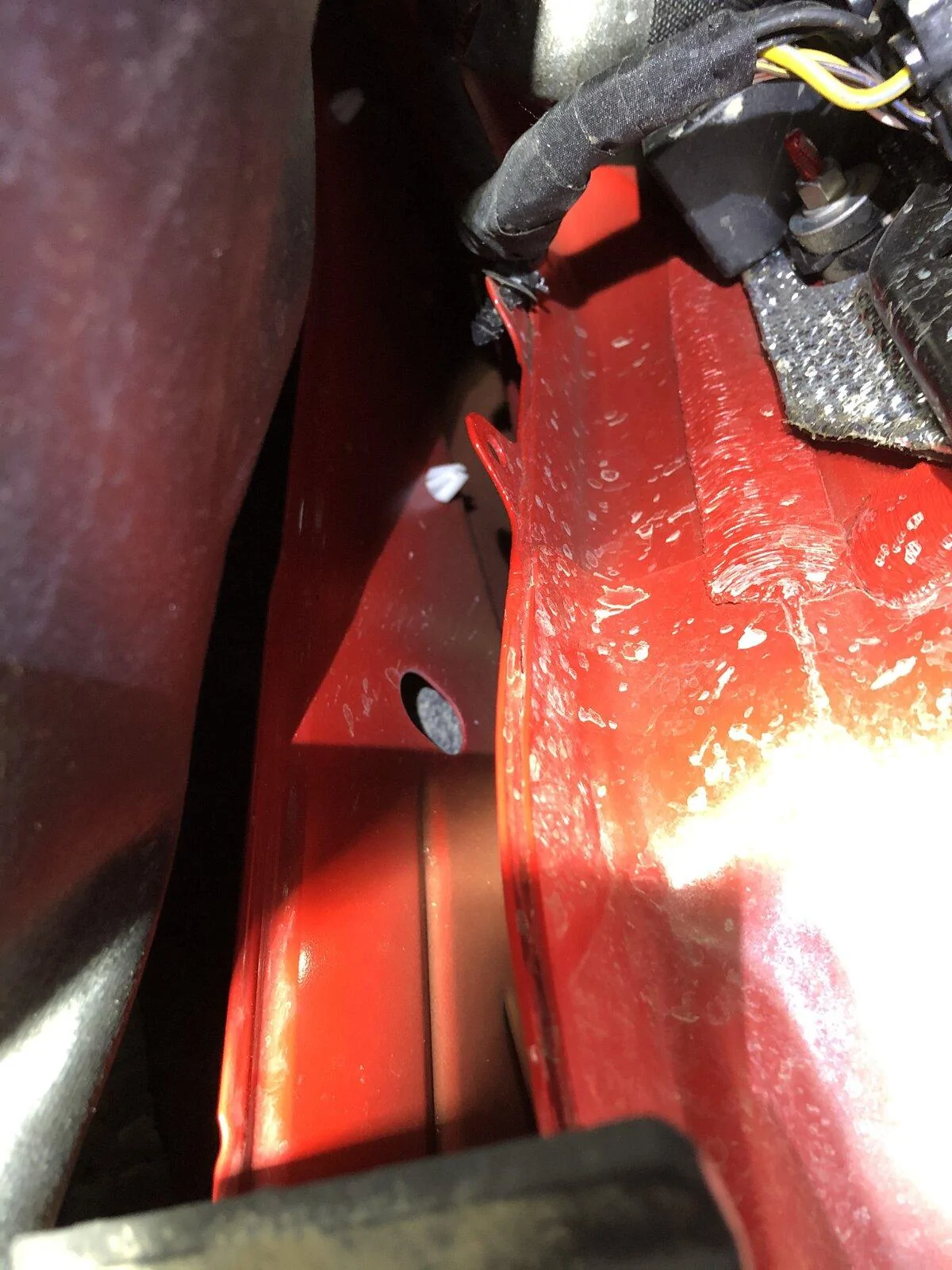

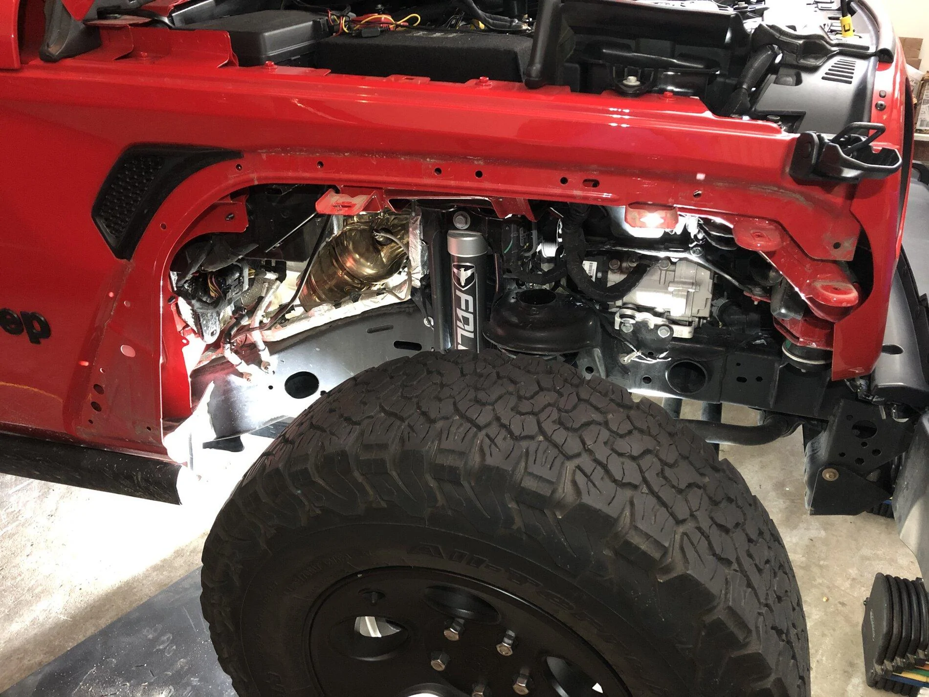

I found that you can get to the back of these clips with needle-nose pliers so that they slide right out with no yanking. As soon as you get these first few started, you can pull the fender out slightly and reach the back of the ones on the top of the fender. A little tight as you work toward the front, but do-able with some patience. Not one broken clip this way.
For the battery studs, a 4mm socket works fine. These aren't crazy tight and a 6-point 4mm didn't damage them
It's a pretty reasonable DIY job for those that are somewhat handy and don't love taking their jeep to the dealer. Pulling the fender looks worse than it is. Happy jeepin'!

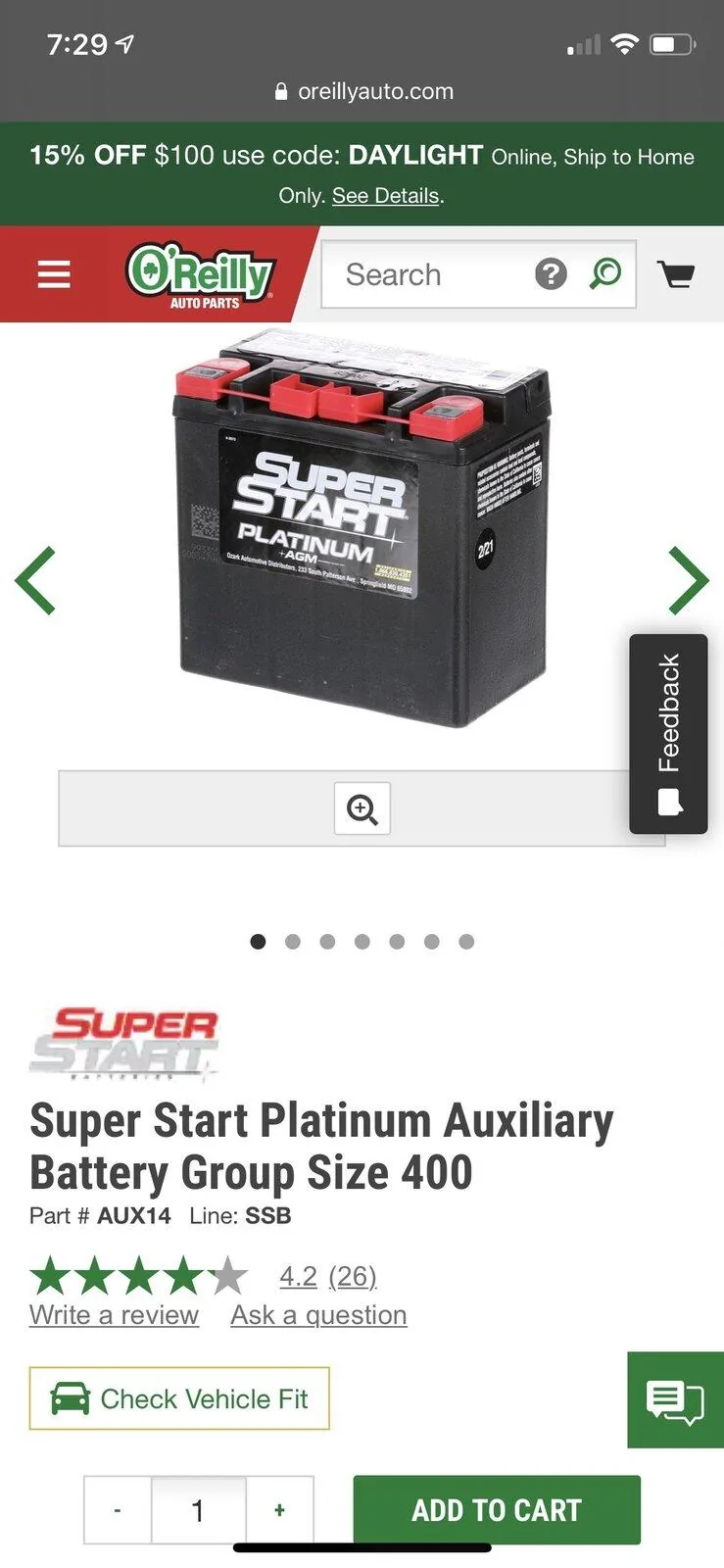

Good to hear as I'm sure most of us will eventually be doing this. So patience is the key! Which aux battery did you end up going with?

Yep! Not bad. I went with the Super Start Platinum from Oreilly

i dont understand why you removed the whole fender. You could have just removed the inner liner instead and just replaced the couple plastic rivets? Seems much easier. Only thinking here.

The fender comes off in 10 min without needing to replace anything. It's really quick - this is more of a "don't yank on your fender when removing it" post to avoid ordering fender clips
