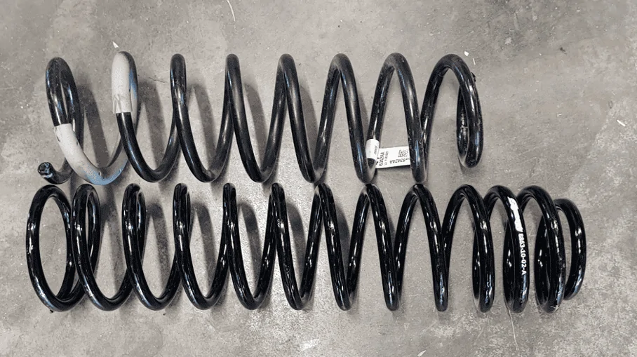

Although the truck only sits 1.5" above normal up front, the Synergy springs are LONG or tall springs, so they'd likely take the truck up higher on a rebound or good bounce so I guess need to look at that.
I'm running the -20 or the 2" lift springs (2" on 4 door)
So the extended length would be around 21" compared to the stock overland spring which is pretty long anyway.

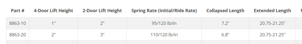

I corresponded with Teraflex the other day to get some unsprung coil spring lengths to check for fatigue. The unsprung length of their 4.5" spring is 24". But... The unsprung length of their 3.5" spring is... also 24".

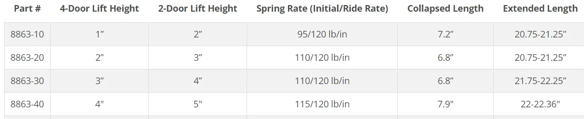

Here's another example like your Teraflex example -
The 10s are 20.75 (left side) but so are the 20s.
Compare the 3" lift springs to the 1" lift springs and they are only 1" apart in length.
Rate is the difference - higher rate would hold the truck up even if the spring wasn't longer.
The extended length would matter at full articulation when one side droops as far as it can - don't want the spring falling out. So it would seem to me that the shock should stop the axle from drooping so far that things can break or come apart.

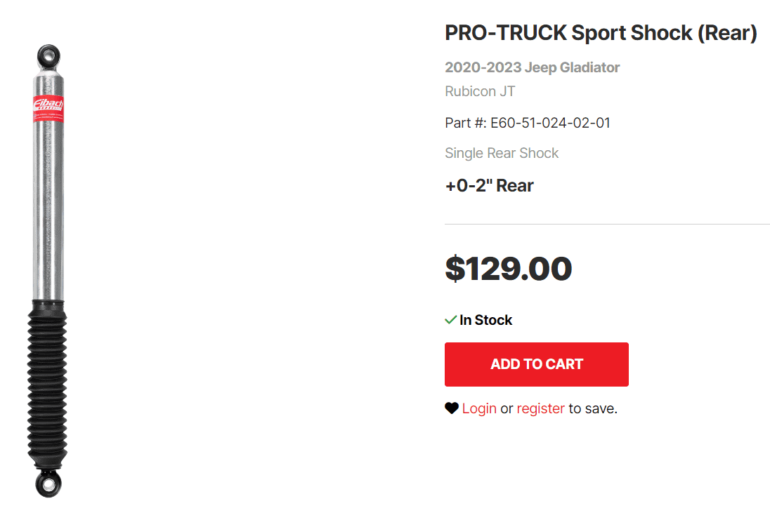

Anyway - trying to order rear shocks for my OVERLAND JT.
I stress the key word- "Overland" on purpose because Northridge, and others, say these shock "do not fit your Gladiator Overland".
Even their own site says "Rubicon".
Has anyone here used these Eibach shocks, this exact part number, on an Overland? (or any Gladiator other than Rubicon?)
https://eibach.com/product/E60-51-024-02-01?epsid=2228

I was just wondering about length, etc. on an Overland because they are advertised for Rubicon and other sellers say "will not fit Overland" or similar words. WEIRD because the fitment is otherwise the same, and I can't imagine length would be an issue.
So it looks like Monday I contact them and get a pair ordered for the rear........
