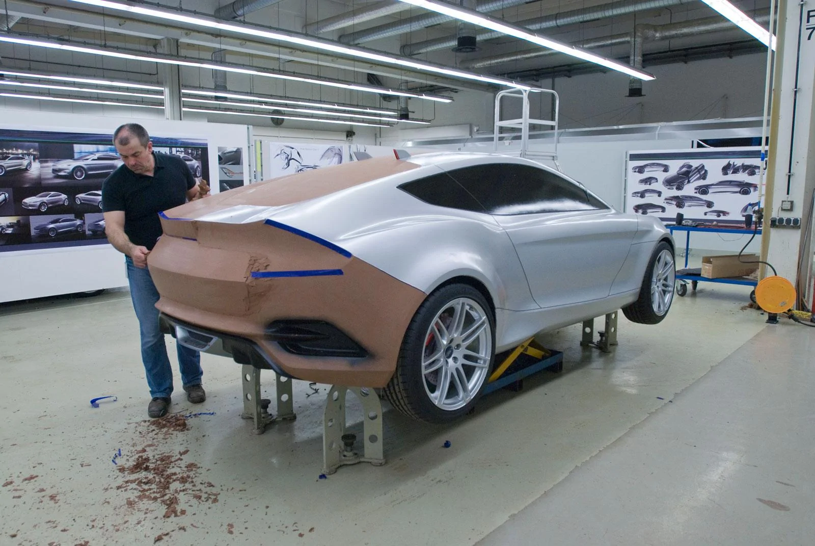

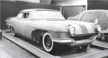

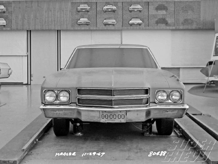

Non running concepts or clay models are often displayed this way to support the vehicle, every car company does this:
Yup - the models done for the AMXII and III were pretty cool. They were even actually built in the end - a few, anyway.
There were multiple concepts versions made but they didn't have the cash to go with it.
The board poo-poo'd the idea of a 4 wheel drive car when first presented - saying no one would ever want or buy a 4 wheel drive car?? It would never sell, silly idea, and with the fuel crisis forget it.

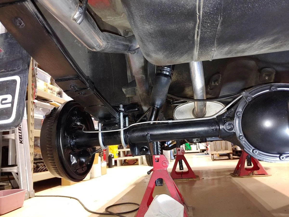

It was very simple - flip the rear differential under the leaf springs to boost the height of the rear, new steering knuckle that was longer (taller) so they could use existing upper suspension (same upper control arms, same upper ball joints, same design springs just different rates) and simply design a different cross-member and lower control arms (boxed and swept back) to handle the load/stress and fill the wheel opening gaps so it didn't look silly with flares.

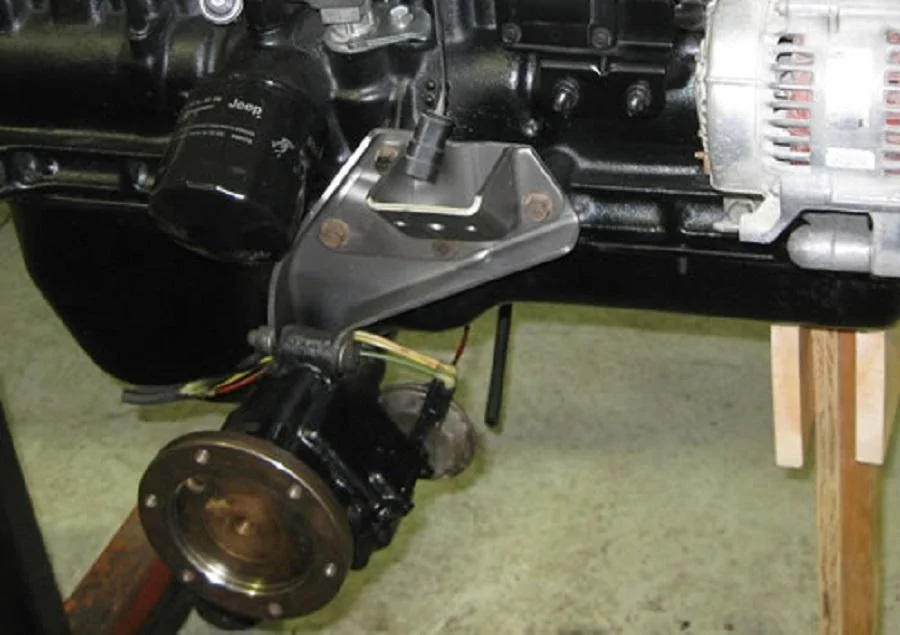

They modified the block of the 258 to hold a pinion brace for the front diff - a mod that MOPAR left in place for years.

My guess is that it's that way so people can see UNDER it and see how they did things - NOT because things won't clear. Heck they already had all of the suspension and drivetrain for the Eagle and they owned Jeep for several years by then (AMC also created the modern SUV in the unibody Jeep Cherokee and had the Grand Cherokee on the board - it's why MOPAR bought AMC - Lee wanted that Grand Cherokee so bad he could taste it (and the engines they had on the drawing boards already which MOPAR used)
I guess I'm saying - what's the big deal - AMC already had everything necessary to make any of their vehicles 4 wheel drive with some minor mods. Swing the rear differential under the springs, the biggest thing with Pacer is that the front suspension was different from any other AMC, unique to Pacer, but still.......... and as far as on Jackstands - a display model, look under it - thus the angles. Some of us do that for show cars, mirrors and other stuff.

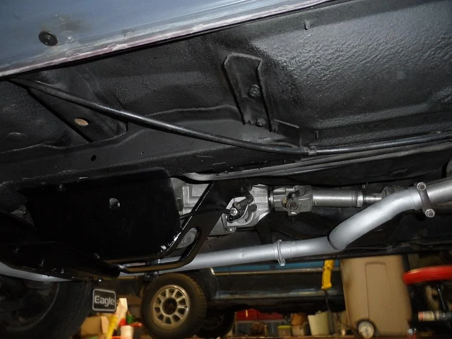

Underslung rear differential -
Jeep Gladiator No wonder AMC went out of business… tailpipe

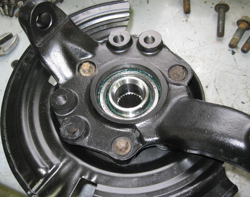

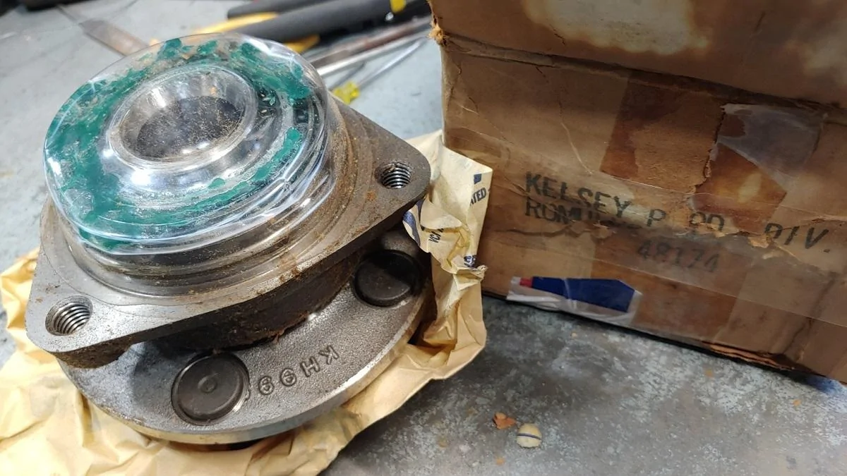

Eagle front hub (I have a pair of NOS hubs) -
Jeep Gladiator No wonder AMC went out of business… nos-hub

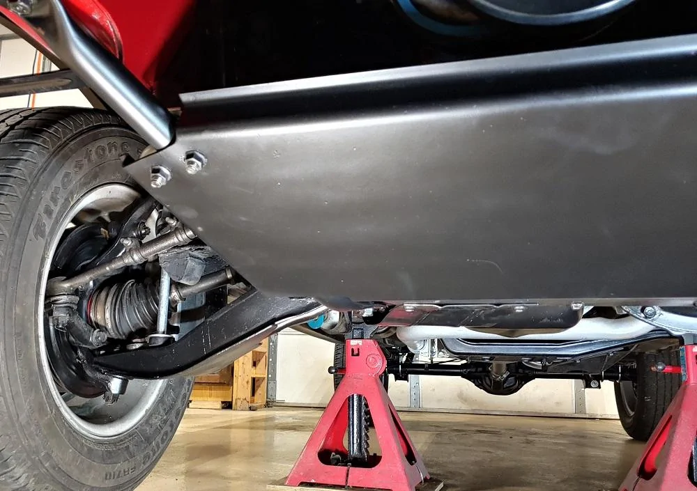

They used steel brackets to hold the front differential in place - cheap, quick, easy solution -
Jeep Gladiator No wonder AMC went out of business… sx4-jeep-engine-FAD

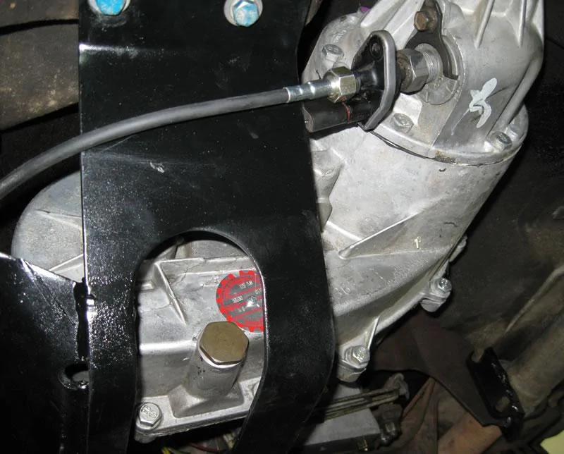

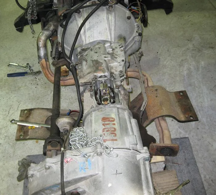

T5 transmission, below is a NOS (new old stock) New Process transfer case I bought still in the crate I installed into mine as the viscous coupling burst in my original transfer case at about 160,000 miles. I found one still in the crate. When that coupling went it was like an open differential between the front and rear axles.
They had to go hydraulic clutch because they packed a lot into the little car - no room for linkage to clear the front driveshaft, etc.

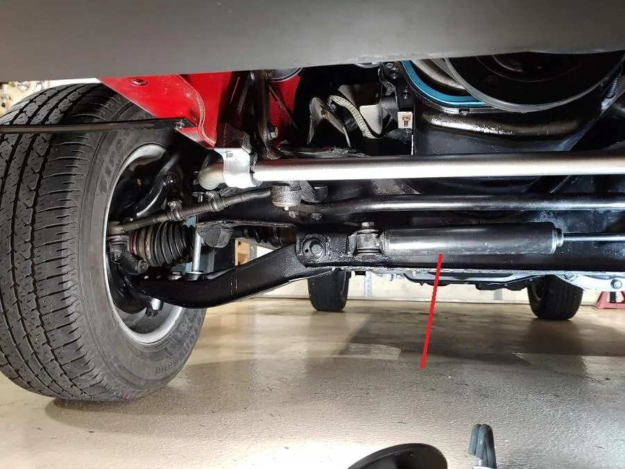

Better view of the front end - with of all things, a steering dampener.......
Jeep Gladiator No wonder AMC went out of business… steering-stabilizer-2
Jeep Gladiator No wonder AMC went out of business… sx4-060
Jeep Gladiator No wonder AMC went out of business… sx4-under_2389

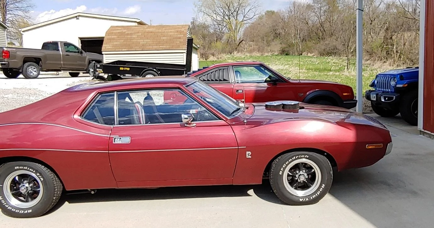

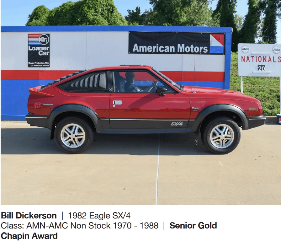

Non-stock class because of the silly Jeep engine I stuck in it.
Note it's the same basic car as the Spirit, the extra space in the wheel openings is filled with the "fender flares".
The Eagle sits 3" higher than the Concord or Spirit sat.
