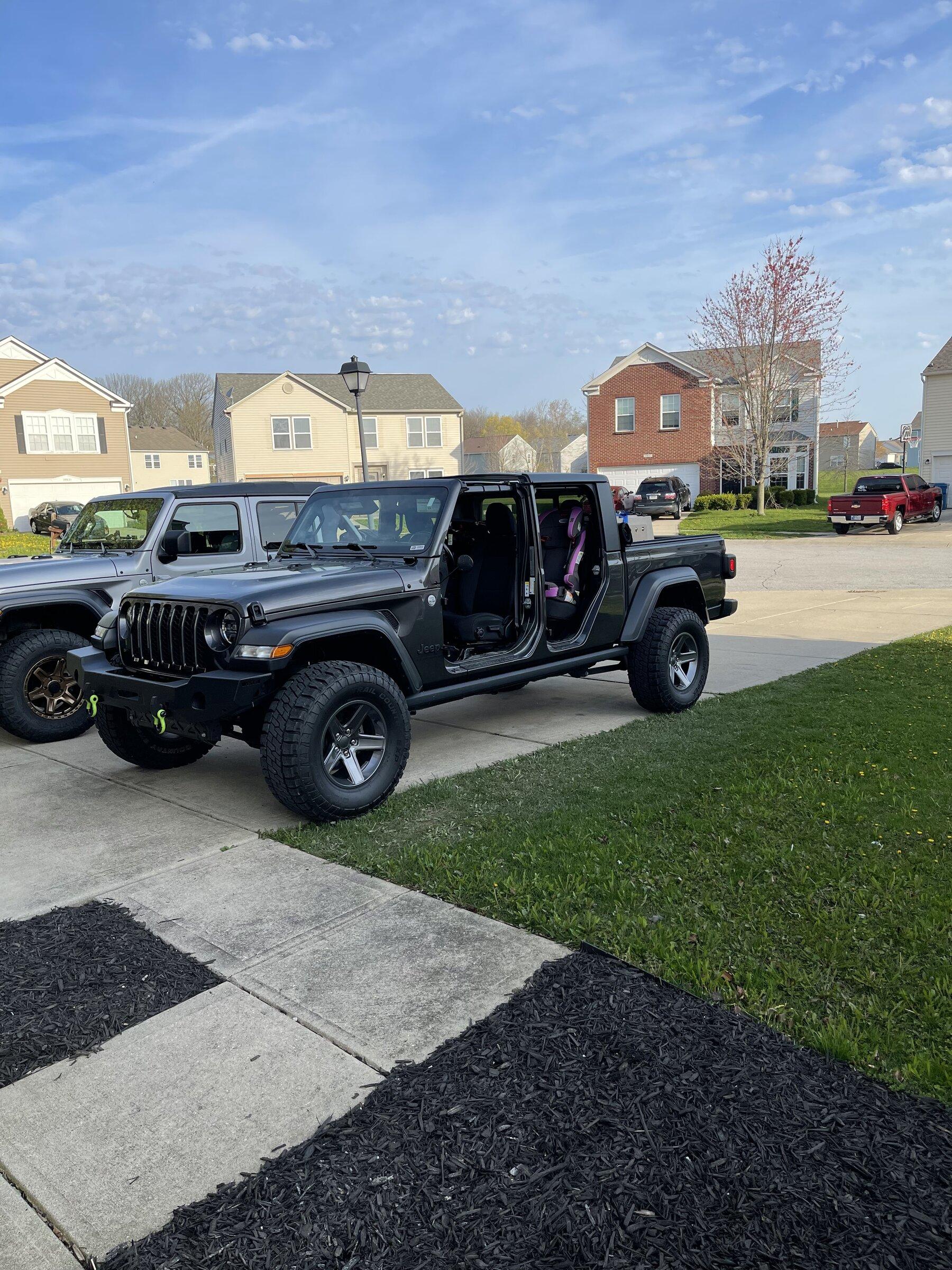

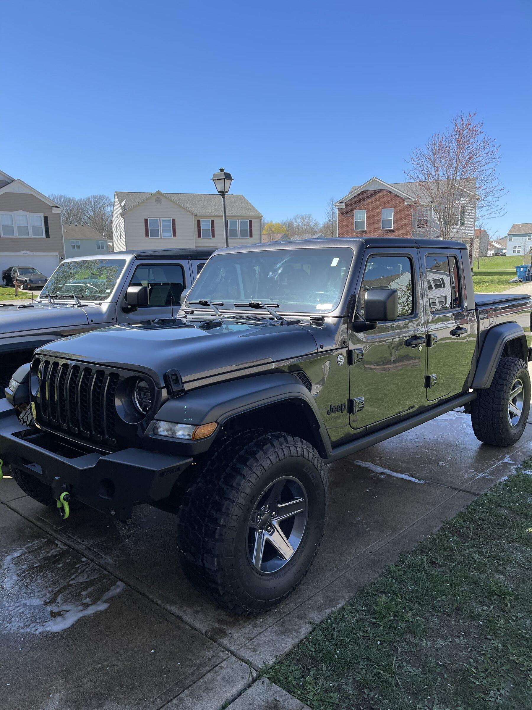

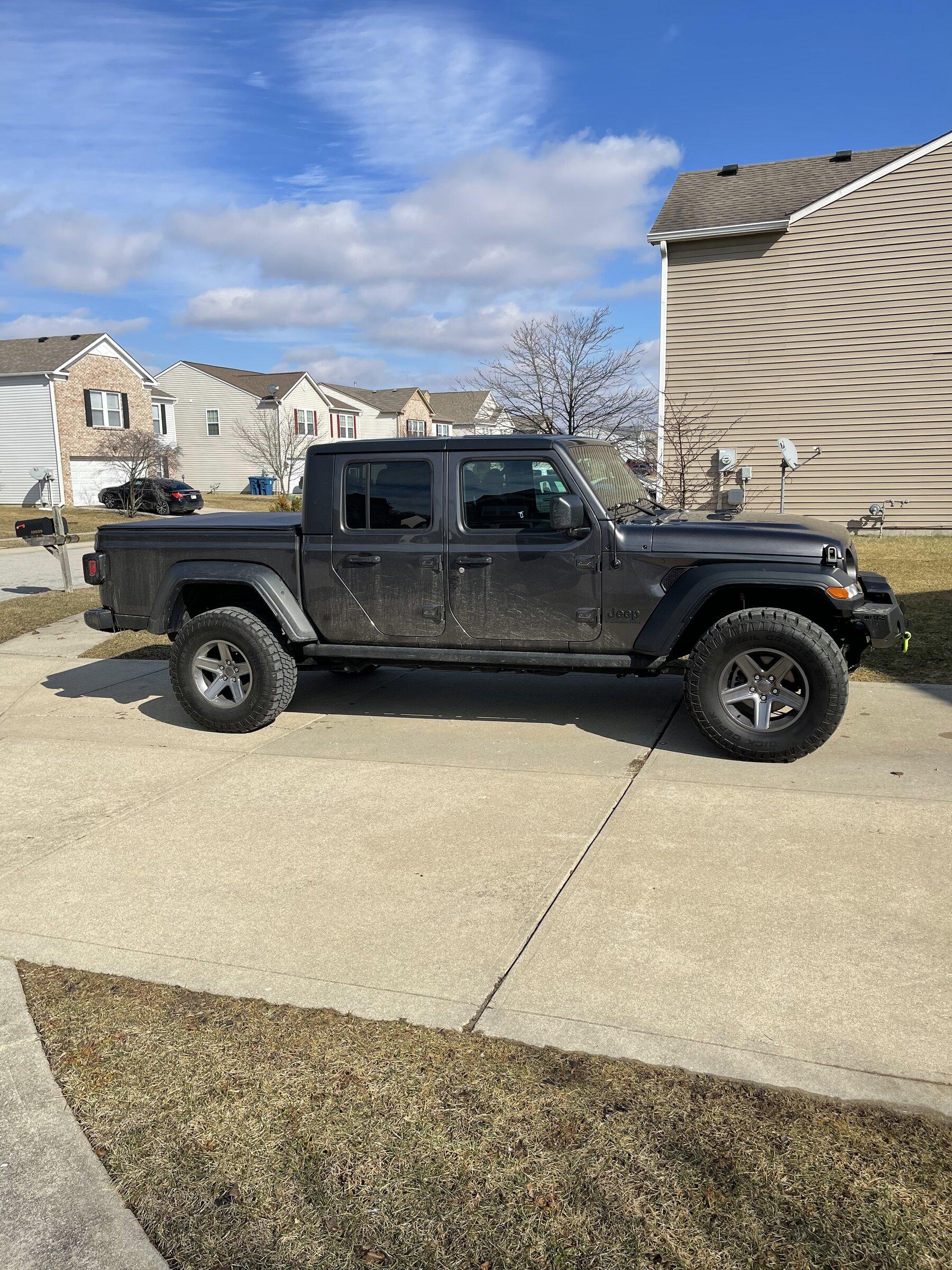

Jeep Gladiator Not another 2" lift thread; Advice appreciated 5AF3DA9A-9B7A-4EBF-BC08-2281568247E6
Oh and for front bump stops all you need is 4 hockey pucks, a 3/8 bolt and a drill.
Gotta say that is a good looking Jeep. Did you catch how much drop you had with the monster of a bumper? And I laughed loud enough to wake up the dog on the hockey puck idea. Gotta be a midwest thing....😏
Thanks! The Jeep dropped about a half inch with the bumper. I am normally a stubby bumper guy but got this Westin for 250 on Facebook. I want to find a cheap set of rubi take off front springs before I throw a winch in there.
The hockey puck thing is real. Been using them for the past 22 years of Jeeping. Adjustable in one inch increments and cheap. It’s so reliable you can buy the same thing for 70 dollars with a fancy name.😉
