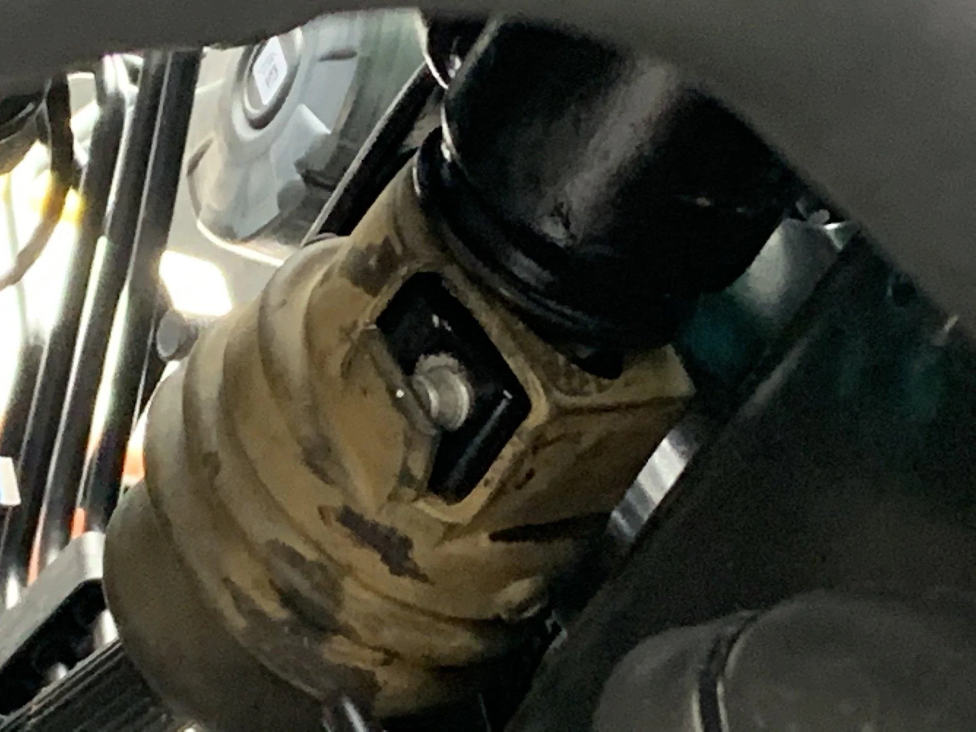

Jeep Gladiator Notchy Steering After TSB 08-074-20 86602B25-12B0-49DA-9A2F-E20B3A4FA76C
this guy? That’s the thread side
Looks like the other side of that. Mine was a 1/2 bolt and mine was actually tight.
appreciate the help though, I was hoping it was it!
Christopher
Jul 11, 2020
Dallas, Texas
Gladiator Overland 2020, Cherokee 1995, Cherokee 1993
Not that one, there is another one... maybe on the other side?
Ill take a pic tomorrow and upload it.
I dont think it was a 1/2, but I could be wrong.
Mine was VERY loose, and I was able to get a socket on it without taking anything off. Just a tight squeeze from above.
Heres a diagram of what im talking about.
https://parts.thomascdj.com/v-2020-...ering--steering-column-and-intermediate-shaft
On this diagram, its part number 10.
I hope this helps someone. Haha
