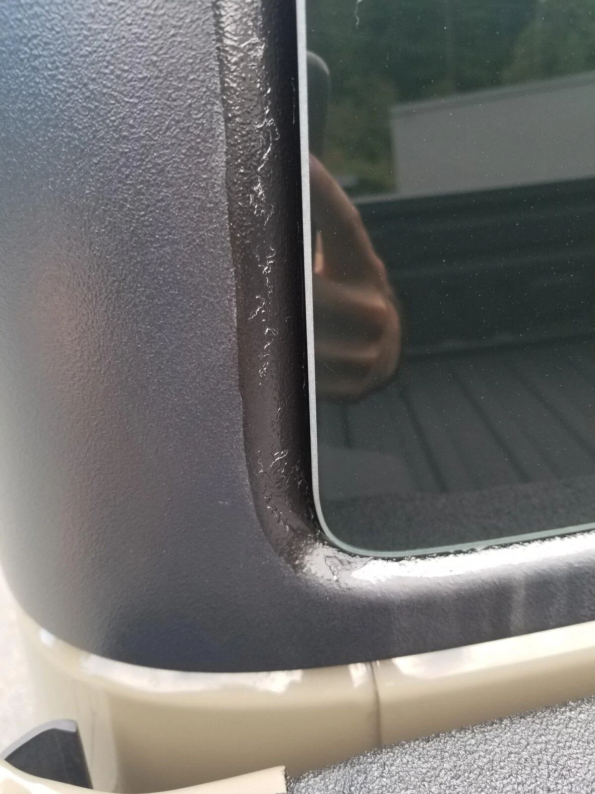

Well the dealers glass guy botched it..gouged and then used gloss black paint all around with hair in it. Frustration continues
Jeep Gladiator Odor after rain 20210918_100816
Geez.... I have a color matched hard top, so now I'm nervous. Mine goes in on Wednesday for the leak test.

Dealer is setting up my next appointment. They are telling me they will fix what the glass company's guy did. Also hinted he no longer works there.
