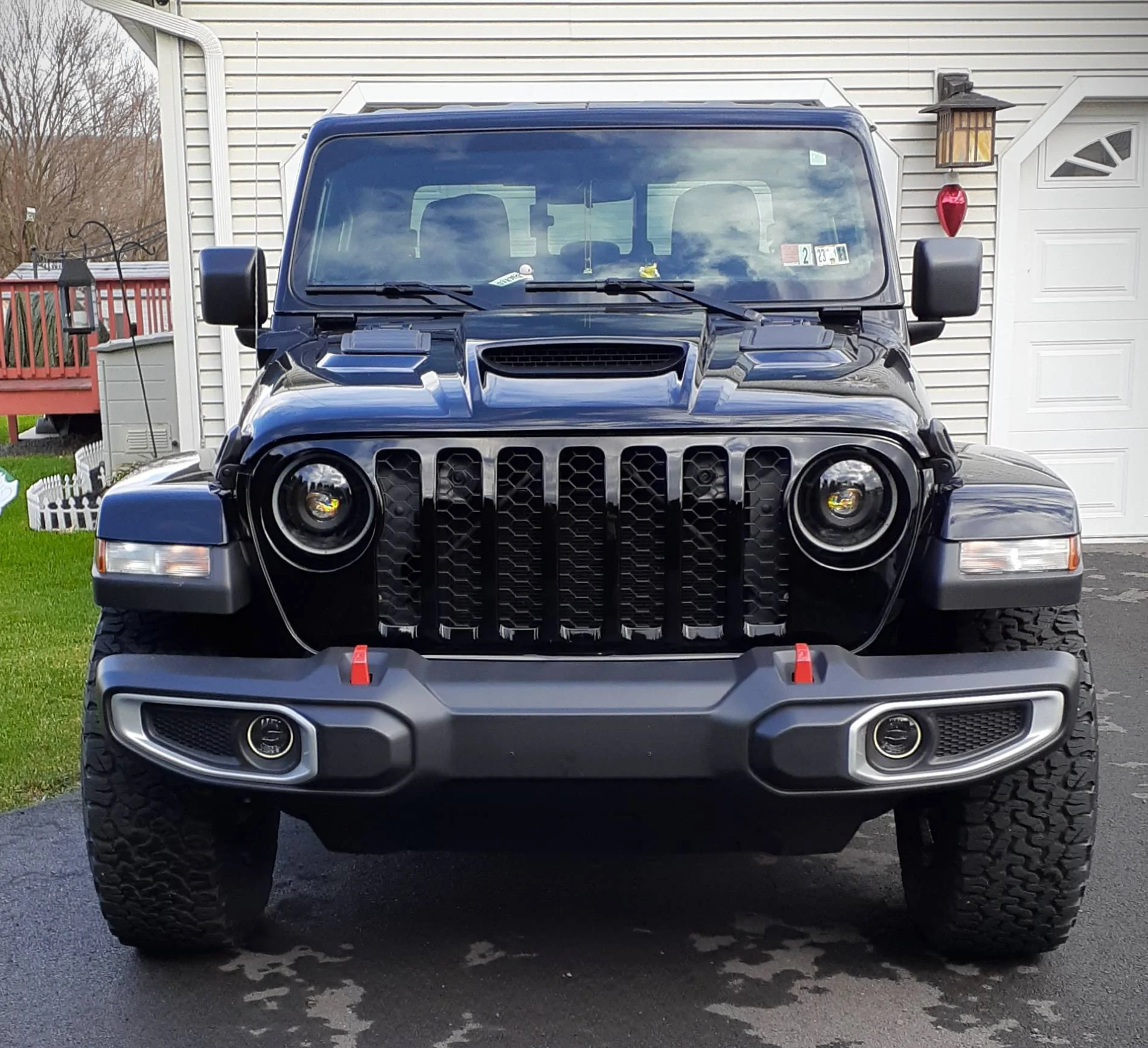

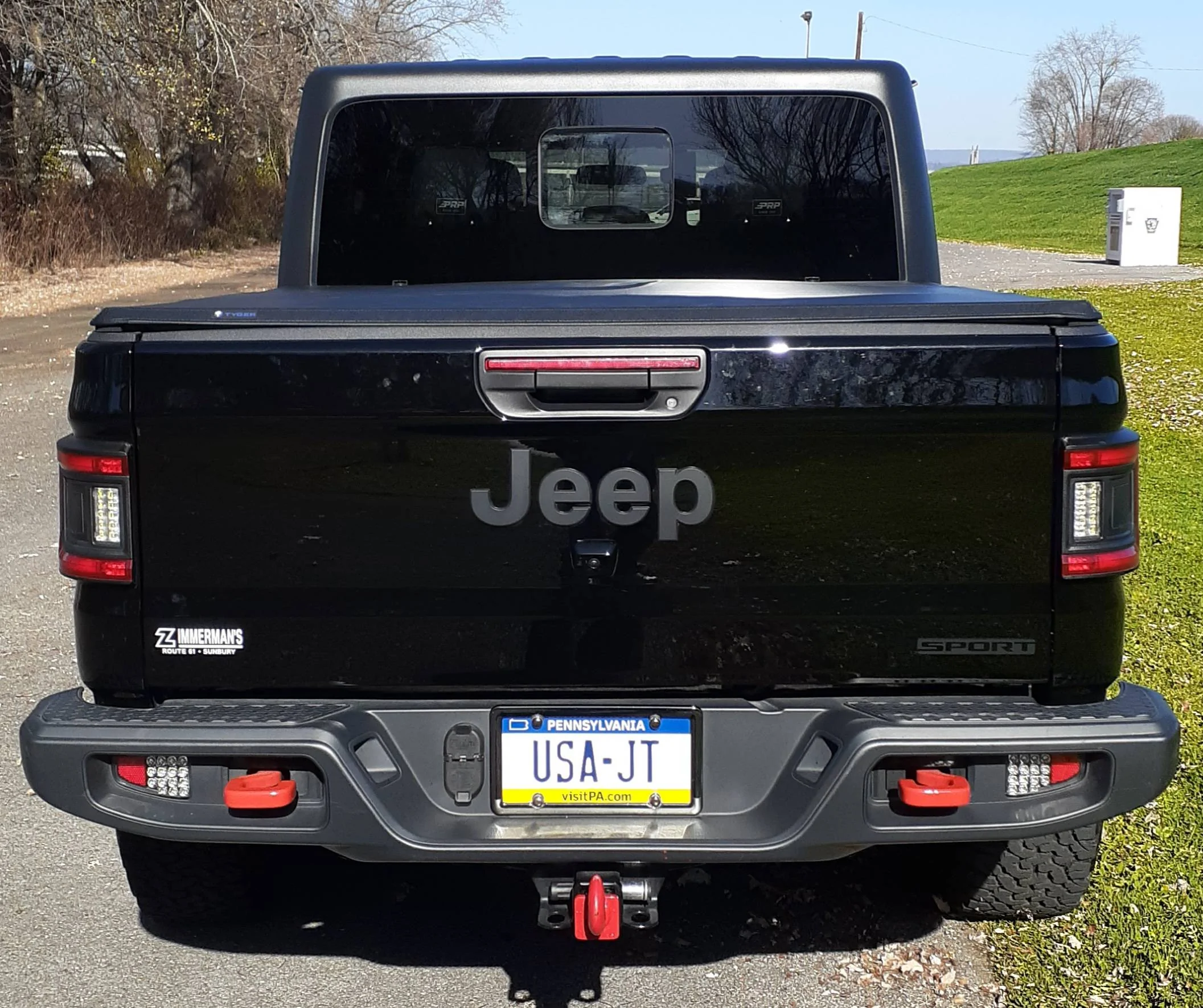

I have a 2021 Sport S that had all halogens and I installed Oracle's flush mount taillights, bumper mount reverse lights, fog lights and Oracle's Oculus bi-led projector headlights and I didn't flash anything. Everything was plug and play. It's been well over a year and no problems.

One thing I did change was the reverse lights.
I found I could use them more if they were tied into the lights in the bed.
They now come on as approach lights, utility lights or reverse lights and all controlled by the switch that's in the dash from the factory.
Easy to wire, you can use t-taps or splice. Remove each taillight and tie each light into each bed light.
One more thing they work great at, tailgaters. ?
