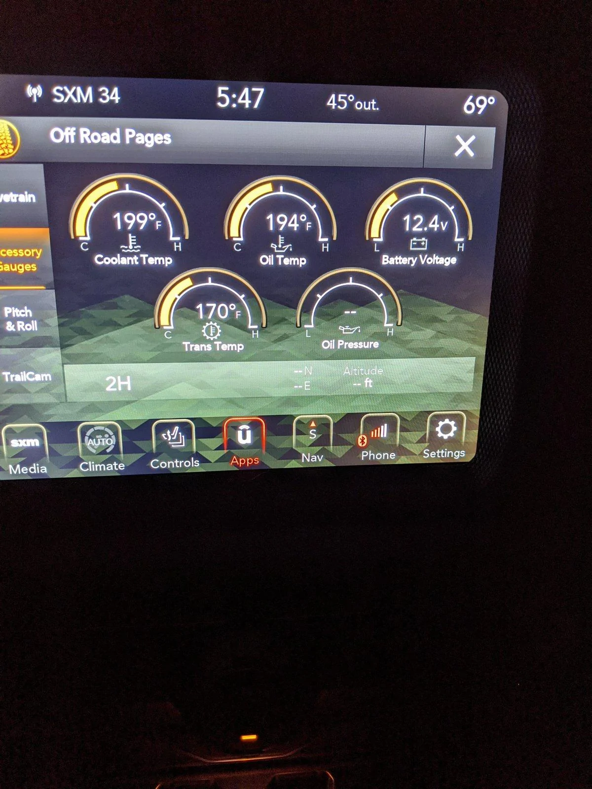

This is what I am seeing on my Off Road Pages. As you can see the Lat and Long are blank. @JeepCares do you have any suggestions?

Doesn't it have to be running?
Yours is obviously shut down because of the no oil pressure and battery voltage under 12.6 volts.
OR does it show that even if RUNNING?

Yeah I kept on forgetting to take a picture so I took one last night parked. It shows the same even while running...I tried it on the way home while driving. It has never shown since I purchased it in September.

Makes sense - something DEFINITELY not right with those all being blank like that. Mine is populated and keeps updating live as I drive. LAT and LONG and ELEV all change as I drive (elevation changes the most quickly - that's really fun to watch as it's like 926 a quarter mile from home and 816 when I cross the creek at the edge of our property then back to 832 at our driveway or something like that then back down several feet as I get to my shop.

Looks like you aren't getting sat signal.
Does your nav work?
178
29,091
34,571
Does your nav work?
That would be the next question - have NAV display a map, then plug in a location and see if it will route you there.

Yes the nav works just fine. I also get lat and long within the builtin gps.

Dealer trip then.
In my taco there were 2 sat inputs and one wasn't plugged in. My nav would work but my clock wouldn't. You may have a loose connection. Bad antenna or a bad radio.

So last week I was on a road trip ti NJ for work. On my way home I wanted to see the additional gauges while on the highway in OffRoad Pages. Wouldn't you know the Lat & Long was populated and updating. I live in MD, and on I83 south and a couple of miles after I crossed the MD line it disappeared, and hasn't worked since. .I know it works, but I have never seen it work in my area.
I am wondering if this is a geographical issue. Maybe because I am so close to D.C. that it won't work...I don't know I am just guessing. When I get my oil changed I will have the dealership look into it as well as upgrade my Jeep for the STFA.
@JeepCares have you heard of any issues in the MD area with the Lat & Long not showing in the OffRoad Pages?
