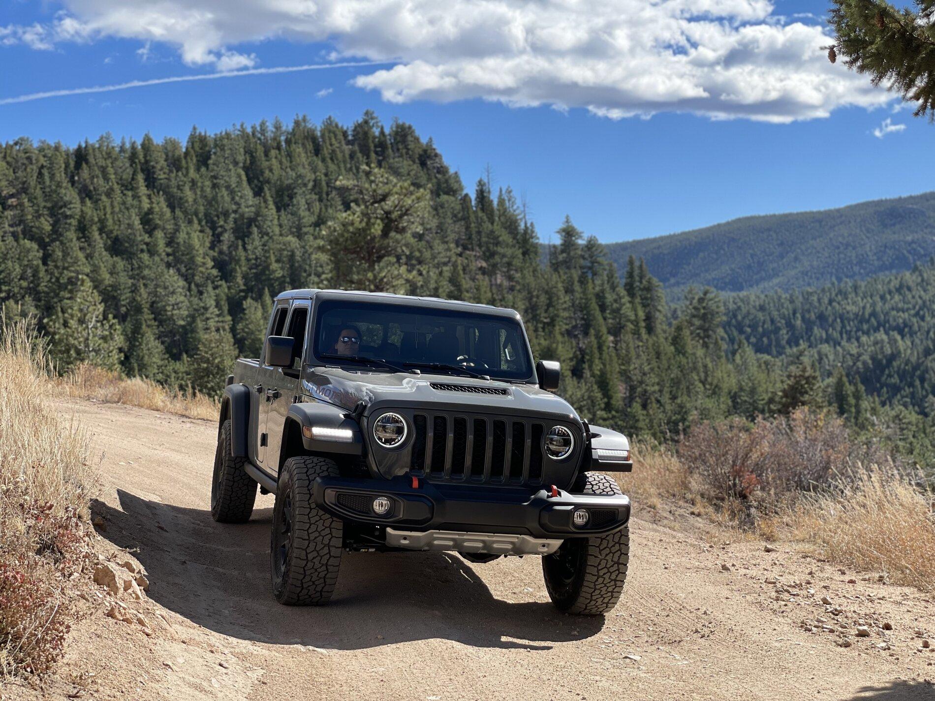

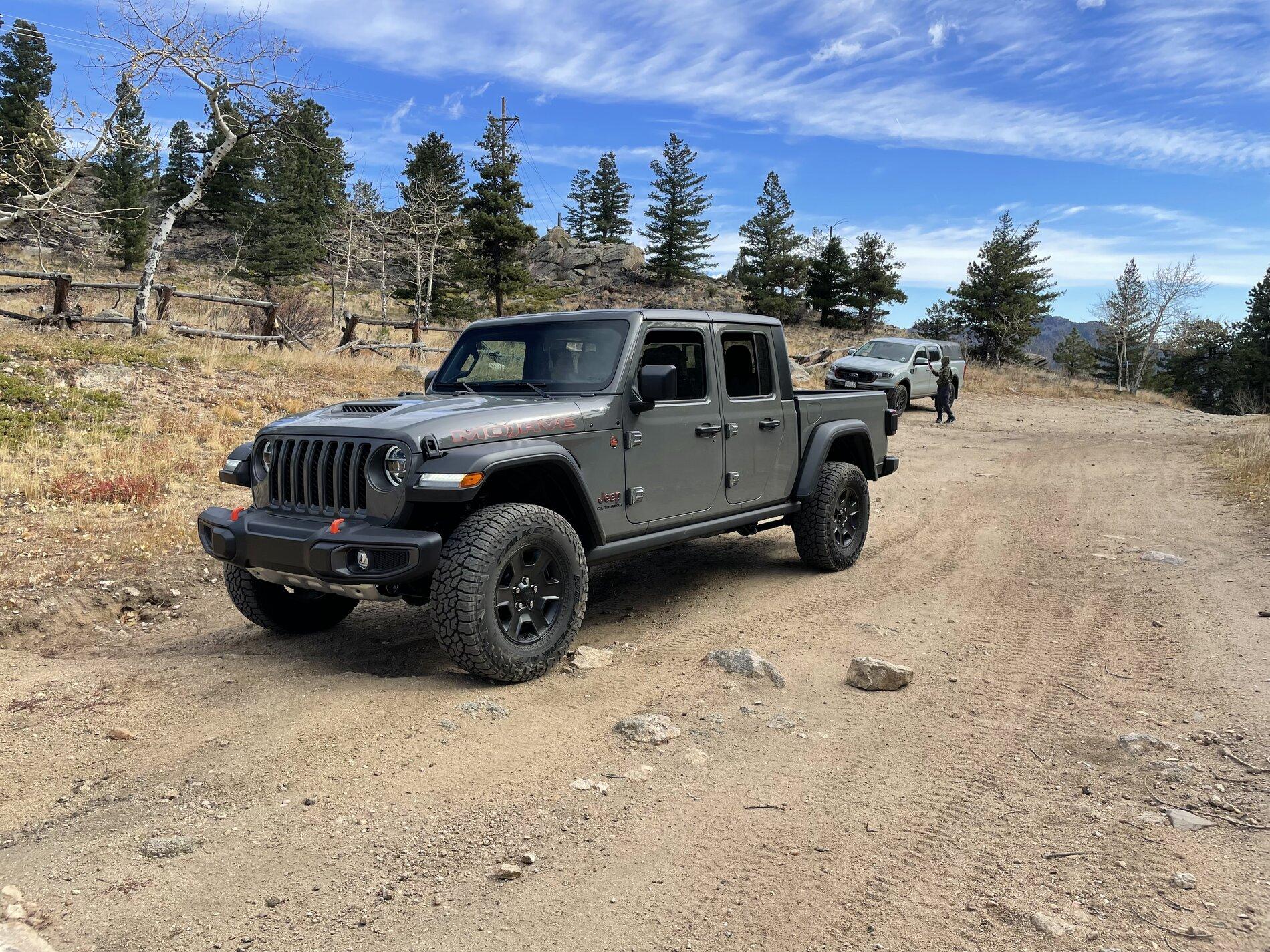

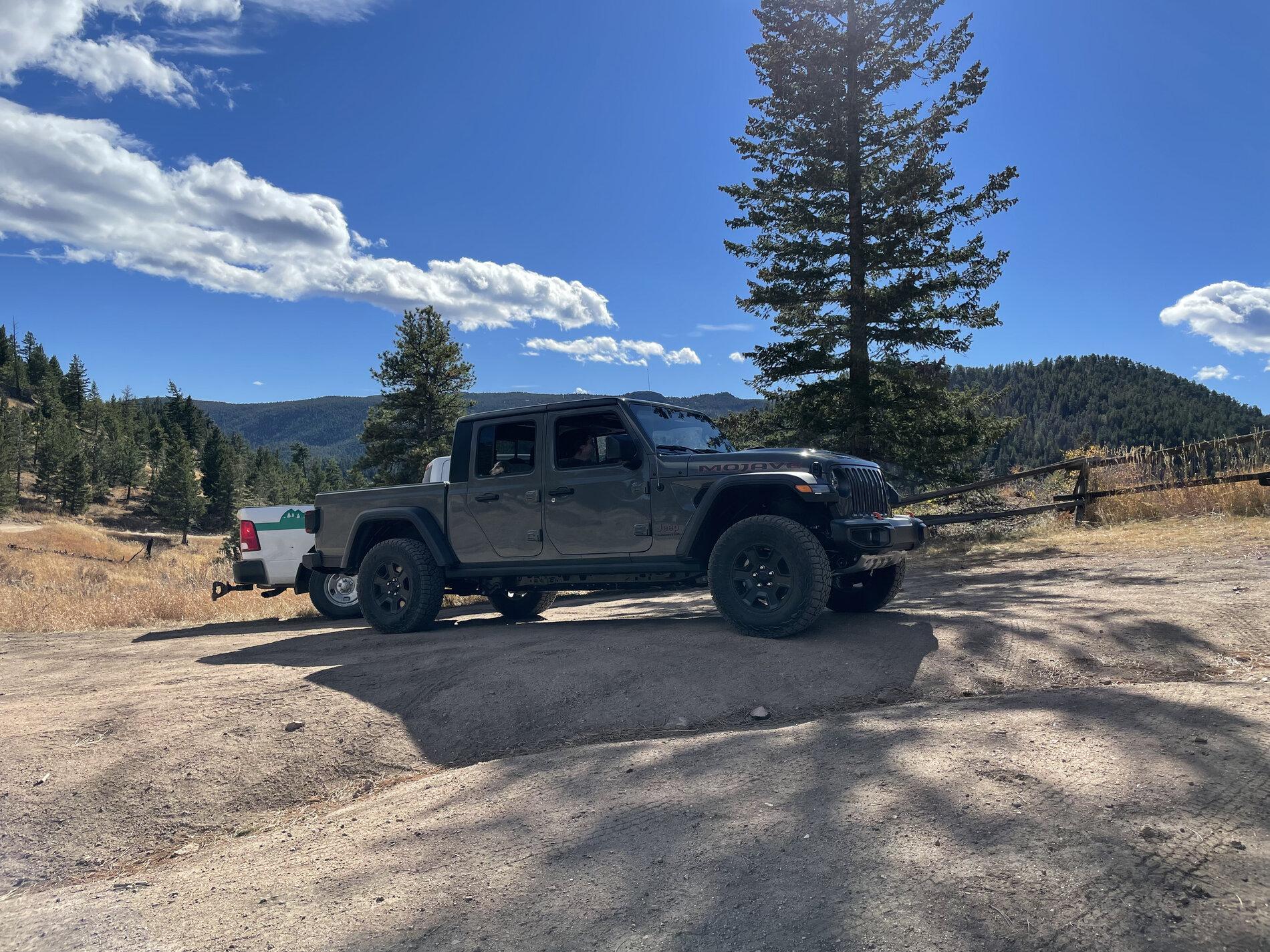

yeah, that’s what I heard but without any experience I didn’t even think of it till this morning. The 2nd one was a forest road and it was pretty mild. The first road we did was definitely 4X4 only, it had some very deep ruts and rocks. I should have taken some photos but I was just concentrating on getting through it.
