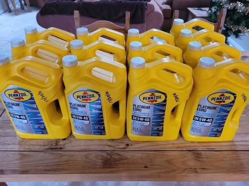

I'm pretty hard on my EcoDiesel engines. I do a lot if idling, short commutes, heavy towing, and high temp operation when pulling mountain grades, plus I run biodiesel blends. For this reason, I change the oil somewhere between 5,000 - 6,000-mile intervals.
I'm keeping both of my trucks for the long haul (15+ years). There are many things that can cause an engine failure. Generally speaking, the oil that you use isn't going to be one of those causes.
I bought 13 jugs of Platinum Euro for $14.25 per jug, which comes out to $2.85 per quart. I purchased enough oil to get me through the next 4+ years.

Sure can’t beat that price. I’m going to take delivery of mine in a couple weeks and also plan to keep it for a long time so trying to plan a good but reasonable maintenance plan for it. I do plan to remove certain things upon delivery so that will help with longevity of the oil but I still think 10k is a bit much. The only vehicle I do 10k oil changes on are my 05 vw tdi with 270k currently on it.
