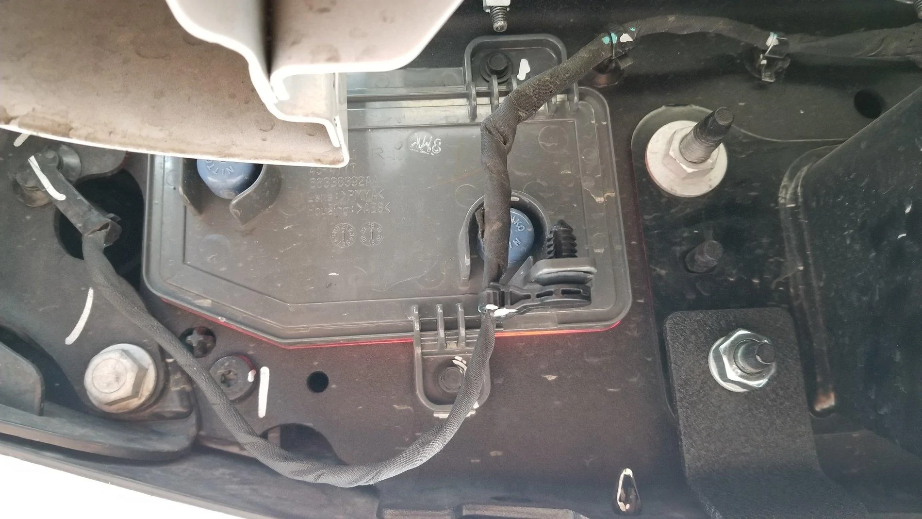

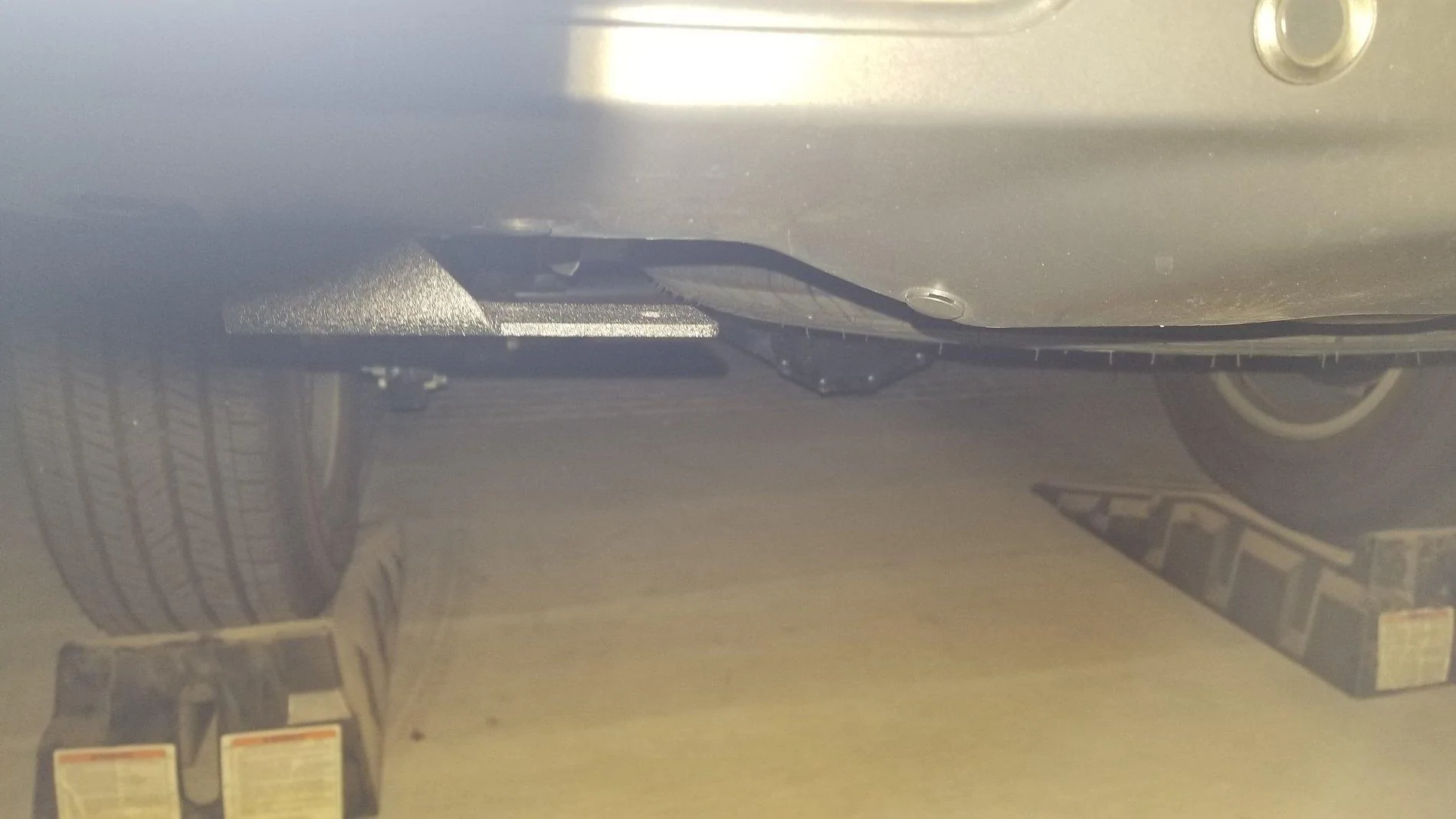

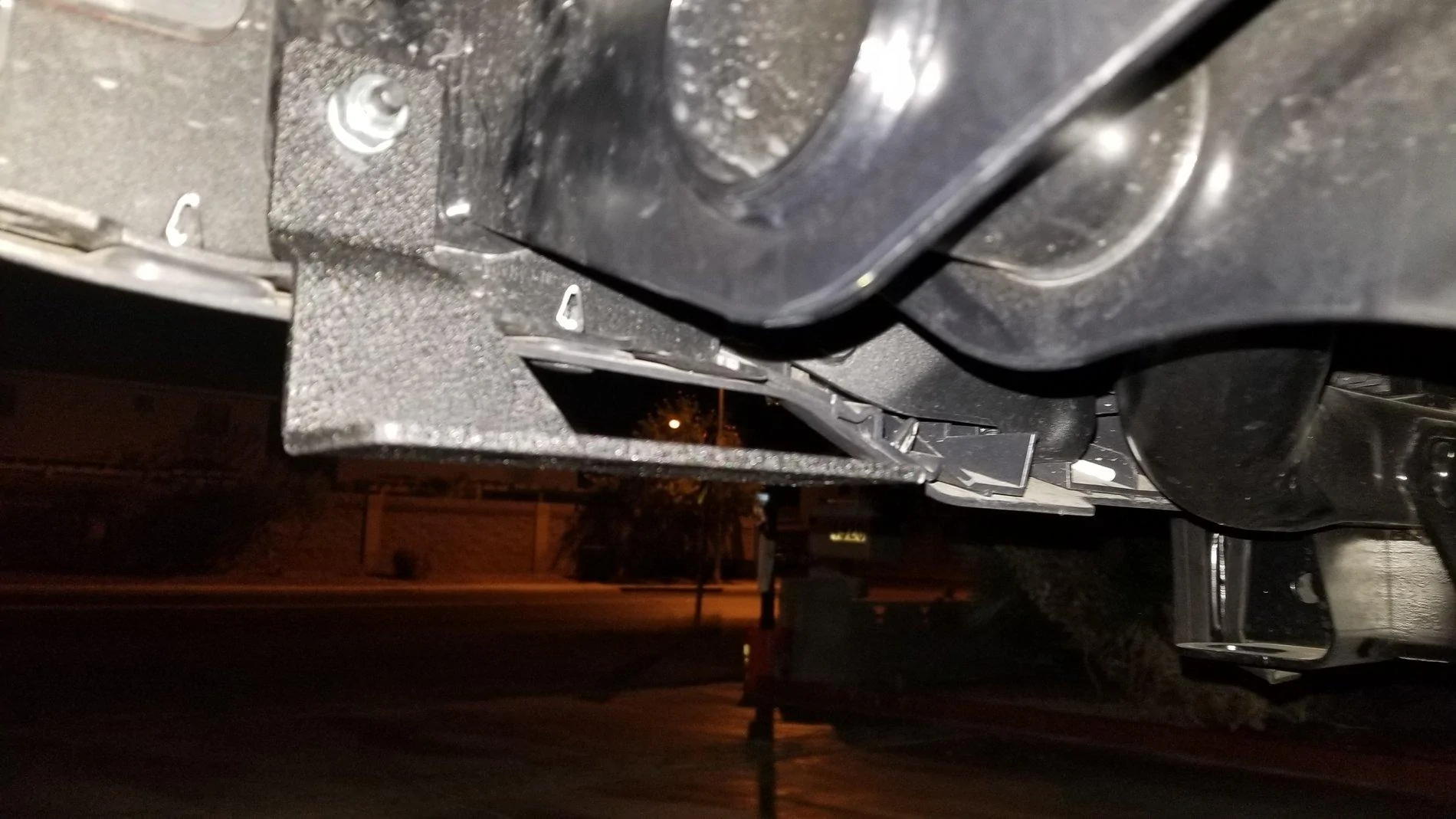

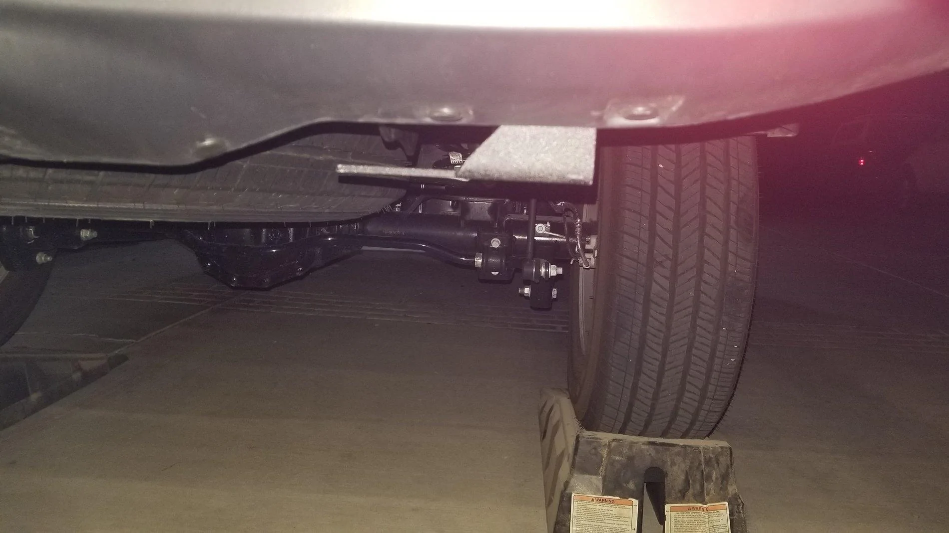

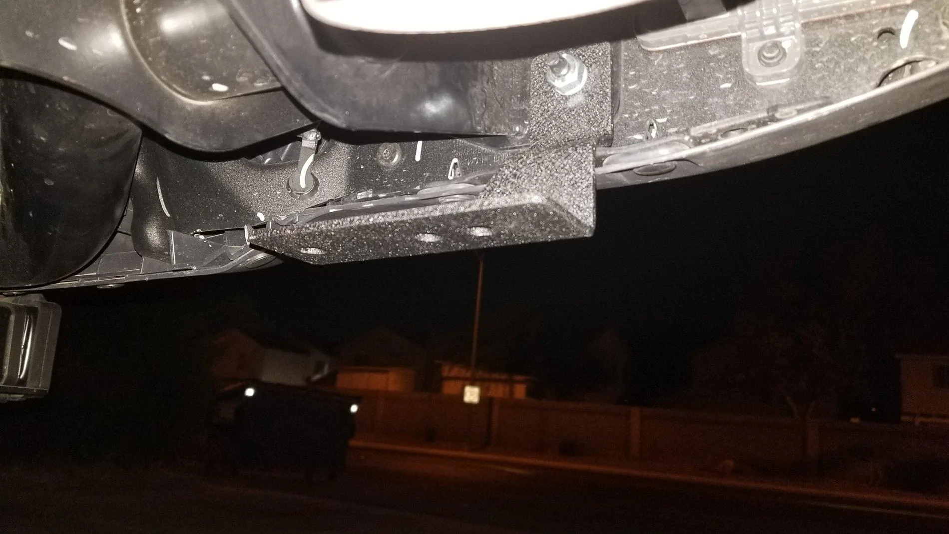

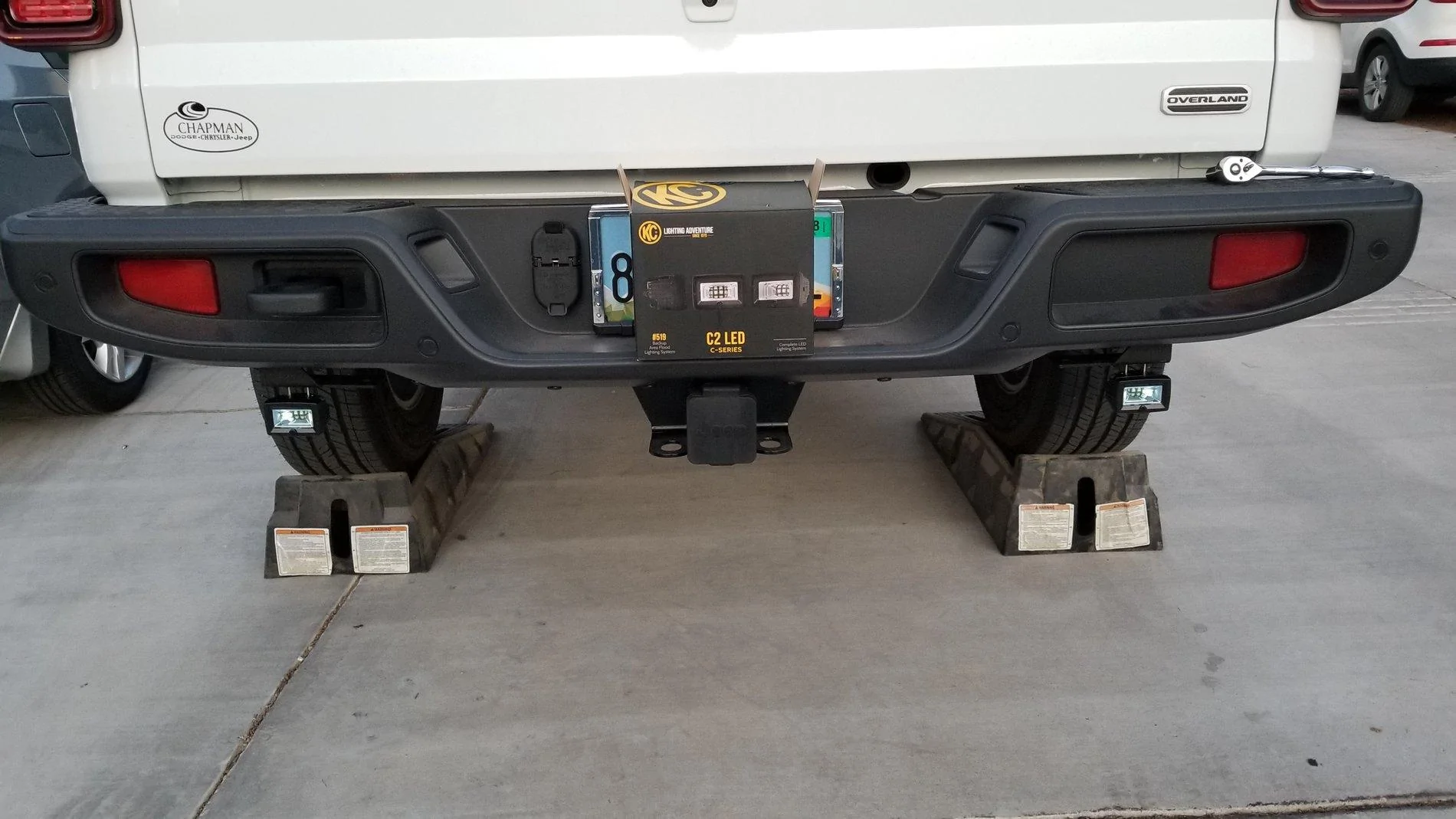

I put on a set of the KC 519 Backup Lights. I used the pieces from Curt to tap into the trailer wiring to provide a feed from the reverse light circuit and a way to mount the plug. I also added a backup alarm, and the Curt pieces allow a quick disconnect of the lights and alarm, if needed. The mounting brackets were designed for the Wrangler bumper, and are real easy to mount to the Gladiator bumper.

The first four photos are just the brackets after mounting them. The fifth shows the mounted lights. The last photo just shows the backside of the bumper. Some have expressed an interest in removing or modifying the red reflector and mounting lights in that position. It also shows how the brackets just set on the existing bumper bolt and are held in place with an additional washer, lock washer, and 10mm nut.

No, these lights are only connected to the reverse feed from the trailer wiring. They only light up when it's in reverse.
I'll see if I can get a night shot with the reverse lights on.
