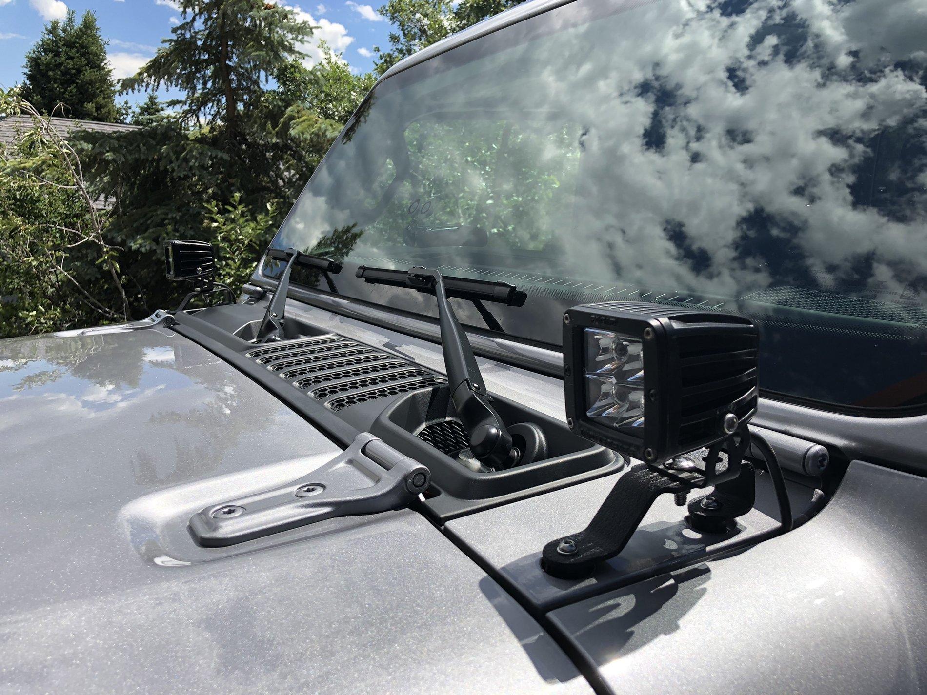

Here are the ones I went with. Off the paint and plenty of room for the hardware:

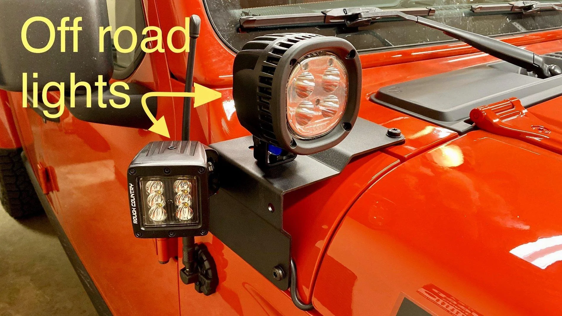

Anyone know of cowl mounts or other methods to mount off road lights that will not interfere with folding the windshield?
I want lights but I like the fact I can drop the windshield quickly (not like my JK that required two days off work. One to lower it, one to put it back up). How about bumper mounts on a stock Sport S?
I installed a set of these Mopar mounts. They attach to the frame between the bumper and grille.
Bumper-mount Light Bracket
Brand : Jeep
Part Number : 82215428
Our Price: $105.00
They are available on Amazon, ebay, or from any dealer.
https://smile.amazon.com/Mopar-8221...r_1_1?keywords=82215428&qid=1577711170&sr=8-1
https://www.ebay.com/itm/2018-2019-...e=STRK:MEBIDX:IT&_trksid=p2060353.m1438.l2649
https://store.mopar.com/accessories...cket/bumper_mount_light_bracket_82215428.html
These are also available from EAG. https://smile.amazon.com/EAG-Pillar...=1577711394&sprefix=eag+mount,aps,234&sr=8-16

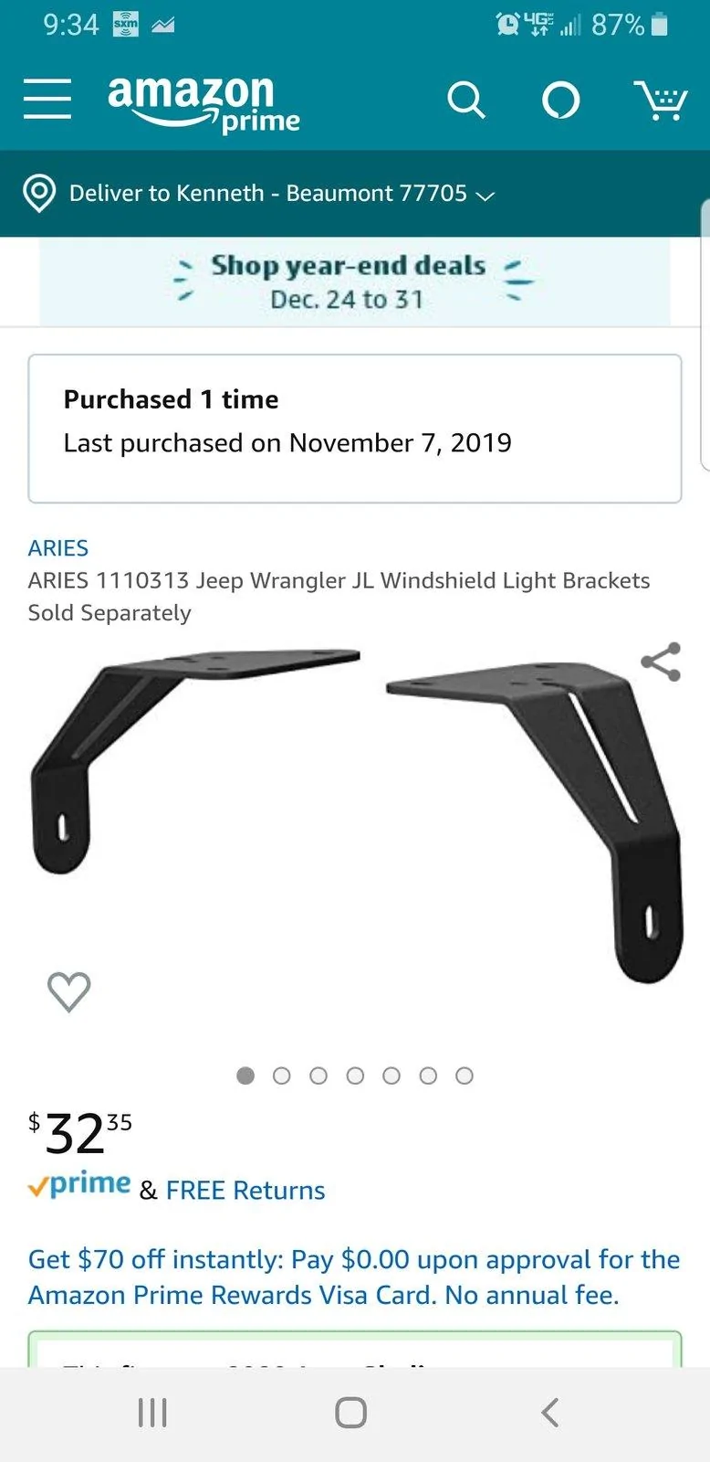

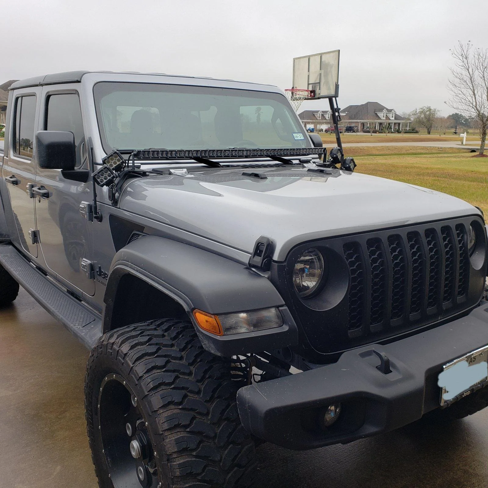

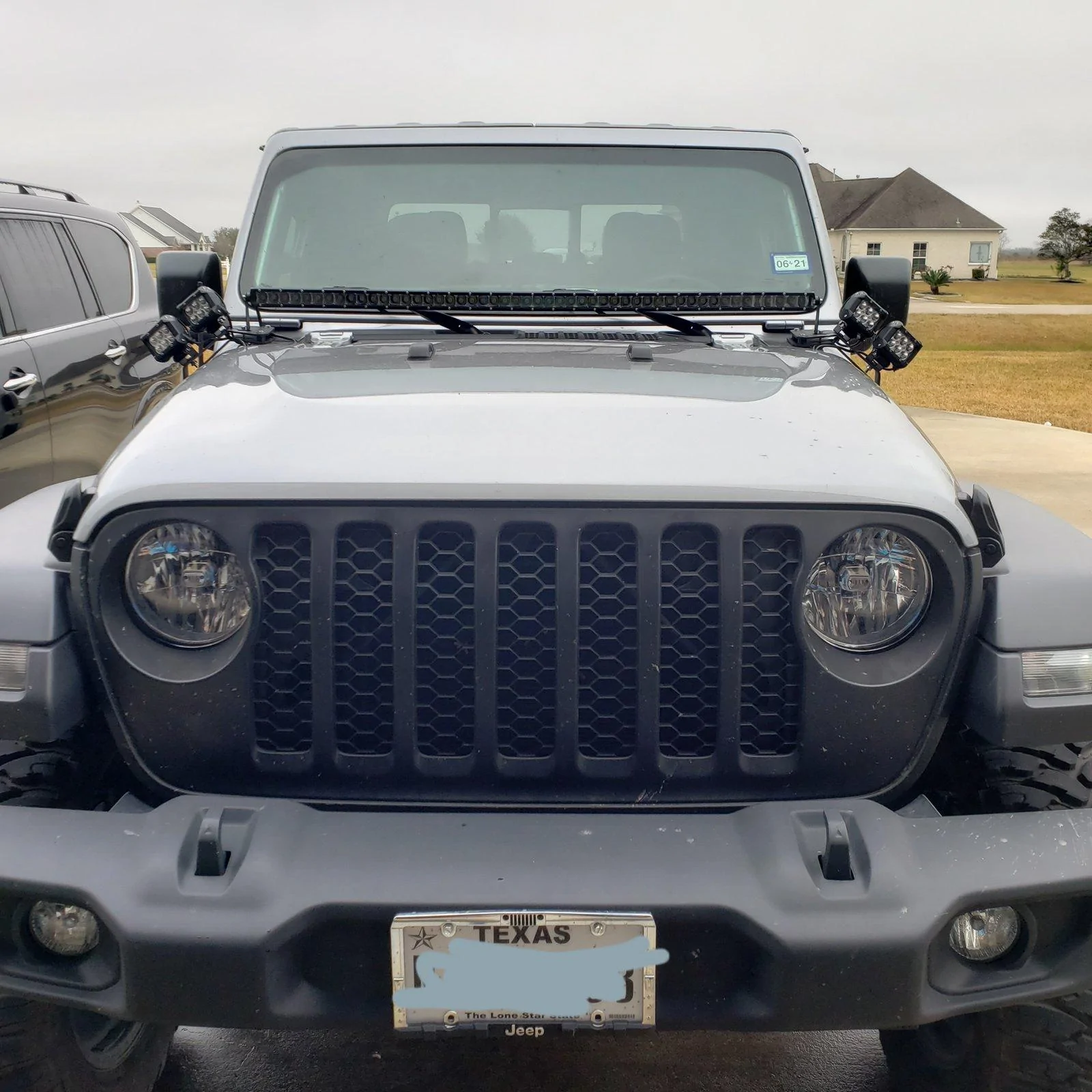

I installed the Aries cowl mount and discovered that it didn't leave enough room for the nut between the mount and the hood so I bought some longer bolts and doubled them up. It actually looks pretty cool and worked perfectly. 52" single row across the hood and 2 - 3" pods on each side.

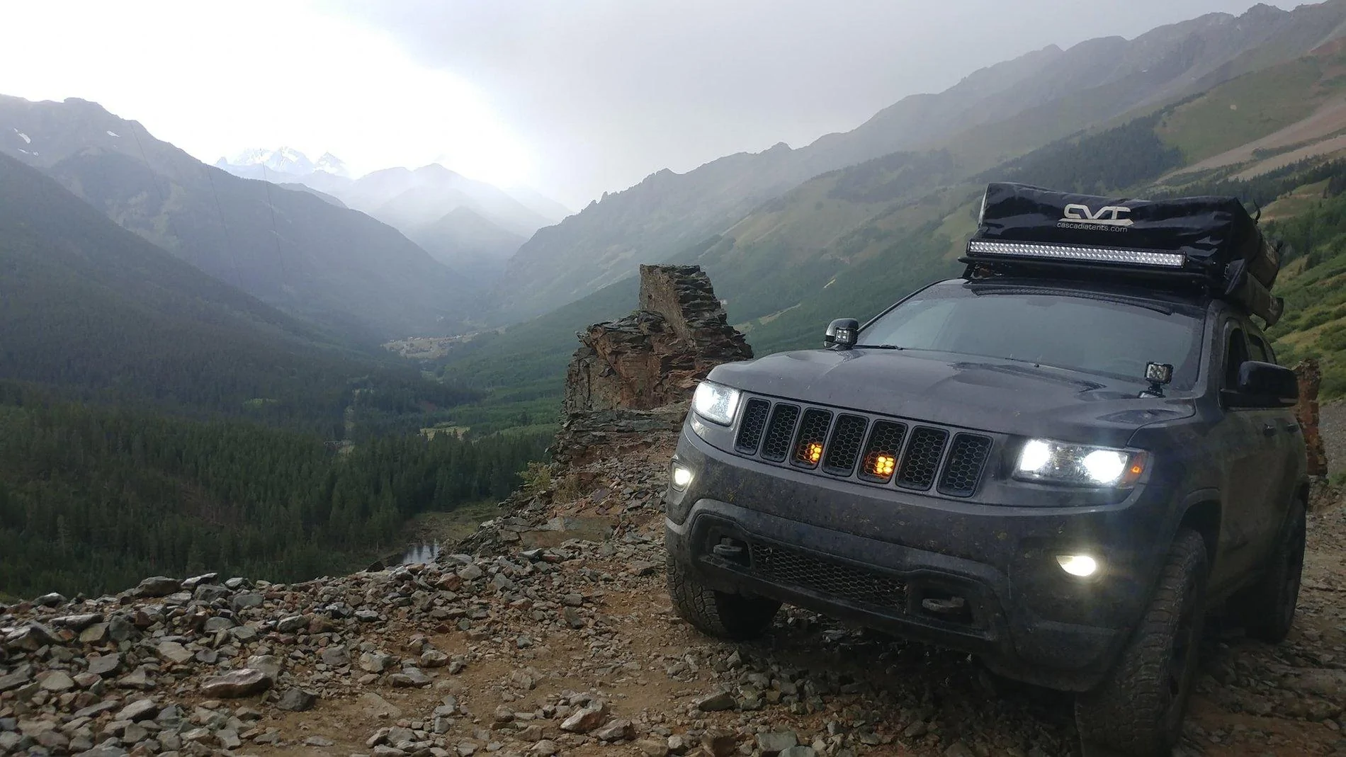

Does anyone know if a bracket exists for the JT that will allow mounting pods behind the grille, like the amber ones shown below?

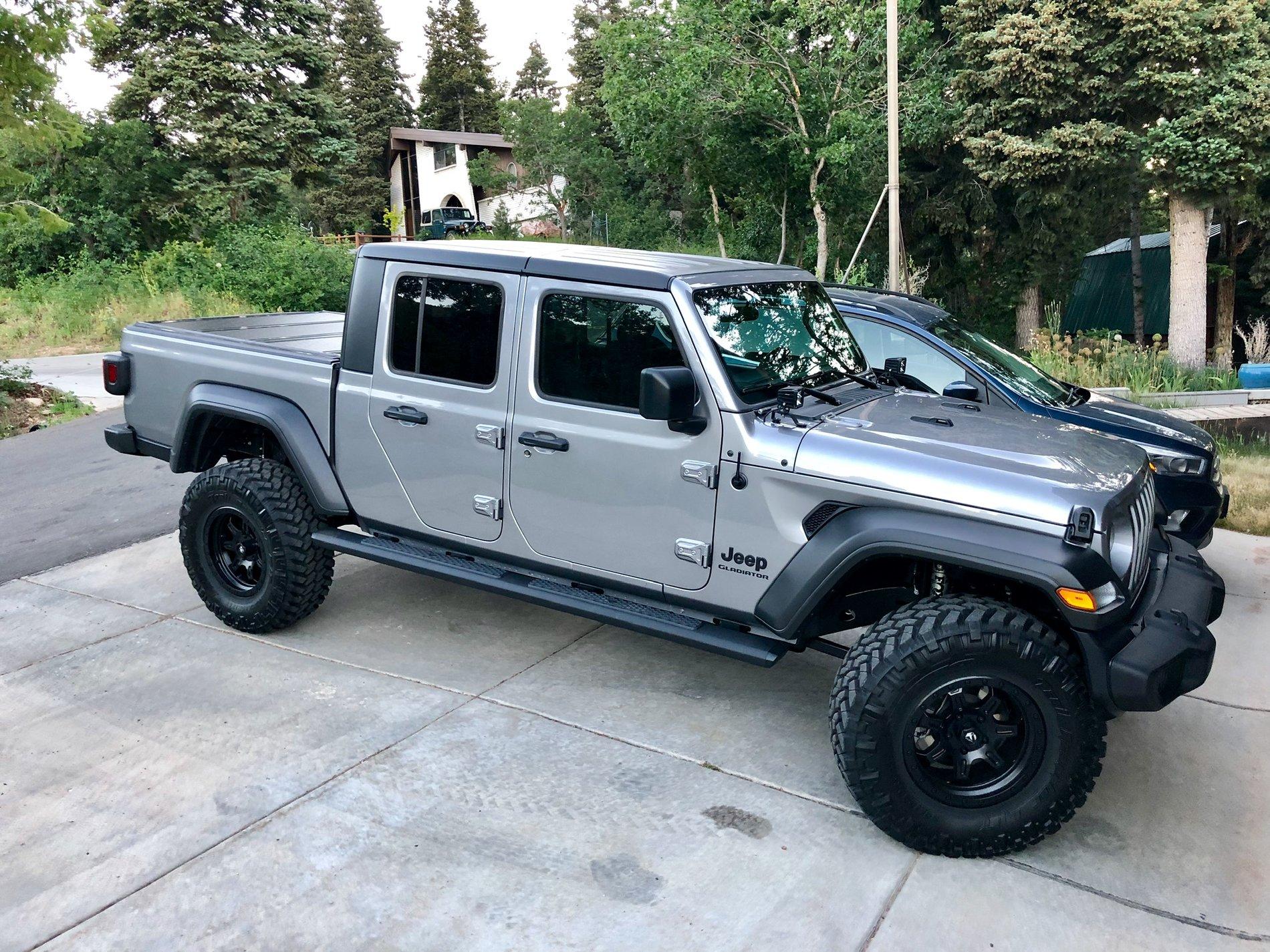

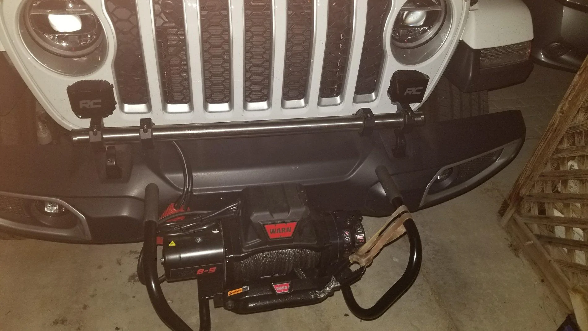

The brackets are not too difficult to install. You do have to drill three additional holes and install rivnuts (nutserts) to bolt the brackets on. The brackets are intended for use with the Mopar 5" ($475) and 7" ($725) lights, which have a taller mounting plate. I chose a set of Rough Country lights that are nice, but low profile. They wouldn't clear the bumper, so I improvised a bit. This is the only picture, so far. I have added another set of street legal fog lights, since it was taken, that are also controlled by an AUX switch.
https://www.roughcountry.com/3-inch-led-wide-angle-lights-70904.html
https://www.roughcountry.com/2-inch-led-square-lights-70907.html
The Mopar brackets are intended for use with lights similar to this.
https://www.roughcountry.com/4-inch-led-round-lights-70804.html?rrec=true
