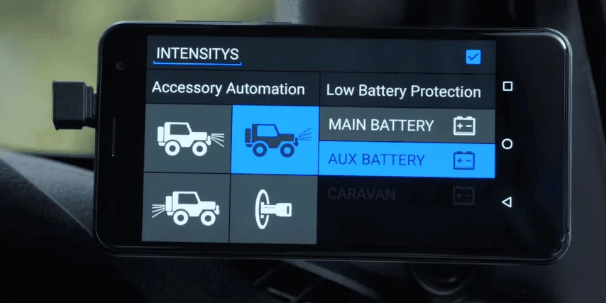

What about an ARB Linx system?

Cape taco12
Cape taco12
May 9, 2019
252
279
Mass
2020 Gladiator Sport S
“Accessory Switchboards
  • Controls up to six (6) additional switched accessories
  • Can be switched on or off manually or automatically by ignition, high beam headlamps, low beam headlamps or reversing lamps
  • Each accessory name can be customized
  • Each accessory can have a user selectable low voltage cut out
  • Can be viewed in either split or full screen mode
A key feature of the LINX for sale is its ability to control six (6) additional switched accessories. Each accessory can be customized to switch on or off by user input, and/or automatically by ignition, high beam headlamps, low beam headlamps or reversing lamps. Additionally, each accessory can be personalized in name with individual settings for low voltage cut out to protect your vehicle from a flat battery”
Sweet never saw that system. It will work as I want but since I don’t plan on adding more electronics the price $600+ is kind of a deterrent. If I planned on adding ARB lockers or airbags I would go with that for sure.
