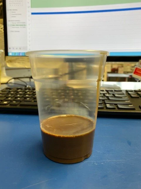

update, just over a month after installing the catch can, with roughly 1000 miles. drained the can for the first time.
