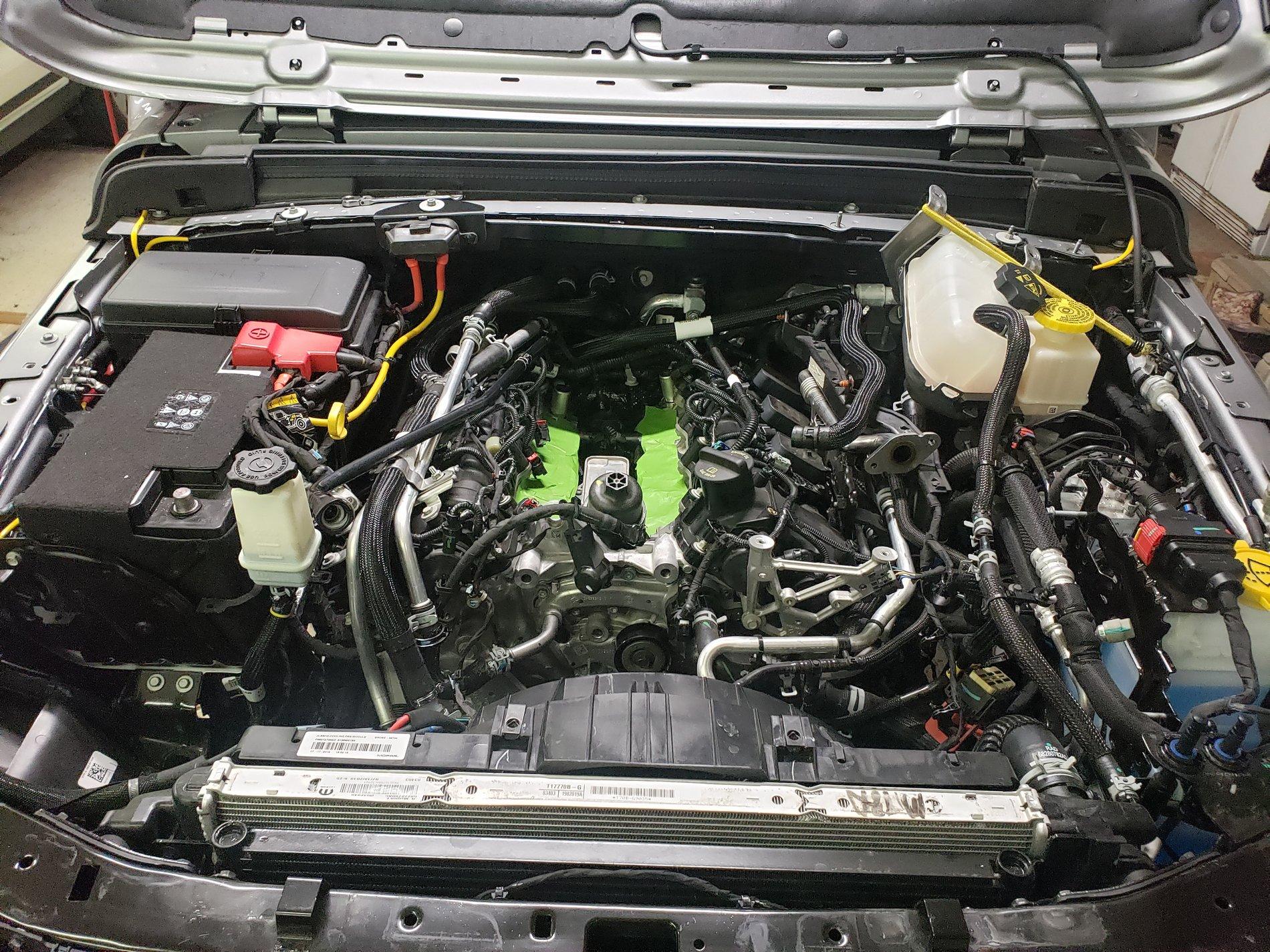

I will be installing the Magnuson SC very soon and I have been researching cooling options. I have not been able to find any remote oil coolers for the 3.6L. I guess I am surprised that no one has made a remote oil filter and cooler kit as the stock one seems to be a bit of a problematic part. Is there one and I am just missing it?

I want to increase the cooling and filter capacity, as I am gonna supercharge it.

You probably answered your own question. The problematic nature of the oil cooler and filter housing is also probably why a remote setup is not readily on the aftermarket. The OEM setup and location would require some extensive engineering of an adapter and routing of hoses to another area for a relocation kit to be possible.
The OEM setup on top of the engine is probably one of the worst locations to engineer a remote relocation kit from.

Oh I do not disagree at all. Was looking at it today shaking my head lol.

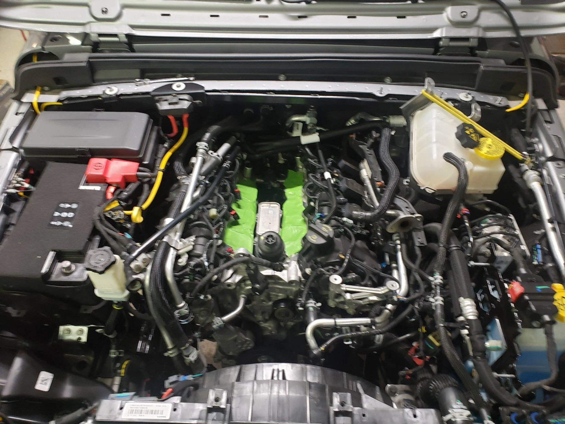

There is likely a oil pressure sending unit to tap into for a external oil cooler. Then I would try to bypass the one in the manifold if you do that. It's more like a oil heater anyways

It is under your intake manifold. It is like an EGR cooler for a diesel I think.

Yes, it's all one assembly. It has coolant and oil passing through it.
