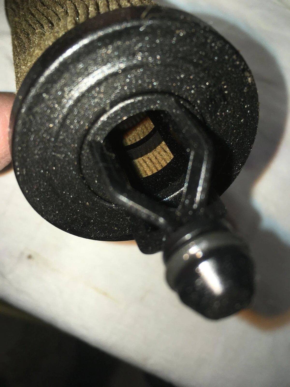

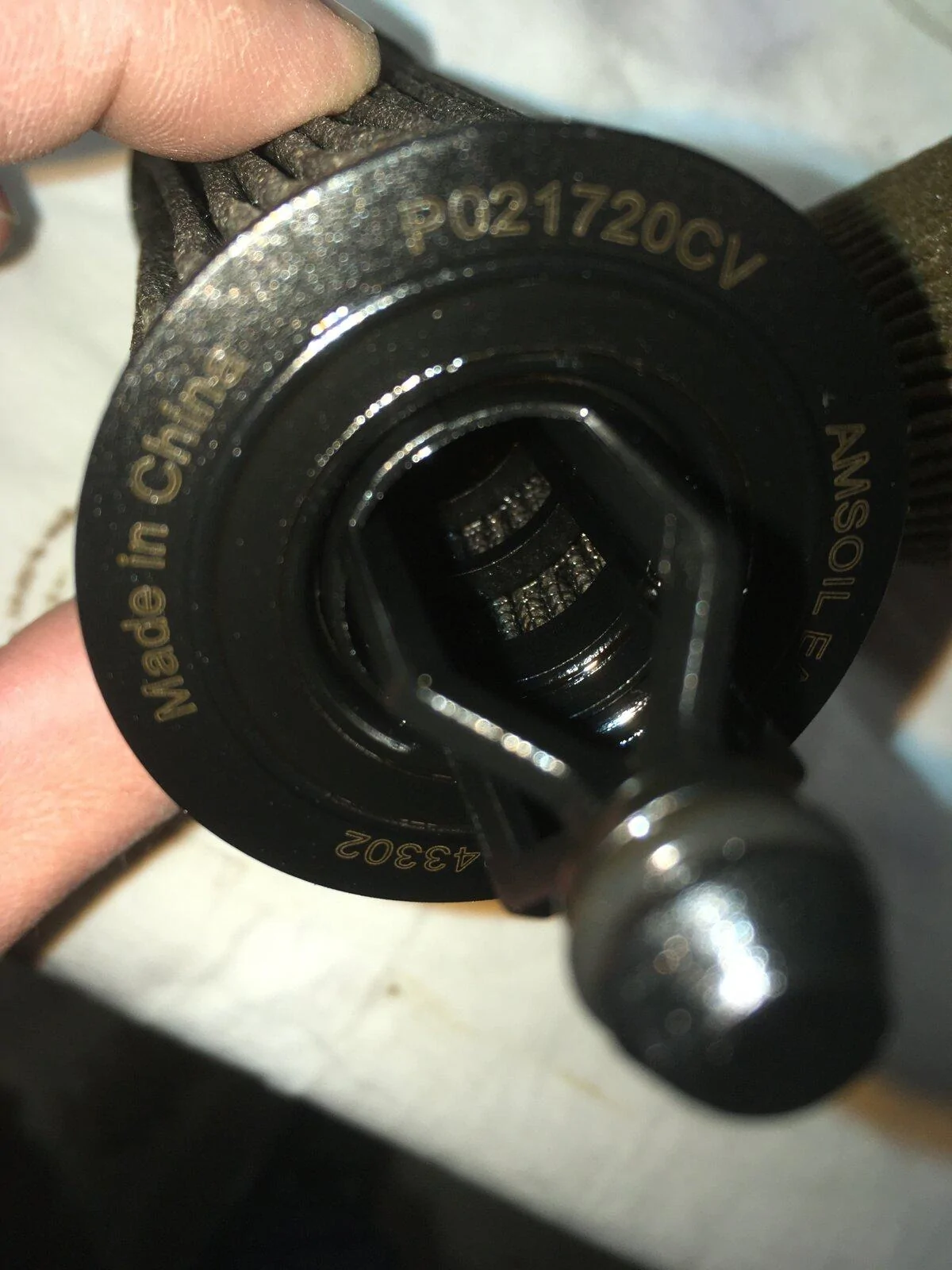

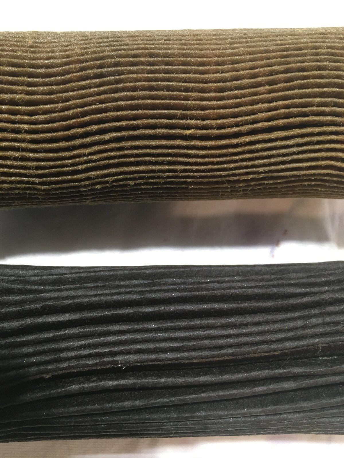

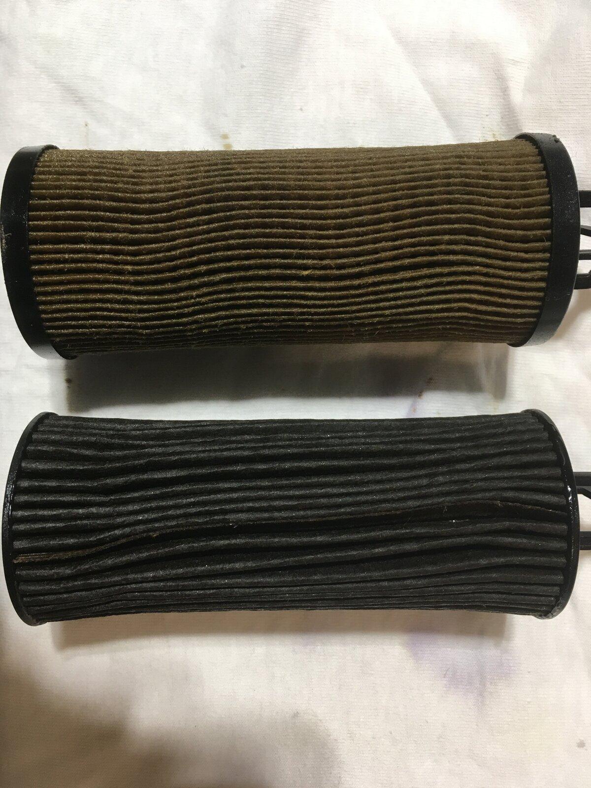

At 10k now and after Pepe had posted the part# on the oil cap I ordered it to have a back up. Received it yesterday and did my oil change. My first oil change was at 1,000kms and replaced the Mopar filter for the Amsoil one. Took a sample of the first oil change and the lab found a “trace of glycol”. I anxiously waited for the 10k to come for the oil change and have the sample going in on Monday. If no glycol is found here, the factory used contaminated oil. We shall see.
Here’s a couple pics of the Mopar filter (top) vs Amsoil (bottom ).
Was more careful to pull the filter straight out and also put back in. (Never had to think about this part or I’d break something).

That is not at all evidence the factory used contaminated oil and people really need to stop freaking out about traces of things in their oil that aren't indicators of wear. There are maximum allowable values of everything including toxic elements and rat shit in your food. Glycol is a component of nearly every coolant on the market so its presence in a new engine isn't unexpected. If you start to see more than trace amounts then I'd worry but trace amounts aren't going to impact the efficacy of your engine oil in any significant way.
Maybe. The thing about oil manufactured and bottled or sealed is that it doesn’t contain glycol. Glycol in engine oil is not something you want to see even if it’s “trace amounts”. Kinda like blood in your urine. Glycol in the oil, even trace amounts is, (1) corrosive, and (2) it says something. Either the Pure manufactured oil is contaminated at the factory(because glycol isn’t added during manufacturing) OR there’s an internal leak in the engine. Both scenarios, to me, are important. Kinda like blood in your urine.
Nobody here is freaking out. I gravitate toward information and details that prepare.
