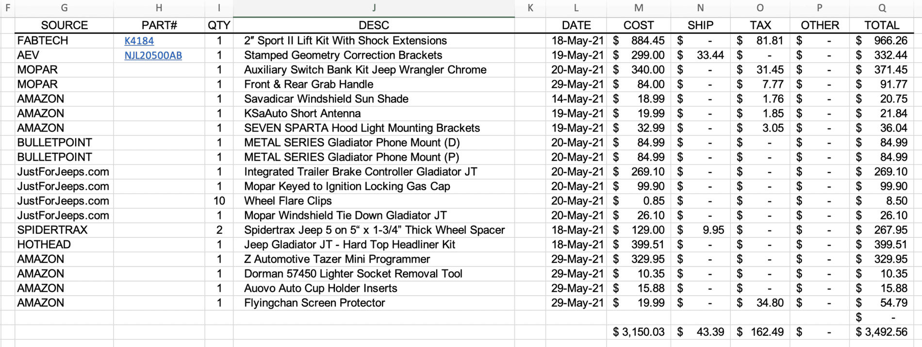

Well 3 weeks into ownership and about the same amount of time it would take to watch all Marvel Movies at once to investigate "things"; I find myself contemplating...how much have I spent just getting gizmo's and gadget's for the G. So I started to add it up..ouch; I haven't even begun. I'll get this filled out properly and reposted later but this gives you an idea of where I'm going with this already.
Jeep Gladiator Oldskool's Mojave Science Project Screen Shot 2021-06-01 at 2.05.44 PM
I'm contemplating changing lifts (preserve Mohave ride) and am working on my wheels and tires now.

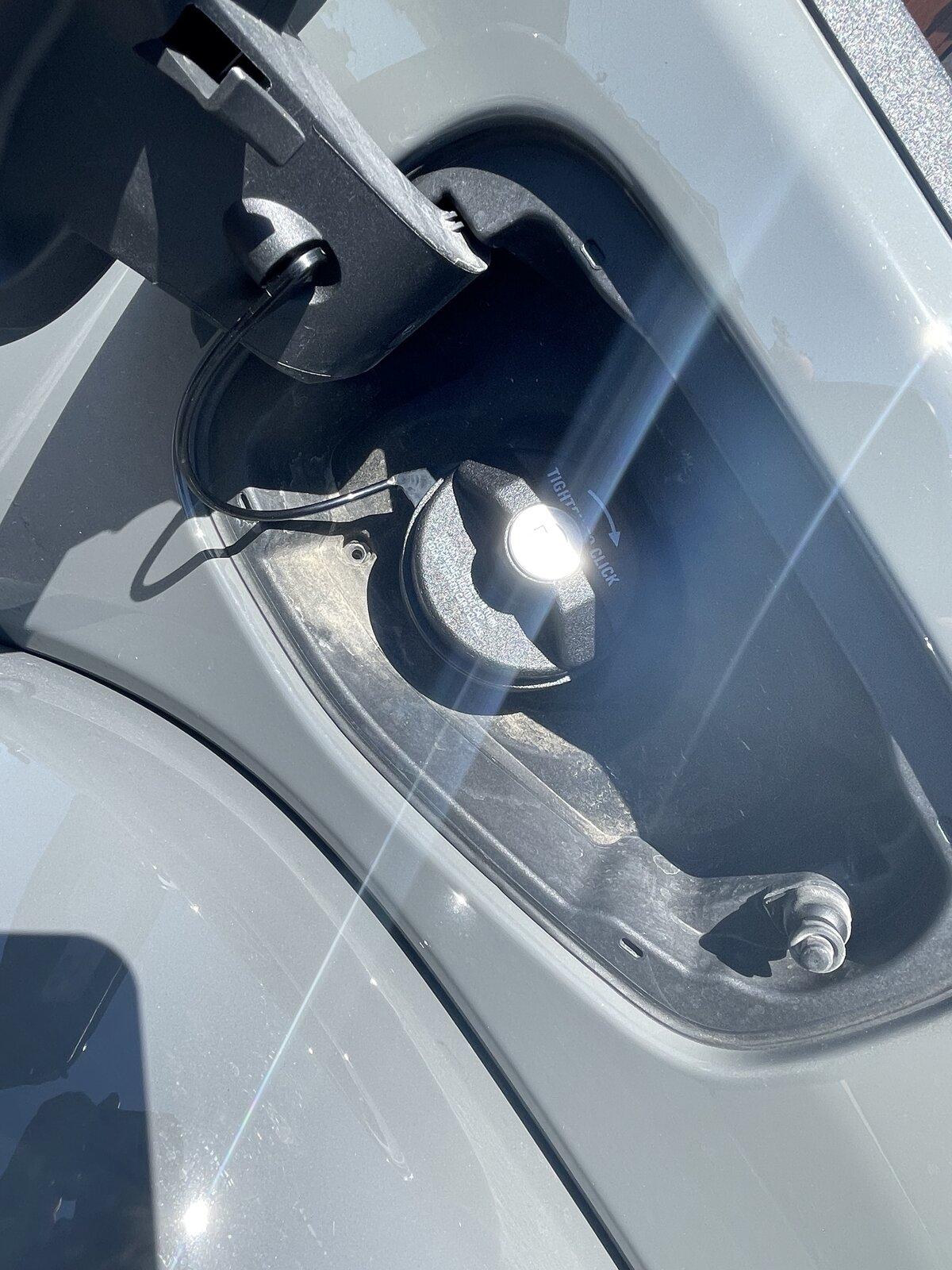

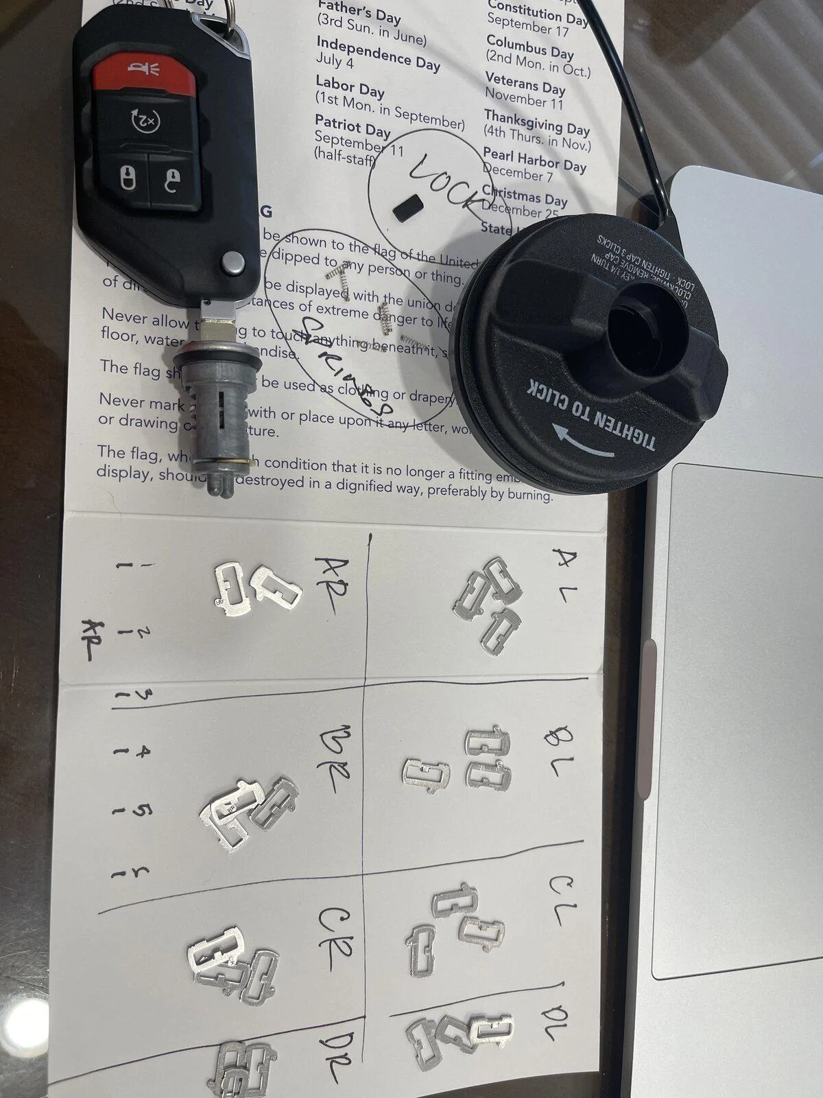

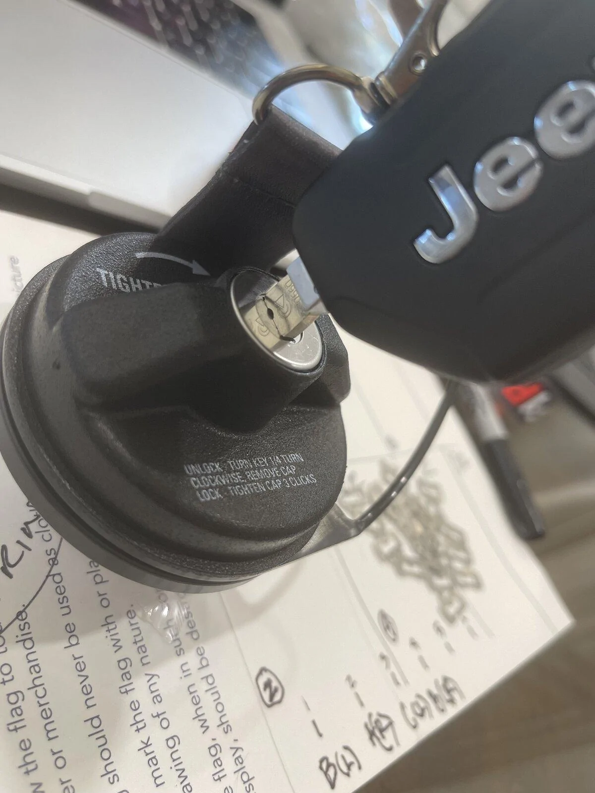

And today, I present oldskool's oldskool re-key and locksmithing skool lol. During my research, I noticed that 1) my Gladiator did not have a locking gas cap and 2) a locking gas cap was available from MOPAR and 3) gas prices are SOARING!
I says to myself upon discovery #2, "self, that has got to be small fortune to rekey" but then realized it was pretty much just as simple as my oldskool VW's and BMW's. So no issue. I Dr. Googled and confirmed, it's pretty much as simple as doing the old cars (circa <1975). Oldskool vs. newskool meets the together #1.
Here's a video on how to install:
And here we go, the goods you want:
Jeep Gladiator Oldskool's Mojave Science Project IMG_6893 2

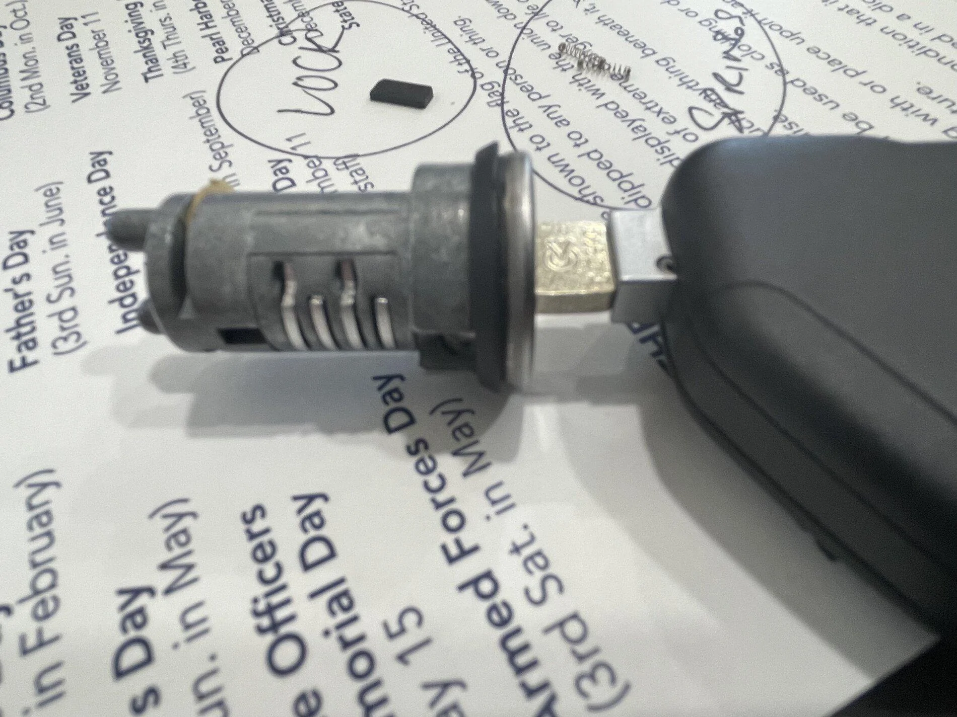

The process.
Gas cap only has 4 pins so pretty easy. Most cars and houses have 5 to 8.
Jeep Gladiator Oldskool's Mojave Science Project IMG_6882
Kit comes with 24 pins; you'll only need 4. But there is a right and a left. It's based on how you hold the barrel. The pictures show my separation of the pins - A/B/C/D Left and Right. This just makes it easier. Pin 1 will be closest to the chrome key entry and is a left pin. Pins 1 & 3 are Left. Pins 2 & 4 are right. This matters for the spring and locking plate functions.
In the video it shows utilizing the spring for all the "test fits". Don't use. Not needed until towards the end; just helps you lose them. Just test fit each pin until it is flush against the surface of the barrel on both sides as the key is 100% inserted. I normally test fit first pin until it fits. Remove, then test for second pin until found and then try pin 1 & 2 together. And then continue this through the entire rekey coding.
Once done, it should look like this:
Jeep Gladiator Oldskool's Mojave Science Project IMG_6889
Once you're confident that you have selected all the right pins, remove the key, remove the pins. Now is time to insert the springs. Insert the springs into the larger portion of the keyway. As such there will be 2 springs needed for the left side keys and 2 springs for the right, for a total of 4 springs all together. There are extra springs in the kit so don't freak out if you lose one or if you have spare parts. I normally insert a spring, insert a pin, hold together with fingers and do the rest until complete. Insert all 4 pins you identified earlier in the correct order.
Once all 4 pins are in insert the key. Verify again, that all pins are flush and that the barrel is smooth. No elevations, catches or snags in the pins.
Now comes time to lubricate. You want to lubricate the pins, the outer barrel of the core and the female area of barrel of the cap. Don't overdue it. Just enough to keep in running smooth. Now comes the point of no return.
Gently insert into cap. The little "retractable brass clip" on the end is the retaining clip. Just wiggle that until it retracts, enters and slips into the barrel; it should slip in and lock once you align the two fingers on the core and inside the barrel.
Jeep Gladiator Oldskool's Mojave Science Project IMG_6890
Now DOUBLE CHECK your work before you get over confident and make a major mistake. Make sure the key rotates freely in the cap and the lock does not come out. Ensure that it rotates, locks the key in place and rotates back releasing the key. Once you're confident that your key master skills are not going to leave you stranded at a gas station looking for a drill, remove the old cap and retaining strap and replace with your new to you locking cap. Place old cap in box for when you get tired of using your key or you trust your neighbors.
Stand aside, you "I don't need a MOPAR or Locksmith guy to work on my Gladiator as we near Summer because I have a beer to buy" guy or woman and gleam at your work knowing you have protected your interests, your pocket book and defeated the socialist monster we can gasoline theft.

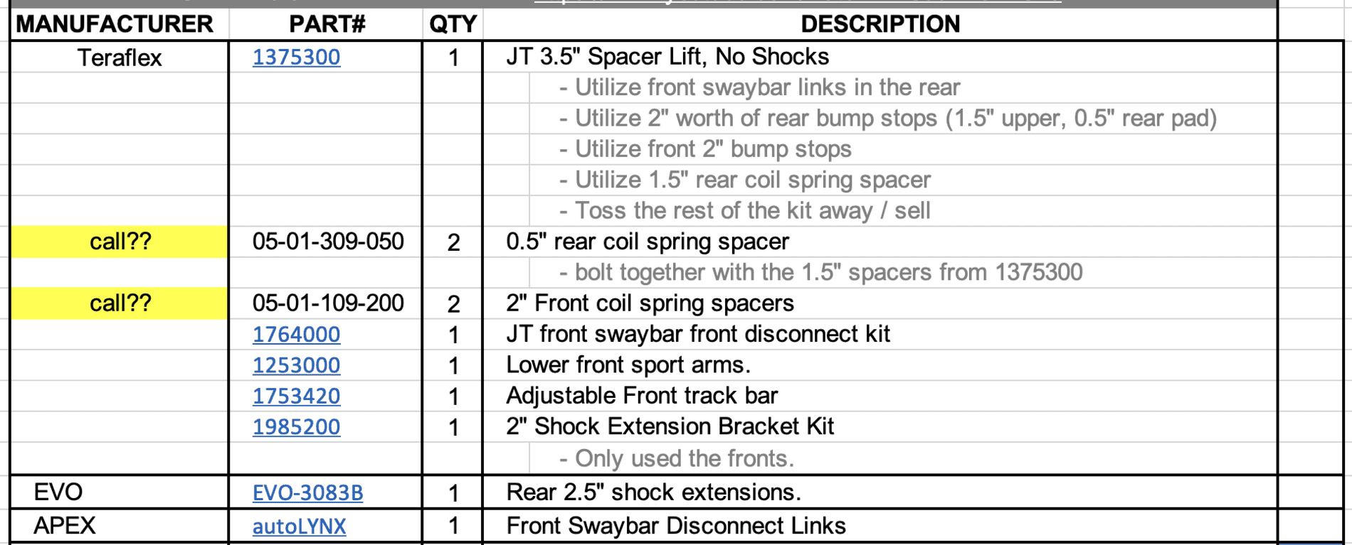

Contemplating lifts. I couldn't have picked a Rubicon and made it easy....no, I pick the Mohave because of all it's badass, restricting qualities like the lift. DO NOT want to compromise the 2.5" Fox shock system and engineering that went into this design. Bust must go MOAR high, not much, just a whittle.
FABTECH: https://fabtechmotorsports.com/product/2-sport-ii-lift-kit-w-shock-extensions-k4184/
- ORDERED but on the fence of actually using now. Buyers remorse? Want to keep Mohave ride quality as best as possible but with Fabtech switching springs, concerned this may not be the case.
AEV: https://www.aev-conversions.com/product/mojave-spacer-lift/
-Thinking I should have gone this route but this has been sold out forever. Looked at non-Mohave units and just missing the shock extension brackets...but sold out as well!
TERAFLEX: No kit available but thinking about using the youtube Mohave OMG 2.O build. My question is can you just order the coil spacers? They look to be out of the 2.5" kit.
Jeep Gladiator Oldskool's Mojave Science Project Screen Shot 2021-06-01 at 5.40.03 PM
Overall, cost is not the issue here; it's the best quality, capability and ride quality for reliability and comfort. Any input?
