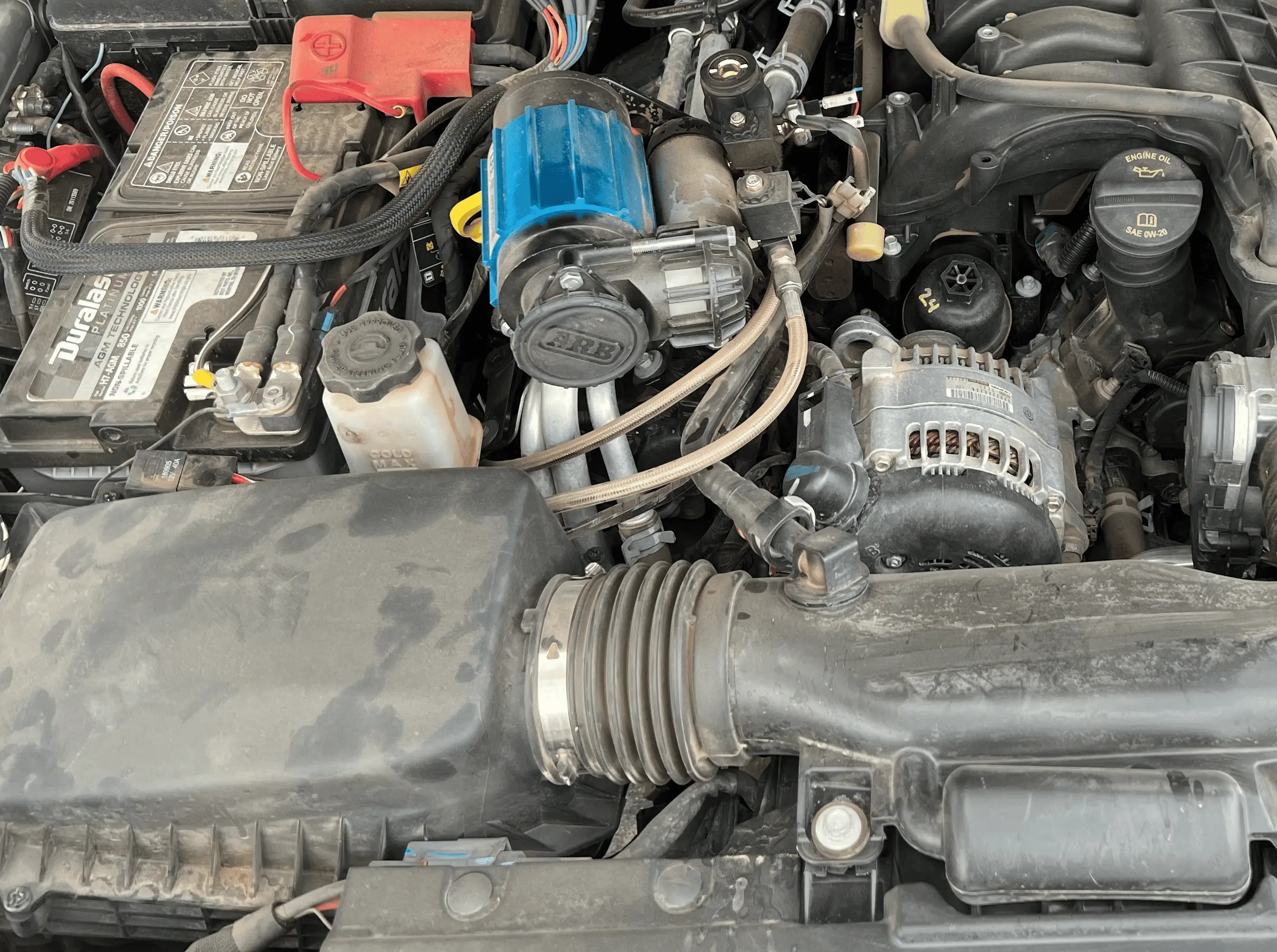

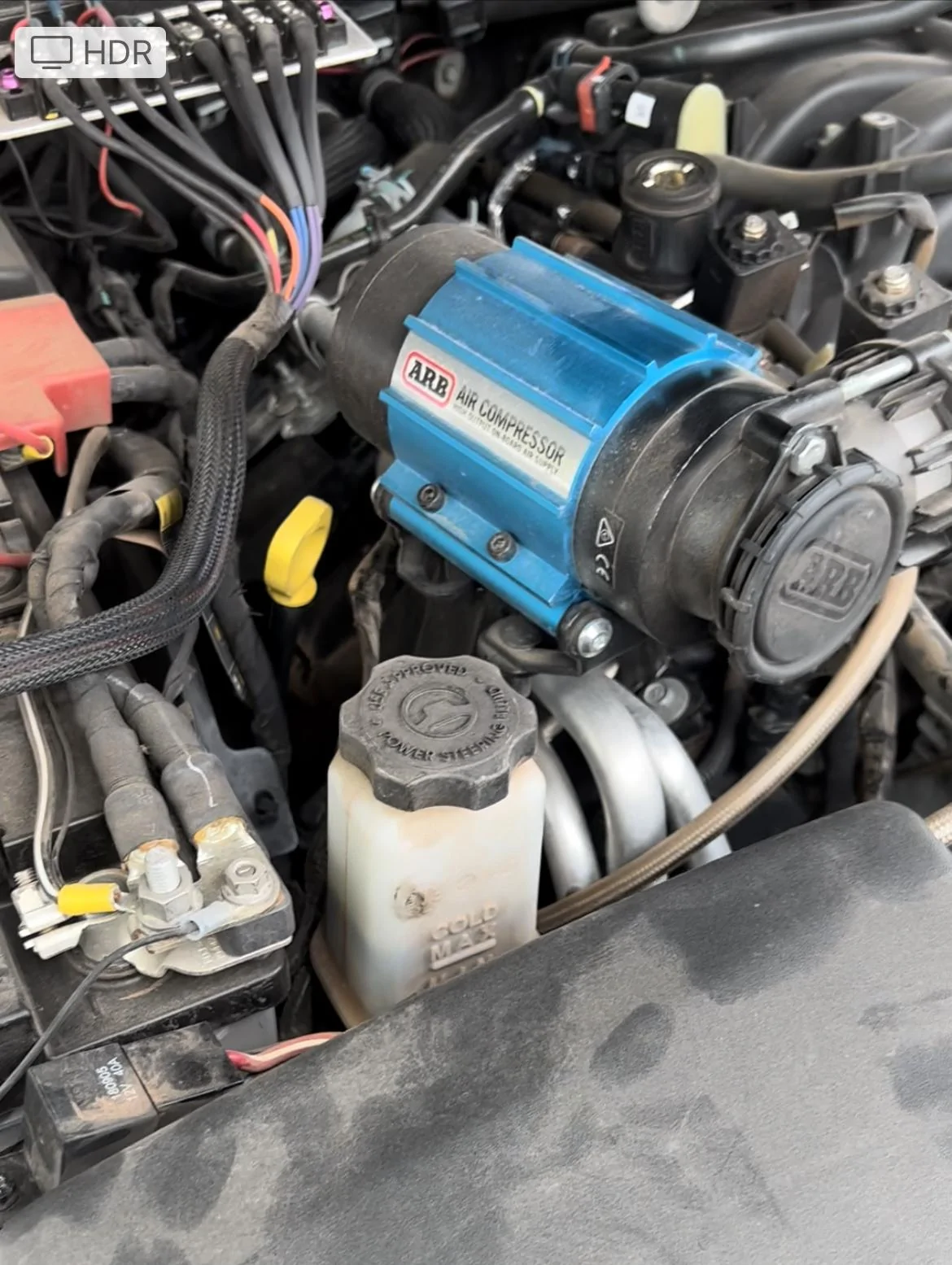

I also have an ARB single mounted under the hood. I have the chuck coming right off the compressor, and also F&R ARB lockers. I did not need an extra mount.... So just the compressor and the hose kit was like $350? There are fancier options but it gets the job done just fine. I can inflate my 37s from 13 to 28 in about 12-13 minutes.

Sure thing, my compressor is a single though, not sure if a double would fit in this space. I've attached a few photos here. Excuse the dirt....
Jeep Gladiator On board air: what’s it going to cost me all in ? tempImagen7cSwy
Jeep Gladiator On board air: what’s it going to cost me all in ? IMG_3912
Here's a youtube video that shows where I mounted my compressor (not my video): . Essentially just remove the engine cover and use the front passenger bracket to mount the compressor on.
I ran a 60" reinforced ARB hose to the front axle and 120" + 60" ARB hoses to the rear. I can look up the exact part numbers and fittings I ordered for the hoses if you'd like, just DM me. ARB 171302 was the hose kit I used that had the nice quick disconnect fitting.

Awesome, thanks!! I would like the part numbers and will send you a DM.
