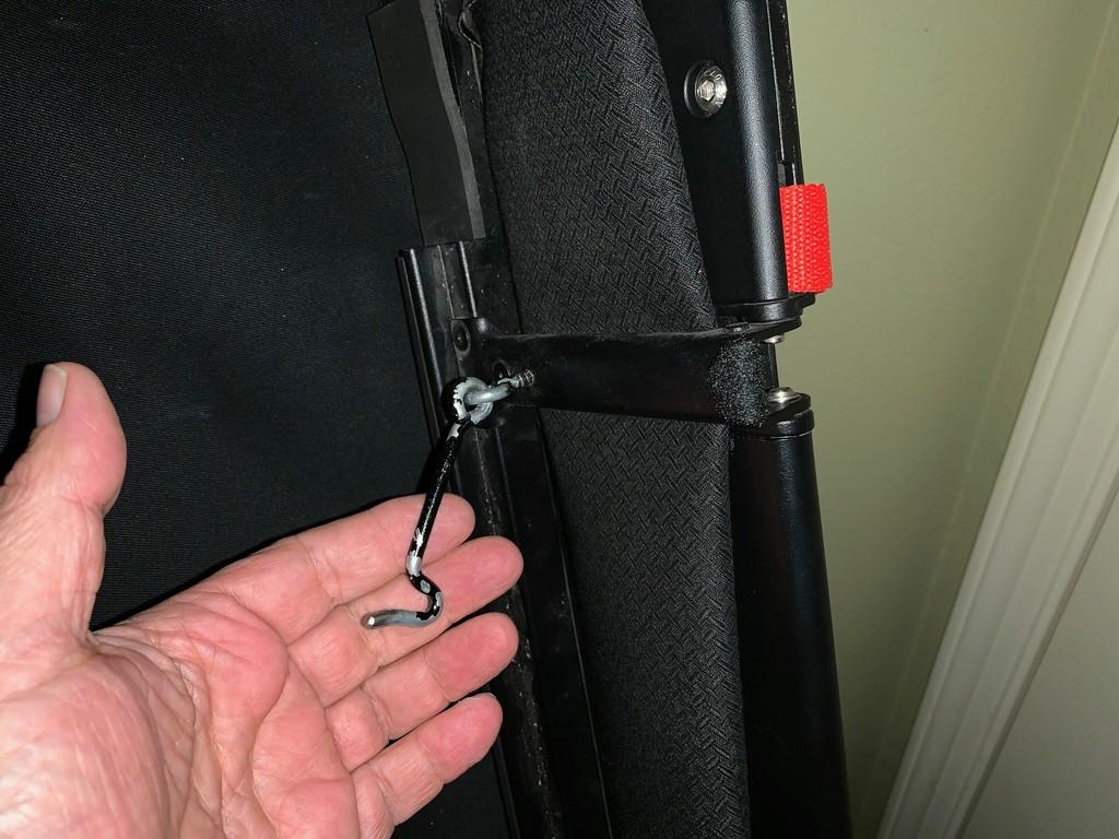

No, the stock soft tonneau is just a press fit, you can pull it up with the tailgate up. However, there is mod that I did with a "gate hook" from Lowe's which allows you to lock it down into one of the holes in the bed on each side. It works pretty good. You can find it with a search. Sometimes it will vibrate out when you are wheeling, but, if you check it before you leave your truck, you can make it so they have to cut the tonneau to get in. It is two gate hooks on each side that slide into one of the existing holes in the bed... I have since switched to a tri-fold tonneau for added security, but, I would recommend the mod to anyone concerned about security of the stock tonneau cover.

Can you post a photo showing the gate hook installed? Thanks

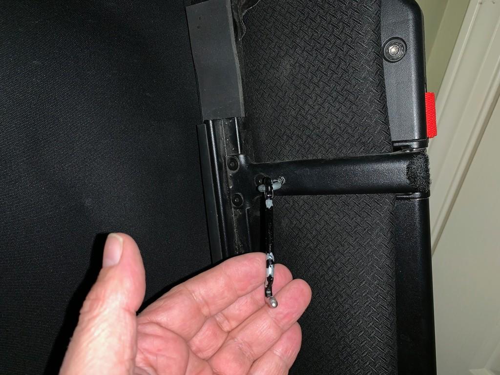

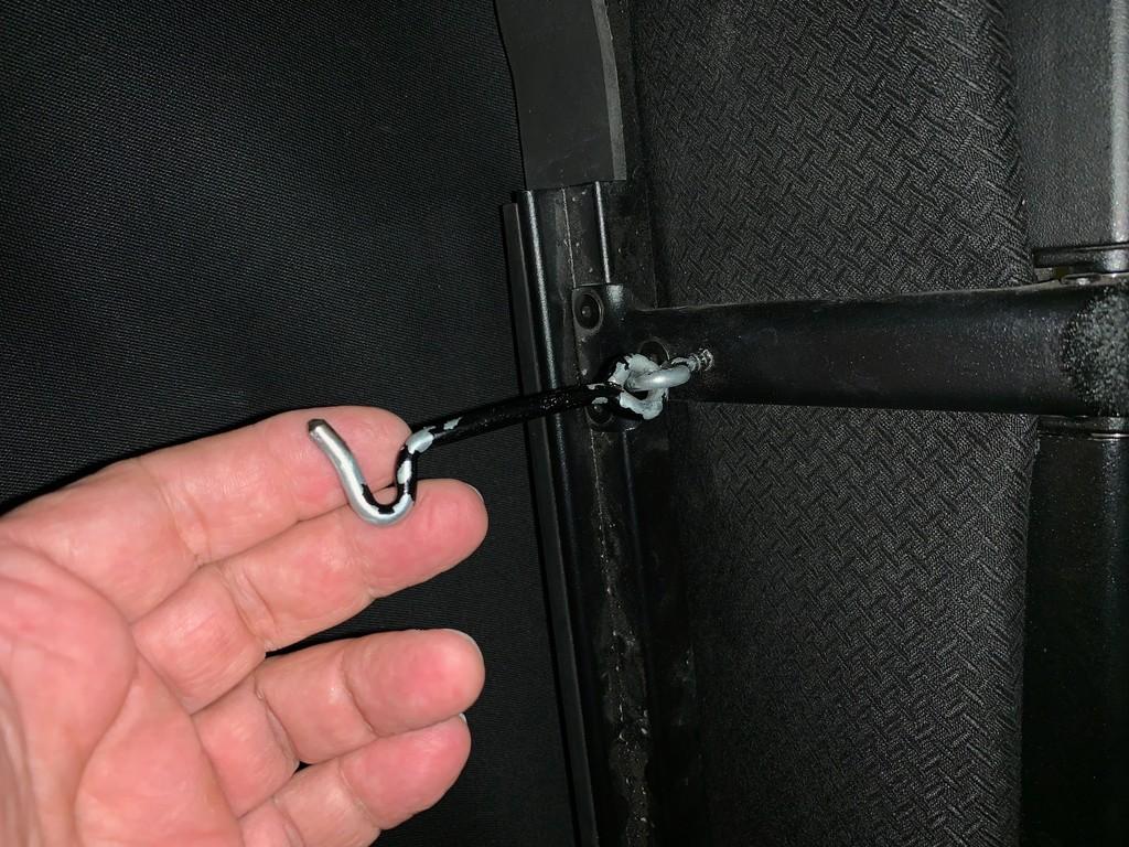

Here you go. My stock soft tonneau is already off my Gladiator, so, here are some pics of it. I painted the gate hook black which was a mistake. You have to drill through that tonneau support bracket and screw in the gate hook until it is just the right length to fit into the hole in the bed.. Put a piece of wood between the cloth and the support, so, you do not drill through the Tonneau cover cloth.
Here is a link to one of the original install threads of this "gate Lock" solution
https://www.jeepgladiatorforum.com/...ver-to-actually-lock.19118/page-6#post-363300
That is a great idea. I also love the diamond back covers because of how stout they are. I just didn't want a hard cover for me personally on my JT. To the OP, If you can just pop your cover open and roll it up so easy, maybe you should opt for some of these other choices out there like the diamond back.
