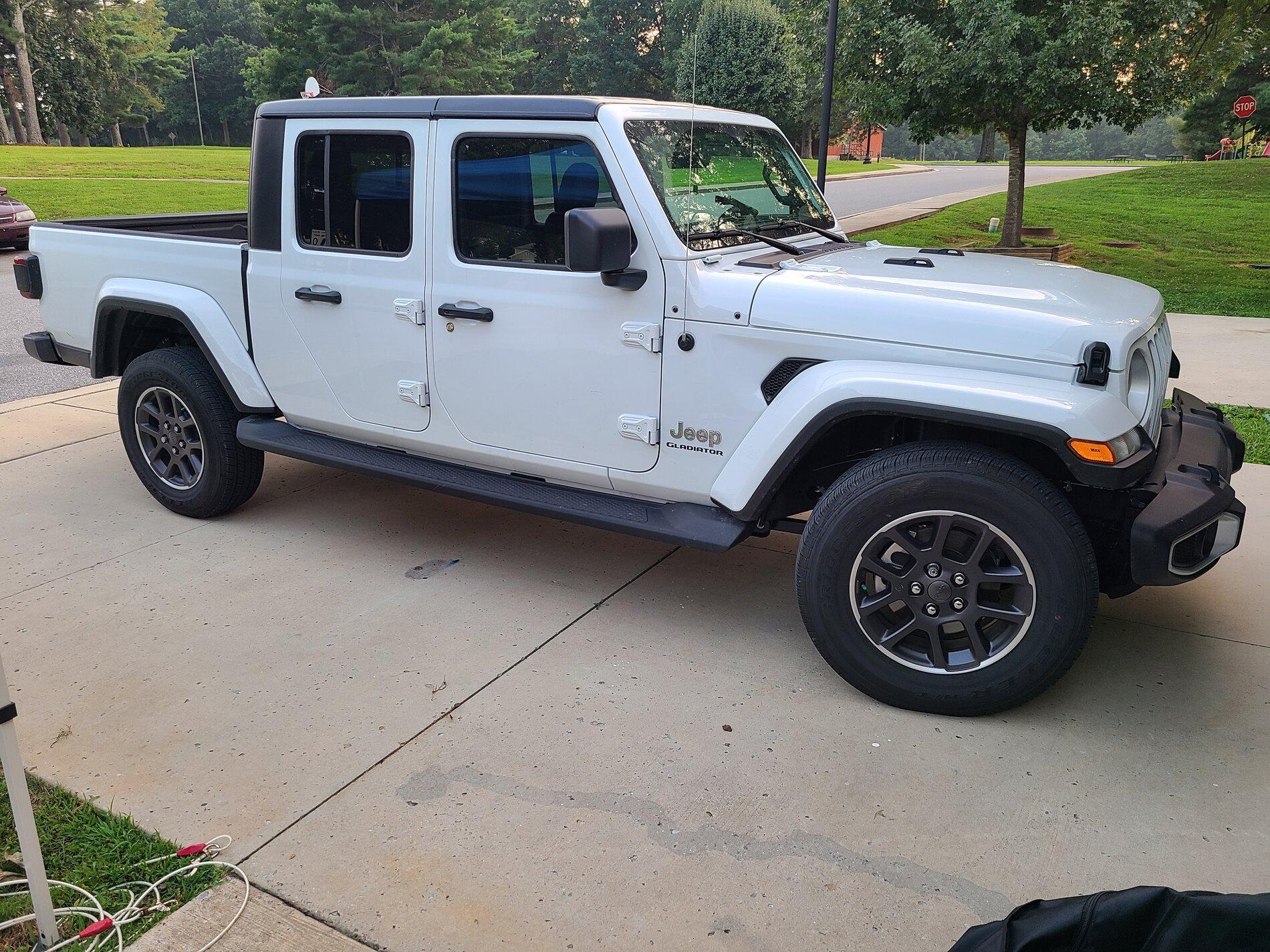

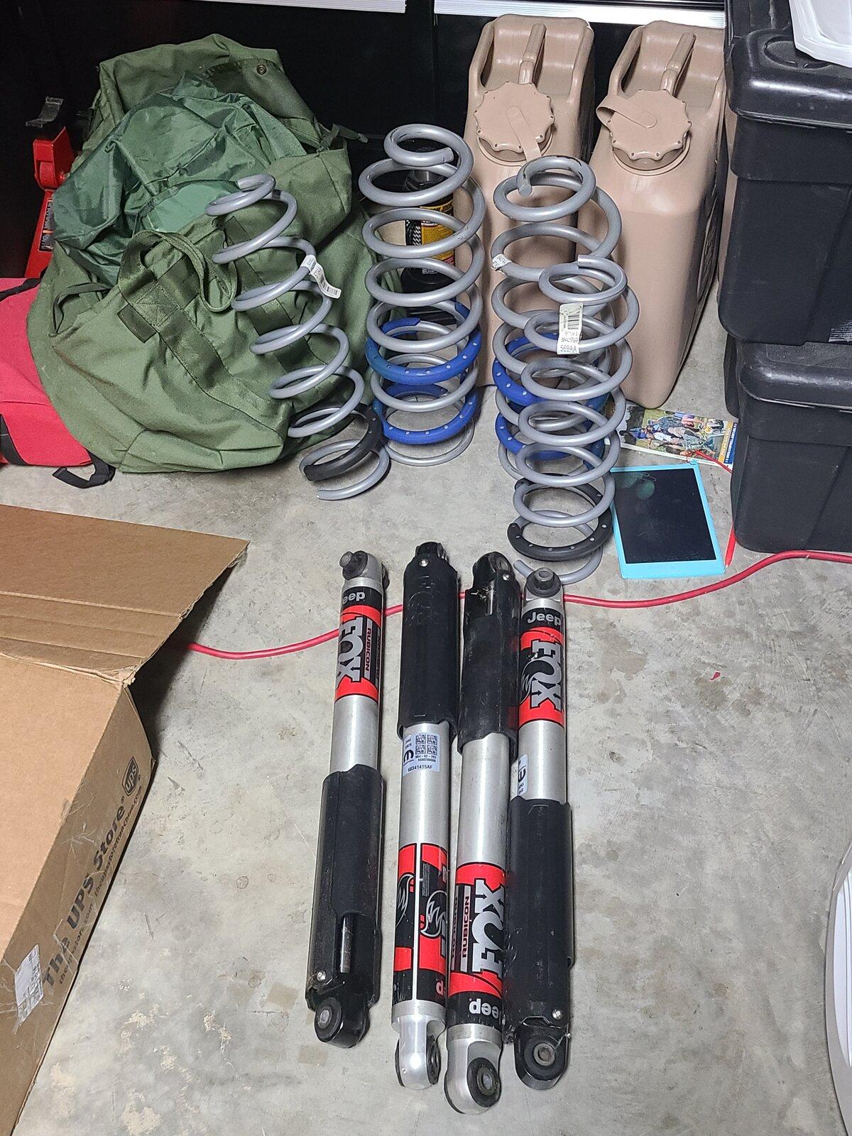

I have an overland, was contemplating different lifts and wheel set ups i wanted. Then I got the orders overseas and found out I have to have factory optioned suspension.
I got an awesome deal on Mojave springs, and even more killer deal on a set of rubi shocks. I was going to go with falcons, but those would have been almost 5 times what i got the rubis for.
I feel like I should just send it, i havent seen anyone else swap in Mojave springs on an Overland....
Maybe Ill just build a Mojaverland...

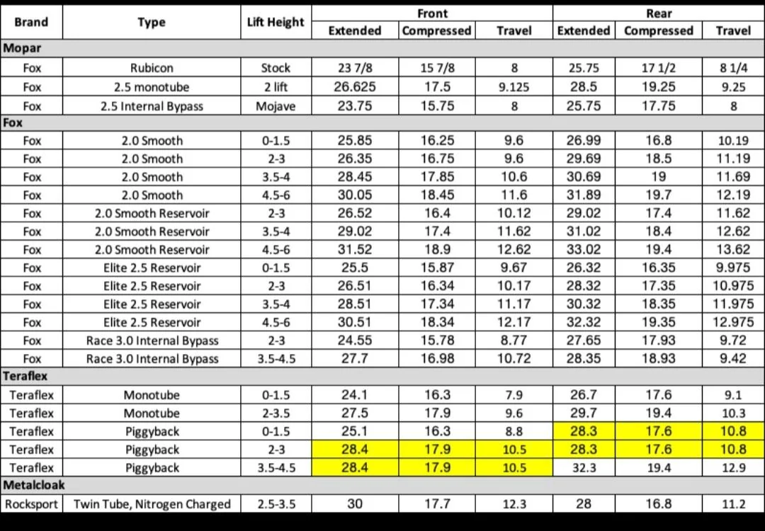

forgot, this was the chart where i saw the rubi and mojave shocks have very similar travel and dimensions

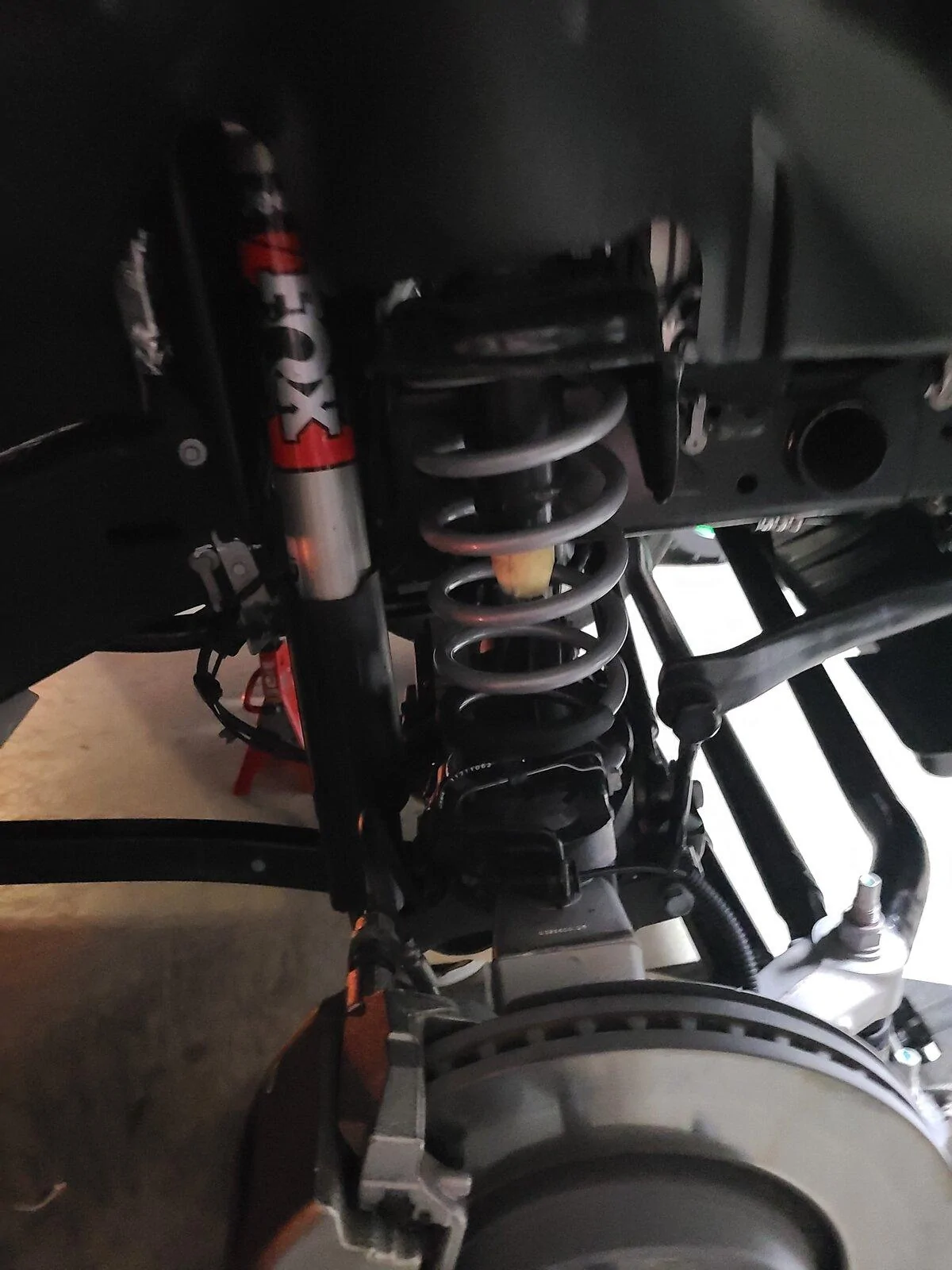

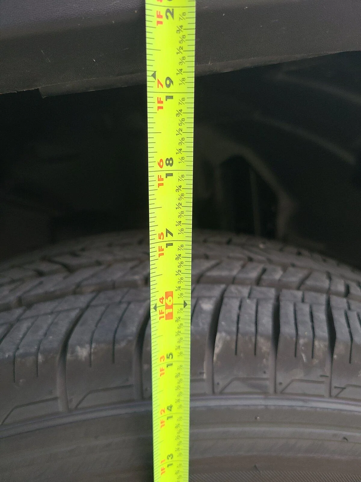

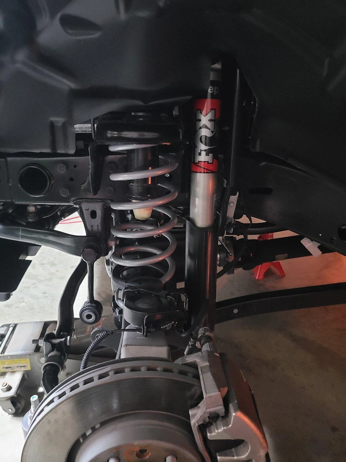

its gonna happen. just got the shocks in today

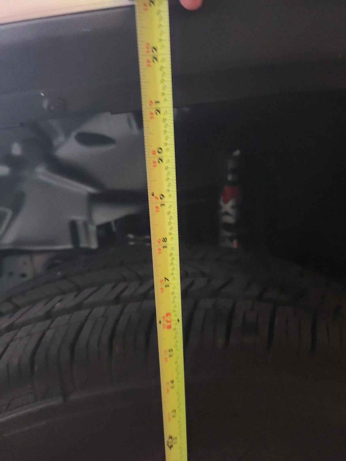

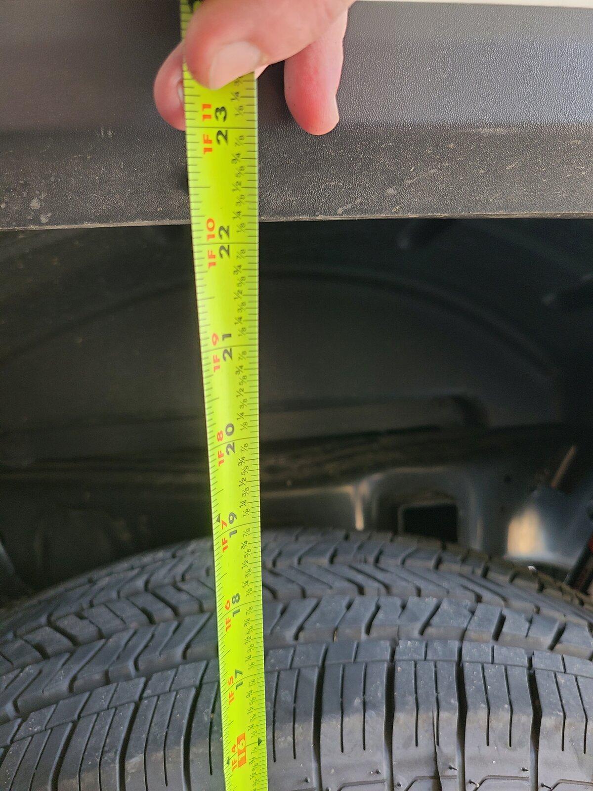

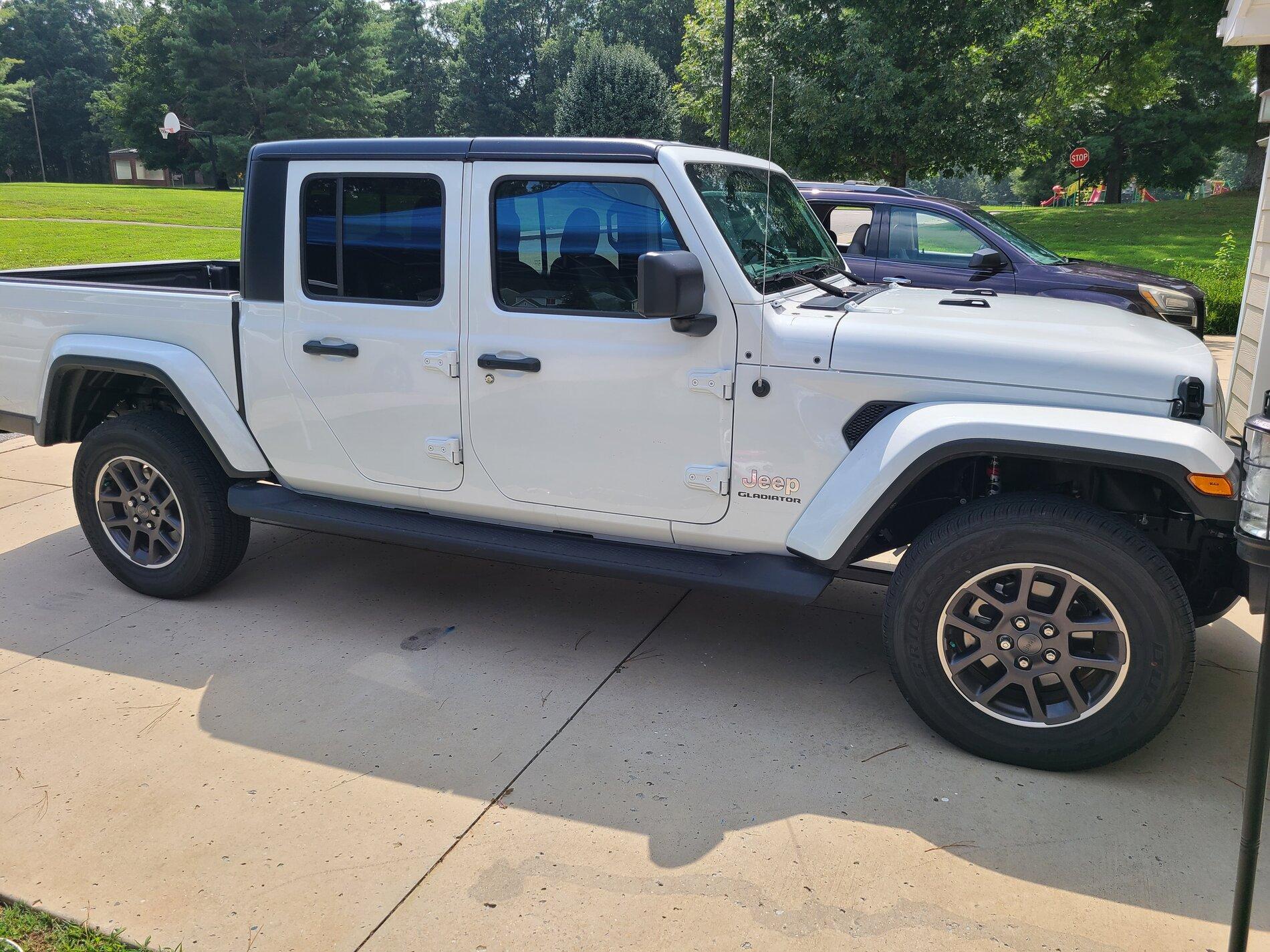

heres for the negative nancies. same spot in garage and on jeep. just the front. turning jeep around in garage now to do the back.

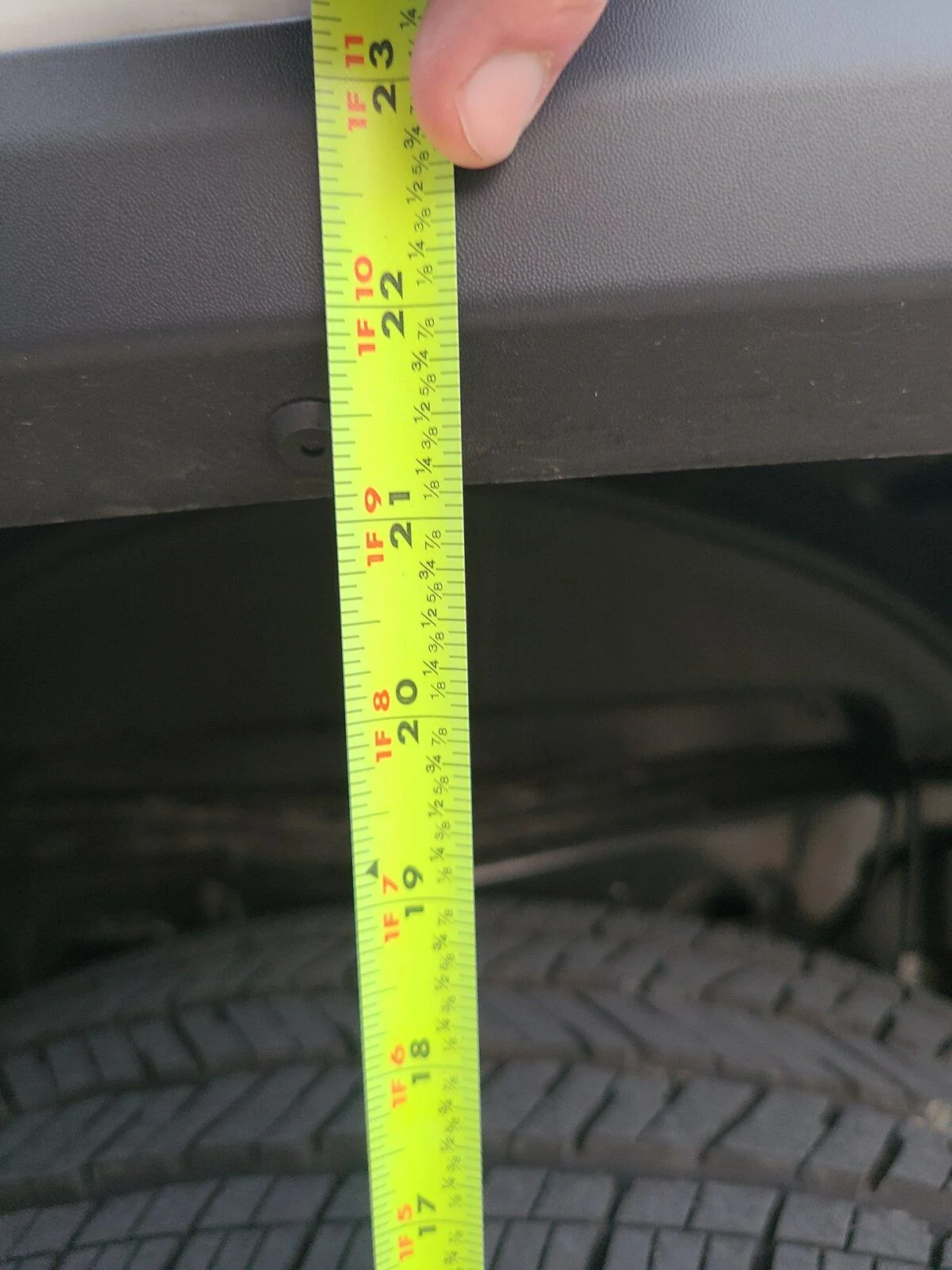

heres the gain on the back and before and after

i got a killer deal on rubi take off for this. figured they would do while i save up for falcons, or something else. so far it is amazingly better. probly cause they are newish shocks. definately a good change from stock overland crap
