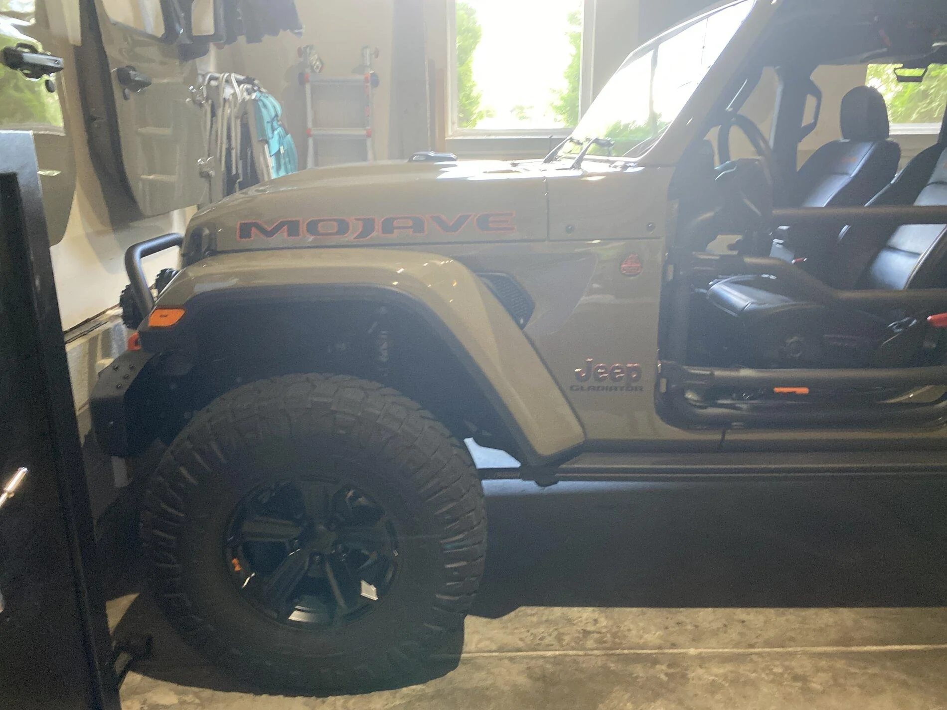

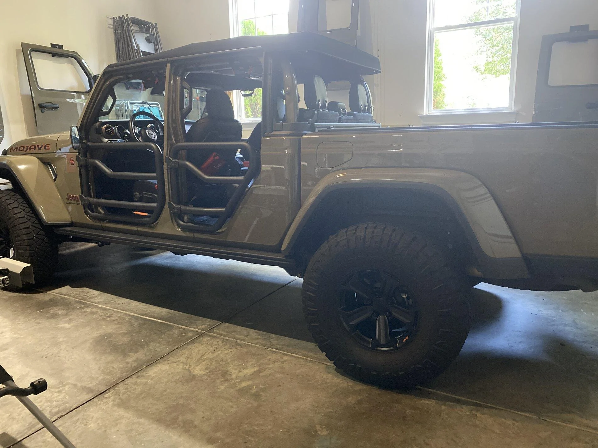

FWIW this is my Mojave. I have a spacer lift but intend to ditch the spacers and change the coils. I have all of the other goodies under there. The spacers worked great (and probably still would in perpetuity) I was just reluctant to jettison my fancy Mojave springs initially.

Looks great. 2 inches and 37’s?

Effectively yes and thank you. The 3" spacer up front (rear is 2") handles the steel bumper, winch, bull bar and KC's.
What coils are you going with? Which shock extensions are you using with your current spacer lift?
