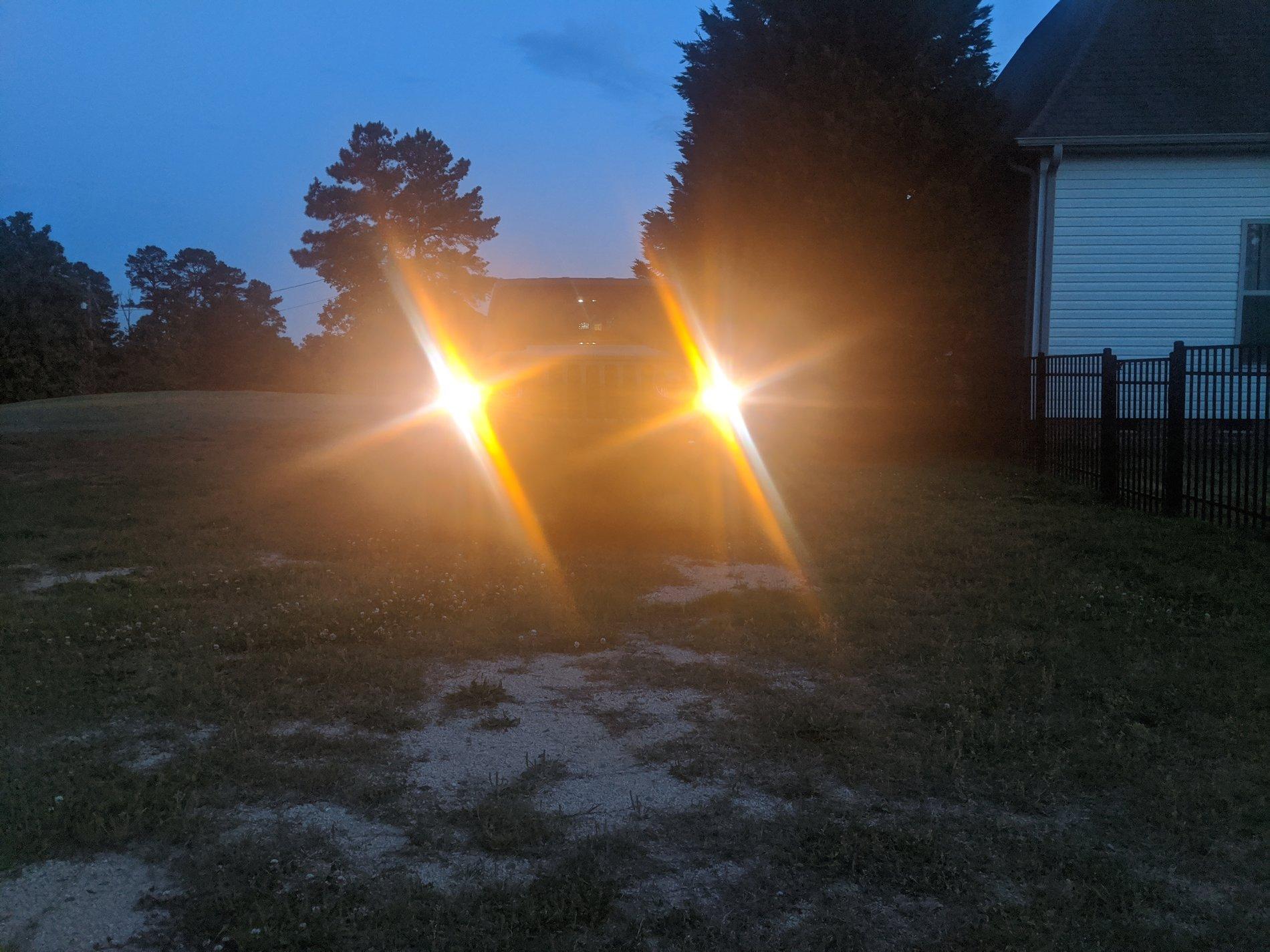

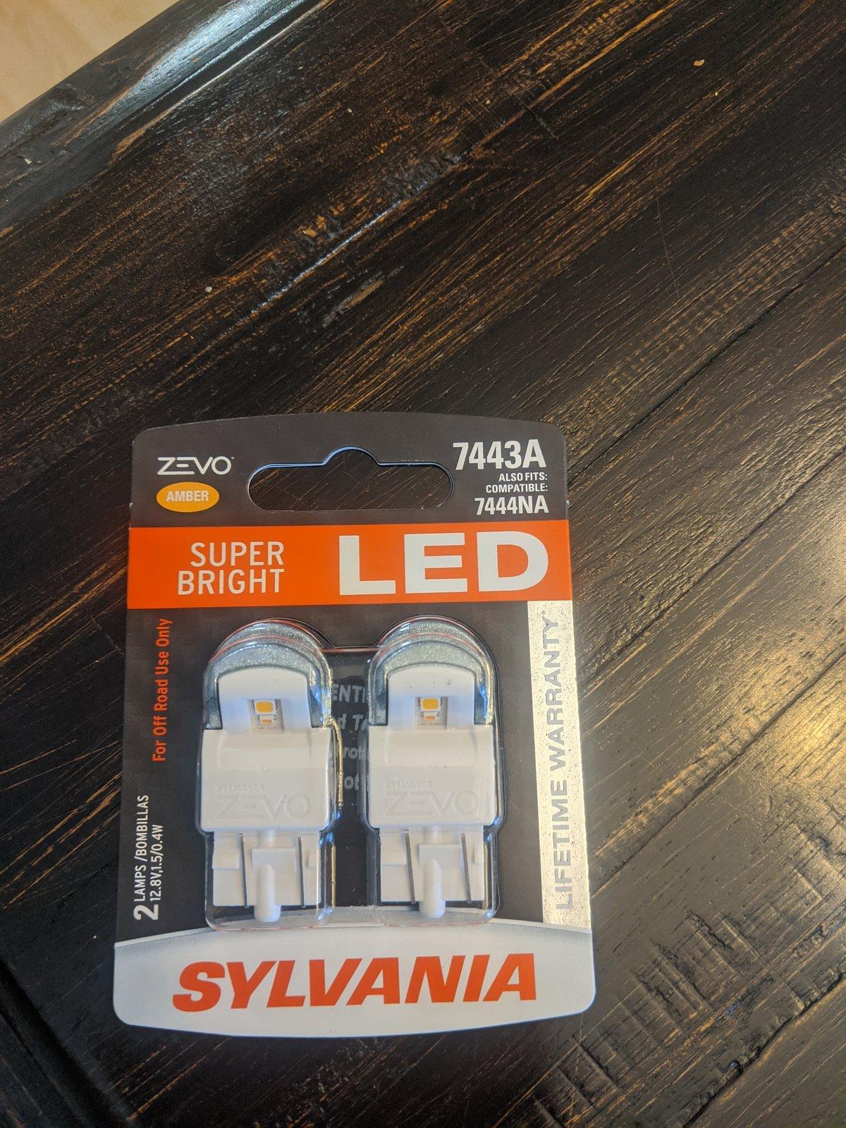

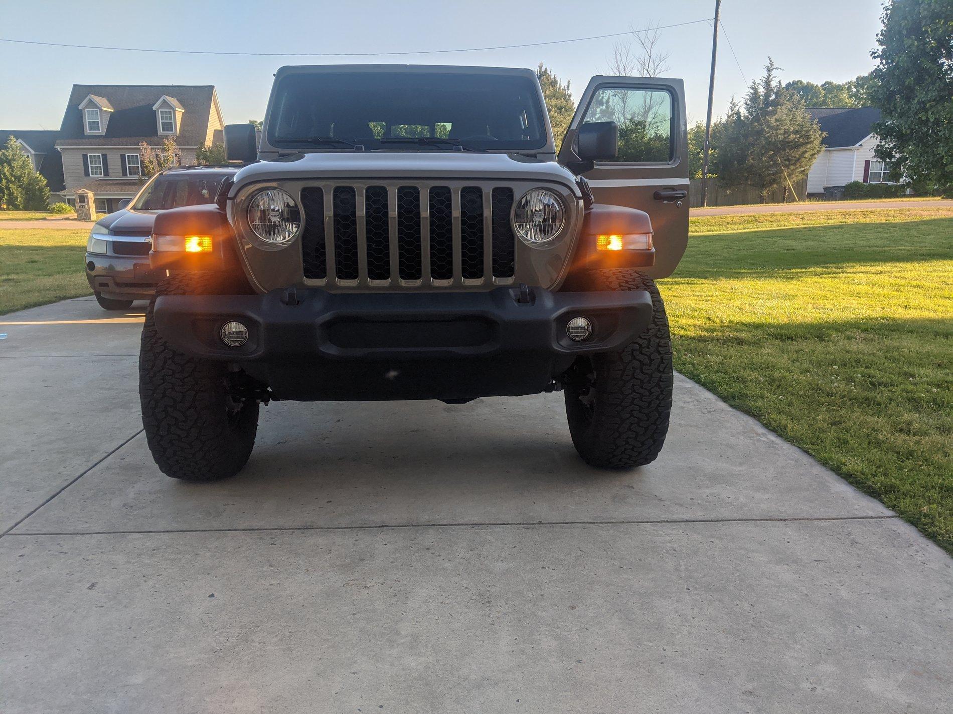

Working with zero issues. I have a Max tow but none of my LEDs I added required resistors or a flash

Awesome thanks for the tip. I will probably install my blinkers over the weekend. I went to autozone and they had the ones you mentioned in 6000K white but if i install then and the same thing happens i can’t return or exchange so just to be safe I’m going to let the shop that did my headlights fog lights and DRL take a look at the issue so i can return them there and buy the sylvannia ones.

I second the sylvania zevo's, have them in my max tow as well, ZERO issues for 2 months now, always work as expected and didn't affect any other blinkers or cause bulb out warnings.
