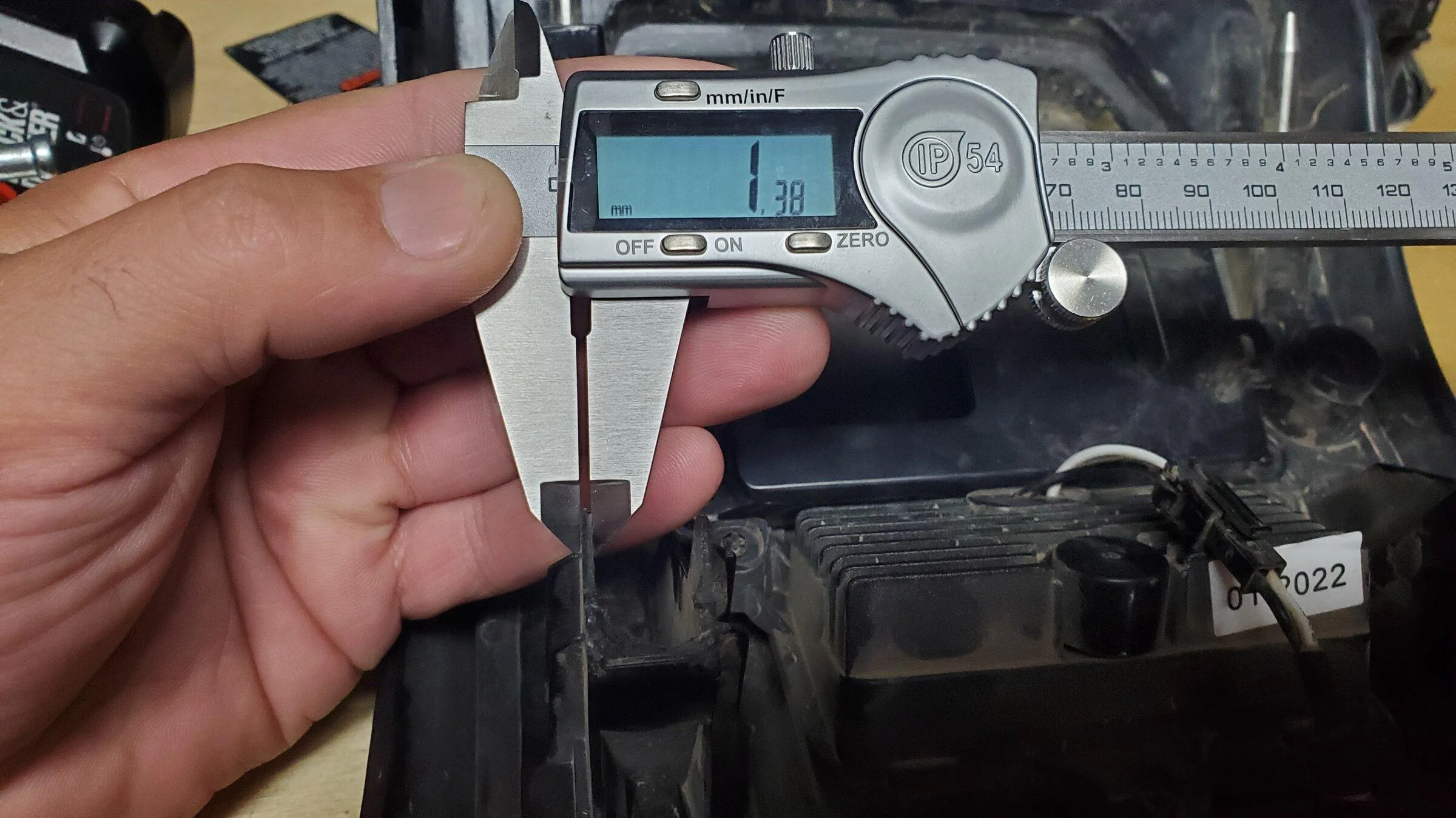

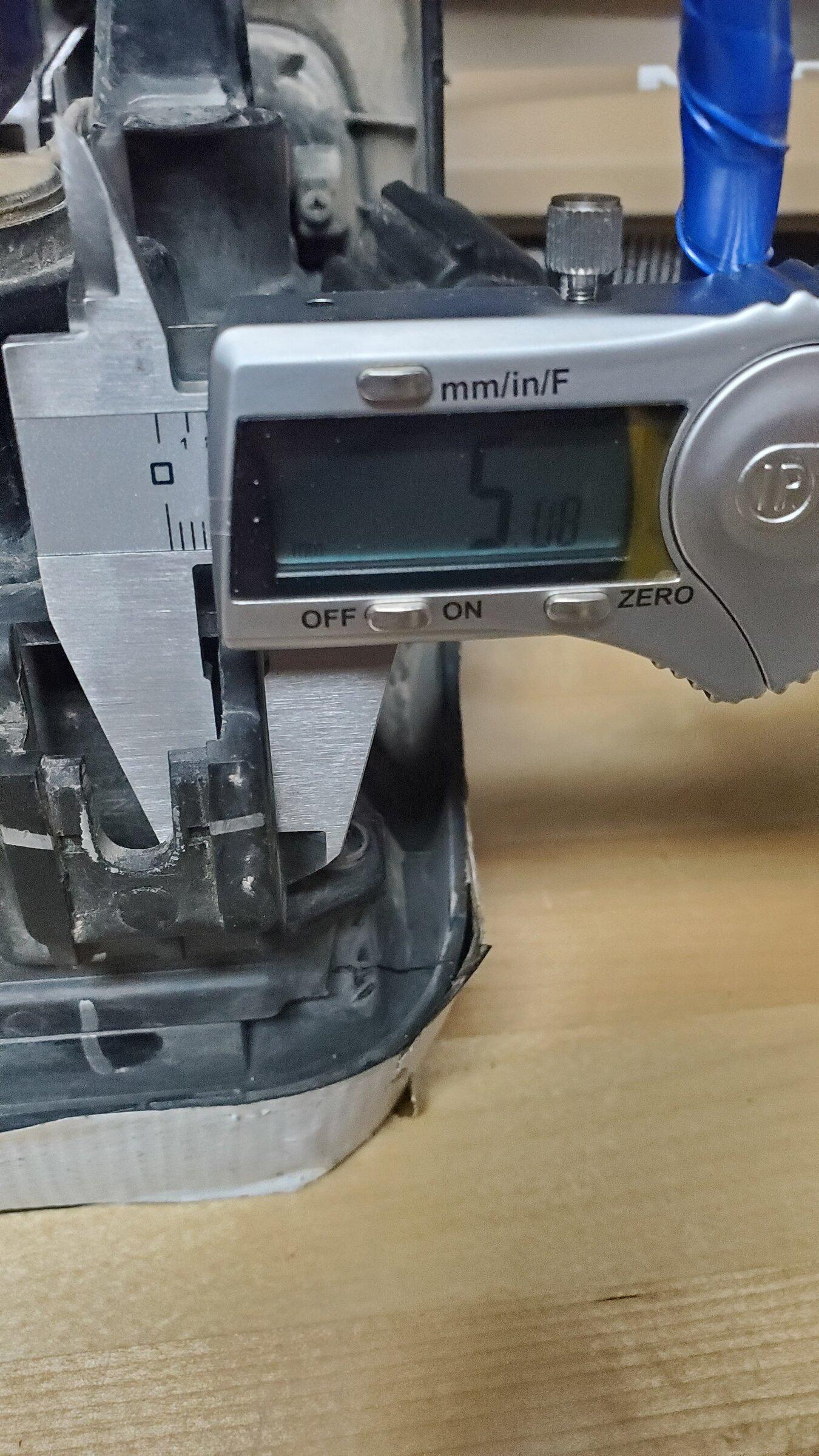

Since you are unable to provide torquing specs or a scientific explanation behind this problem, I’ve decided to take a stab at it. The walls of the posts are only 1.3 mm think and are not reinforced or connected to anything on the sides. That’s right, 1.3 mm of thin plastic is all that’s holding the 5+ pound lights to the body of the Jeep through high speeds and vibrations of offroad. On top of that, the lights are not flush with the body leaving a huge gap for the wind to get inside and rattle the entire assembly. Over torquing, under torquing or just right torquing has nothing to do with it! In comparison, walls on OEM lights are over 5 mm thick and connected to the rest of the lights assembly on all sides for a nearly indestructible hold.

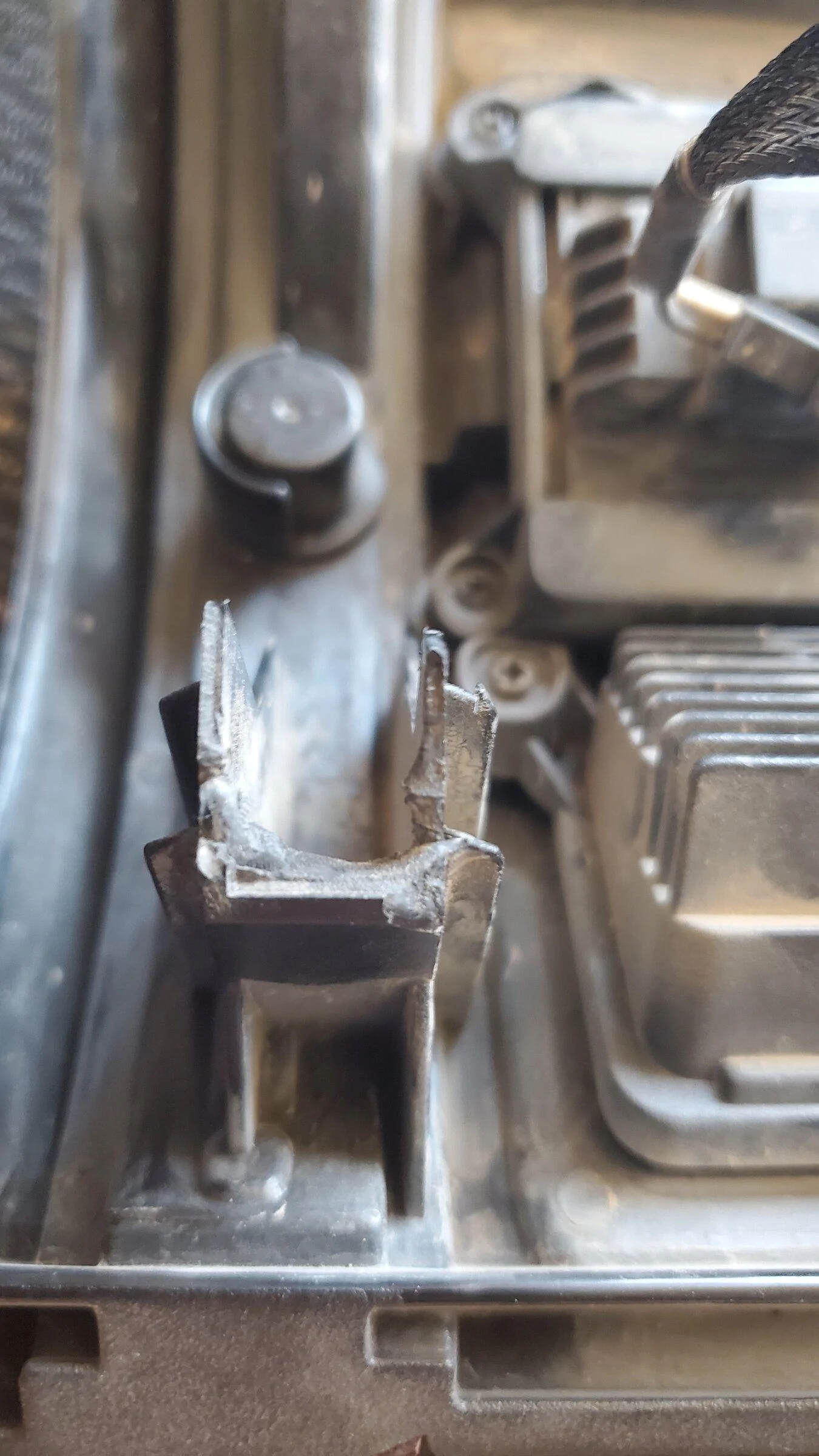

These were tightened by hand and I stopped after encountering the slightest resistance but according to the manufacturer that's too tight. Unfortunately, both posts completely ripped off, see pics below. My guess is that the wind got inside at high speed and just ripped both posts out
Jeep Gladiator Oracle Flush Mount Tail Lights cracking? 20220425_110517
