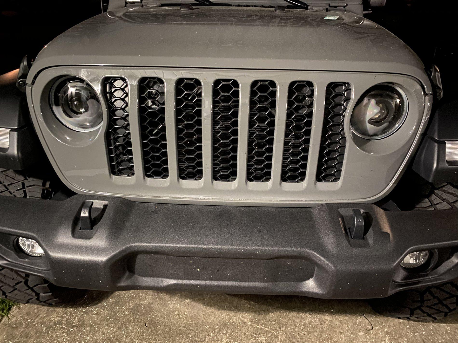

except the oculus project an absolutely absurd amount of blue to those oncoming anyway. I’m really bummed about my purchase. Between the blue hue and reflect off all street signs, the relatively dim halos, and the fogging lenses... I wouldn’t make the purchase again nor would I recommend them to others.
Damn, that much condensation inside the lens is really disappointing. Especially at this price point.

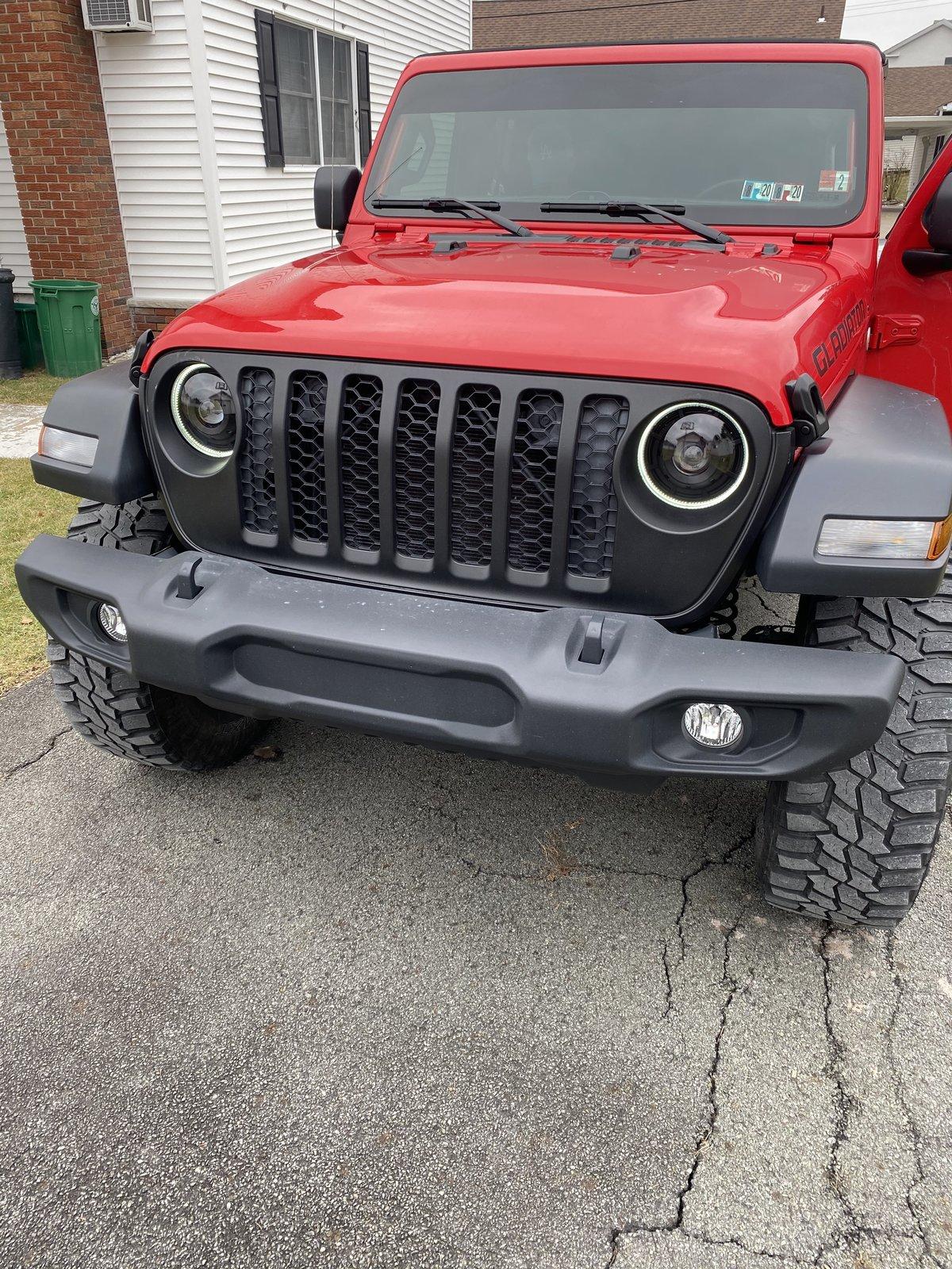

Installed a set the other day. I think they have made a big difference in light output. I did have amazon led bulbs in prior and although they may have been a little brighter, the Occulus projects a much more crisp and consistent beam pattern with a much better cut off. I could probably lower the beam slightly but not a single oncoming vehicle has flashed me so far. A little fogging in the lenses at times but have had that with other headlights so certainly doesn’t bother me and does dissipate soon after. I’m happy with the purchase.
Thank you for your feedback and purchase of our product! Glad to hear you are happy!
I installed a set of Oculus Bi-LED on my Gladiator the light output going from stock Halogen lights to the Oculus was amazing. The cut off is sharp and crisp. As far as the blue tint it is no different than my Toyota Corolla with led projector lights. I put them side by side and the blue tint is the same. I am in lower Alabama by the coast and have noticed the condensation one time last month.

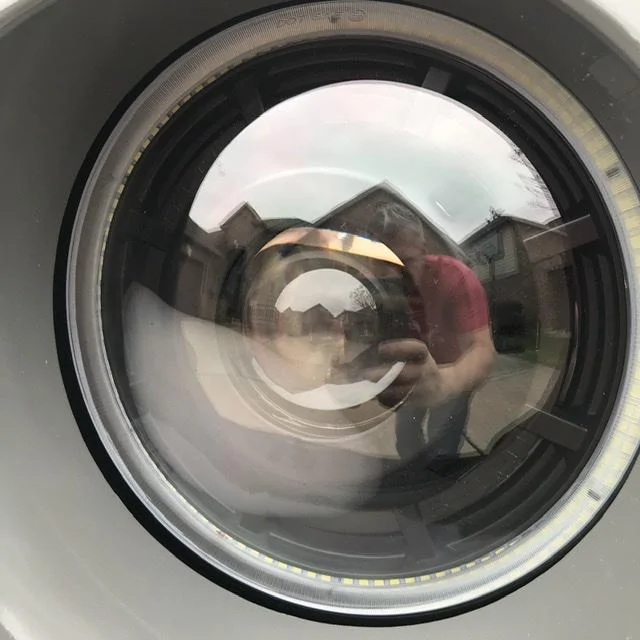

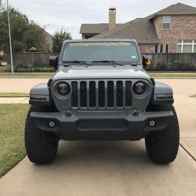

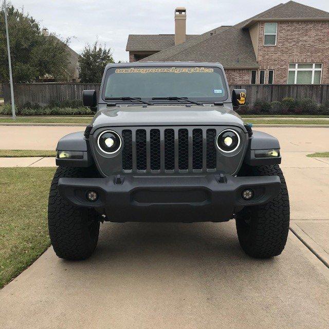

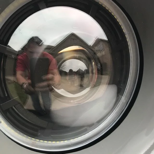

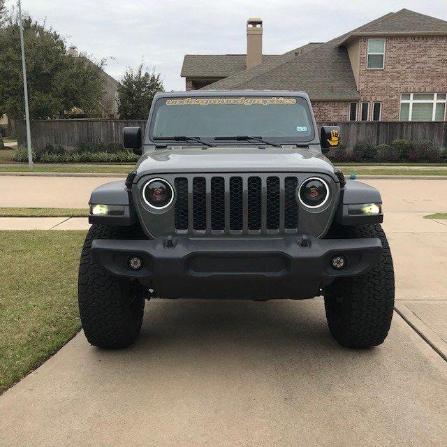

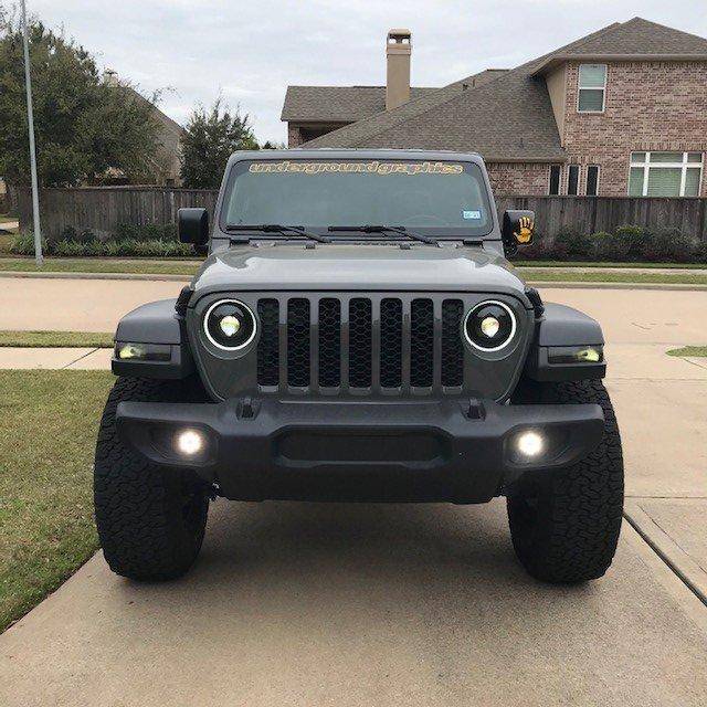

View attachment 65413 View attachment 65410 View attachment 65412 View attachment 65413 View attachment 65410 Just did the install today, along with a few other pieces. Was super stoked for this, only to get home and see the condensation/fog. What’s up Oracle?!
Thanks for your purchase and your question! The condensation you’re seeing is normal for the first few uses as the moisture in the humid air trapped inside of the headlights during assembly in our New Orleans office evaporates when the inner temp rises. It should dissipate with a little time or this can be cleared up quickly by parking the Jeep with the lenses facing direct sunlight.
So am I correct in saying these are vented housings, not sealed. Went through a car wash yesterday and the entire lens was spotted. And yes, as the weather warmed, and the sun hit the lenses, it went away. But what if we have rain for a few days? What if our weather is humid and overcast? These issues do not affect OEM lights. I;m really wanting to love this purchase, but I am concerned. I absolutely love the function, the look, but this fogging issue, while you say is normal, I feel is not. ....nothing worse than a great looking Jeep with awesome aftermarket headlights getting attention and then explaining, ..."oh, that's just how it is, it's normal, it will go away." LOL
I'm gonna give it a bit more time, ...while I fill out the warranty/registration card. Thank you for the prompt response as well. ;)
JRobes
Oct 27, 2019
935
1,469
South Dakota
Enginerd
Yes, they are saying their headlights are not sealed by stating this:
...The condensation you’re seeing is normal for the first few uses as the moisture in the humid air trapped inside of the headlights during assembly in our New Orleans office evaporates when the inner temp rises....
If they were sealed, the humidity level of the housing's air would remain regardless of heating/cooling cycles (unless that trapped moisture can be absorbed overtime into the housing's materials).
Since it's not sealed, heating/cooling cycles of the air trapped in the housing will force mixing of ambient atmospheric air with the housing air since the air volume increases when warm and decreases when cooled. So the more cycles that happens, theoretically the more dry ambient air will mix in with the humid trapped air assuming you're in a location with less humid atmospheric air than New Orleans.
Another reason the fog temporarily goes away is that warm air can hold more water content than cool air. So when the air in the housing warms (headlights on), the moisture can be absorbed by the warmed air in the housing. When the lights are turned off and the front glass of the housing cools by atmospheric air (or the car wash's cold water jets), the housing's air also cools causing the moisture that was absorbed by the housing's warm air to re-condense on the inside of the cooled glass, hence the fog you see.
Long term, I'd be concerned that if ambient air can get in, so can any particles (dirt/dust) that's in the air, and those particles would more and more stick to the fog that occurs on the inside of the glass, and you'd be left with no way to clean it off. Maybe they have a small air filter where the air is allowed to enter/leave the housing to alleviate this issue though. Having them sealed with dry air or some other internal gas would be best though.
If they were sealed, the humidity level of the housing's air would remain regardless of heating/cooling cycles.
Another reason the fog goes away is that warm air can hold more water content than cool air. So when the air in the housing warms (headlights on), the moisture can be absorbed by the warmed air in the housing. When the lights are turned off and the front glass of the housing cools by atmospheric air (or the car wash's cold water jets), the housing's air also cools causing the moisture that was absorbed by the housing's warm air to re-condense on the inside of the cooled glass, hence the fog you see.
Hey guys, was just typing out a reply...good timing and thanks for chiming in with your words! :like:
Actually, almost all modern headlights have some form of a ventilation system (whether venting channels or small holes/slots) to allow air to pass in and out of the housing to regulate temperature and any pressure. These will not allow any foreign objects into the housing; if you do see sitting water (not condensation) or dirt inside the light, you might have a compromised housing or seal.
Just as condensation works when your windows fog up, it will dissipate without any adverse effect on the light's function or longevity. We have these headlights on our daily driver Jeep in Louisiana where extreme weather is just a fact of life (lol), and these perform as intended...rugged durability with superior light output in any condition. Thanks again for your curiosity, and you can find info on the Oculus 2-year limited warranty here ;)
