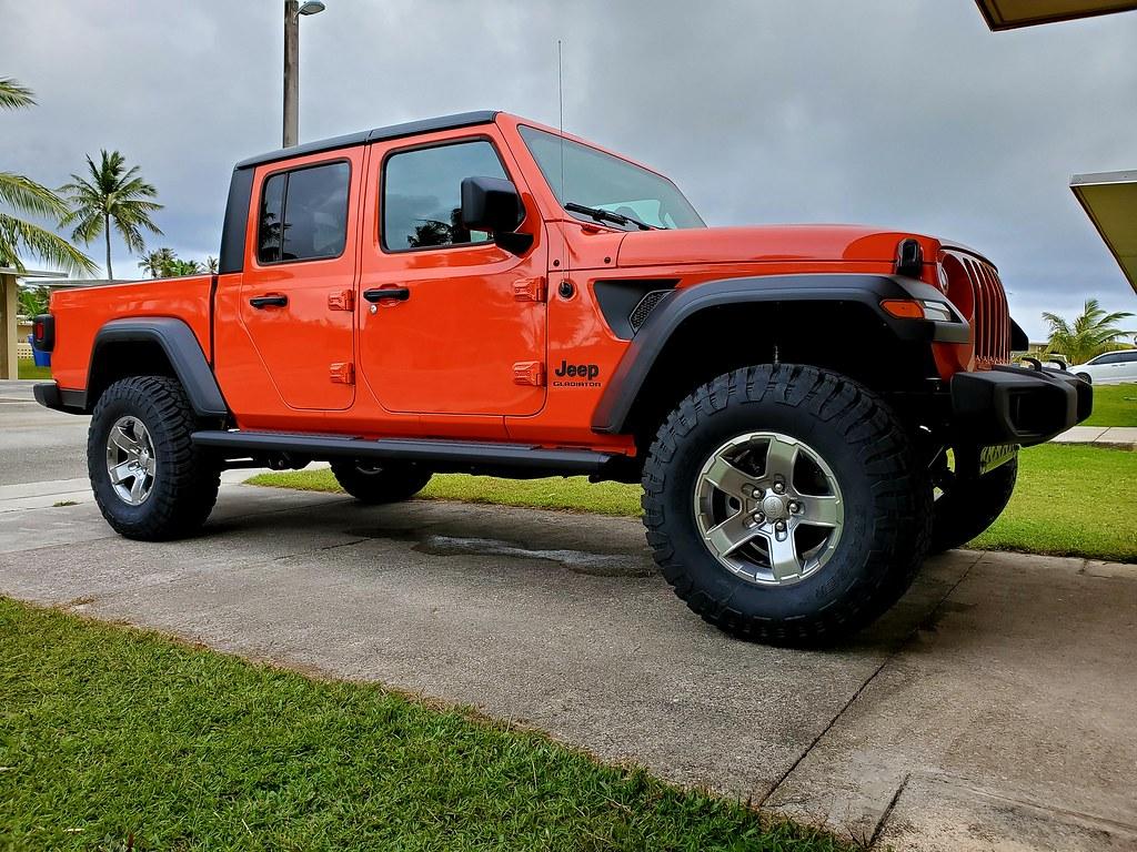

Intro

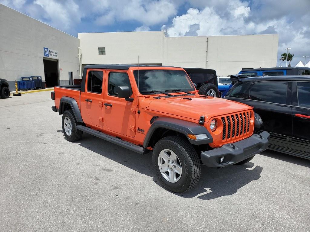

I hope to use this as a journal for part numbers, build inputs, and to track progress. I have done many of these Jeep builds on jeepforum, JK forums, and other sites. I have really enjoyed everyones work so far and on categorizing their builds, I am learning from them.
An Island Tale
My wife and I recently moved to the beautiful Island of Guam. While here, we were not intending to do any major purchases or moves financially. Things changed when we saw the new Gladiators on island. There only only a few of them and we decided to move on one of them. There are some strange circumstances in island purchases since the dealer is the lone FCA dealer on island. The other issue arises in that its a lot of money to have anything shipped to the island. Parts, services, upgrades, wheels, tires, all cost so much more here. So with this we have to be very careful with upgrades and value added for the dollar spent. I guess at the end of the day that is something we are all trying to do.
The Name
I have changed it about 5 times, I cant seem to settle on a name and it will change over time, as I build it. The thing is with the ARB lockers, 35 spline shafts, and all the equipment, I was leaning towards an Aussie inspired name. We shall see.

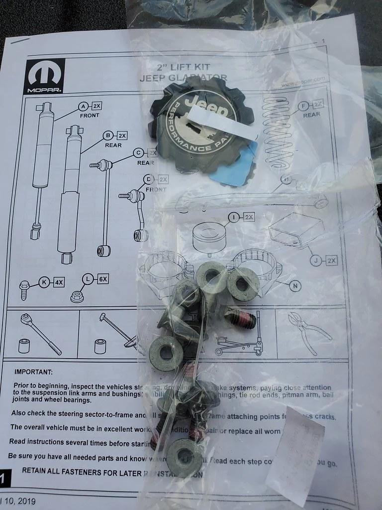

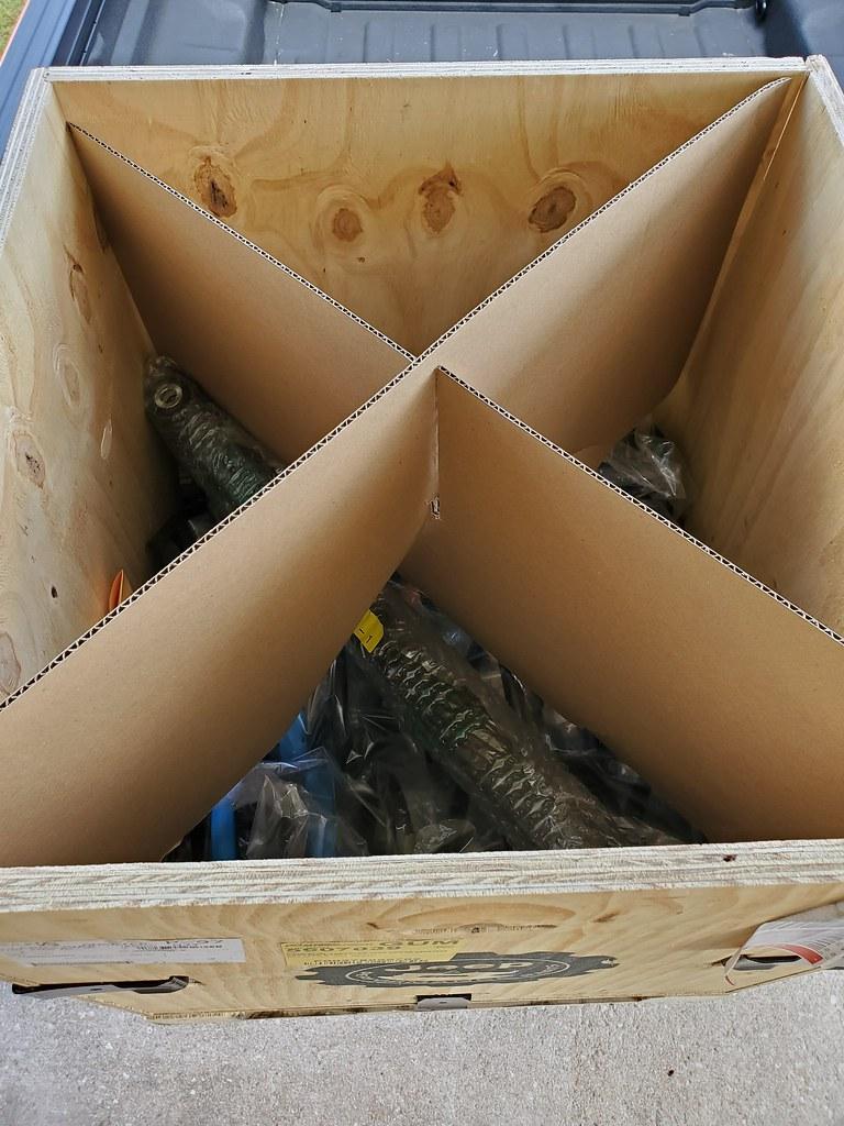

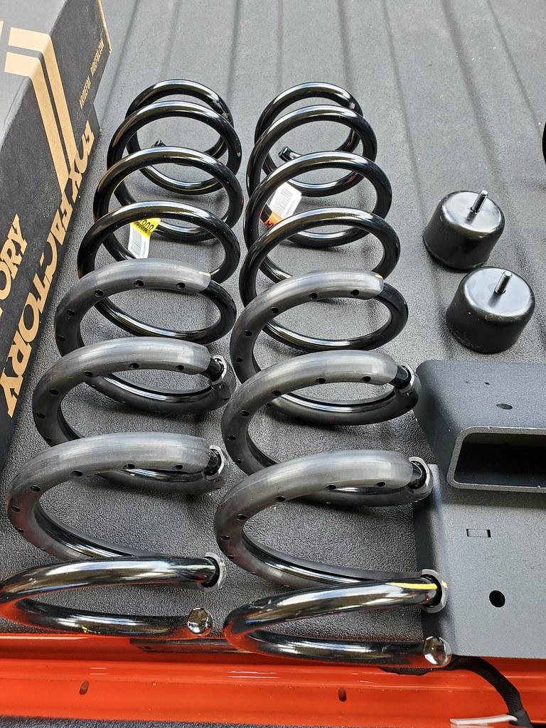

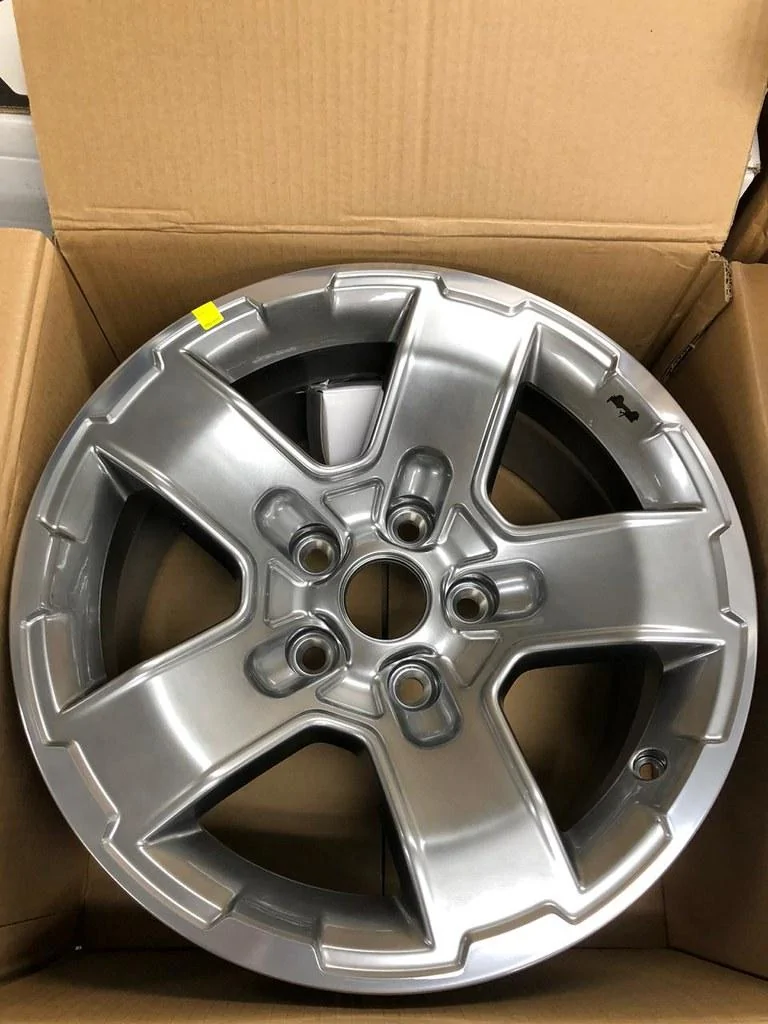

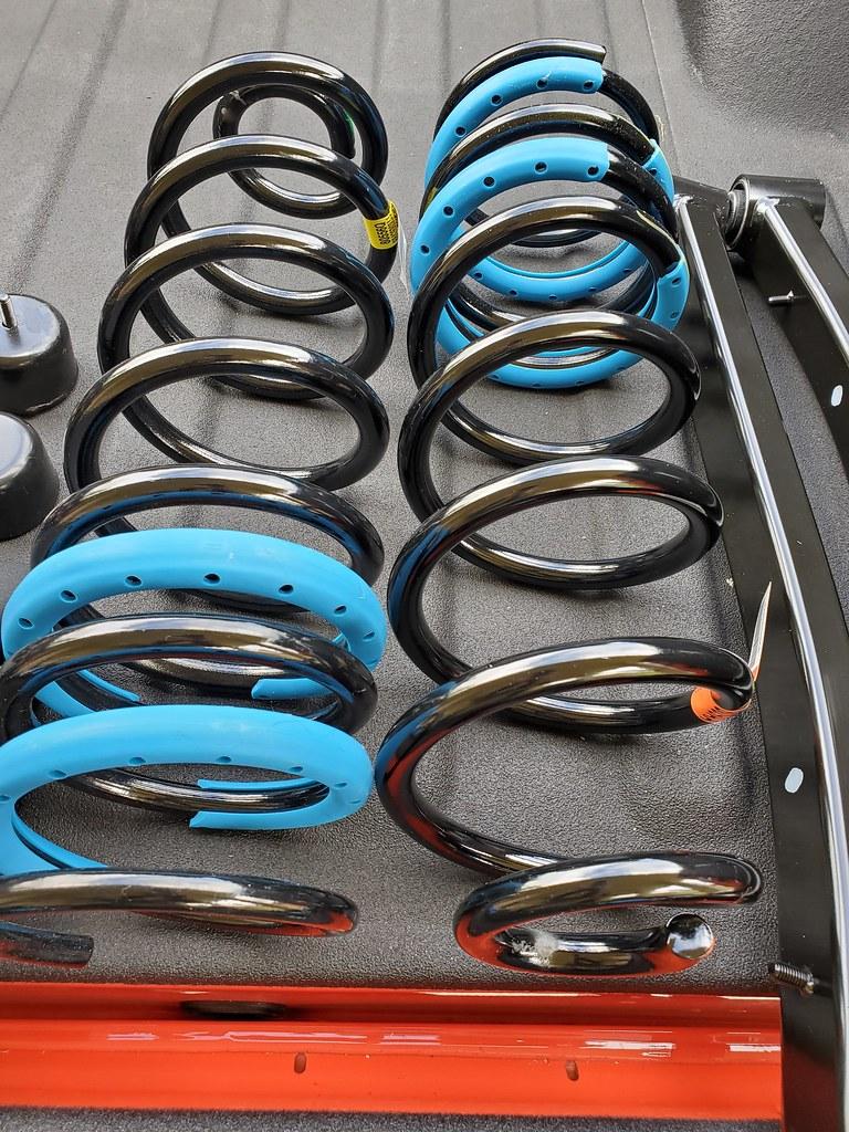

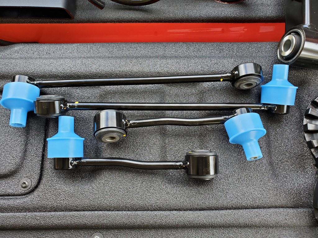

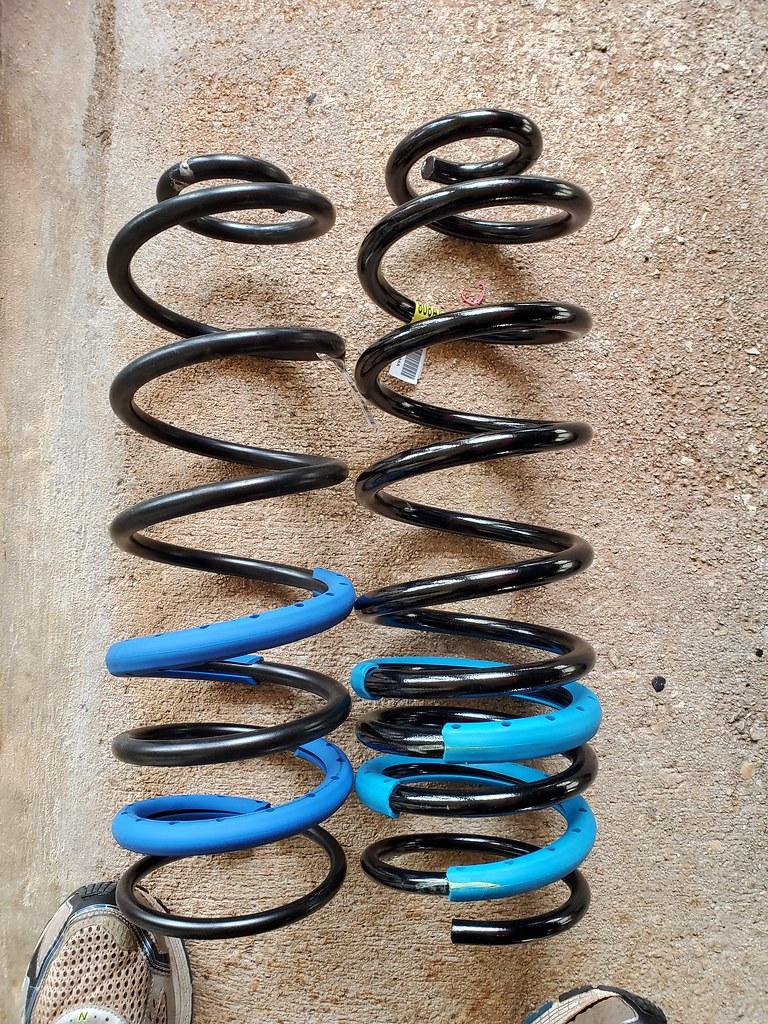

17x8.5 5.22 Backspacing Mopar Gear Wheels $1,040 77072471AB

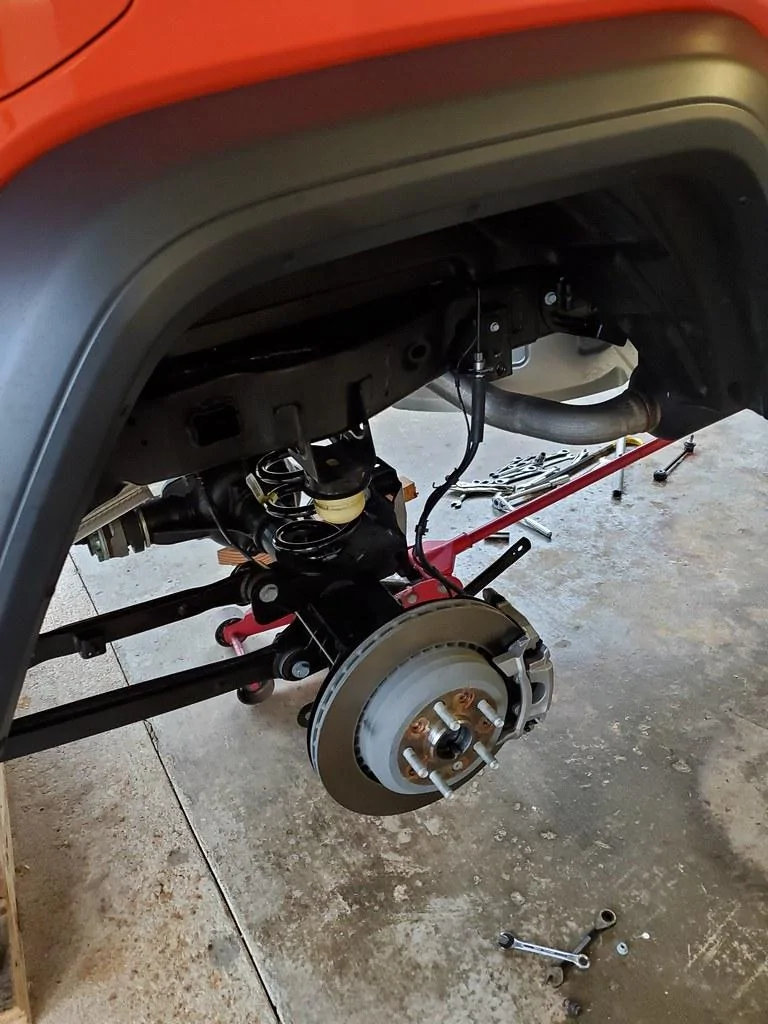

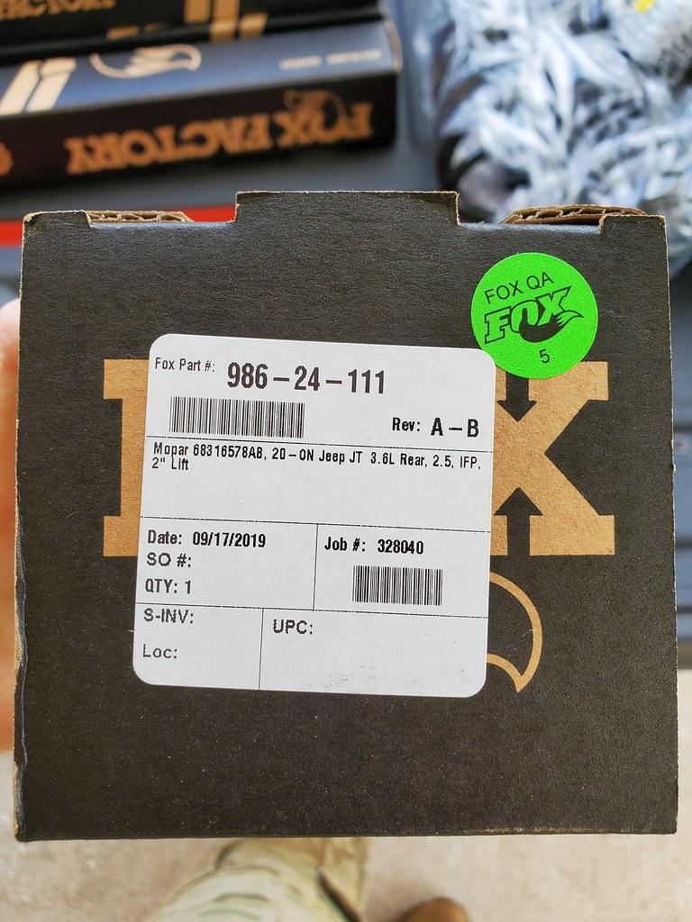

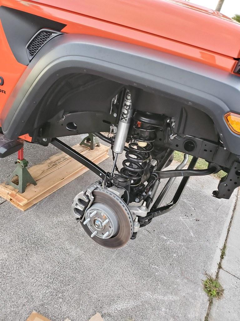

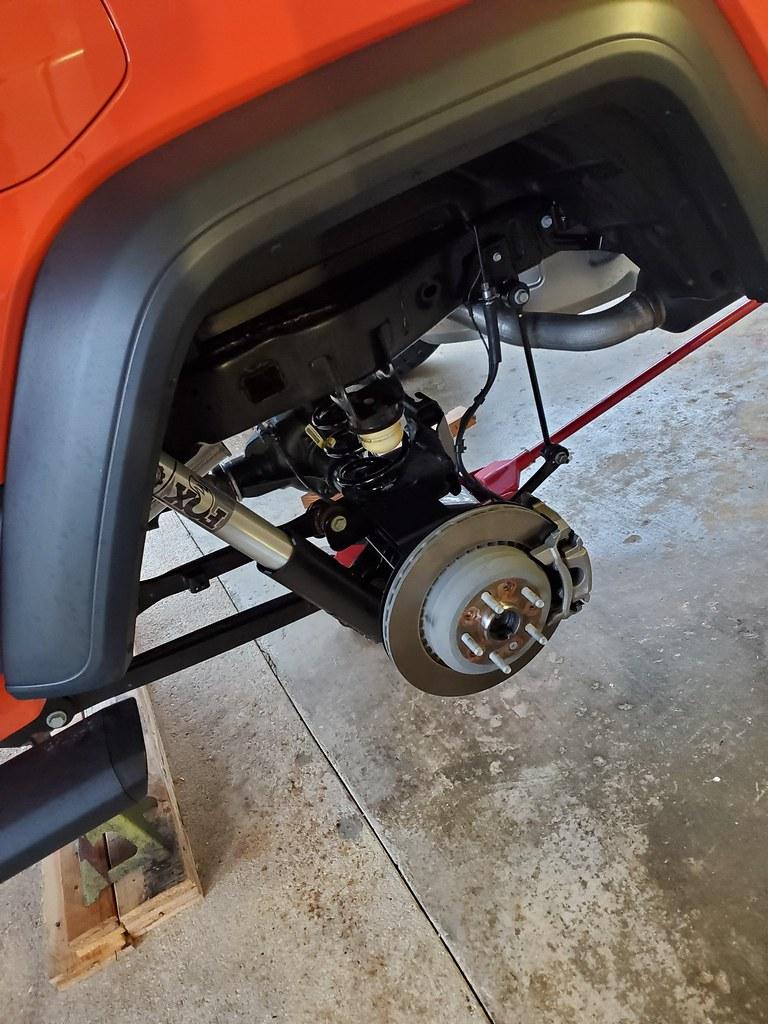

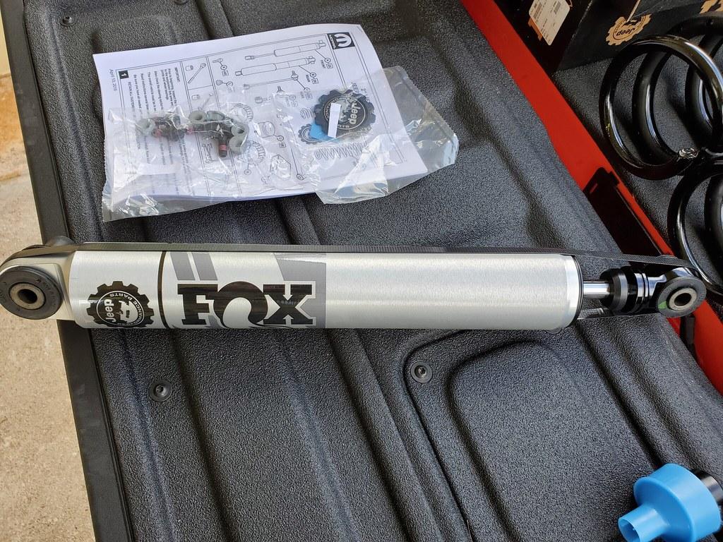

Mopar Fox Lift Kit (Installed at home) $1,740 77072468AB

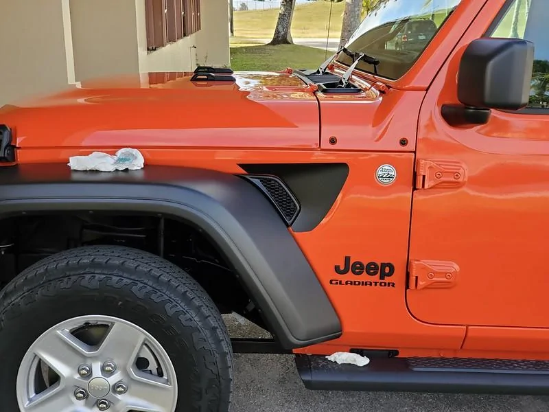

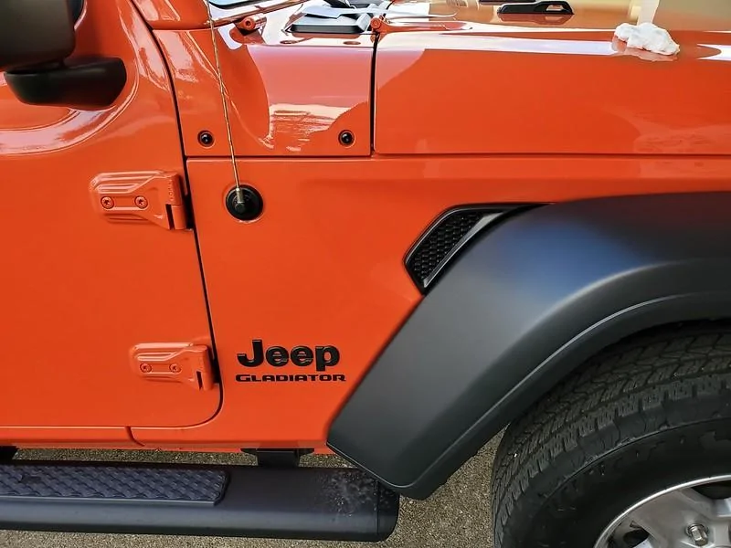

Mopar Rubicon Fender Kit w/LEDs $600 62215985

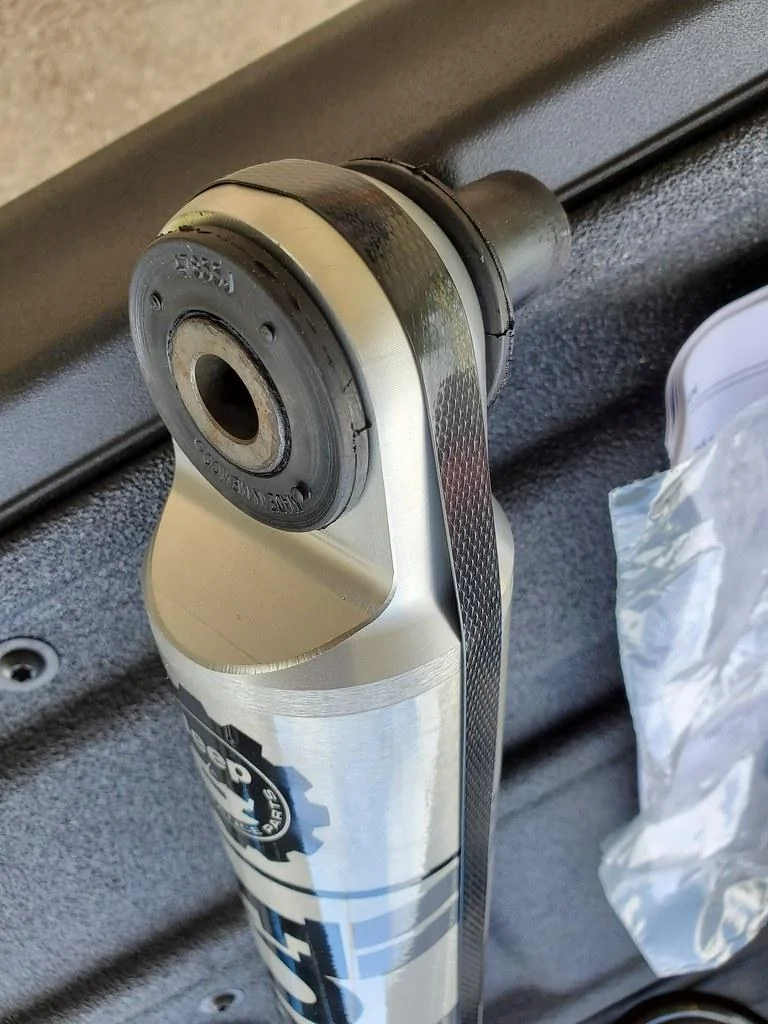

Fox Steering Stabilizer 140
Synergy 1 5/8" Steering Stabilizer Relocation Kit 80

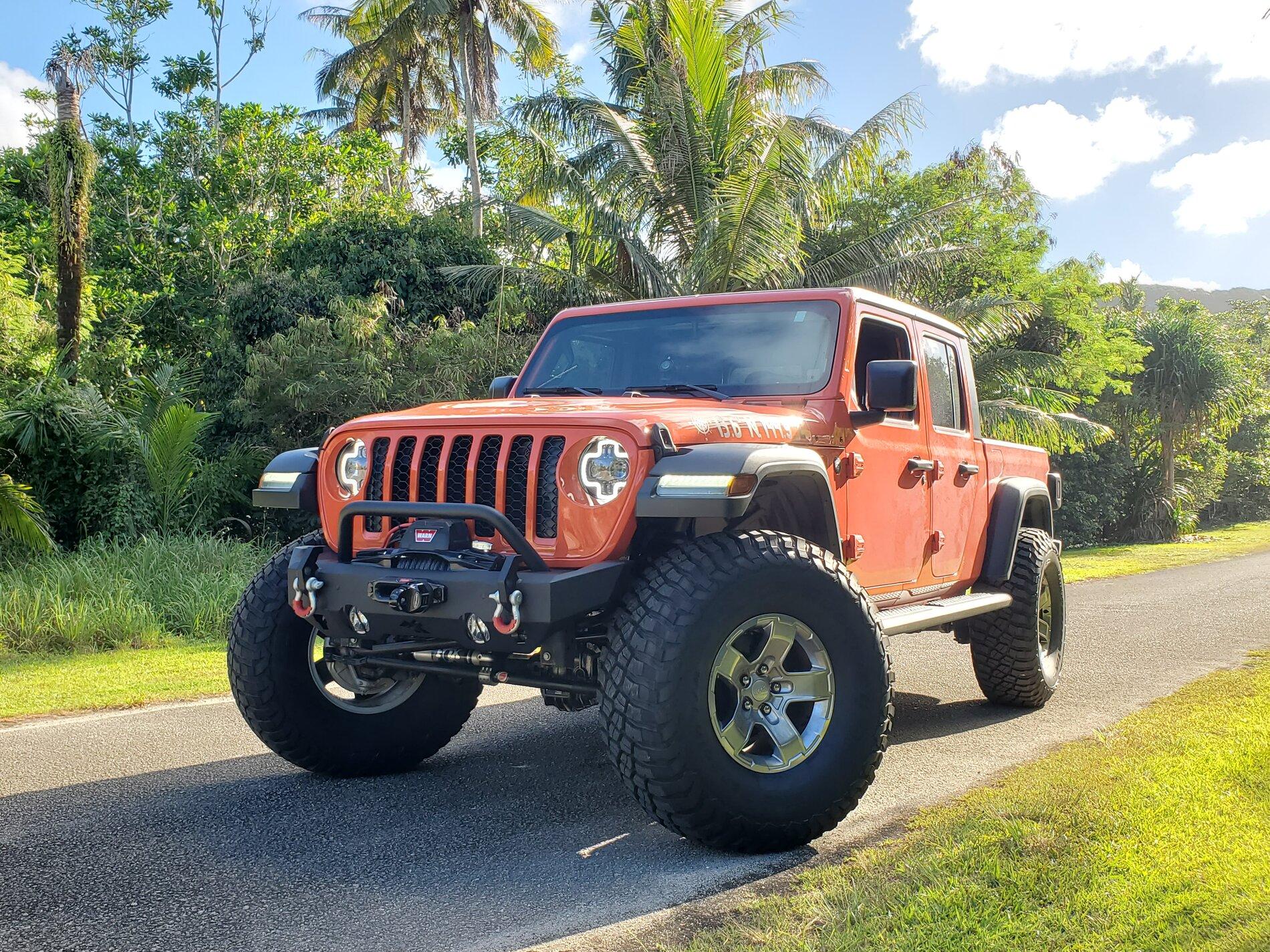

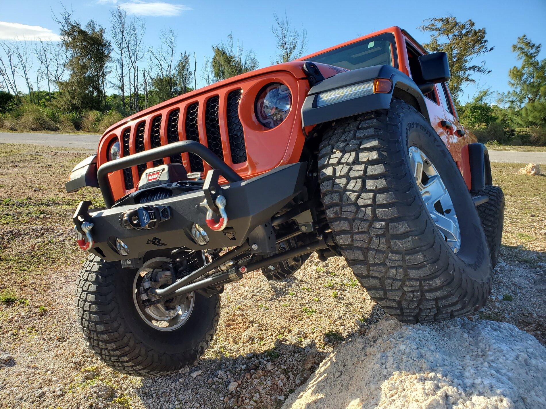

39x13.50R17 BFG KM3 Mud Terrain Load Range C (Measure like 40's)
TEWLTALK ~ BUILD WHAT YOU GOT
I HAVE A NEW VIDEO BUILD PAGE AT YOUTUBE. EVERYTHING IN THIS BUILD HAS A HOW TO.
Most current set: 39 inch tires on a Mopar Lift Kit, ARB Lockers, 488s, Forged 35 Spline Shafts, JKS Disconnects and more.
