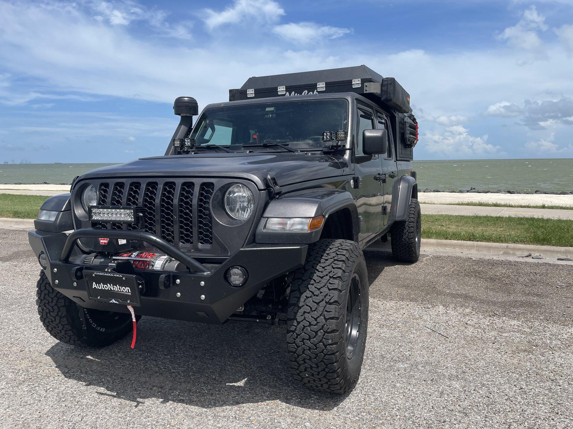

Hello fellow overlanders, this is DAUNTLESS. The Jeep Gladiator we'll be driving around the world. We anticipate the journey will take 10-15 years. We'll see how he holds up.
Our entire build series can be found on YouTube here.
But the highlights of the build are:
Jeep Gladiator Sport S with Max Tow Package. 4.10 gears, automatic transmission, 1535 lb payload
MOPAR 2" lift
TeraFlex 3.5" rear coil springs
Airlift 1000lb air bags
Hellwig Rear Sway Bar
WARN Diamond Cutter wheels
BFG KO2 AT tires (34 10.50) Basically a 33.5" tire which was recommended by experienced international overlanders
Alu-Cab Canopy Camper (we reversed the main entry door as our living area is on the passenger side)
Alu-Cab Shadow Awning
Alu-Cab Shower Cube
Alu-Cab 13 gallon potable water tank
REDARC Manager30 with RedVision system
280 watts of solar by Cascadia 4x4
170ah Renogy Lithium Battery for the house
Webasto Gasoline Heater
Long Range America 17 gallon external fuel tank
Goose Gear Double Drawer modules x2
Goose Gear Utility Cabinets x2
Goose Gear Bulkhead
Goose Gear Deckplate
Goose Gear corner unit
Goose Gear 60 High seat delete
Goose Gear solo fridge slide
National Luna Legacy 50 fridge/freezer
Rigid Industries E-Series Pro 10" light bar
Rigid Industries fog lights
Rigid Industries Flood and Spot pod lights
Rigid Industries Scene lights (amber and white)
WARN 9.5xp winch with Spydura Nightline rope and Hub wireless controller
AEV Snorkel with Sy-Klone prefilter
RockHard 4x4 Aluminum front bumper with lowered winch plate
Obviously there is a lot of gear that we are carrying which I'll save for another thread on gear. But that's pretty much the highlights of the build itself.
We'll be at Overland Expo Mountain West in the showcase area, and at Overland Expo West in the Goose Gear booth this year if anyone is going to either event.
We'd love to connect with other JT overlanders.
Let us know what you think!
