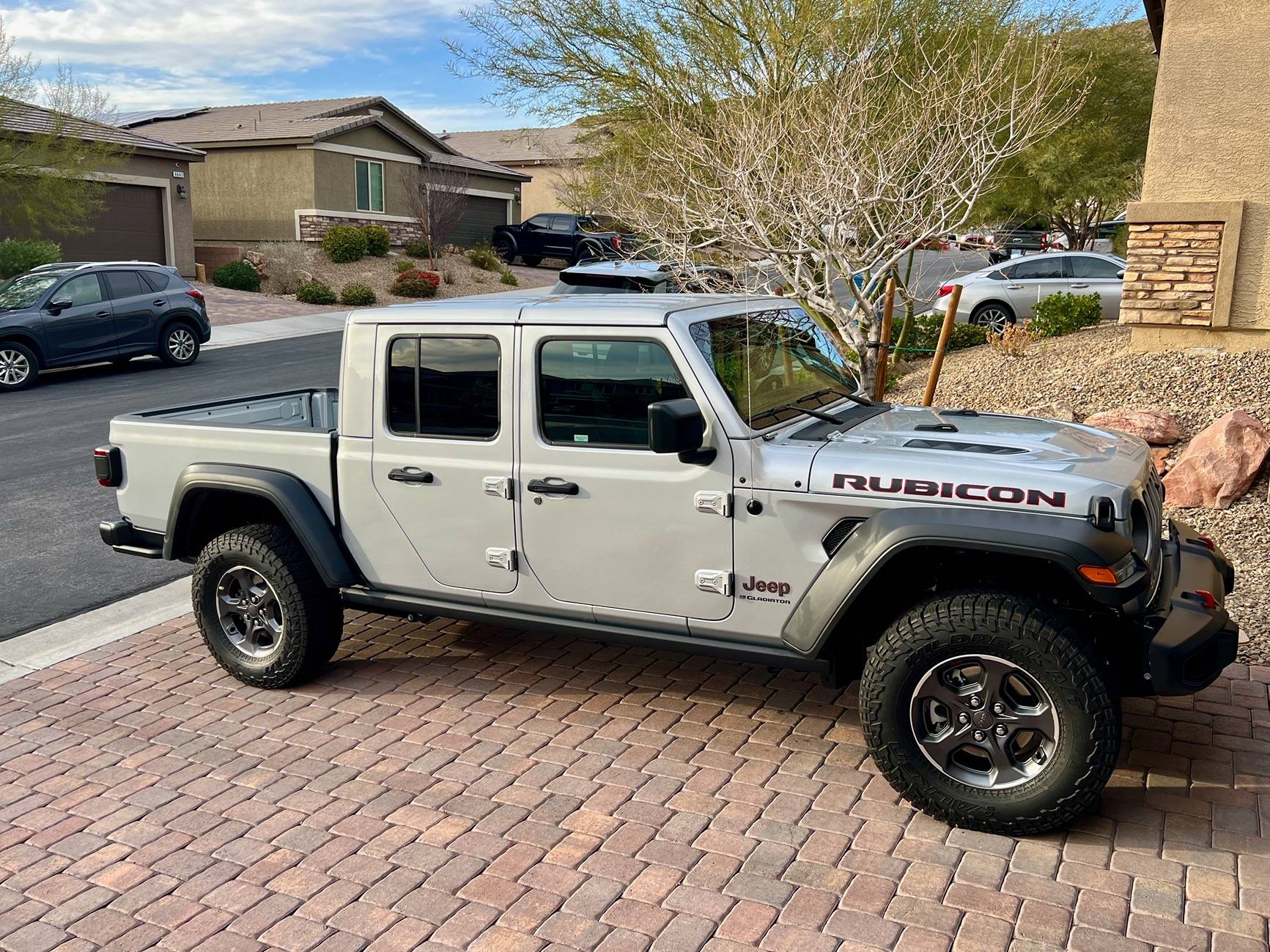

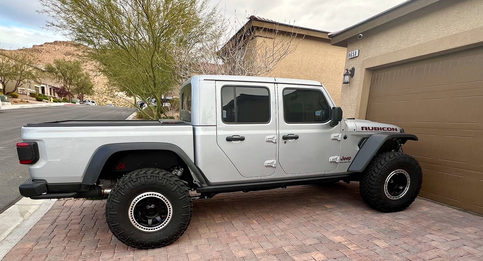

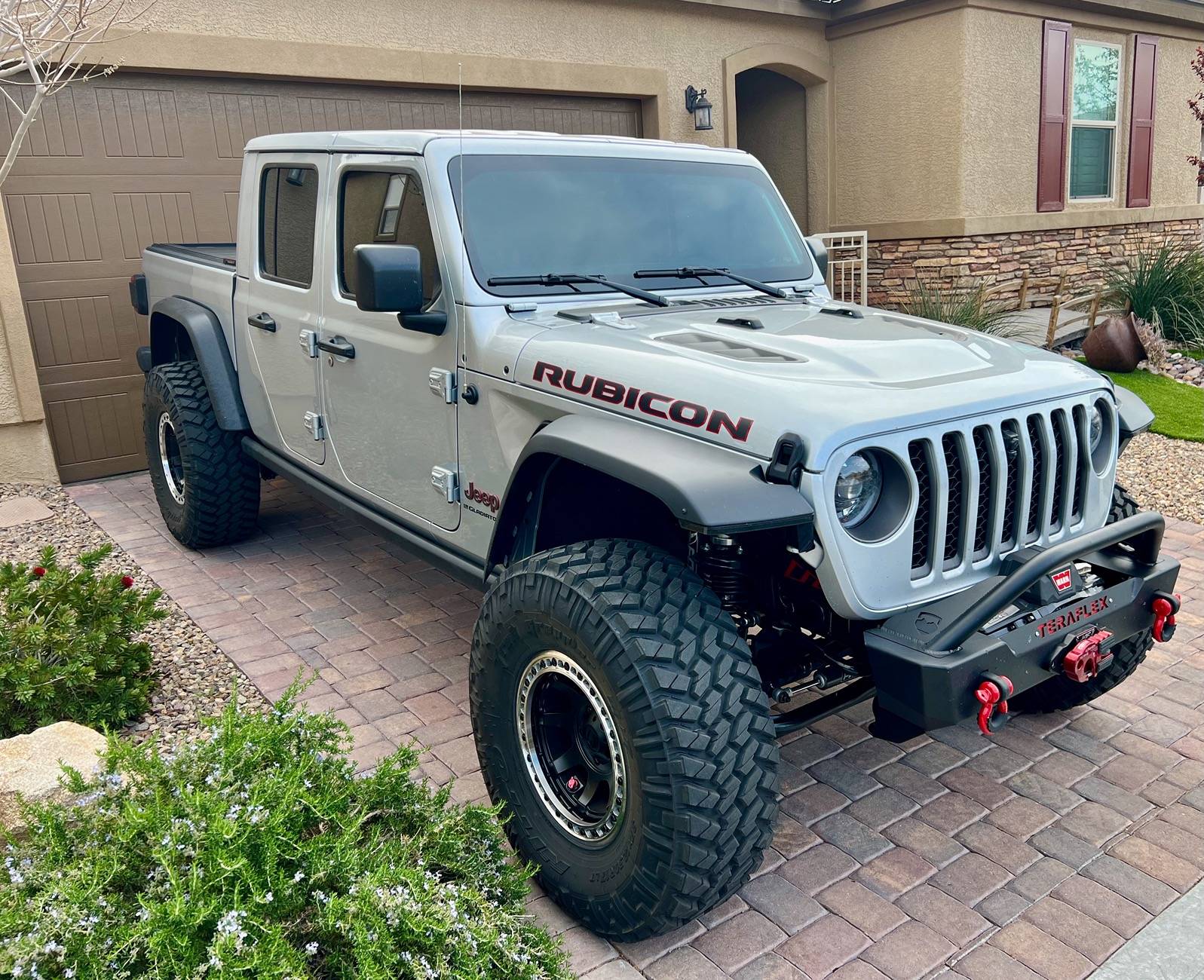

This was a fun build. We use our JT primarily for Overlanding and pulling our Patriot X3.
Here is our build list on our JT:
SUSPENSION:
๐Ÿ”ง teraflexsuspension Teraflex RT-2 suspension system
๐Ÿ”ง teraflexsuspension Teraflex Spring Base Lift 2.5" JT Gladiator
๐Ÿ”ง teraflexsuspension Teraflex Alpine IR JL/JT Front Upper Adj Control
๐Ÿ”ง teraflexsuspension Teraflex Alpine IR Arm JL/JT Front Lower Kit
๐Ÿ”ง teraflexsuspension Teraflex Alpine IR JT Rear Upper Adj Control Arm
๐Ÿ”ง teraflexsuspension Teraflex Alpine IR JT Rear Lower Adj Control Arm
๐Ÿ”ง teraflexsuspension Teraflex Track Bar JL Front
๐Ÿ”ง teraflexsuspension Teraflex Track Bar Rear JT Assembly
๐Ÿ”ง teraflexsuspension Teraflex JT Rear Driveline Spacer Ki
๐Ÿ”ง teraflexsuspension Teraflex Axle Bracket Kit JT: Extended-Travel โ€“ Rear Upper Control Arms
๐Ÿ”ง teraflexsuspension Teraflex Spring Retainer JT Upper/Lower Kit
๐Ÿ”ง teraflexsuspension Teraflex Spring Spacer Mount JT 1.5"
๐Ÿ”ง teraflexsuspension Teraflex Speed Bumps 2"
๐Ÿ”ง teraflexsuspension Teraflex Jounce Bumper Kit JT Gladiator
๐Ÿ”ง teraflexsuspension Teraflex / Falcon Shock Kit Diesel 2-3"JT All 4
๐Ÿ”ง teraflexsuspension Teraflex Leveling Kit 1" front spacer
๐Ÿ”ง teraflexsuspension Teraflex Speedbump Jounce Tube Brace
๐Ÿ”ง teraflexsuspension Teraflex Bumpstop Rear Upper JT 1.5โ€ Kit
๐Ÿ”ง teraflexsuspension Teraflex Bumpstop Rear Upper JT .5" Kit
๐Ÿ”ง teraflexsuspension Teraflex Bumpstop Strike Pad Front Lower 1.25"
๐Ÿ”ง teraflexsuspension Teraflex Sway Bar Link 8 1/2"
๐Ÿ”ง teraflexsuspension Teraflex Bumpstop Strike Pad Front Lower .625โ€
AXEL UPGRADES:
โš™
teraflexsuspension Teraflex Differential Cover JL/JT Front Rubi 44 M210
โš™teraflexsuspension Teraflex Differential Cover JL Rear 44 M220
STEERING:
โƒ teraflexsuspension Teraflex Drag Link JL/JT HD Forged
โƒ teraflexsuspension Teraflex Tie Rod Chromoly Kit JL/JT
โƒ teraflexsuspension Falcon Steering Stabilizer Adjustable 2.2 1-5/8 Tie Rod
WHEELS & TIRES:
๐ƒ teraflexsuspension Teraflex Beadlock Wheel Olympus, 5x5, -25mm, 4" B/S black with machine rings
๐ƒ teraflexsuspension Teraflex Lug Nut kit (Black) spline drive 14mm W/Key
๐ƒ nittotire Nitto Trail Grappler M/T 37x12.50r17
INTERIOR:
โšก z_automotive Tazer JL Mini
โšก offcialmopar Mopar Brake Controller
EXTERIOR:
๐Ÿ’ช๐Ÿผ teraflexsuspension Teraflex Bumper JL/JT front Rockguard crest
๐Ÿ’ช๐Ÿผ teraflexsuspension Teraflex Bumper JL/JT front Rockguard crest skid plate
๐Ÿ’ช๐Ÿผ teraflexsuspension Teraflex Bumper JL/JT front Rockguard crest hoop
๐Ÿ’ช๐Ÿผ americanadventurelab American Adventure Lab Rear JT inner fender's , trimmed and modified for falcon shocks, with black hardware
๐Ÿ’ช๐Ÿผ americanadventurelab American Adventure Lab (New style) Fender Chop Kit JL/JT Rubicon (smoked)
๐Ÿ’ช๐Ÿผ americanadventurelab American Adventure Lab Front Inner Fenders JT diesel Quick-Release with falcon cut out, with black hardware
๐Ÿ’ช๐Ÿผ americanadventurelab American Adventure Lab eep JT Gladiator Driver Side Aluminum Bed MOLLE Panels
๐Ÿ’ช๐Ÿผ americanadventurelab American Adventure Lab eep JT Gladiator Passenger Side Aluminum Bed MOLLE Panels
๐Ÿ’ช๐Ÿผ rollnlock Real Truck Roll - N- Lock M-Series XT Tonneau Cover
RECOVERY GEAR:
๐Ÿ”ฉ warnindustries 10000 lb Winch VR 10-S W/Synthetic Rope
๐Ÿ’ช๐Ÿผ Just4funmotorsports J4F Fairlead, Winch
๐Ÿ”ฉ factor55llc Ultrahook Red
