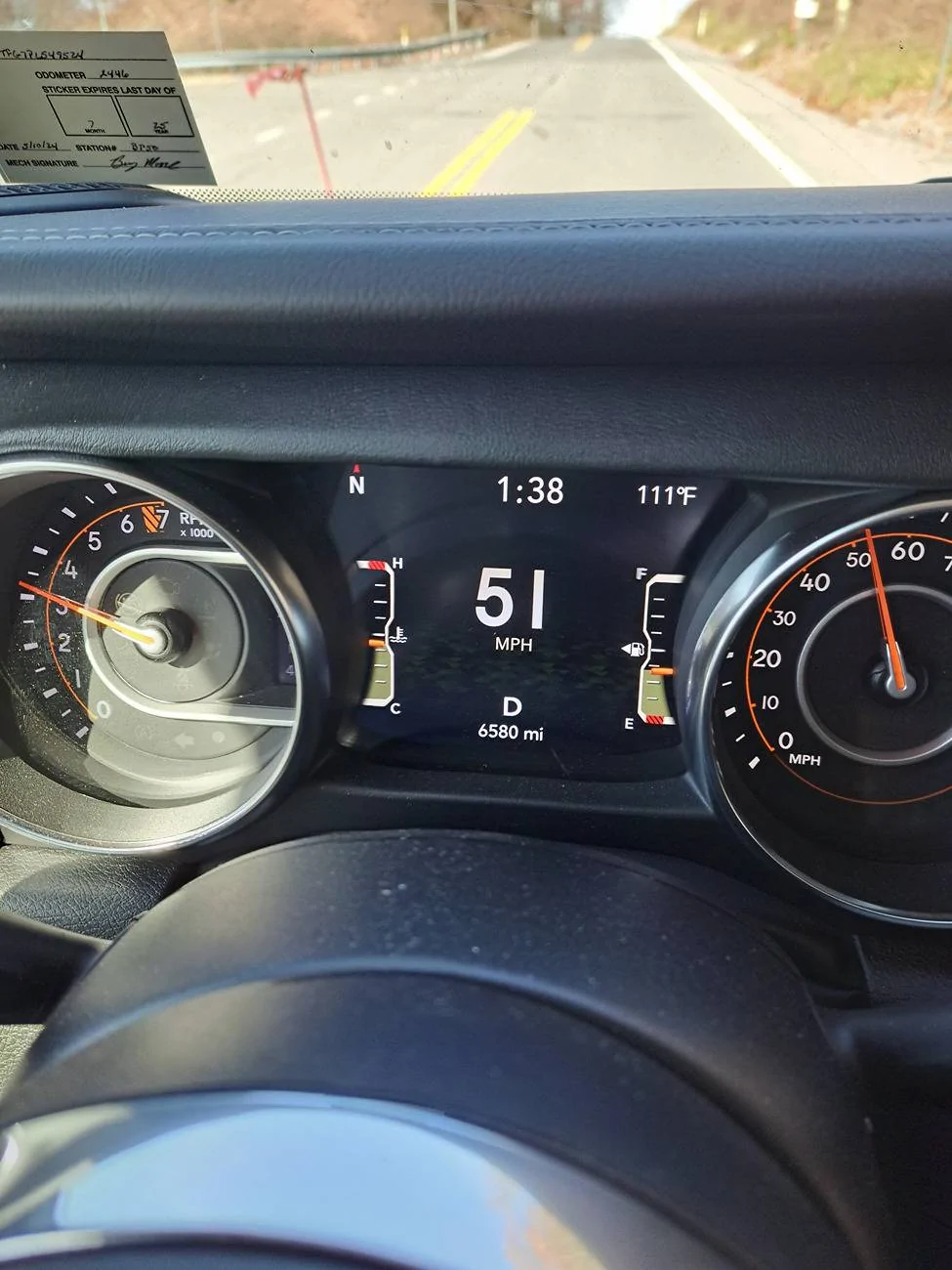

I have a 2023 Gladiator that I purchased with 1,300 miles on it. I now have slightly over 6,500 miles on it.
I had a new Western Plow installed by my local dealer so that I can plow my ¼ mile driveway. When I drove the truck home yesterday, I noticed that the outside temperature was registering around 110 degrees Fahrenheit when the outside temperature was actually around 60 degrees. The outside temperature reading would fluctuate about 25 degrees between 90 and 115. My temperature gauge was running in the normal range. I think that the electric cooling fan may have been running a little more than it has in the past, but I am not sure.
When I dropped the plow at home and drove the truck, the outside temp. reading was more like it actually was outside.
It seemed odd to me that the plow would block enough air flow to cause that much of a heat build up to make the outside temperature register that high. My Gladiator is completely stock (no modifications other than the plow system).

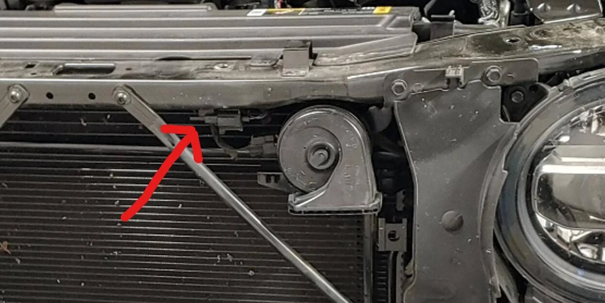

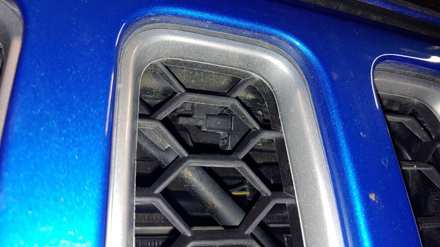

I have posted in great detail on this exact thing - and included pictures of the sensor. It's on the driver side, toward the top and can be seen through the grill slot.
It's more than blocking flow - it's causing low pressure and pulling engine bay air forward. In my case, I have seen the display show outside temperatures of 101 degrees. The HVAC heat will not work - not in auto mode or manually choosing heat and turning it up high. It might help, but my wife still complains of cold air when with me if the plow is on.

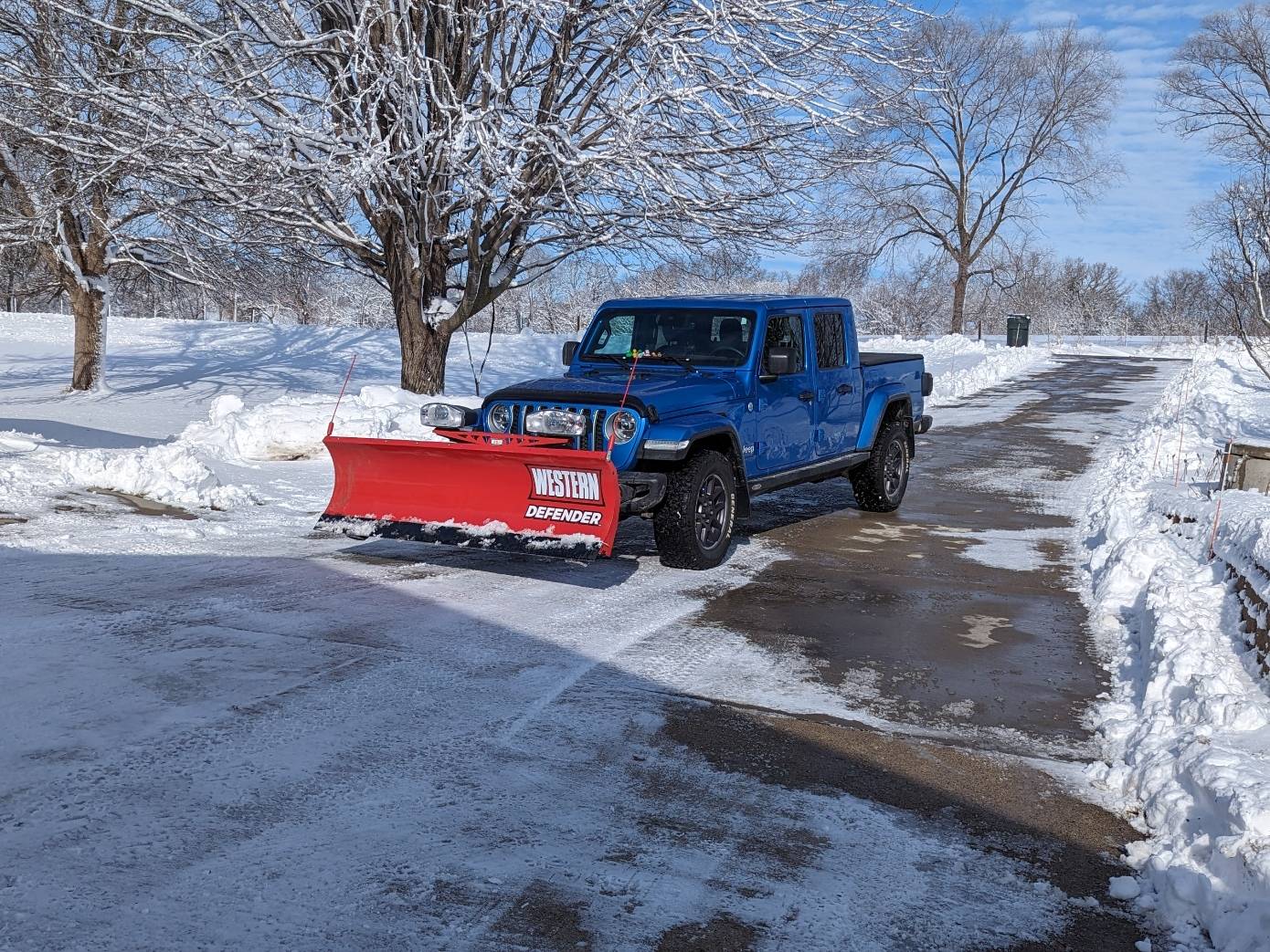

I'm running a Western plow, 72" I think it is, on my 2022 Overland. This will be the 3rd winter with it. I've gotten to the point where I just drop the plow off when done plowing, but if I can find a solution, I'd rather leave it on as we can have a snow, 2 days of nice, then another snow, then a week of nice, then another snow. That's a lot of on and off for a 67 year old with bad back and essential tremors.

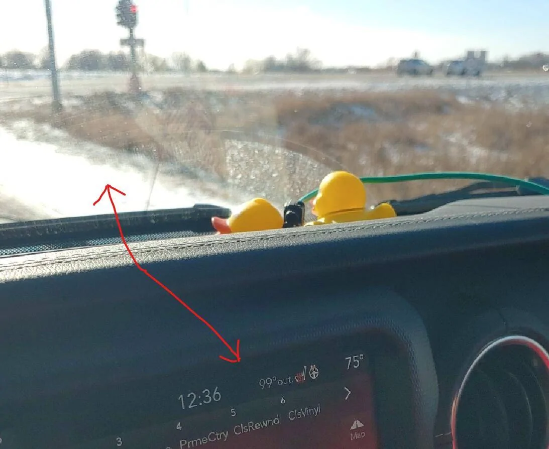

Sensor -
Jeep Gladiator Outside Temperature sensor 1730223472048-ka
Jeep Gladiator Outside Temperature sensor 20230130_103312
It was somewhere between 0 and 10 degrees out, snow on the ground, yet the temperature sensor said it was 99 - I just missed catching it at 101 because when I slowed to a stop, the temp reading dropped a bit due to the lack of the plow causing low pressure at very low speeds or at a stop.
My wife doesn't like the seat heat much so rarely turns it on and she generally has the heater set to 70 or below. In this case, she turned on the heated seats and kept cranking the heat up - didn't help much ->
