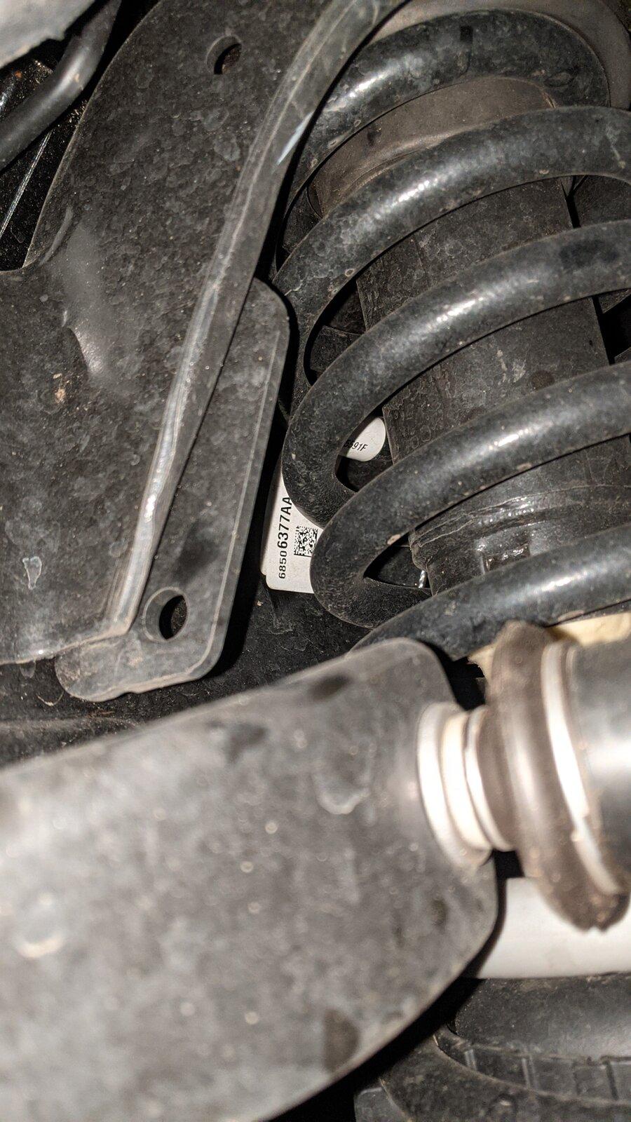

Anyone else diesel comes with front stock springs 6377AA, which is the same as rubicon front springs 6377AA/6378AA?
However, my Overland rear part number are different though.

I just checked mine and they donā€™t have a part number on them.

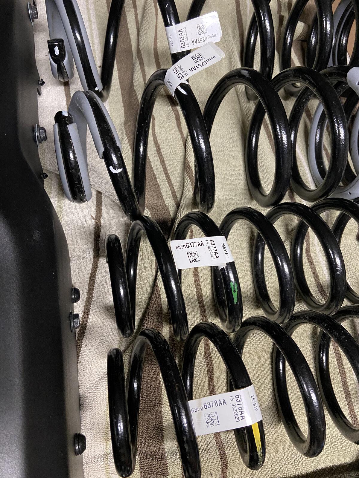

Here's my rubi diesel springs for refence.
Vtur
Vtur
Mar 6, 2021
1,102
1,146
Norcal
JTOD
Today, i replaced just the shocks with rubi ones and it ride great. Less body roll during turns.
Jeep Gladiator Overland diesel front springs same as diesel Rubicon PXL_20210419_005853933

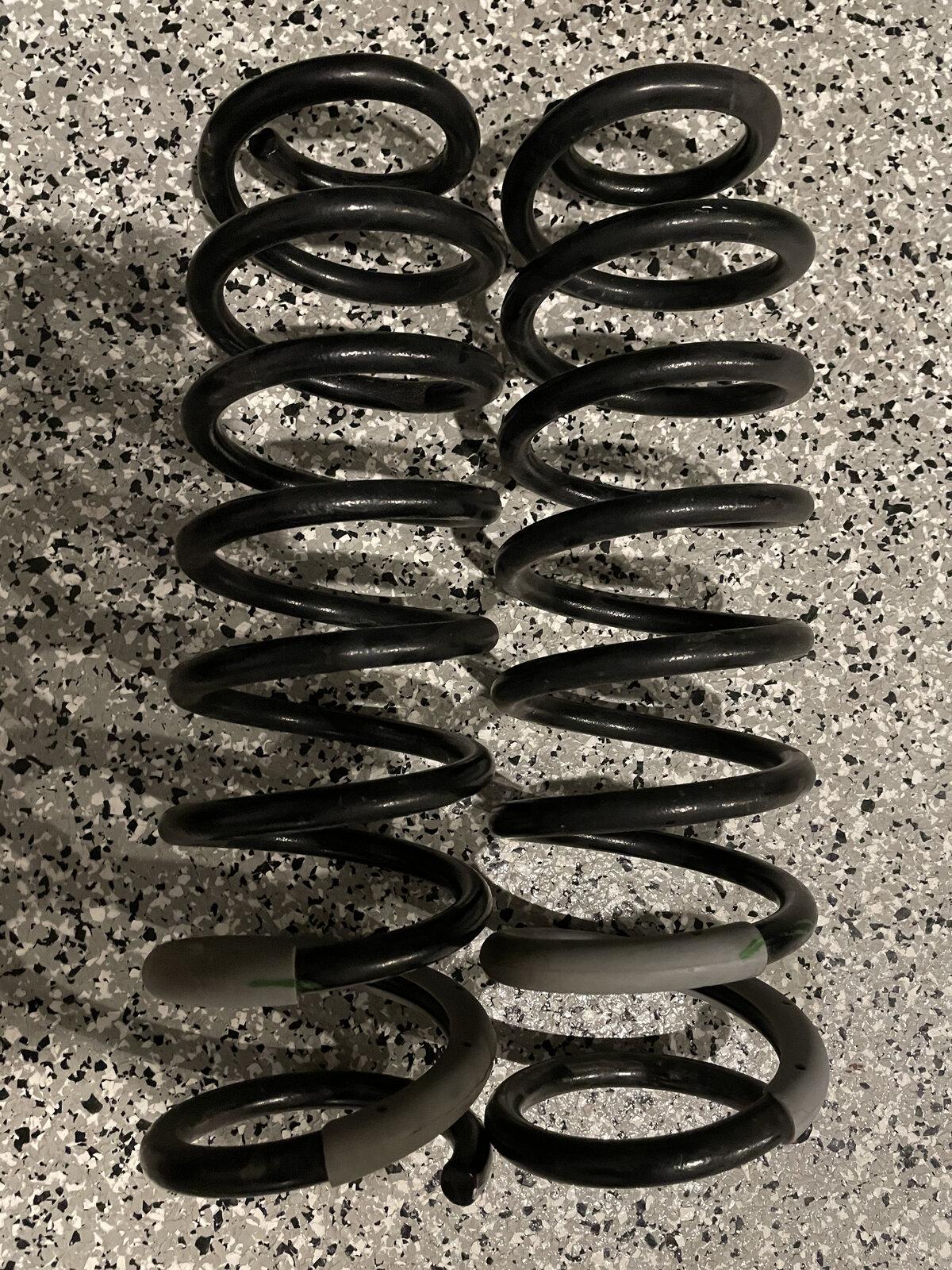

Strange!
my Willy's addition eco has matching springs both driver and passenger sides.
The fronts are both 6377AA with GREEN paint pen marks and the rears are both unmarked yet have a GREEN paint pen marks mark.
Which exact corners did each of those springs come from?
The reason I'm asking is I have a lift on the way which says it has corner specific springs. If that's so I want to match it up to the proper corner the best I can.

I like where this thread is going.
Strange!
I don't know which corners as mine fronts are both 6377aa. However, those springs were removed from a rubi with steel bumper as an option. I would guess the 6378aa is to compensate for sway disconnect and locker.
Hopefully your lift instructions will indicates.
Mine didnā€™t have part numbers but look the same as yours.
Mine are from a rubi diesel with factory installed front and rear metal bumpers.
