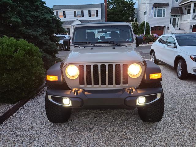

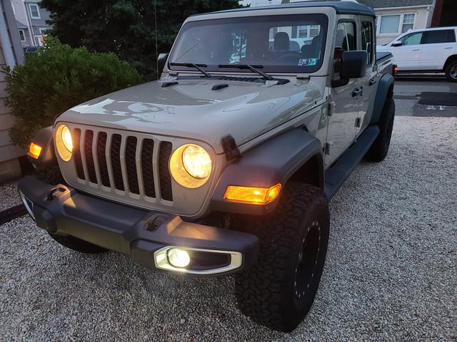

Sharing some pics of my Overland bumper retrofit on my base Sport.
Project started after install my lift because taking off the Sport bumper fender wings exposes the fog lights to the elements. I sourced the Overland bumper from another forum member and it included all required parts, trim and hardware except for fog lights. I moved the fog light harness from the old bumper to the new bumper and I picked up a set of Bunker Indust LED fog lights from Amazon in "Used - Very Good" condition, since my old fogs would not fit. These LEDs are meant to replace the standard fogs and did not require reprogramming.
Overall very happy with the upgrade for under $200 in parts. Had my local Jeep shop install it at 1.5 hours of labor for $130.

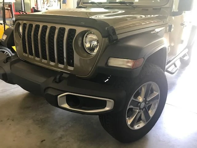

Nice. I'm trying to do the same. I got the overland bumper. But it didn't come with the brackets for the lights. Now, I got to find brackets and fog lights... since the Sport fog lights do not fit.
