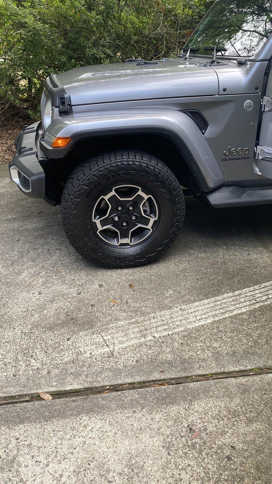

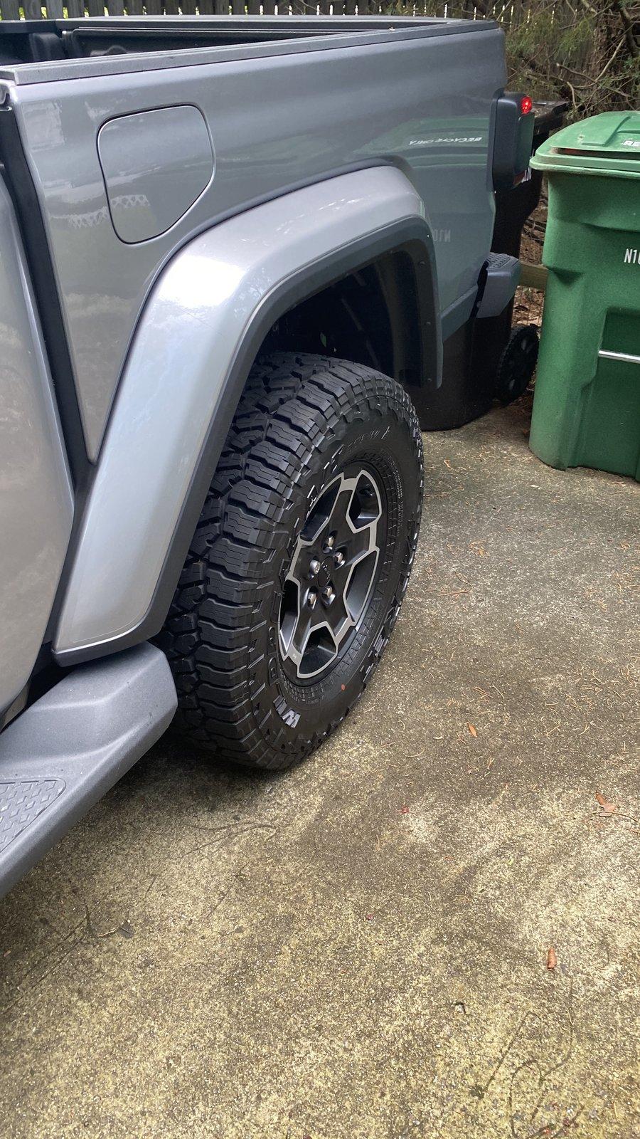

285/70/17"s on my overland, they are take offs from a Mojave but fit very well without any issues.

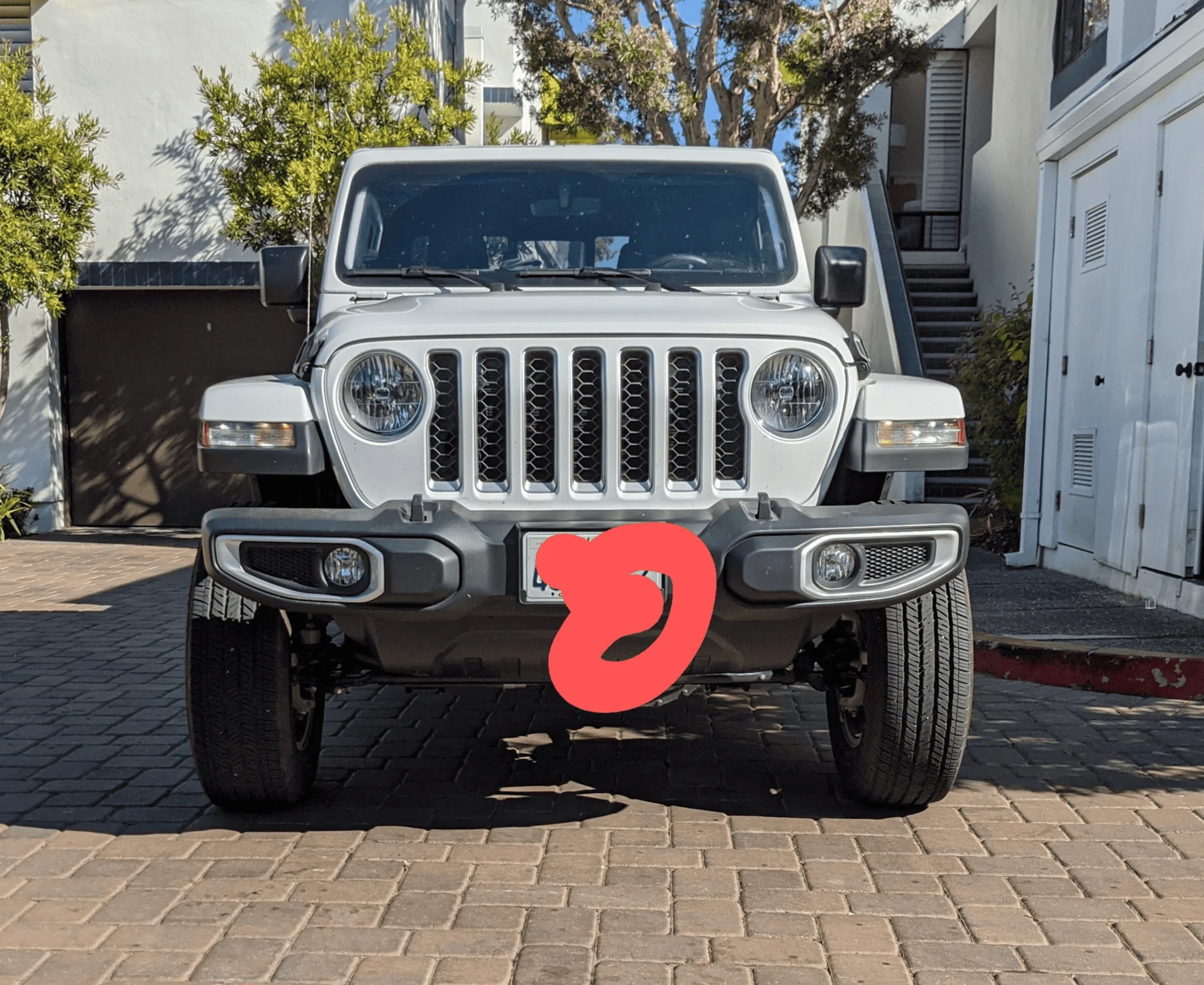

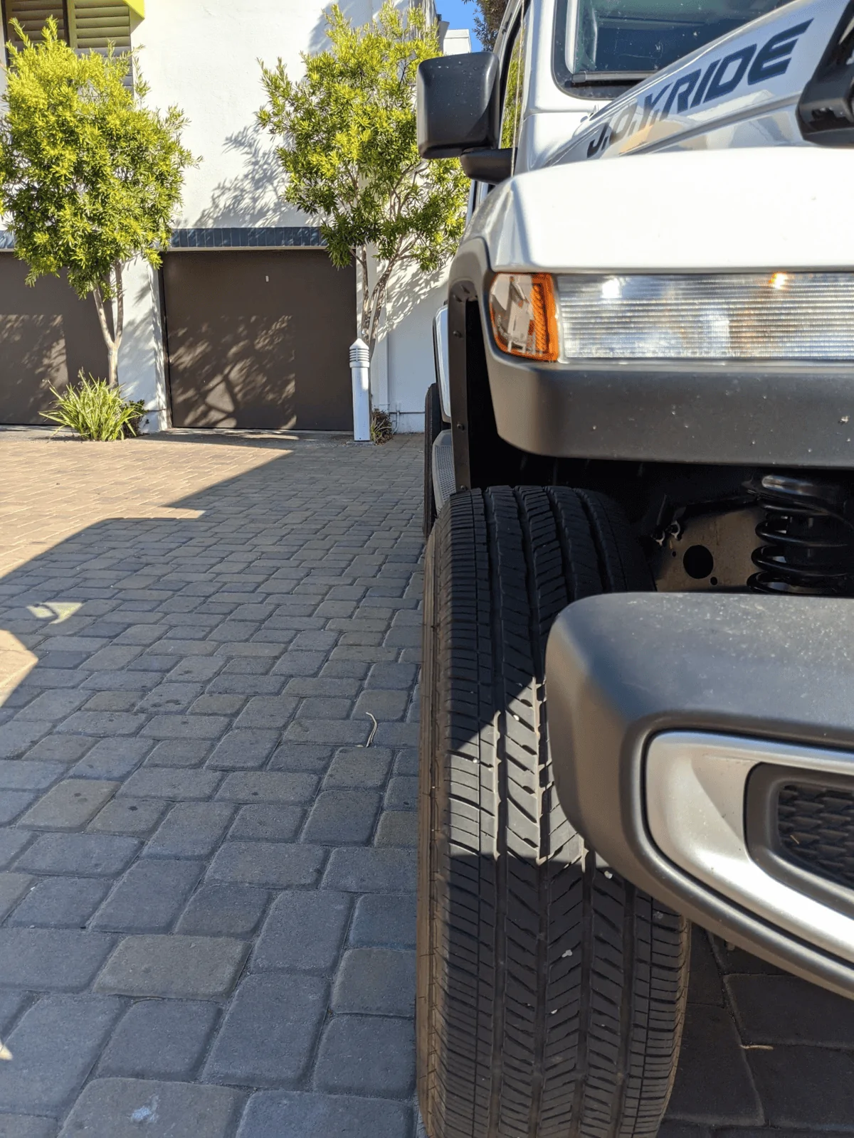

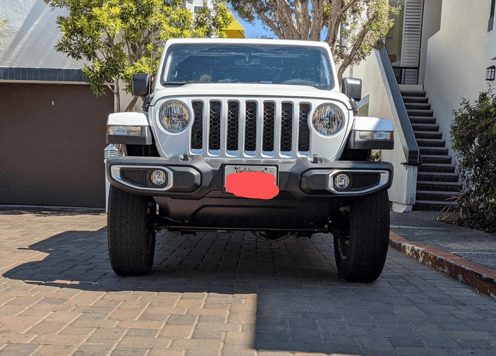

For general use A/T tires just keep the 18s. Add some spacers and it helps the look. I did the spacers the day before my 35s went on and just put the stock ones back on for the night.
Before 1.75" spacers
Jeep Gladiator Overland - Keep 18” wheels or buy 17s for A/T tires? 1597118029358
After
Jeep Gladiator Overland - Keep 18” wheels or buy 17s for A/T tires? 1597117984611
Jeep Gladiator Overland - Keep 18” wheels or buy 17s for A/T tires? 1597118098060
Have you had any issues? Notice anything after some time? Getting this done as I type. Looks good.
