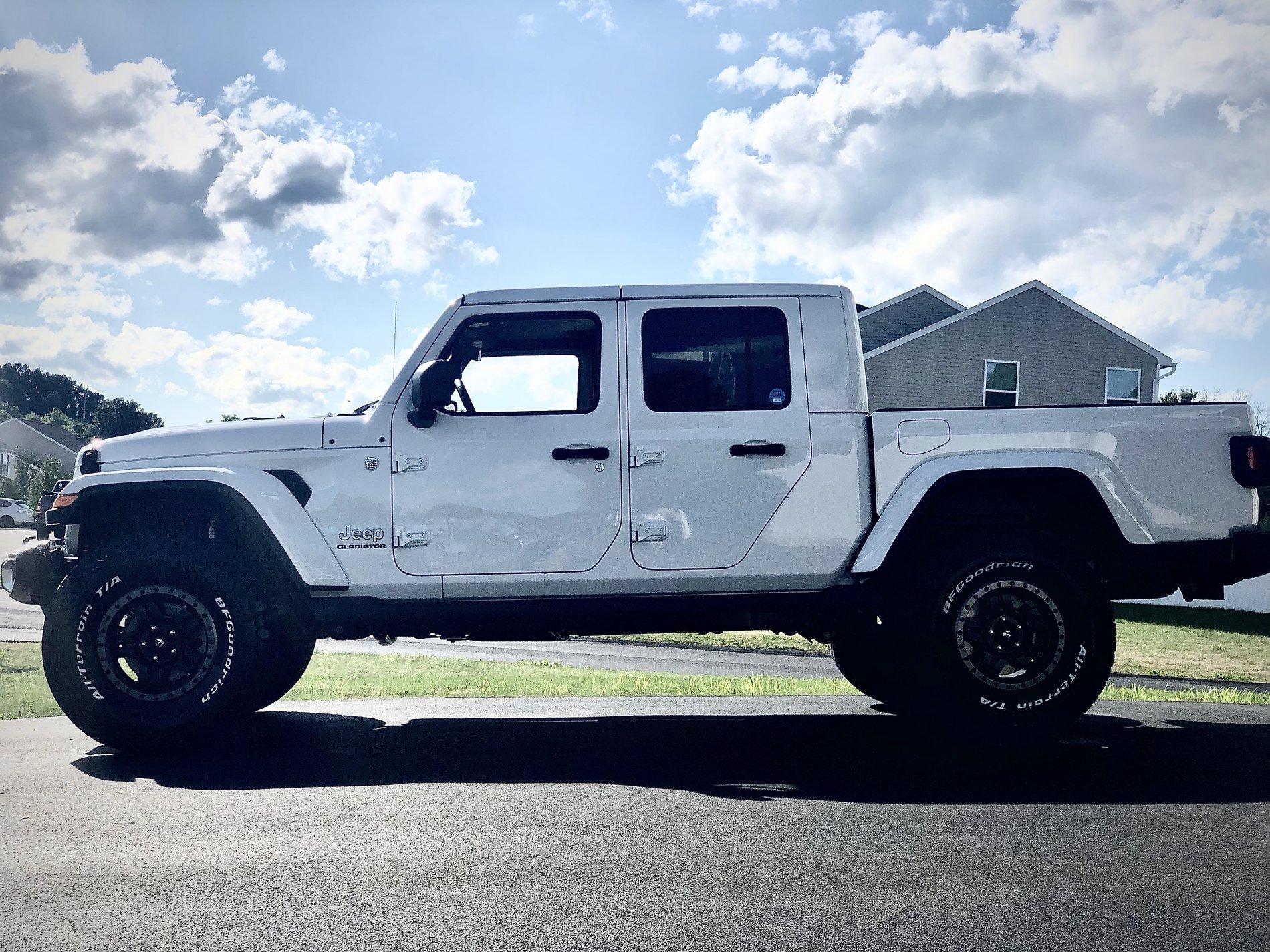

I have been fine with 2” mopar lift and 37” KO2’s with 3.73’s. I haven’t taken it off-road though.
Do you have any pictures of your setup to satisfy my curiosity?

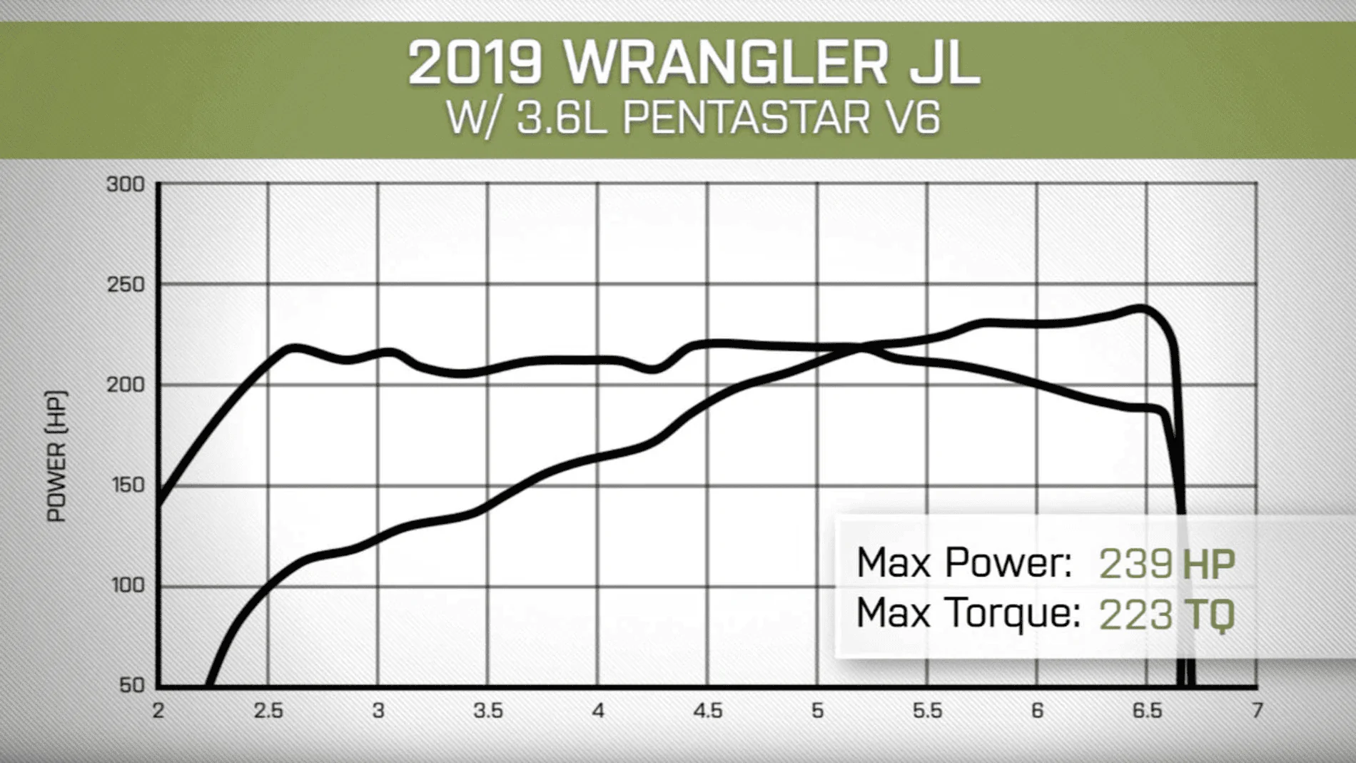

For me shift points isn't the issue, it's the lack of power to hold the gear at speed. If I put it into say 7th and give it enough gas to not force a kick down even in manual setting, it will just start slowing down. It seems to be anything around 2,000 rpm in higher gears where you'd want to cruise isn't happy. Needs to be spinning higher like 2,500. Which makes sense when you see the power curve
Jeep Gladiator Overland owners who switched to 35 & 37 tires 1597092832483
It may help some of the gear hunting but it won't help the gear ratios and power to rotate the mass.
