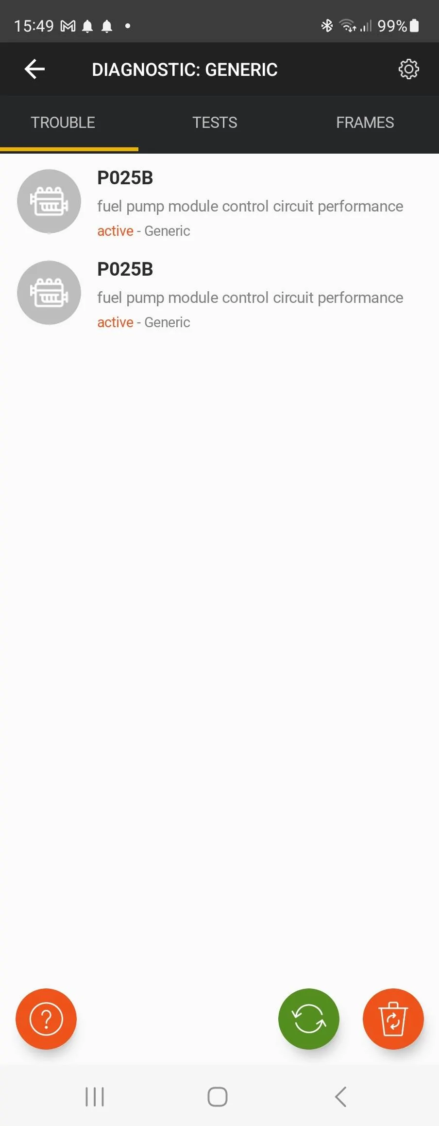

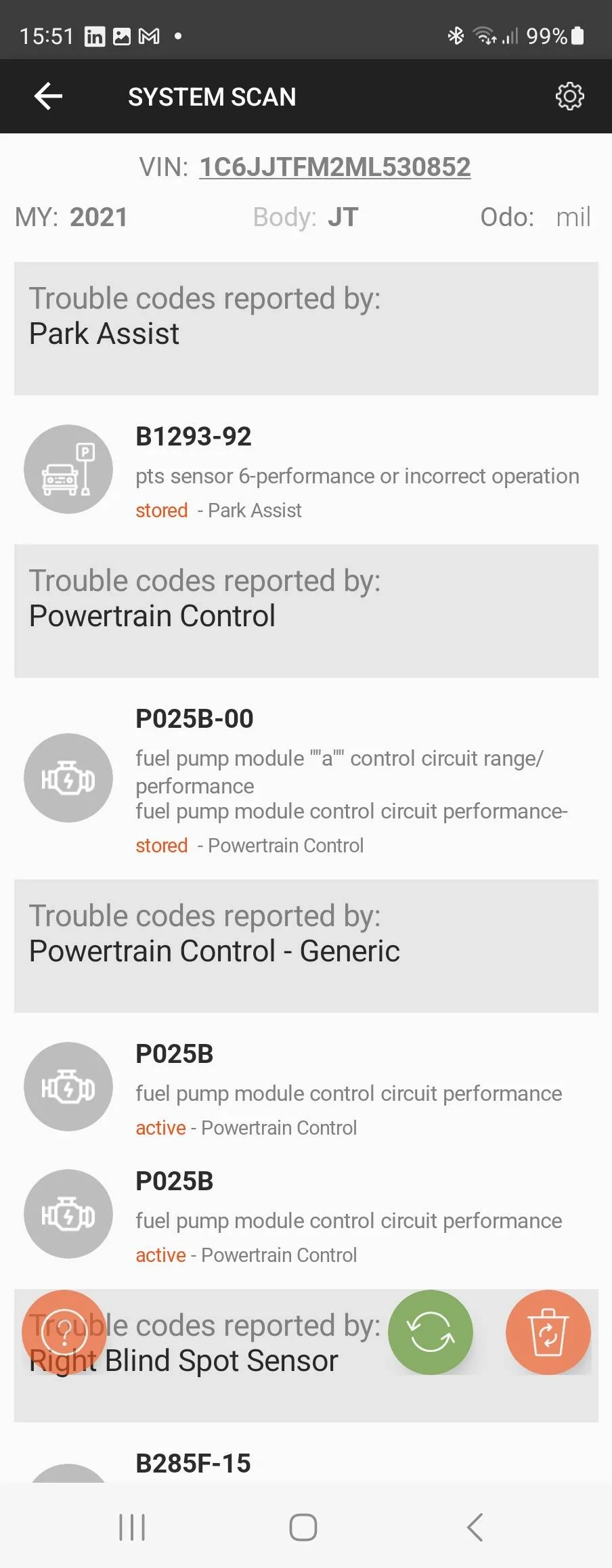

Hello from Poland! I bought a Jeep Gladiator Ecodiesel, Overland from a Polish dealership - I luv this truck!
I'm looking for help or maybe someone with similiar case - Whenever I tip my truck - even by 6 degrees, check engine light comes on with P025B problem.
So far my gladiator has spent about 4 months being fixed - warranty claim.
At first they replaced pump control module, which didn't help, then the pump has been replaced with a new unit. It didn't help at all.
Truck runs fine on normal roads, as soon as I go offroad and truck starts leaning to the sides or when I go up or downhill, P025B appears. Dealership told me they are out of ideas - they don't know what's wrong with it and how to fix it.

6 degrees in what direction? forward, back, left right?
sounds like a wire harness issue, something is getting streached or pulled when the jeep is leaned a certain direction.
i would try to narrow down the exact circumstances that cause the issue and figure out how to repeat it. maybe even get it do the failure, leave it in the potion and start looking at all the wires to the pump for anomalies.
That or tell the dealer its defective and you want a replacement jeep.

I agree the poster above. My old Jeep had a short in the wiring harness causing the transmission to throw codes and go into limp mode sporadically. It only happened when the jeep flexed a certain way. They finally figured it out when they tried it on the lift with the axles/wheels drooped down.
6,083
13,878
Check the wiring harness by the transmission and exhaust. There is a bracket that rubs on the harness and causes mayhem. There is a couple of threads on it.

On the passenger side of the engine/transmission. There is a bracket for the exhaust. On some years, the wiring rubs on it. Causing shorts.

I brought the truck back to the dealership - they set the rear wheel on some elevation and kept shaking the bed until check engine came on.
It was indeed a problem with the harness you mentioned. Problem solved - thank you for helping out - if you ever visit Poland I owe you a real beer :)

Yes first thing to check with EcoD "electrical" issues is the harness that crosses/rubs on the EGR tube flange. There is even a TSB about it. Lots of threads on here about it.
