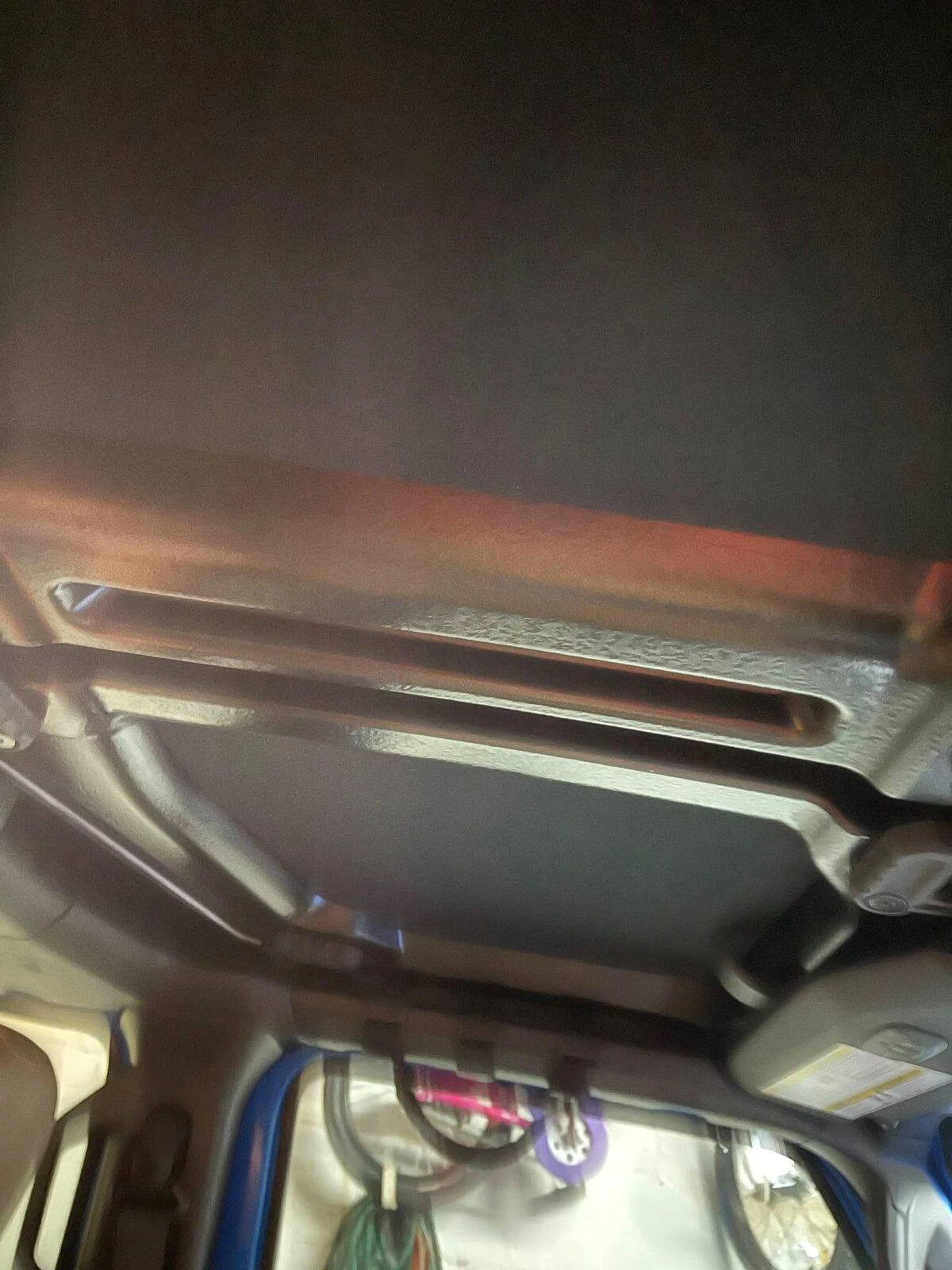

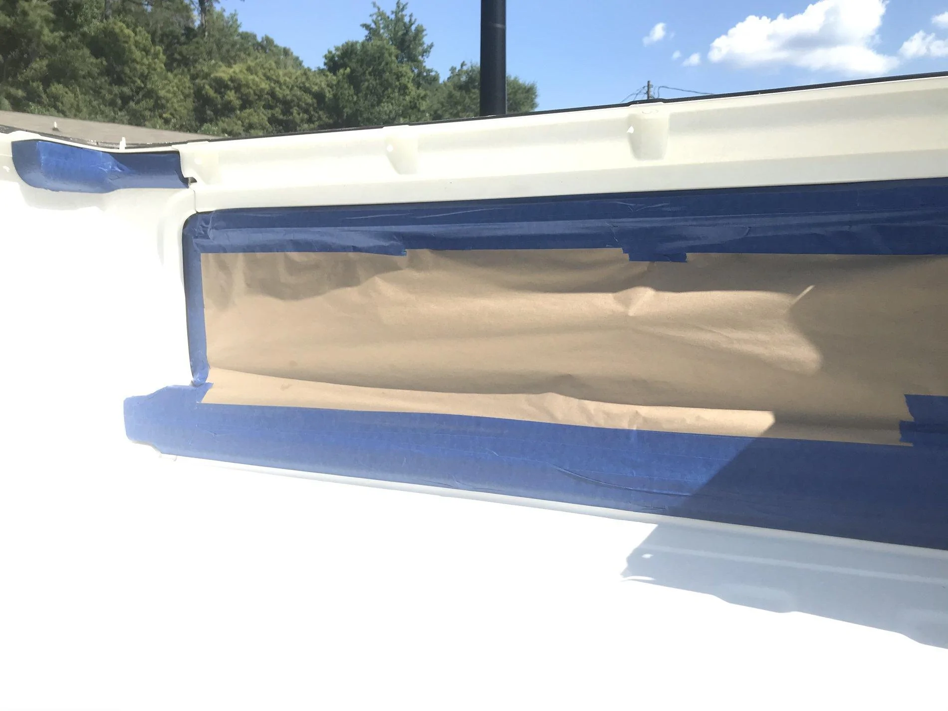

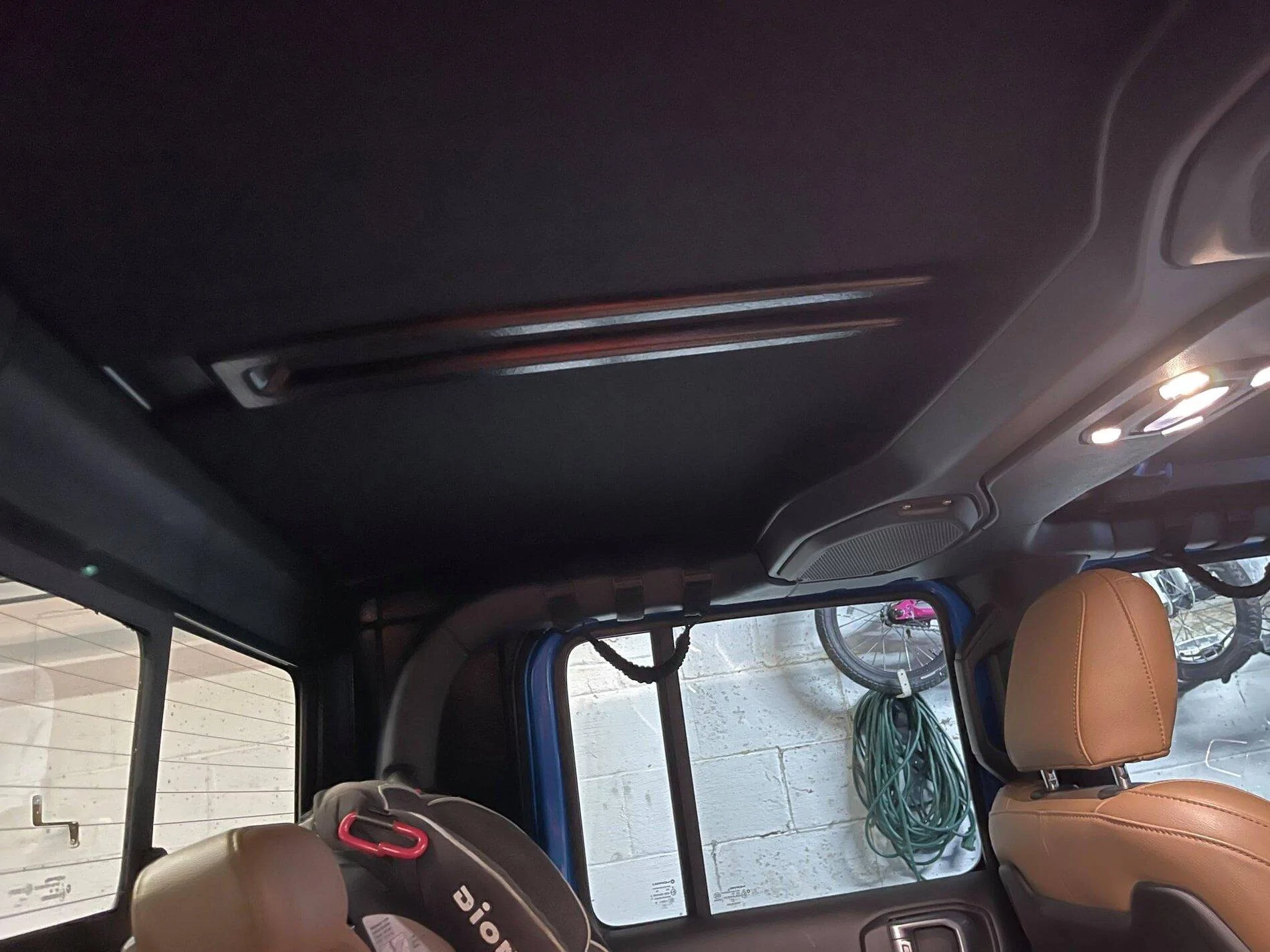

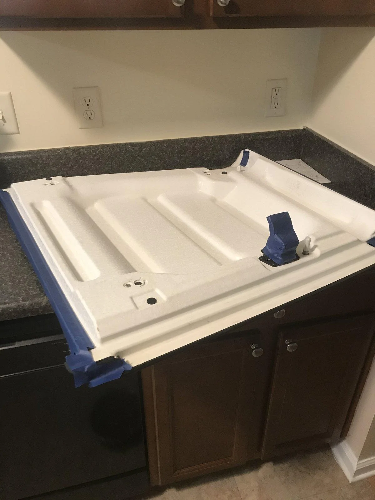

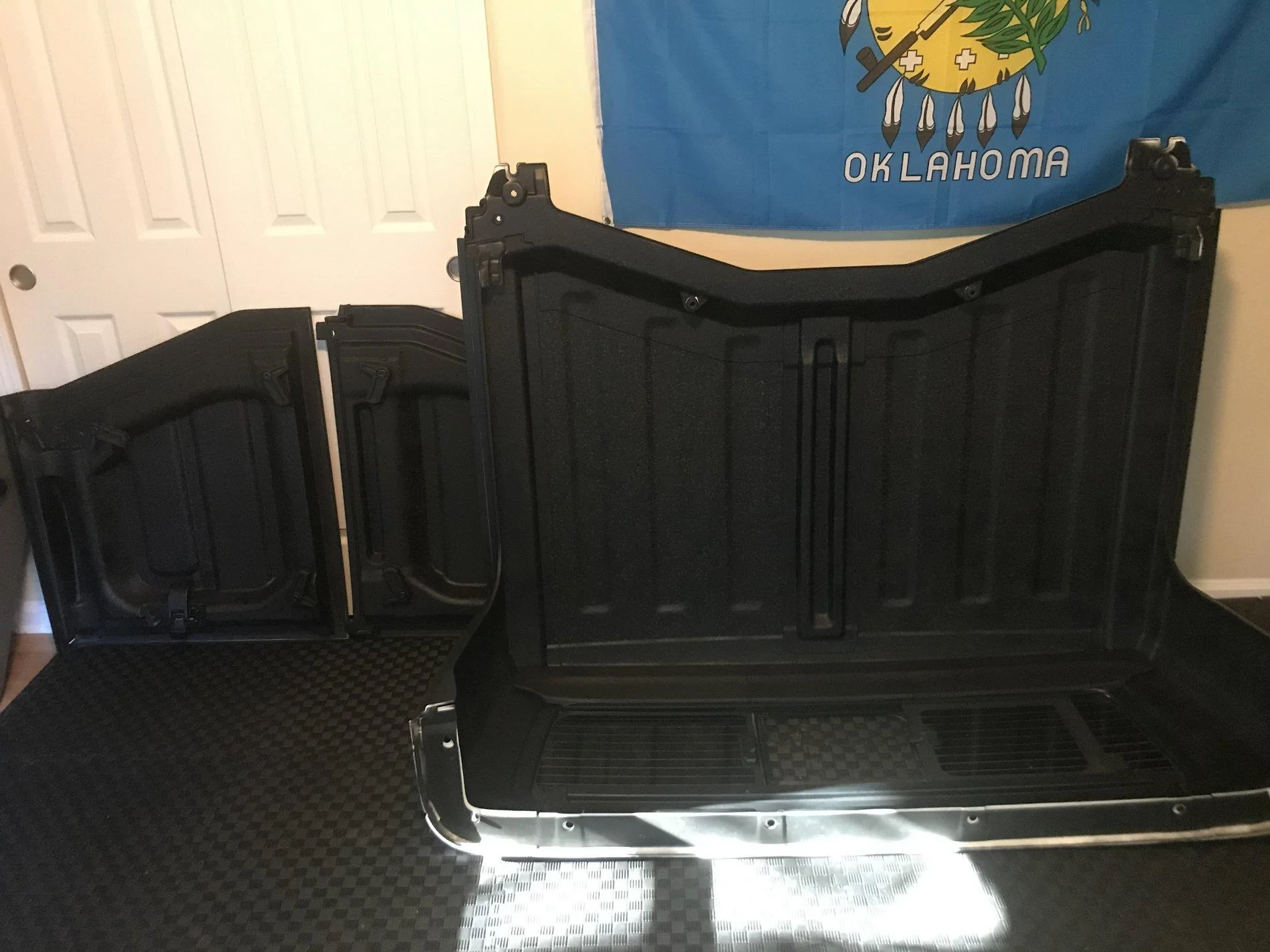

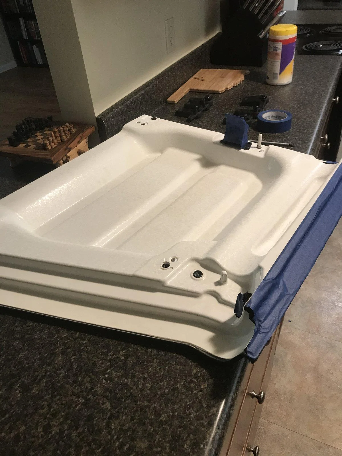

I just finished this up today. I used alcohol wipes to clean and prep. I also removed the latches and did a lot of taping off. It sucks up a lot of paint. Each freedom panel took a full can each and the back took three cans. It looks really good, but we’ll see how it holds up.

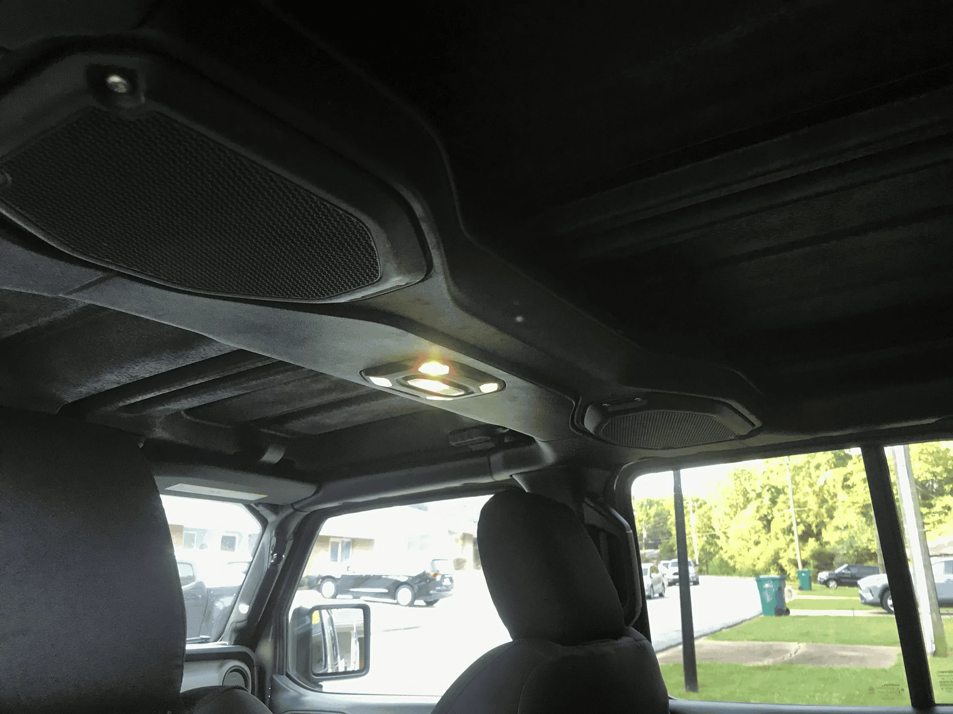

That looks really good. I'm going to do that prior to installing the HotHeads panels that just arrived. Just going to paint the areas the panels don't cover.

I used Krylon Fusion Flat Black. The plastic sucks up a lot of paint. It took several more cans than I expected. I don't remember exactly how many, but it was around seven or eight I think. Six months later, still no sign of wear.

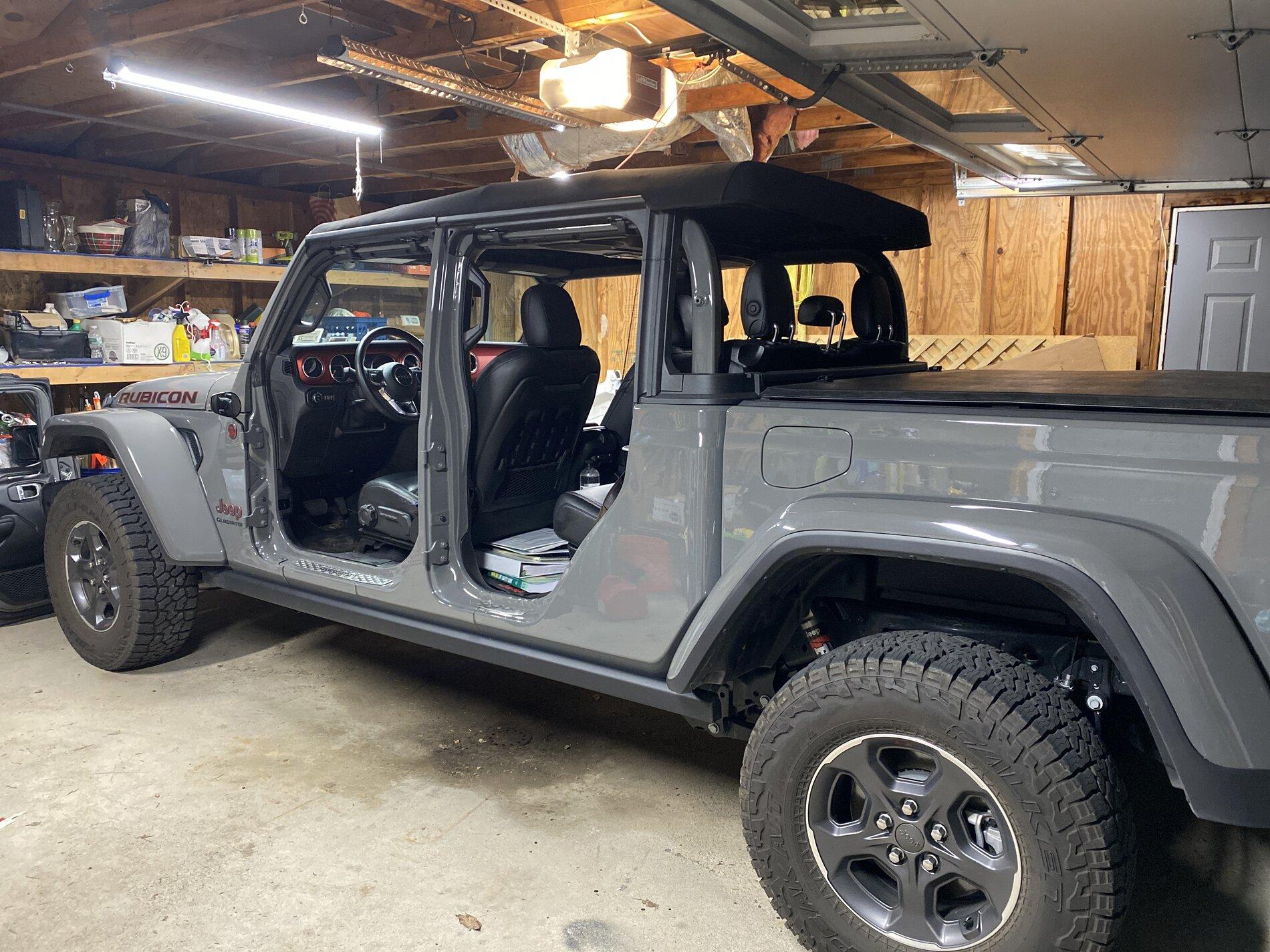

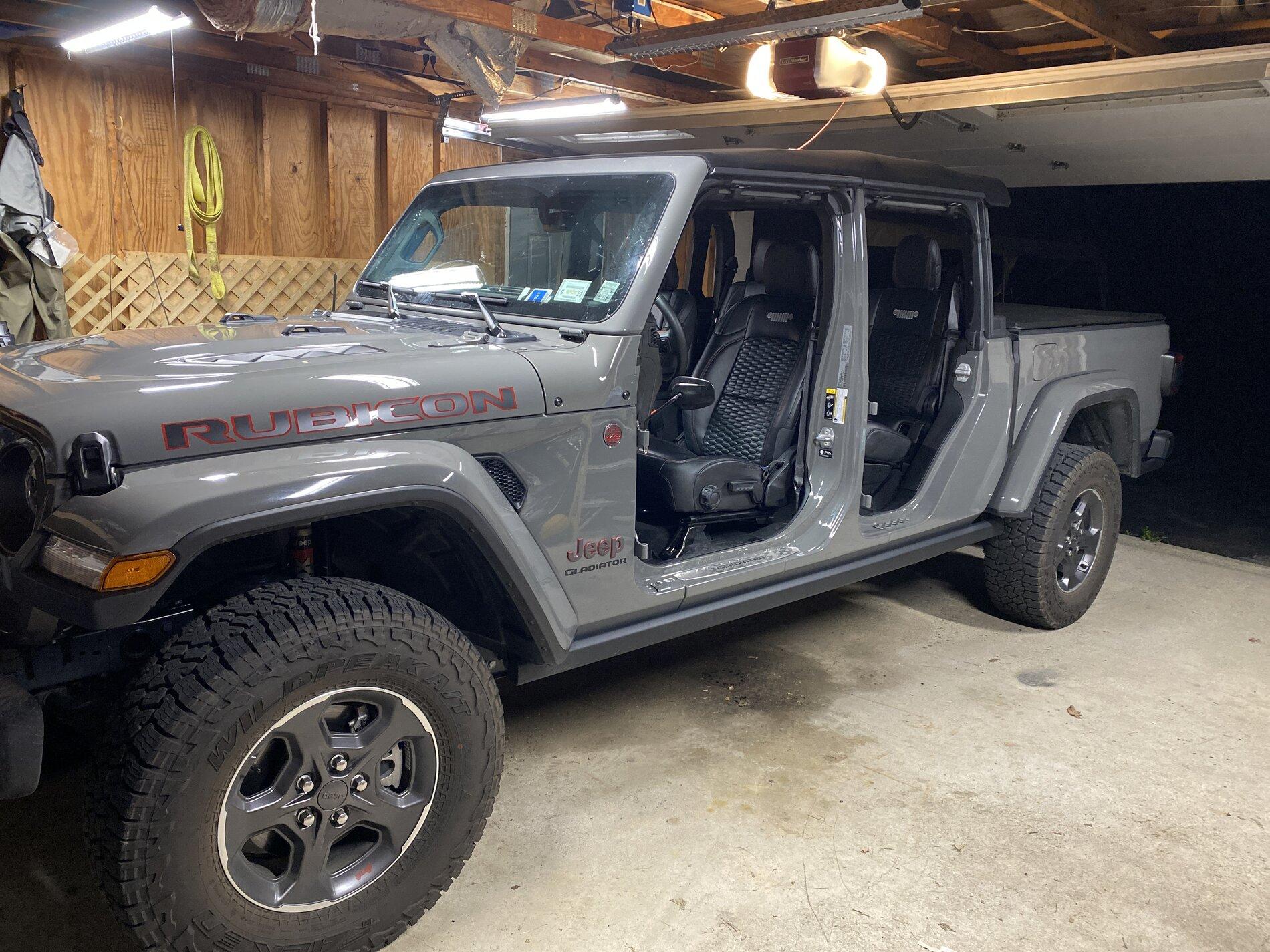

Going to paint the inside of my hard top before I swap out the soft top here soon. Would like to see some gloss, semi gloss, matte finishes to see what I like best, should I bother priming or just grab a few more cans of color? Thinking bout going for sting gray, maybe a shade darker. Show me what you’ve done folks
For reference

I went with flat black for mine. No primer, but the white soaked up a ton of paint. I can’t remember how many cans it took, but it was more than I expected. A little over a year later, it’s still holding up great.

With black seats, I would consider a dark gray. That's a lot of black when you put the doors on. Or you can make your own insulated panels and brighten up your black roof that way.
