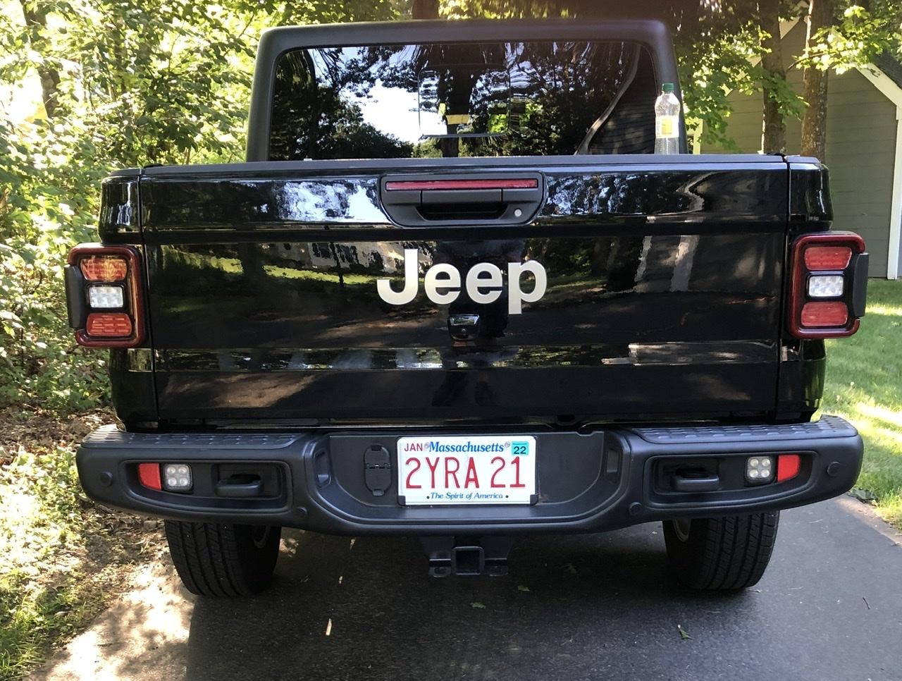

Holy crap these things are driving me nuts.
I decided to swap my plastic bumper for the rubicon steel bumper and these damn parking sensors can kiss my ass.
Different brackets to mount them in the steel bumper. I think I got the right things just to run into assembly issues. Finally got them all installed with I think the right parts but now I am not sure if the orientation is correct.
Anyone with a rubicon can you please help?
need to know how they should be oriented. Images would be helpful.

after installing them I followed the orientation of my overland bumper but when I put it in reverse the warning starts immediately.

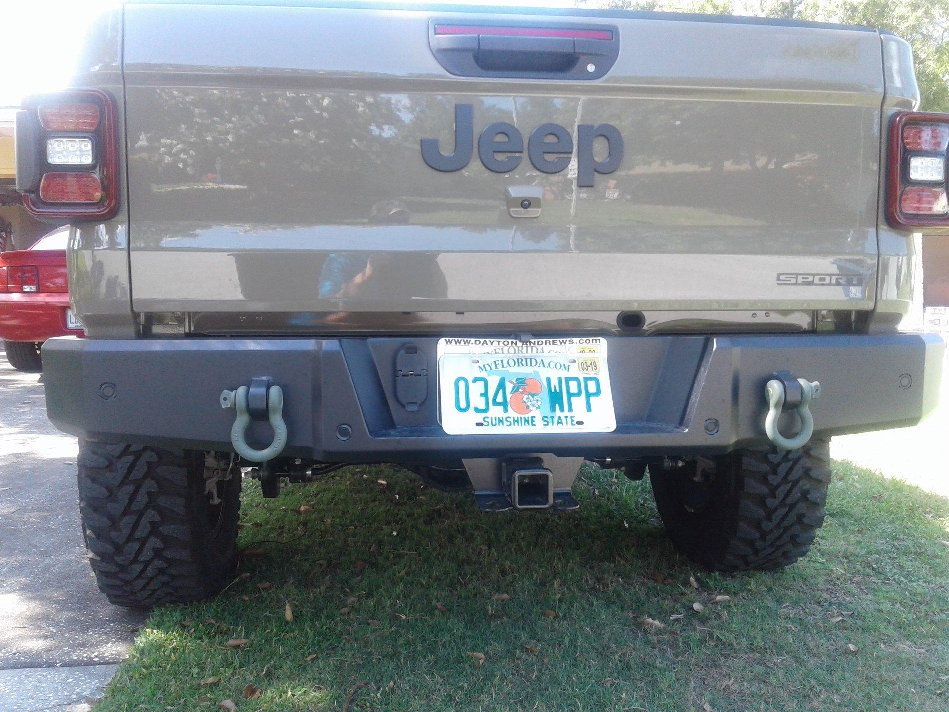

Did you ever get this figured out? I replaced mine with an aftermarket bumper and now the thing starts beeping and going nuts as soon as itā€™s in reverse. I thought maybe they need reset. Dealer checked it out and said no reset available.

Hmm...Iā€™m confused. What did you adjust? The angle of the bezels?
I bought a Magnum Raptor rear bumper. They call for replacing the bezels with ones from a Ram 1500. They are perfect straight with no angles. The bumper is pretty much straight too so Iā€™m not sure adjusting the angles would help.

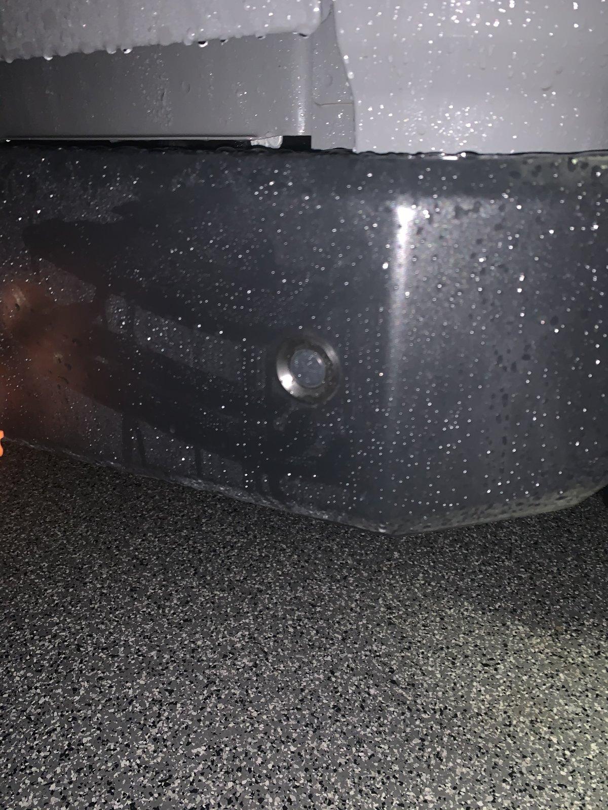

Yep, I just twisted them around until they were positioned to work. The sensors snap into the actual bezel which can turn in the bumper.
It isnā€™t easy. YOu have to grab the sensor from behind the bumper as well as the bezel and turn both at the same time. You kill your fingers.

I had the plastic bumper on a Sport S. The bezels were plastic welded to the bumper. The holes in the Magnum bumper are slotted so that the Ram bezels can only be inserted one way from the outside. Snapping the sensor into the bezel from inside the bumper locks it all together but the bezels wonā€™t rotate.

It looks like your sensors are just sitting in the holes. Can you poke them inside by accident if you push on them?
No they are tight in there
