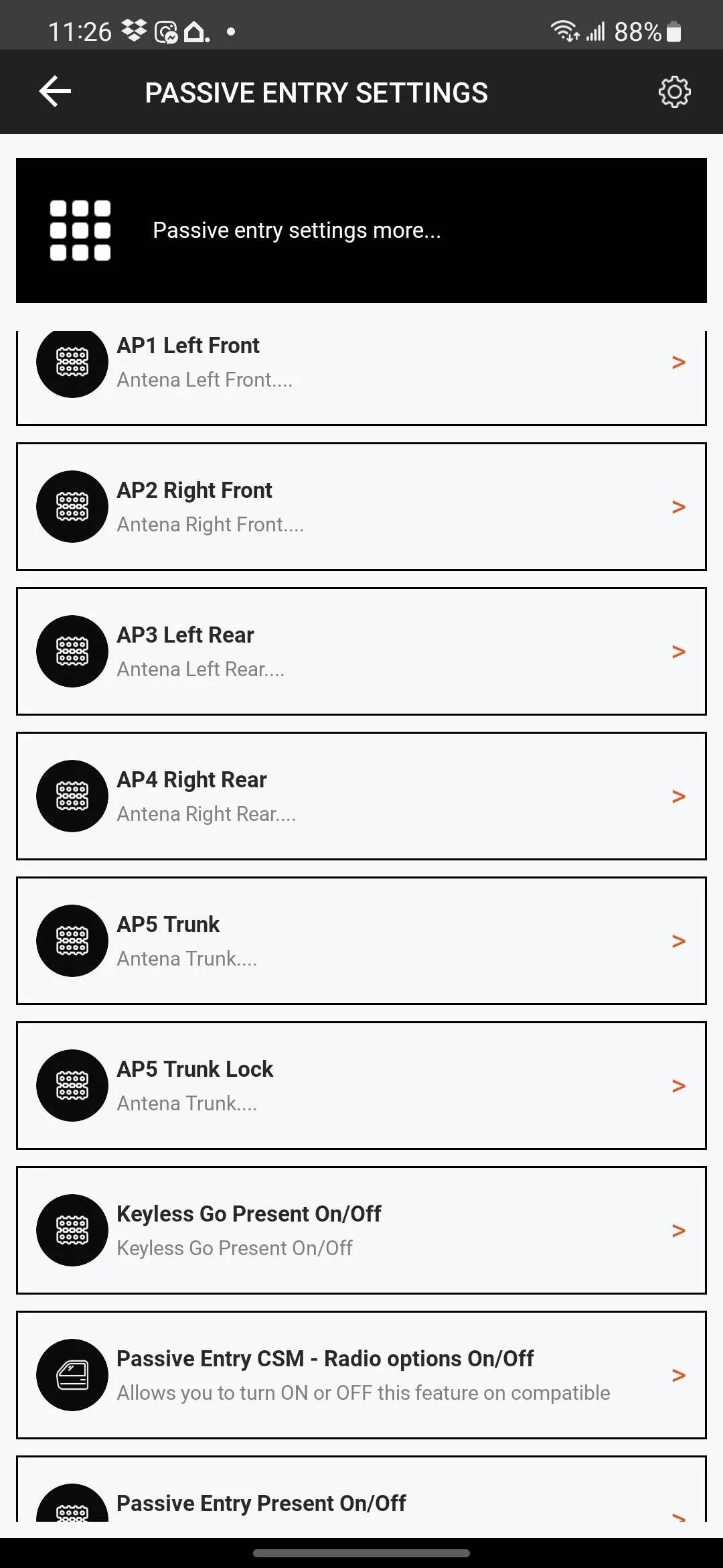

JSCAN settings
ADAPTION --> PASSIVE ENTRY SETTINGS -->
Settings in the order shown.
1) AP1 Left Front > Smart Switch
2) AP2 Right Front > Smart Switch
3) AP3 Left Rear > Smart Switch
4) AP4 Right Rear > Smart Switch
5) AP5 Trunk > Smart Switch
6) Passive Entry CSM - Radio options > Active
7) Passive Entry Present On/Off > Active

Did you check out the huge long thread on this that started back in about 2020?
Dozens have done it. Mine went smoothly back then, even though it was only about 30 degrees in my garage and I still had the old dark fluorescent lighting in there at the time. So it was dark and cold.
I still have a list of the parts (Benny didn't have a kit back then) and the JSCAN settings I used.
These are all you really need because there's no trunk for these, no back or hatch with passive entry.
AP1 Left front > smart switch
AP2 right front > smart switch
Passive entry present > yes/ active
Passive entry CSM > yes/ active
The last one is to add the option to the settings in the radio. You can turn it on and off from the radio once that shows up after a few hours. I believe it stands for something like customer settings menu or similar.
A couple of the videos make it appear harder than it is - and those using power tools risk breaking screws as some have also found out. A couple of steps in one of the videos isn't really necessary but it must have made it easier for them when they did it.
ecidiego
Nov 3, 2021
48
1,671
2,554
San Diego
2021 Gladiator Mojave
IT
Good work!
I think you only need AP1 and AP2. The other antennas aren't present.
I did plenty of searches but didn't find a true complete post, several posts put together, so I decided to share my experience and consolidate all the info I came across; also with current info as some of the posts were from 1 to 2 years old. Personally, I always hand loosen bolts before hitting with power tools, learned the hard way a few times myself in the past so made that a habit. I wasn't sure which settings on JSCAN so I played with a few and went with what I posted above, which does work, although I may try and go in and adjust based on your info to see the exact settings needed. Thank you for the reply and comments, I've seen you post numerous times as I'm still a newb to the forum, nice to have a post with a reply from Papa 😁

Good work!
Yeah that was the only thing I had to try and play around with (JSCAN settings), so I just wanted to post exactly what I did to make it work. Thanks for the comment/reply Cheers :like:
