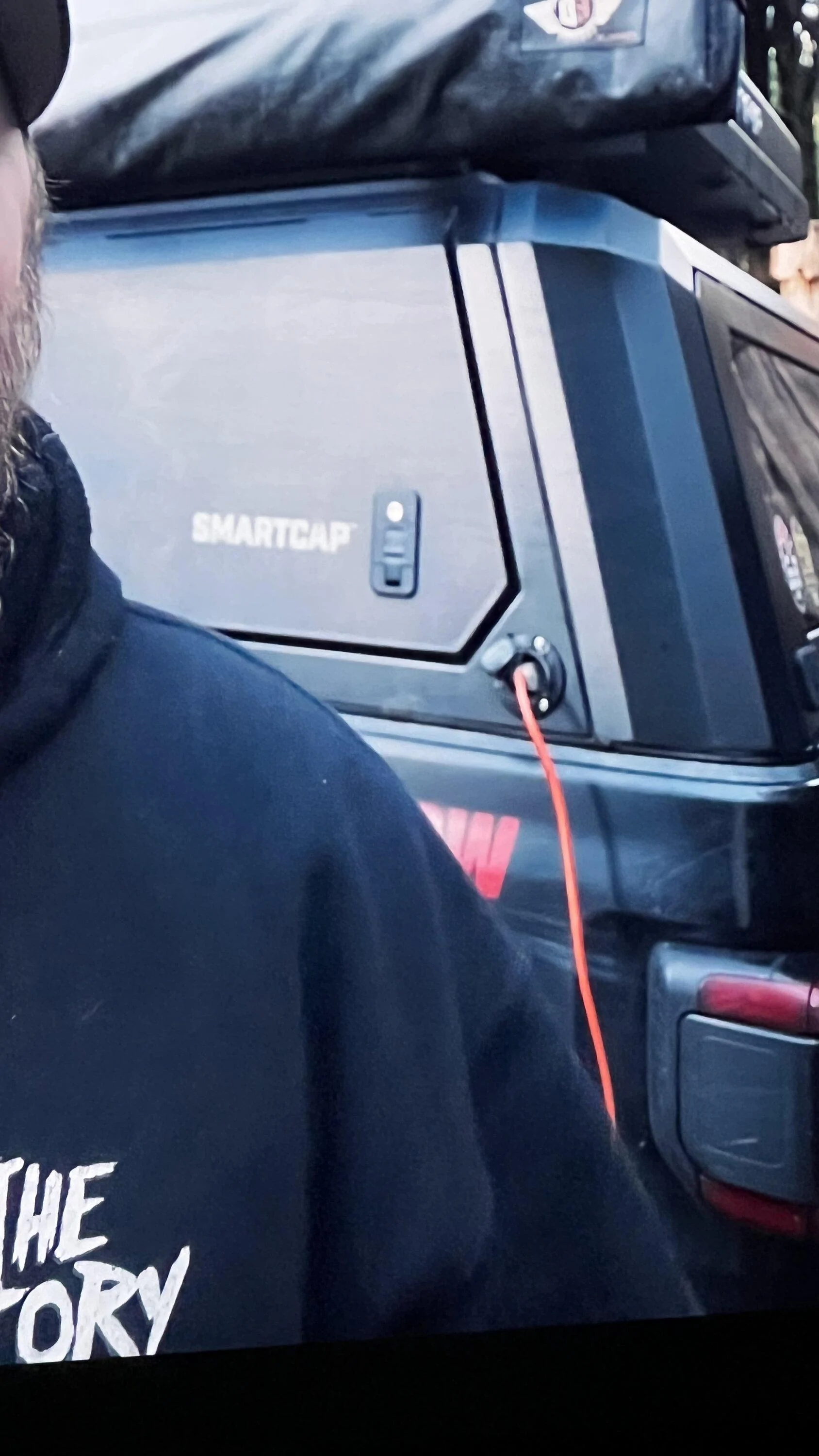

I would like to find a solution for a easier to hook up battery tender. With cold temps on the way, I want to make sure my JT is hooked up even if its only 3 days before I drive it again. My experience, batteries just dont last in the cold. Sean on the channel "The Story for Now" has what I am looking for, in theory (picture below). However, this is for his redarc system, I believe, that charges his aux battery. The redarc system has a shore plug option to charge the aux battery, but thats not the same as a low amp maintainer specifically for the main battery.
Does anyone happen to know if something like this exists? Hooking and unhooking clamps onto the battery every couple days when there's a couple feet of new snow is a pain.

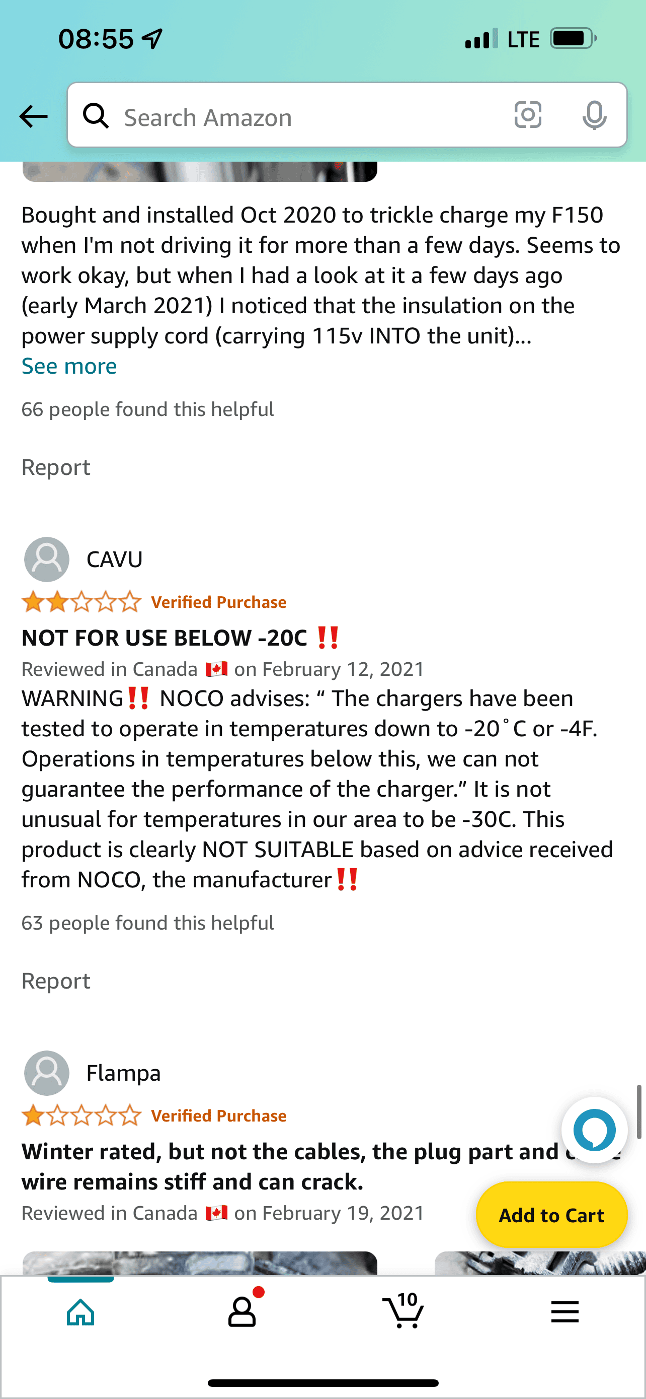

thank you! I was about to add it to my cart but then saw this comment
Jeep Gladiator Permanent mount battery tender 90708EE7-30EC-4ADC-90DA-FBE60653E6A1
i will have to call noco and verify
