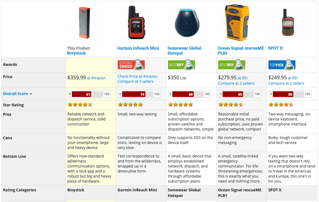

A great review of these units on REI's webpage:
https://www.rei.com/learn/expert-advice/personal-locator-beacons.html
