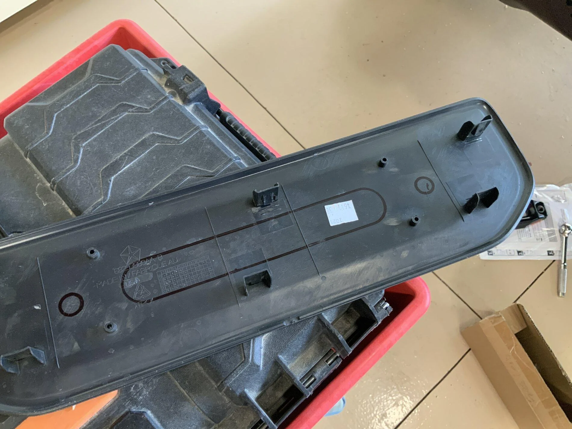

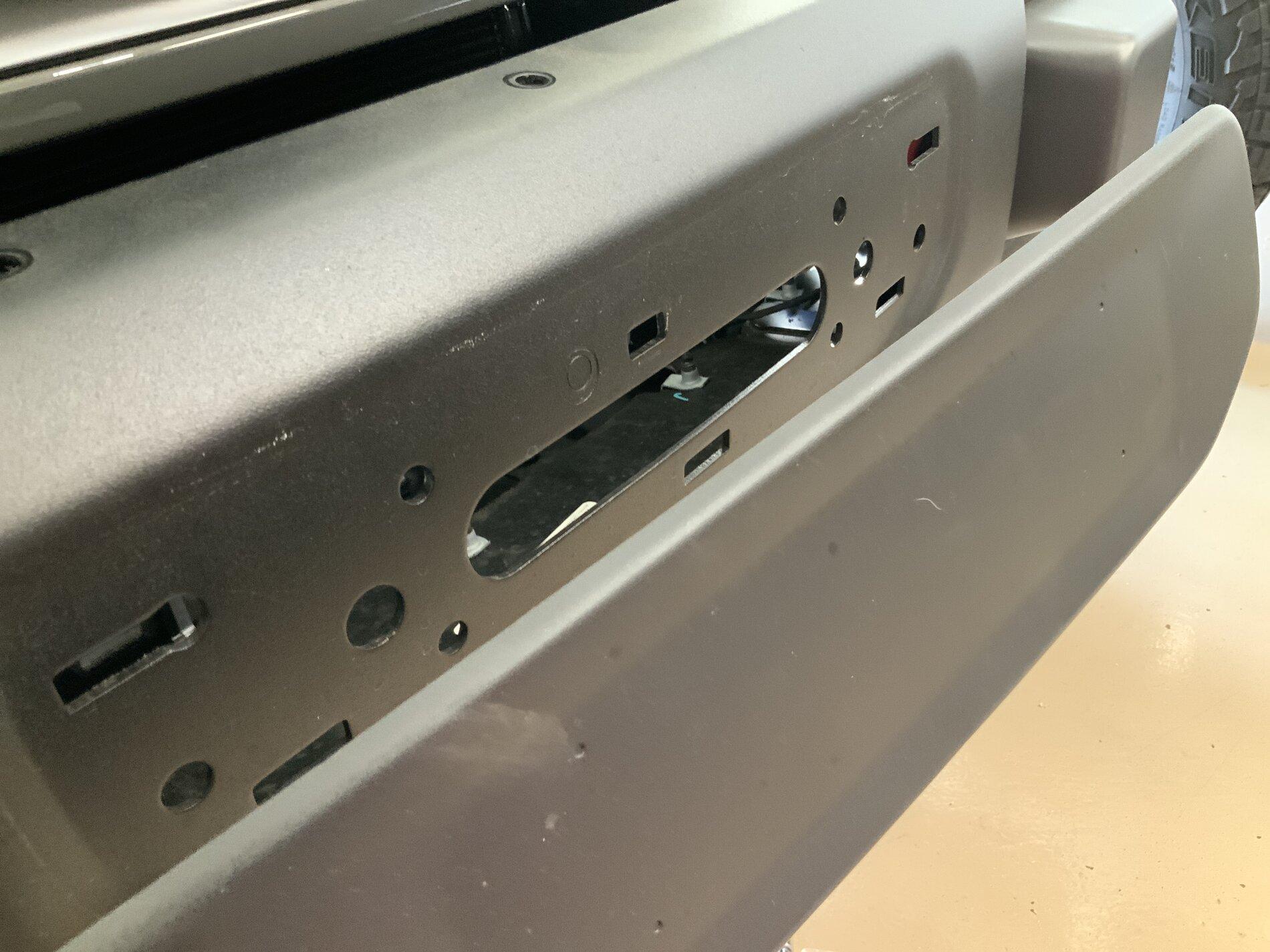

Do you just trim the plastic piece And leave it on? Plenty of excess holes in the steel behind the trim.

Yes, get this one, or one like it. You sandwich it between the bumper and the fairlead using the fairlead plate mounting bolts. I had to get longer bolts from Home Depot for mine to account for the extra thickness of the plate. Just make sure they're not too long where you run the chance of your cable/rope rubbing against them as the line builds up on the spool. Also, make sure the plate you order is for the "CENTERED" opening. There are some out there for an offset opening, which places the opening more to the left of right, depending on which way you mount the plate. I'm not sure why the offset plate exists, but I'm sure there's a reason it's out there.
