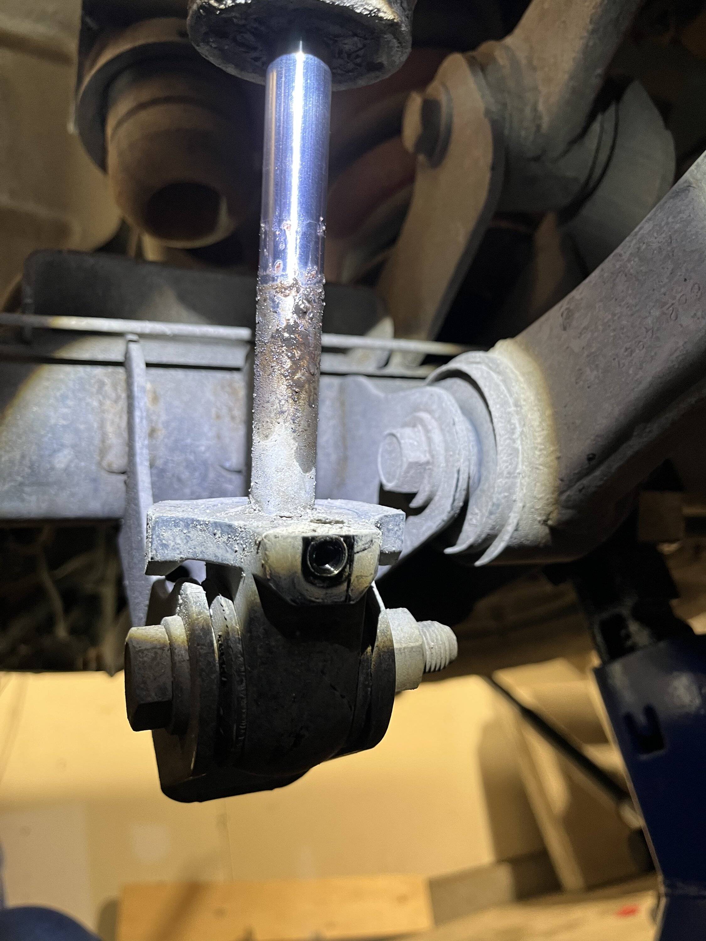

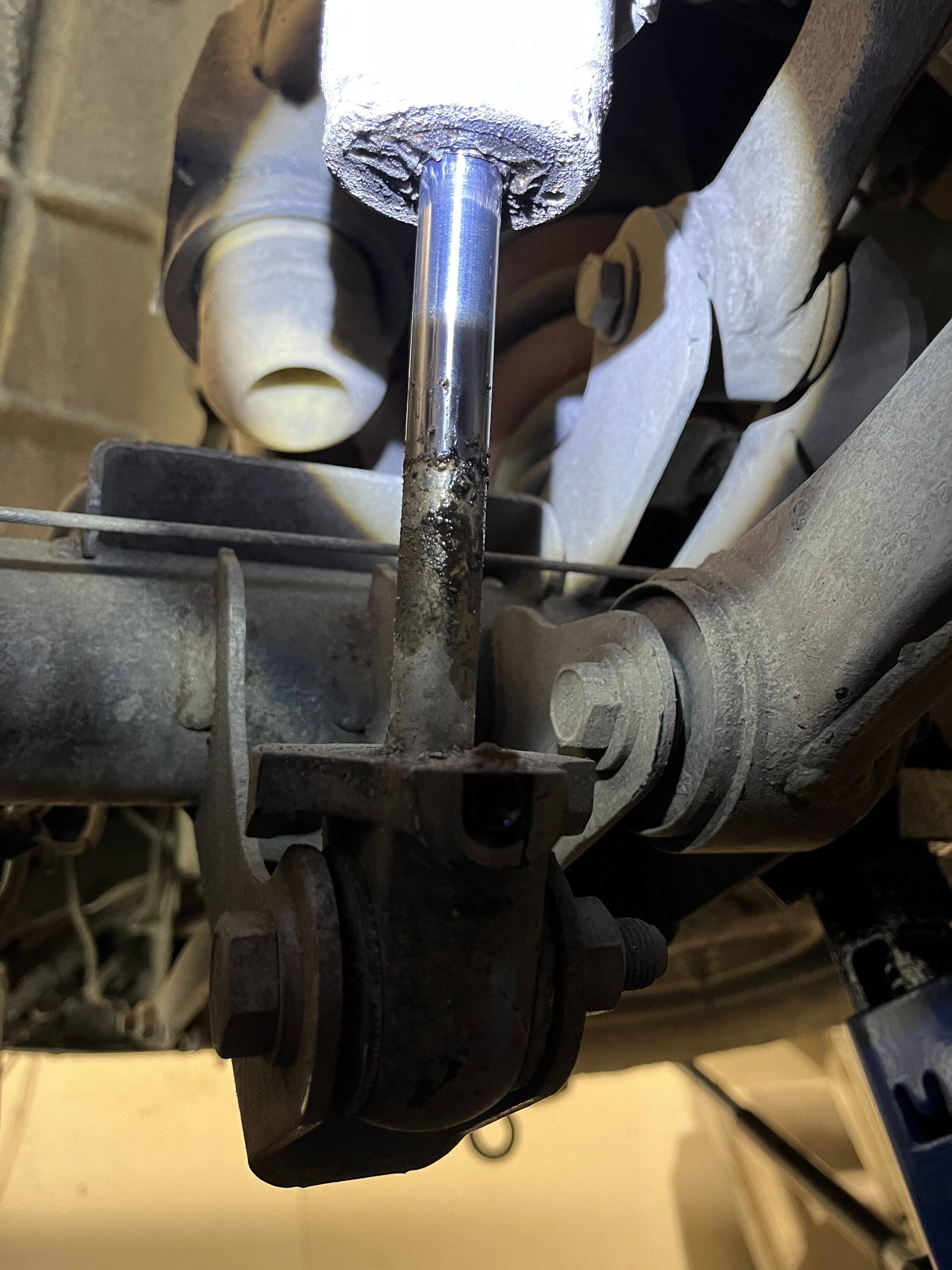

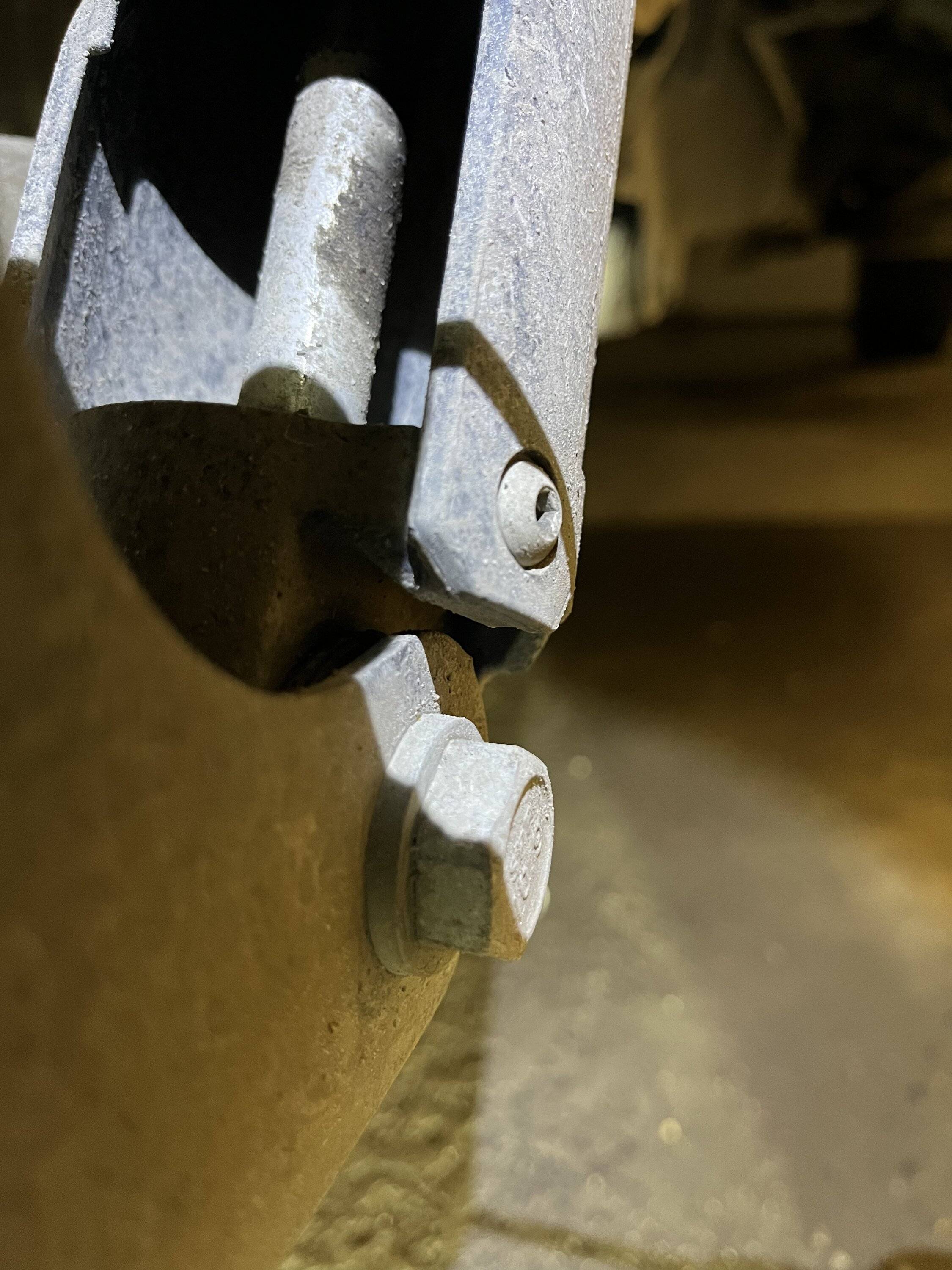

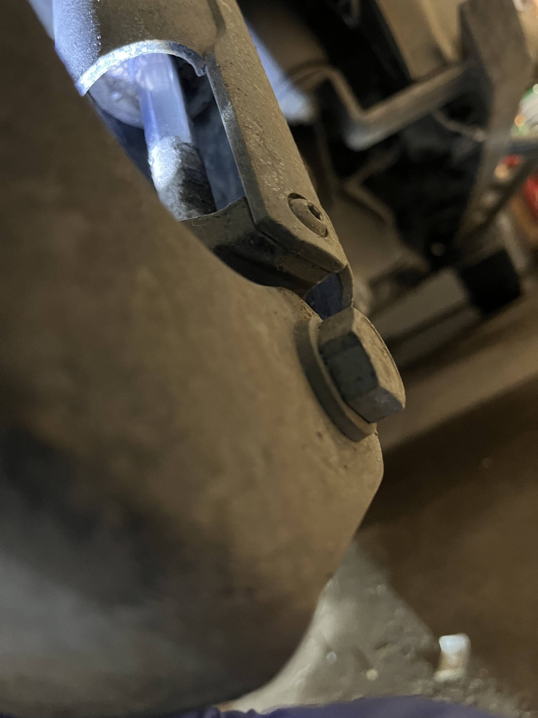

So this low creep speed and tight turning popping noise has been bugging me for a while and after checking all the nuts and bolts in the back and finding them tight, I had to dig a little deeper.
I’ve never liked the shocks on the JTR and the wife was really complaining lately about the excessive bouncy ride so I slid underneath to look at the shocks and lo and behold, they’re oily.
Truck goes in on Tuesday. Would they determine these are shot? I pulled the bottom bolt and shoved the shock stem all the way up then let it drop on its own. It would make a pop sound as it almost flexed out.
I would say yes. You would still have to be within the basic bumper to bumper warranty period for them to be covered. Then again, you are in Canada so no telling how they will handle it.
Based on the oily condition, I'm going to say no. Manufacturers typically accept some shock 'weeping' and 'wetness' as normal, and won't do anything unless the shock is dripping oil. Your shocks do not appear to be dripping.
Now, if you can get the dealer to confirm the popping noise is abnormal, then I think you'll get the shock(s) replaced. But, actually getting the dealer to accept an abnormal sound as abnormal could be a challenge.

Try. When I was in the shop doing this sort of work - if it leaked it leaked. Only a damp area wasn't a leak. If you could wipe any part of the shock and have wet oil on your finger, it was a bad shock.
My bet is that if I wiped my finger all the way around the wet part of that shock it would almost constitute a drip.
