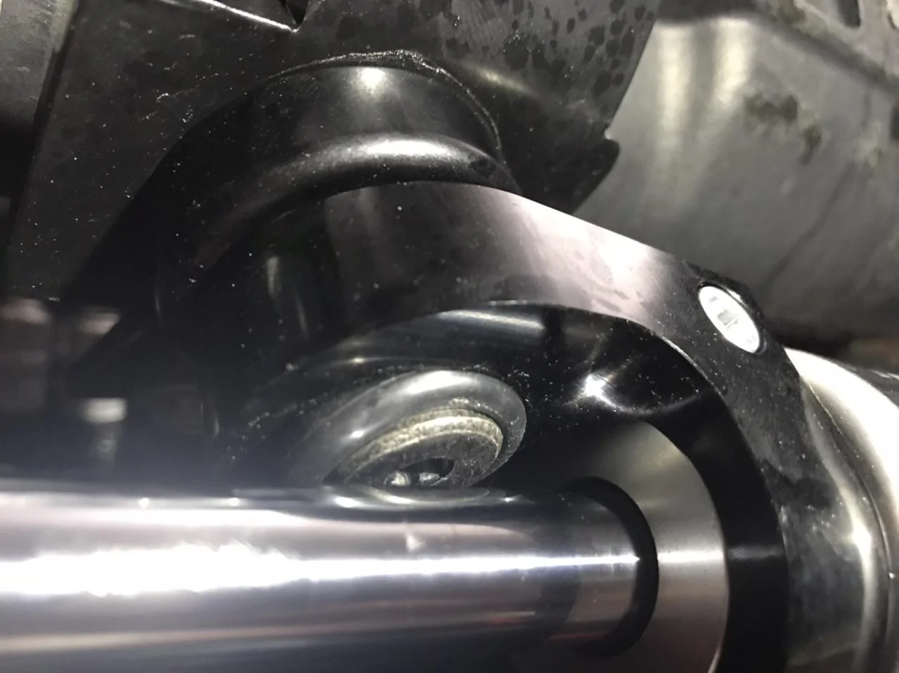

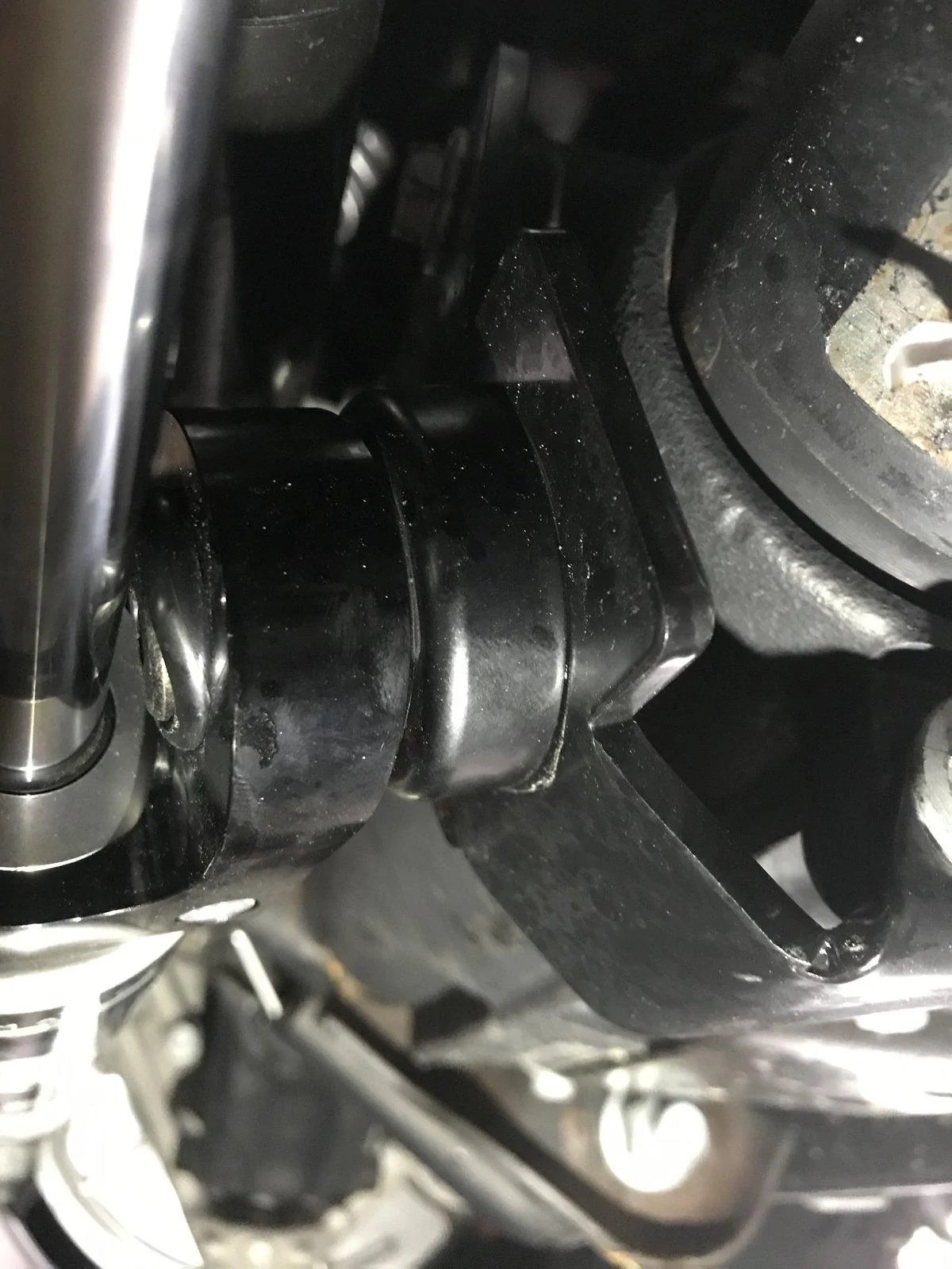

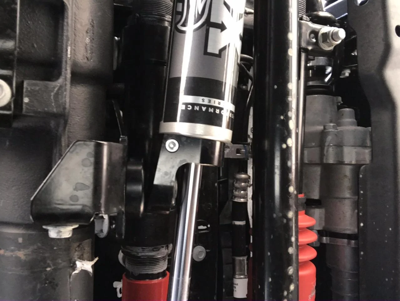

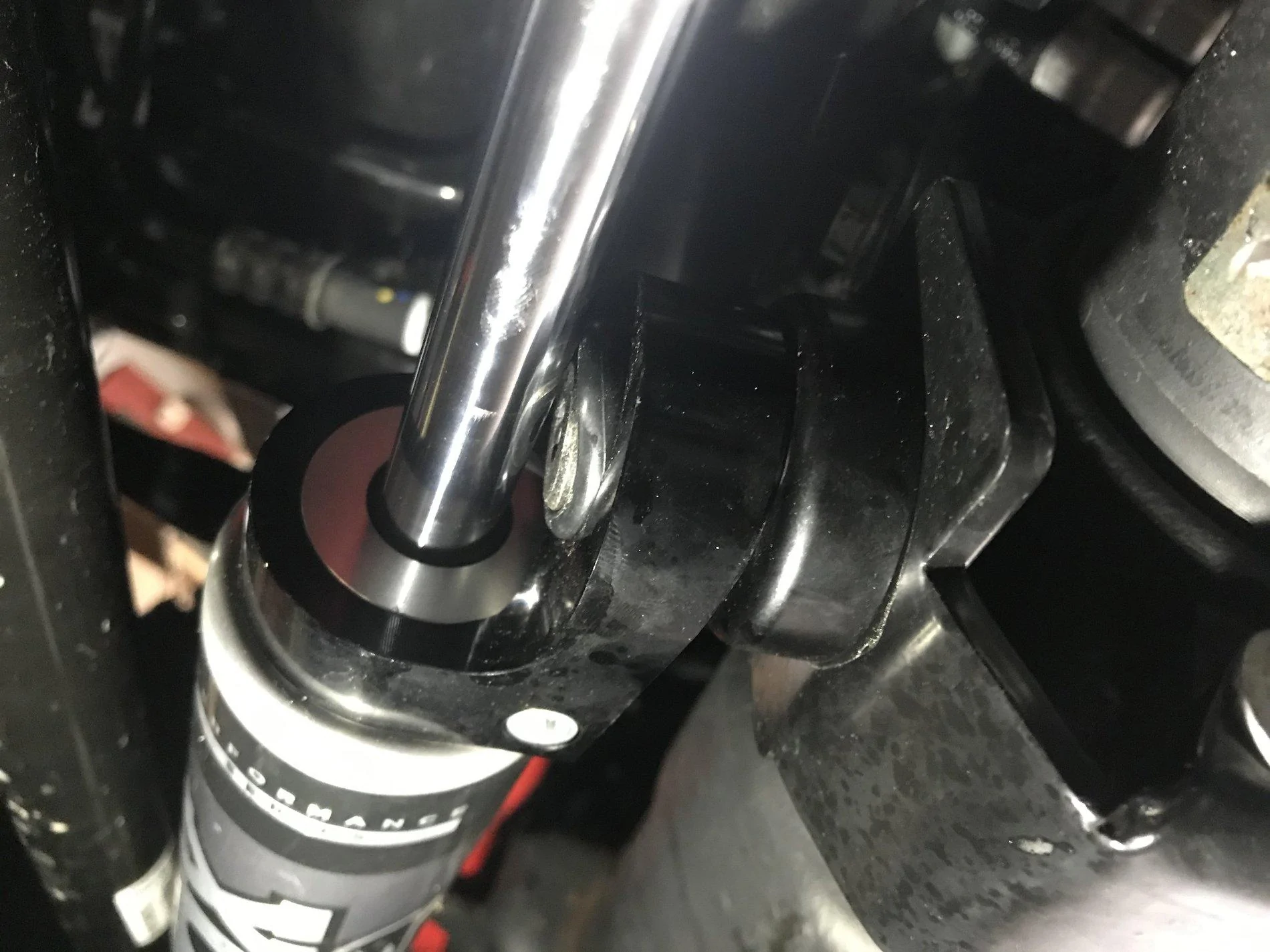

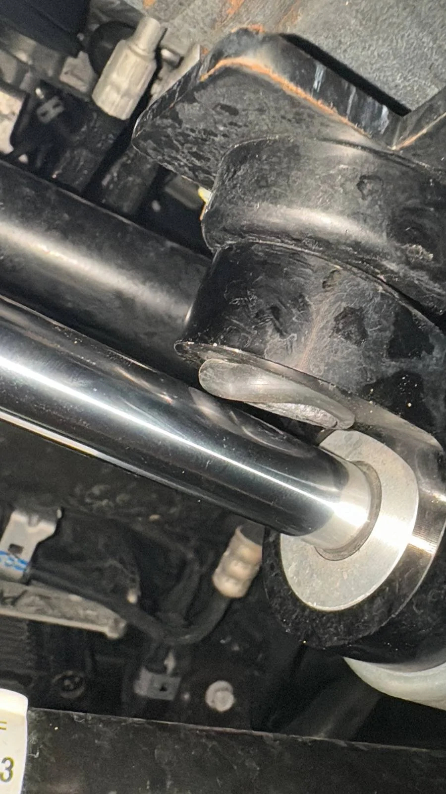

Oh and I noticed this with my steering stabilizer. It doesn’t look normal and I’ve reached out tofox on it. The rubber o ring seems to be coming out and the stabilizer is at an angle compared to the mounting bracket.

I would call this more of a heavy rattle than popping. To me, the sound of a worn out ball joint is a pop. This sounds like an interference hit/rattle. The flex of the suspension from the engine torquing may have some components touching under the right conditions. And retorque all the bolts in case something was bound up the first time. you may now have a bit of slack after things unbound and got properly seated/aligned. That stabilizer looks tight, but the pic may be misleading me.

I have an email out to fox and am going to call them about the stabilizer. It doesn’t look right to me. It’s like the bracket that bolts to the axle isn’t bent right and is putting a bind on it. Just didn’t know if anyone had one and theirs was at a slight angle also. Maybe this weekend I’ll loosen things and retorque everything.

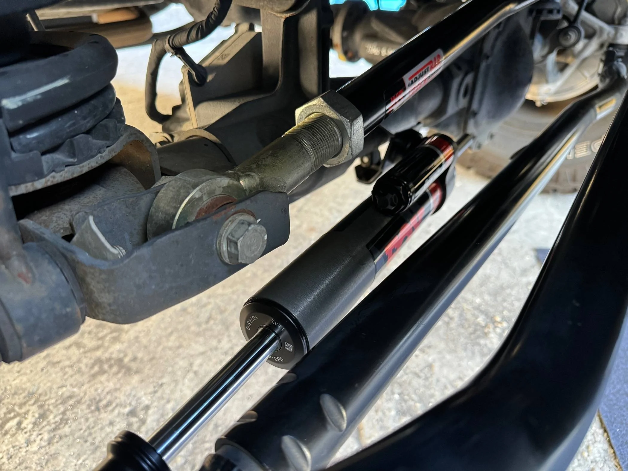

Is the bracket bolt on your stabilizer making contact with the shaft? It looks like something is a bit off with the bushing. It should look like this:
Jeep Gladiator Popping noise 1594237265454
Jeep Gladiator Popping noise 1594237615005

That’s the bracket and the bolt isn’t making contact. The rubber o ring that goes around the bolt to seal the ball joint is popping out. It’s at a pretty good angle and my assumption is the angle force has squeezed the o ring out a little. I contacted fox about it and they said to undo everything and reinstall the o ring. It just seems like the bracket they manufactured should come out away from the axle a little more to allow the stabalizer to be straight. Here’s a pic from the bottom that I sent them.
Jeep Gladiator Popping noise D5674041-5C40-4B92-9DAE-AC785B8542E8

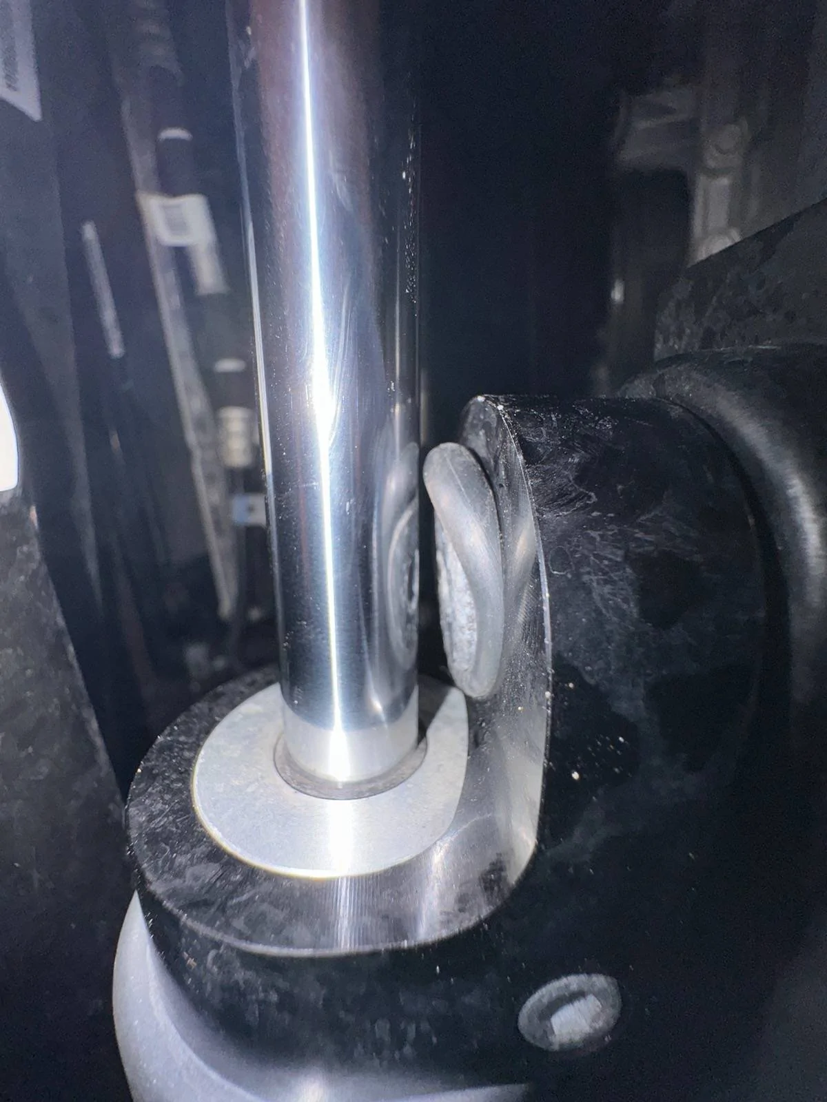

Now the next pic is the o ring coming out
Jeep Gladiator Popping noise 330A43BA-0EC0-4598-AC1C-CC979E7DE4E3

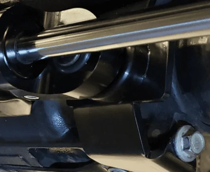

I just was searching online for something of this issue and well first of all I have the Jeep JLU WILLY’s 2022 and I have the same issue that rubber o-ring issue. I had installed a Fox TS and then after I saw this issue I decided to get the Fox ATS that is adjustable. Both are awesome specially the ATSI have pics of both when it had the Fox TS and now the ATS. Same issue with the FOX ATS I will put up a picture with the ATS with the O ring issue. Hopefully you have a fix for this or some that thank you in advance issue. Wondering if it’s because the pivoting point within the area. Did you have a solution. Thank you in advance.
