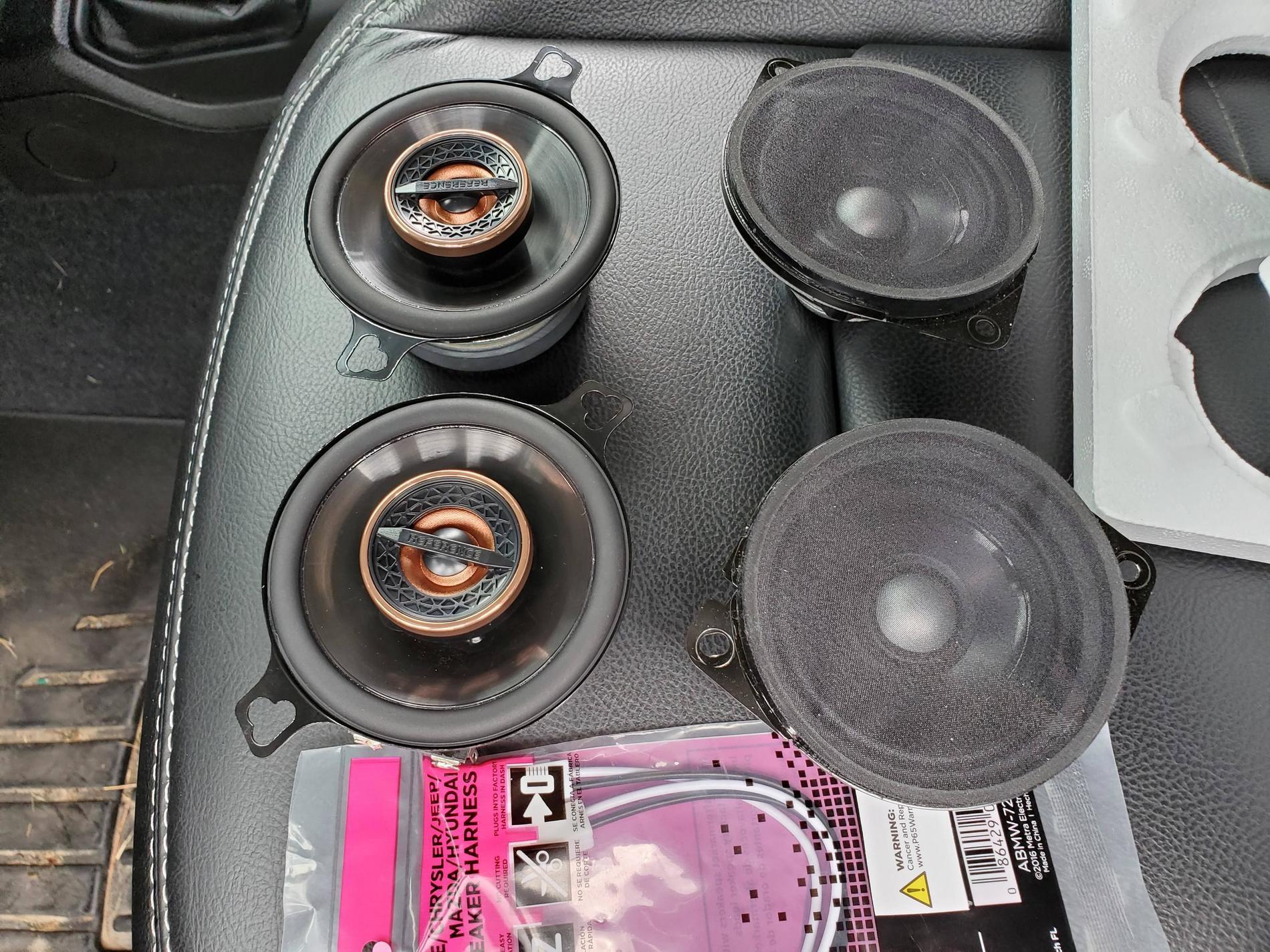

Stumbled across this on the jl forums:
Source: https://www.jlwranglerforums.com/fo...t-with-dash-speakers-and-alpine-system.34664/
I had a popping noise, I thought was coming from the front dash speakers, but as I found out, it's the knee speakers. The good news is the speakers I bought drive a much cleaner high and add even an extra mid-bass allowing me to keep the volume down while getting cleaner "in your face" sound.
These were used in the Alpine 9 speaker system with 8.4" touchscreen, but I am guessing most dash speakers are the same size.
I purchased the Infinity Reference REF-3032cfx 3-1/2" 2-way car speakers which I mention because all links die eventually, but at the time this was posted the link is:
https://www.crutchfield.com/p_108R3032CM/Infinity-Reference-REF-3032cfx.html?omnews=15593
It required trimming a tiny amount off the very ends of the mounts (it looks like it would fit three possible applications).
Jeep Gladiator Possible Speaker Upgrade mhddnv9-
Jeep Gladiator Possible Speaker Upgrade pnfmdvl-
Had I known how much better these improved the front sound, I would have done this anyway, so that worked out :) I've had two audio shops tell me speaker upgrades wouldn't do me any good. Now I'm questioning that.
