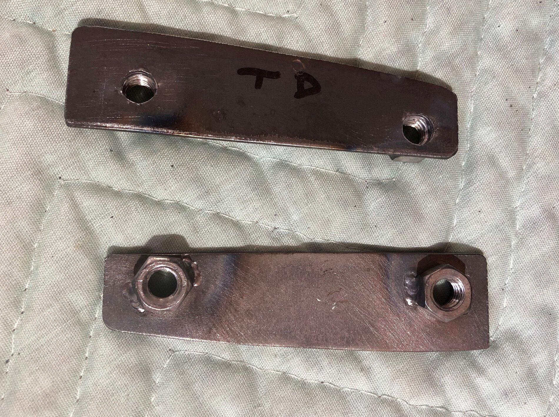

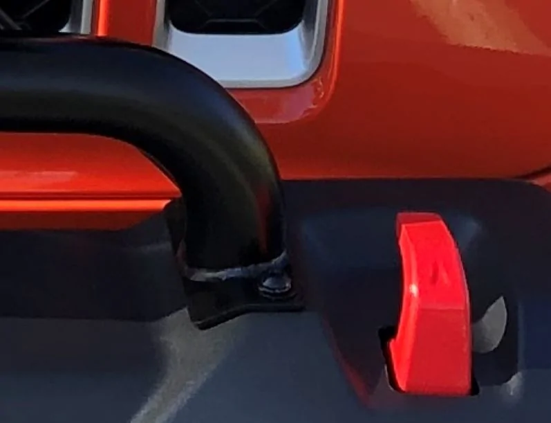

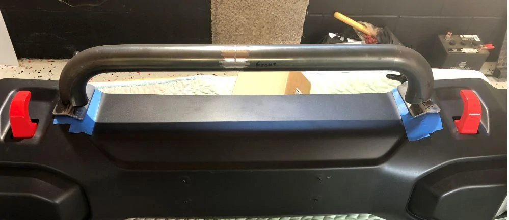

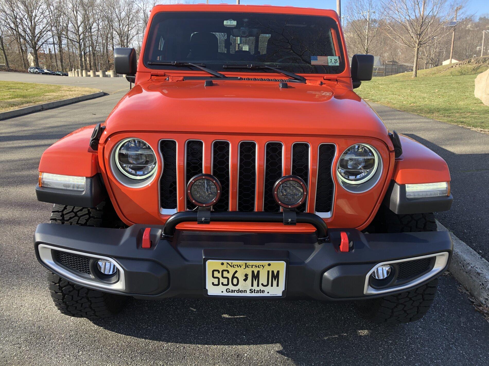

I made my own bar and mounted it on the Overland plastic bumper.
Yes, I used backer plates. It is bolted through the bumper cover and heavy part of the back plastic. It is VERY sturdy. More info here:
https://www.jeepgladiatorforum.com/...le-guard-on-plastic-bumper.38842/#post-633387

Hey punk'n haven't gotten around to doing this yet but wondering how you have yours setup from an electrical standpoint, specifically is there a way so that they only come on with the headlights? ..........
I wanted as many options of how/when to turn them on as possible. So, I just wired them to one of the Aux switches. I figured that gave me the most options...
a. with headlight low beam and fogs
b. with headlight high beam and fogs
c. with hi/or low headlight and no fogs
d. just bar light on by themselves.
However, if you wanted lights on the bar to come on with headlights, you could probably just tap one of the low beam wires and wire it into a relay as the trigger. Then, you could power the relay feed off of the Aux switch. This would allow you to have them on or off with headlights low beam via the Aux switch.
(On a side note....I did add a plug to disconnect wiring in case I ever want to pull bumper for some reason.)
